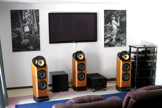

              If it's of any help, I have 3 x 802D's doing front duty. I'll not have it any other way.

                Wow...Nice set up Shadow..

                  Thank you, Iceman.
                  The reason that another PM1 would do so well doing center duty is that its vertical driver orientation would avoid sound wave interferences caused by other usual center speaker driver horizontal arrays. Your result should be an untainted and seamless front end soundstage.
