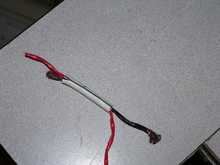

A few days ago I decided to shorten the mains speaker wires as they where to long. That is when I noticed something black inside the black coated wire..The red was fine.So I cut all the wires into sections and the black runs intermittently through out all the cable.I had bought 100 feet of this wire from my stereo shop long ago and before the economy closed them down so when I replaced the speaker wires long ago when trouble shooting my problem all I did was replace my problem with the same problem.See picture.
What can cause this .It is only in the black coated wire.It is **%$###r 12awg wire and I guess that's what I get for going that route.Replaced with some 12awg wire from ^%%$## and now the Legend speakers are sounding even and the problem is gone.I have been searching for the answer and never could figure it out.
