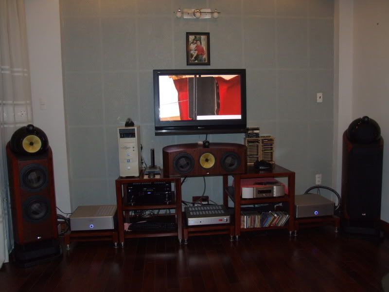

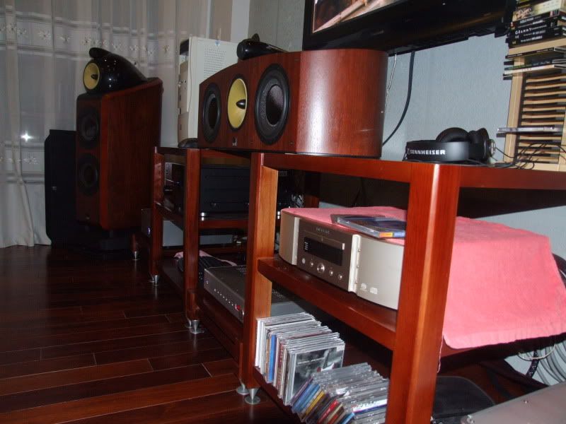

      I completely moved whole AV system to a dedicated room, and managed to get some pics up.
      BTW, I gotta exchange a speaker for another one due to mismatched color (1 dark brown, 1 dark red). Dealer sent in a new piece but it is 80kg (boxed) vs the other one is 84.6kg. Why the weight is different?

        Very nice setup! What do you have the 802D's on? Is that granite? How and where did you customize from. They look very nice and robust.

          Thanks, Ray!
          Yes, I have custom-made granite bases (2 layer per piece) for 802Ds, and each is very heavy (~30kg). In Vietnam, you can easily get those.
          I am thinking of removing the middle (low) one (where the pre is on) so that I can have more space (about 25cm on each side) for 802D to get more soundstage (about 30cm from back/side of each 802D)..

            Awesome system, d52232dole! :T
            Also great to see another Krell owner.
              A very good idea. Or is it possible to move the Krell amps into the middle section, where the pre is? This could open up even more room for the 802D's. Just a thought.

                Gorgeous setup! That's one lucky kid. ;x(
                Excellent idea.
                Also, is it possible for the rear two speakers to not face each other directly?
                Now it looks like you will soon need an even bigger TV, or maybe a projector screen? :B
