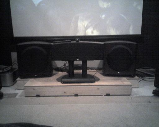

                I'm not familiar with your pre/pro, so let me tell you what I have done. This is subject to change, as I just received my SSP-800.
                I am currently using a Krell Showcase. It only has 1 output for subs. I used that output to extend to the subs, at which point I 'Y' off to individual cables for each sub. I unplugged one sub and calibrated the sub to my ref point via the volume knob on the sub itself. I then unplugged this cable and did the other sub to the same level. Then I plugged both subs in and used the system to calibrate the pair (which were now of equal levels) with the rest of the system. I found about a 4db difference between the individual subs and the pair.
                Both of my subs are inside of the L/R speakers. See pic:
                I have built a platform to raise my center and subs off the ground. The platform is filled with a combination of sand and insulation. I also found it necessary to spike the subs, which I used the soundcare superspikes. (I know that isnt what you asked, but so there doesn't need to be any questions about it). I also used U boats to "float" my stage off the floor.
                I only have N802s, but I cross mine over at 80(THX).
                This will change with my new SSP-800, as it has independent inputs for each sub.

                  Cool, the platform looks unfinished is it new?
                    Yes, I have some tile work to do in another part of the room before I can carpet. It is still in its 'raw' form at this time.
