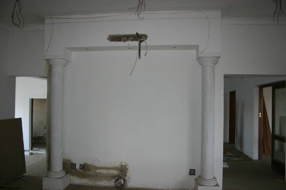

            Here is a picture of the wall that is to be used for the plasma and on walls.
            The distance between the inner parts of the columms is 2.46m.
            The columms project out from the wall 30cm(depth).
            Can I opt for a 50inch, if so will I still be okay with the on walls or will the columms interfere.
            Is even a 42" a problem thus limiting me to sub/sat systems.
            The installer has recommended putting the two front sats up where you see the wires hanging(it will be just below the cornicing). The two thinner wires.
            The centre would then be just below the plasma. I am worried about this, hence also leaning to the FPM's which would flank the plasma.
            Would they be okay hung up so high if I were to go for the sats?

              Your installer is wrong. Putting your L and R that high is not ideal. When you sit have both your plasma and the centre of the speakers (in the case of FPMs) at eye level.
              FPMs will work great here in my opinion. Place them 1.5 meters apart or just an inch or two from the plasma. Get the 50". Trust me.
              Looks like you have a very cool space to work with. If you want my personal opinion FPMs look their best in black.
              What do you plan to power them with? I have powered mine with Denon, a Rotel 1055, Rotel 1067 and 1068/1077. These speakers seem to sound dramatically different depending on what you pair them with.
              *On a side thought, and I could be wrong. I would at least consider placing the L and R ON the columns. It may not work at all, but if it looked ok it would probabl sound best.
              * one last idea. Get yout installer to place the cable outlet/power outlet right behind your plasma so you see no cords running to it.
