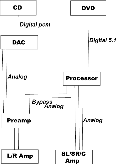

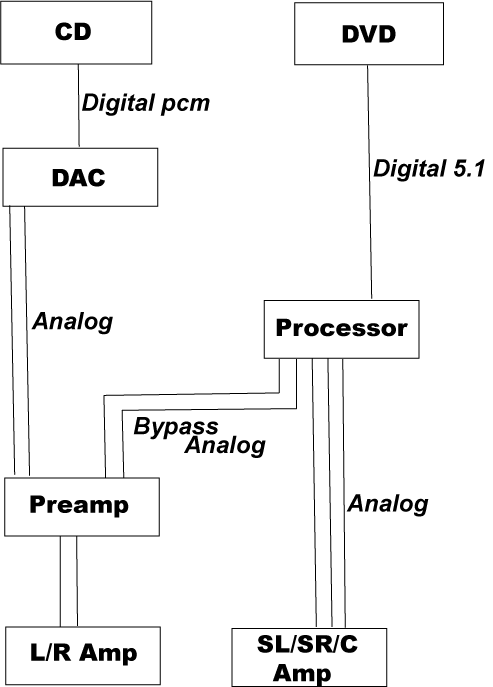

                          • misterdoggy
                            • 1418
                            Aha more important to have a bypass in the preamp and bypass the L&R channels of HT.
                            Ideal: direct from the CD/DAC to the Preamp to Amp
                            HT DVD to Processor to Preamp (bypass) to Amp
                            they share the common L&R Amp trhu the Preamp
                            I think I've got it !!

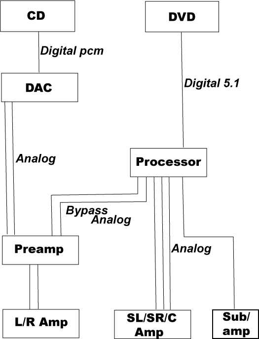

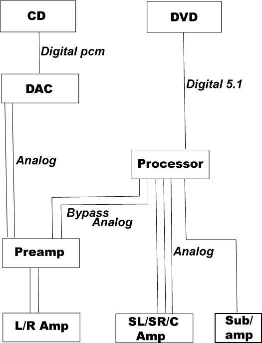

                            • misterdoggy
                              • 1418
                              Is this the idea then ?
                              • krellfan
                                • 64
                                Doggy,
                                Your second diagram is how my system is setup. Hoffi had suggested the Krell KCT and it might be a good option. Since the Krell amp has CAST and Balanced inputs, the KCT preamp can be connected to the CAST and the MC12B can connected to the balanced of the 400cx. If the KCT is turn on, the 400CX will automatically switch to CAST input.
                                The switch box that I was referring is automatic switching since it can be triggered from the processor such that when you turn the MC12B on, it switched in input.
                                • Karma
                                  • 801
                                  HI doggy,
                                  Wow! Nice drawing. Yes, you nailed it. There are a couple of minor details that are not accurate compared to my setup but none are show stoppers. What you have drawn will work.
                                  The CD player and DVD player is actually the same unit. I drive the DAC from the players coax output. Because the player and the AV receiver are both Denon I can use the Denon Digital Link to provide 5.1 from the player to the AV receiver. Thus, both paths from the player are digital. This is just a detail that happens to fit for me.
                                  The center channel connection is from the AV receivers center preamp out to the Krell KAV3250 third channel. But if one only has a stereo power amp, one could just as easily drive the center speaker from receivers center power amp just as you have it drawn.
                                  You don't show the subwoofer connections which is an issue you will need to work out. I use a manual toggle switch to switch the subs (I have two of them used in a stereo mode for music and mono for LFE) inputs between the Preamps left and right stereo outputs for music or from the LFE receiver output for movies. I split the LFE signal to drive the subs.
                                  Sparky
                                    • 10933
                                    Your last graphic is exactly how my system is setup. I only use the processor for multi-channel, that maintains the purest signal for 2 channel.
                                    • misterdoggy
                                      • 1418
                                      Originally posted by Karma
                                      HI doggy,
                                      You don't show the subwoofer connections which is an issue you will need to work out.Sparky
                                      Sparky,
                                      Actually My CD and DVD player are one unit with 2 digital outputs. 1 PCM and the other for 5.1, but in the drawing it portrays that they are separate because they are separate in the unit as well.
                                      The subwoofer is of no consequence as it is self powered and will receive the signal from the processor.
                                      I've redone the drawing to include sub.
                                      I am happy to hear from "respected" members that use this config and will go this route too.!! Thanks Guys
                                      I'm thinking about Pass Labs X2.5 as it has bypass with Gain made expressly for processors.

                                                                    Another question. If someone is searching for complete transparency, then why have a preamplifier at all.
                                                                    I am running thru bypass in the mc12b. Isn't that transparent.
                                                                    Or this bypass isn't transparent and I need a preamp to be transparent, because there is some "coloration" of some sort coming from bypass going thru the MC12.
                                                                    I mean, I've read reviews about some preamps that cost $5k and the word used the most is "transparent". Why pay 5k$ for nothing "air"

                                                                      HI doggy,
                                                                      Not all bypasses are created equal. There are different ways to implement it; expensive and cheap. In the case of the Krell KAV-280p preamp, relays are used to implement the gain change and alter the signal path. This is the expensive way.
                                                                      My Denon AV receiver does it differently. Here an analog circuit called an "Analog Switch" is used. They are pretty good and are used extensively where signal quality is not of absolute importance. But it is an active circuit (not exactly but kind of like an amplifier with a gain of 1) which can and is characterized by its performance limits. This is the cheap and most common way especially in less than top end equipment. Best to avoid if possible.
                                                                      Relays, done right, are much better since there is less opportunity to corrupt the delicate audio signal. This and a thousand other very definite things are the reasons that some equipment costs more than others.
                                                                      But, in the final analysis, the simplist signal path is almost always best. There are some restrictions even here because the reality of physics imposes itself. For example, will that nifty passive circuit drive the necessary cable capacitance? And the list goes on. Blanket statements will almost always prove wrong in specific cases. Only our ears will reveal the truth .
