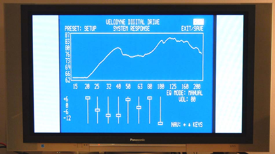

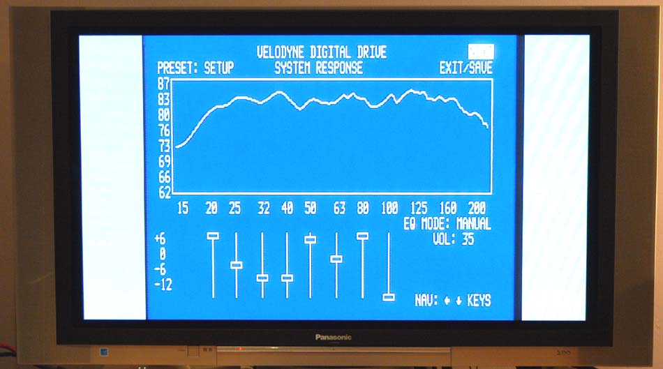

    b&w signature 805 + velodyne dd-12
    see thumbnails for some interesting 15hz - 200hz response charts for my pair of signature 805 before and after incorporating a velodyne dd-12 into my system :E :T
    i am one happy camper

    WOW, you just sold me on the digital EQ system!!

      Very impressive EQ, what crossover frequency did you use?

        thanks guys. i am sending full signals from cd player to both monitors and sub, while limiting the sub's response to 60hz and below. i chose 60hz because it is the center of my monitors' response dip. it works well.
        i initially thought of getting two subs. but after hearing the superb dd-12, i doubt another one would be much better for the money.
