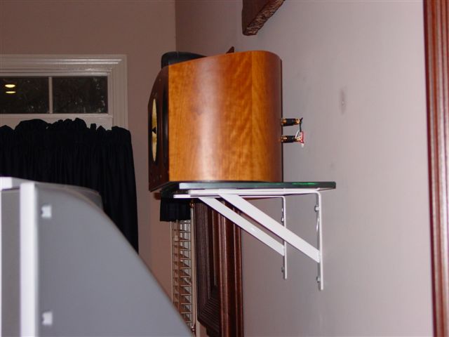

    I have a sony Qualia 70 inch RPTV and would like to mount a HT2MD on top of the TV (TV stand only has 20 inch width shelves). The HT2MD is 33.1 inches wide and weighs 68lbs. The TV does not have a wide top platform... It slopes back. I noticed Jeff has one installed on a Sony RPTV:
    I've sent him a PM and haven't heard back yet. Most top shelves only allow for 15 pounds. Any recomendations????

      Viper,
      Here's a picture of the shelf I described in the PM.

        Jeff,
        Thanks for the reply... The setup looks as you designed it (Center floating above the TV)
