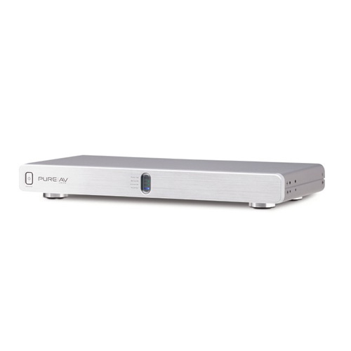

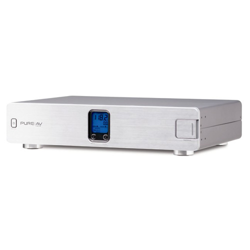

        I would suggest Belkin PureAV PF30 Power Console. MSRP is $200, but you can find them for about $100 or less at a few online stores. If you don't put too much faith on power conditioners drastically improving picture and sound, this may be a good one for you. IMO, it looks sleeker and more elegant than most power conditioners out there, and if your electronics are silver, it will match them well. It does however only have eight outlets. There are also upper model PureAV conditioners you can buy for far less than their MSRP.
        As suggested before, APC makes really good products even though they cost more. Also, if you have Rotel gears, the new Rotel power conditioner RLC-1040 ($499 if I'm not mistaken) may work for you too.
        Below is the picture of PureAV PF30 and PF40.
