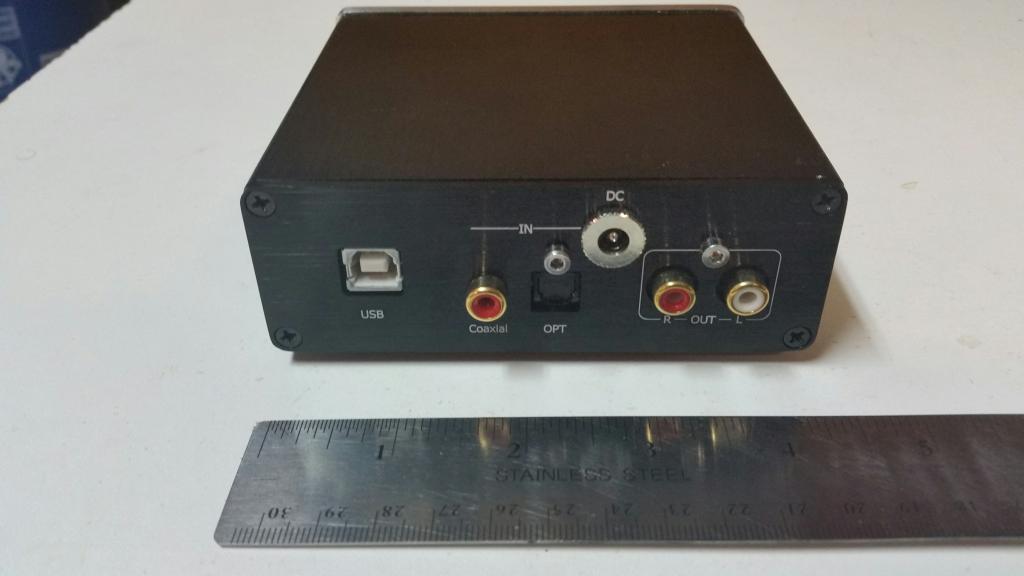

It arrived!

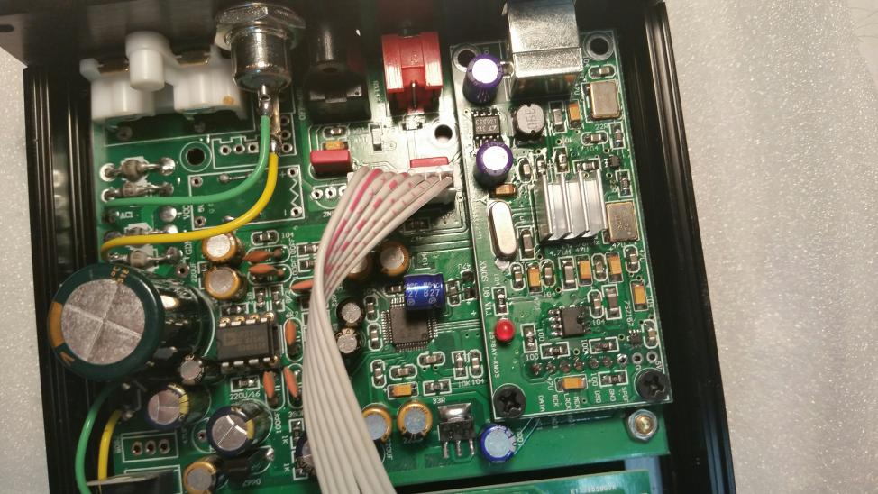

It got here yesterday and I couldn't wait to open it up this morning and take a look at the insides. Because I can.:demon:
Now i'm not really sure what I was expecting, I've been burned by things from China before. Sometimes ya just get Lucky:T

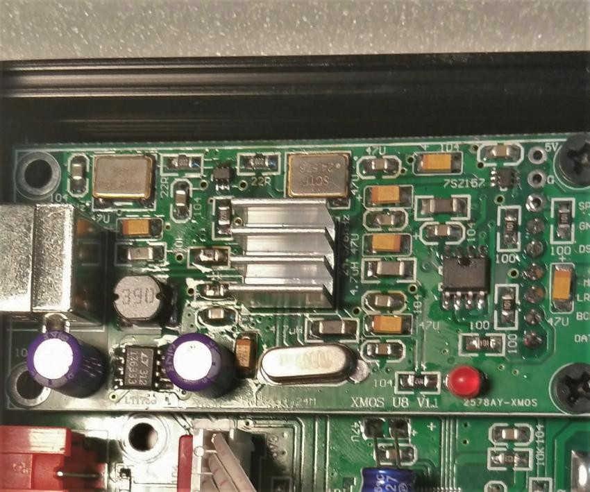

For starters, it has a real AKM 4490EQ chipset and a real Xmos U8 v1.1 daughter board. Whoa, most excellent! (Ted's Voice)
Nichicon and Elna capacitors too. :E
The output op Amp is an OP 275, it's even on a 8 pin chip socket. Just like a ripe fruit waiting to be plucked and exchanged.:rofl:
Solder joints are clean and things are Tidy inside.

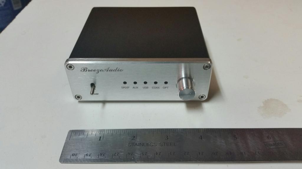

I wish my speakers were finished so I can try this out and give a review. Maybe next week.
Enjoy the photos and tell me what you think.

thanks for the pics, i will let The Maestro make any comments relating the electronics as such things are not in anywhere near my wheelhouse of expertise.- Bottom
It certainly looks like it's worth what you paid and more, but as usual, the acid test is the listening... good luck with that.
