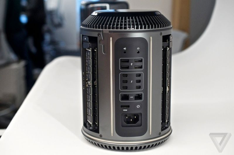

      Over the holiday break I hope to have my external USB 2TB drive loaded up with Hi-Res stuff and connected to the M50 server, and the DCD8 added in to the system. I'm looking forward to this, it's going to be a music oriented Christmas in many ways (new Taylor acoustic guitar for my GF, too- don't tell her and spoil the surprise!)
      And I have a huge backlog of ripped SACDs and unripped material that needs to be processed into tracks and coverted to AIFF or FLAC- probably the latter considering how well the NAD M50 handles that, and the resulting space saving. To that end, about 1 AM Thursday morning I ordered a new Mac Pro- I'm one of the lucky ones, it will actually ship in December!
      I just gave my last one away to my daughter's cousin who's a partial quadriplegic, due to spinal injury, just like Charlie.
      The internal storage will just be used for the boot system, system library, applications, and admin account. the main user account will reside on an external Thunderbolt RAID array, in a Pegasus J4 (4TB)

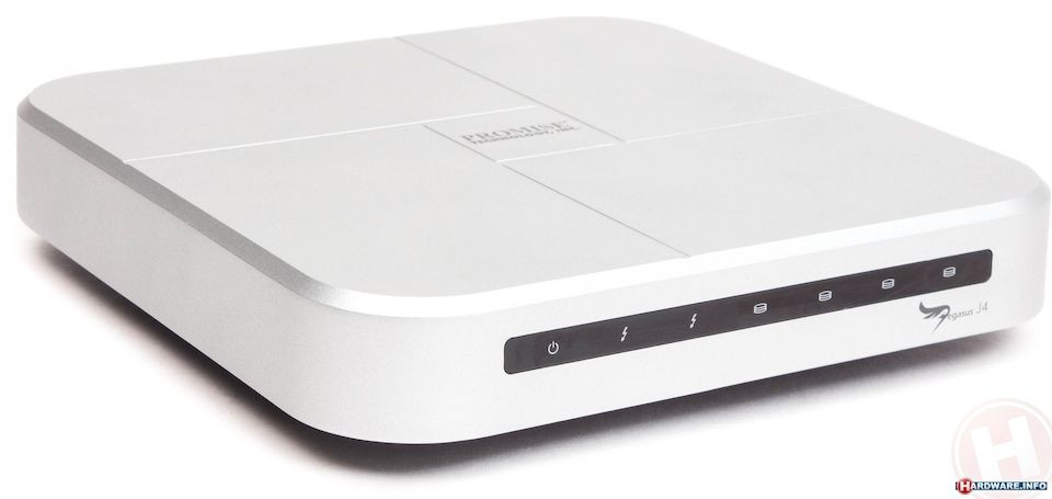

      What's likely not apparent from this picture is that it is a 4 drive array using 2.5" disks, with a foot print matching the current Mac mini. I.E., small and portable. Backup will be a LacCie 8TB TB array.
      Of course, this will get used for photography and design, as well as work. With the ability to relocate user folders to a different drive from the startup drive, I can have multiple "accessory" user drives, one setup just for work stuff, with a different user account name, for example.
