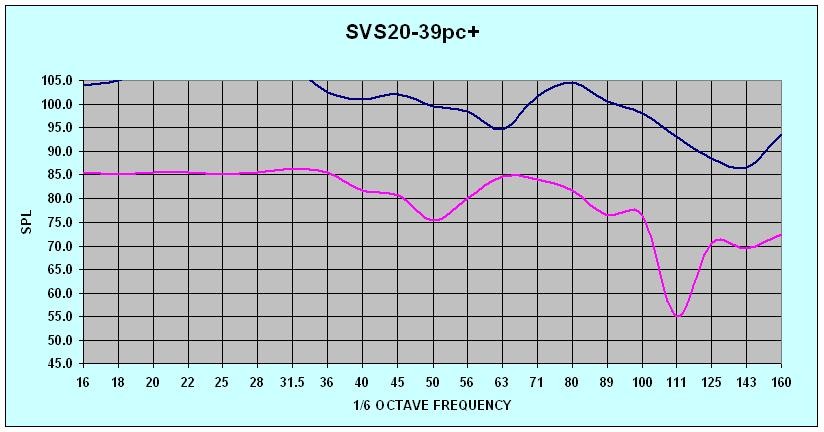

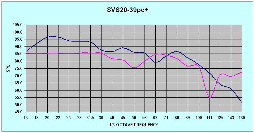

                  Finally got around to taking some test tone measurements.The setup is as follows,dvd player set to all speakers large sub yes,digital output on.Rotel 1066, all speakers large sub yes,dvd input(DIG COAX,PCM STEREO MODE WITH SUB)Outlaw icbm doing all bass management i think mains set to 60 x-over and all other speakers to 80 x-over.See attached spreadsheet,P.S.started with the 208 test tone at 80 db.Dark blue line is current sweep,not sure what pink line is?

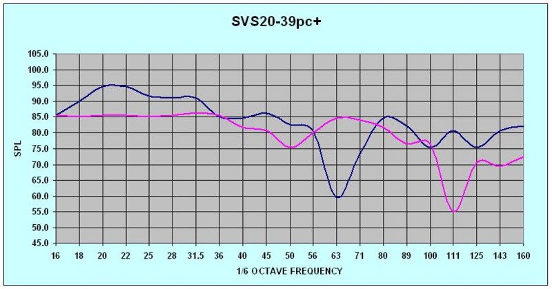

                    On the second test sheet everything is the same except i turned the digital output off in the dvd player and the rotel input to stereo input with sub.I started with the 208htz tone at 80 db,man the volume went sky high on the graph and off the graph!!!!!!! 8O 8O 8O Did i do something wrong here?All i did was to use the analog out of the dvd player instead of the digital out.

                      Hey Todd... you might try using the first frequency tone of 16hz and set your level at 70-75db... then work from there instead of a 280hz tone. You will only be measuring frequencies from 16-160hz anyway.
                      Disconnect your mains and surrounds to start with and measure only the sub. If you are setting your level using a 280hz tone then it's coming from your mains and not your sub. Your first goal is to get your sub only smoothed out... then later you can measure your subs + mains and see how they interact with each other.
                      The blue line will be your initial (non-adjusted or no BFD used) measurements. Once you get a BFD then the magenta line will be your adjusted measurements (with the BFD filters).
                      A BFD will probably help you but you really need to see the line with the sub only measured first. Changing your crossover frequency from 60hz to 70-80hz might help with the dip at 63hz. You can try it and see.
                        Not sure about the second plot, obviously the output is higher with the analog inputs.
                        The huge dip at 63Hz in the first plot is a room null. Try moving the sub and or move the mic and see how the plot changes.
                        You will need a Behringer DSP1124P if the null doesn't go away when you reposition the sub.

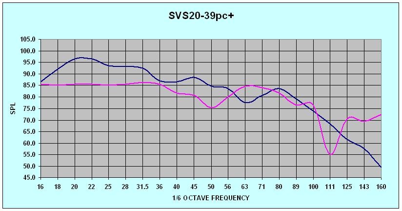

                              Here's the latest graph's with the sub only,first sheet is with the icbm set at 60 x-over for the mains,80 all other speakers.Rotel 1066 set to two channel direct with sub on.The second graph i changed the mains crossover to 80 at the icbm.What do you think.......................I tried all the different phase settings on the sub(0-180) didnt make any difference really.The graph looks alot smother with the sub only.

                                Those really don't look that bad although if it were me I'd still want a BFD to slope it a little more gently. You are not too far from having a pretty good house curve.
                                How does it sound? If you like it then you might leave it alone. Or for a very small investment you can pick up a BFD... flatten out the response and hear if you like the difference.
                                It's looks like it's a little heavy from 20hz to 31hz but you might like it that way.
                                I noticed the the previous dip you had at 63hz is not as bad. Did you move the sub? I also noticed changing the x-over point to 80hz only bumped up the dip at 63hz by a few db's.
                                With a BFD you should be able to bring down that area from 20-31hz... bump up the 63hz... and knock down the peak at 80hz. You'd be fairly flat up to 36hz or so then gradually slope down 5-8db all the way out to about 100hz or so. I'd also bump up that dip at 111hz as much as I could for LFE. I don't how much you can get it up but maybe enough to make a difference. I'm not sure how much info you'd be missing anyway in that area... probably not much.

                                  Thanks for the info sonny,no i didnt move the sub,that dip really only showed up tremendously when i was leaving the mains play when running the tones.Should i run tones on the mains?Or isnt the graph really for the mains and the sub run together.Please bear with me here still learning about this hometheater stuff.One other question, does this slope change when you add in multi channel music or change surround modes in the receiver?What i mean by this would be that the icbm would be getting more bass info from the other channels and feeding that to the sub so with that added bass info would it change the curve?I guess you could run the tones on prologic or someother mode and just leave the amps off to see if it changes any.I guess i am happy with the sound right now but it seems to lack something.I like to really feel and hear bass,not bloated but good clean bass,and with the system located in the basement on a carpeted concrete floor with a low tile ceiling,its kinda hard to feel and hear the bass this way until you jack the sub volume up and then it starts to get chesty,all most bloated.

                                    I suspect the previous dip you had at 63hz was from frequencies canceling each other out. Your mains x-over was at 60hz so it's quite possible this could have been happening between your mains and sub. If you have changed your x-over frequency to 80hz you should notice this eliminated when you do your mains+sub measurements again. Then again you might have a problem at 80hz... but maybe not... room boundaries effect different frequencies in different ways too.
