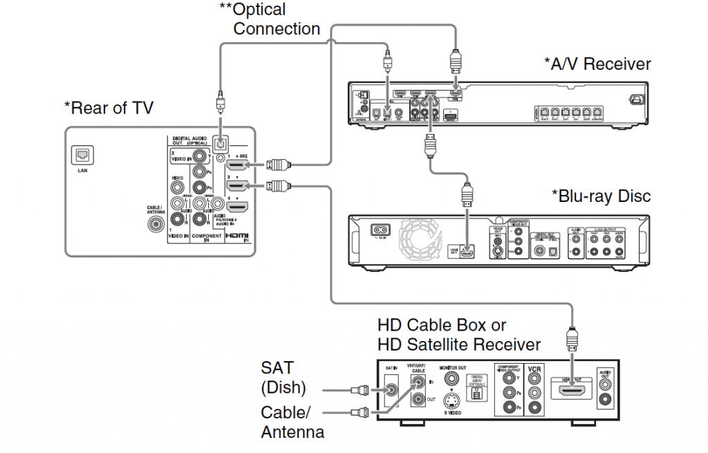

    Hello - looking for some help. I finally after many years have gotten around to trying to rewire my system so I am getting full use of my receiver and getting sound out of my TV through my surround system in full. I have my TV working, but now my Bluray player will give me either audio or video, but not both. I will detail my existing setup and hope someone can spot what is wrong.
    Equipment:
    Receiver - Sony STRDG800; Bluray Sony BDP-S590/BX59; TV Sony Bravia KDL-46EX621, Cable-box FIOS Motorola QIP7232-2
Name:	Screenshot 2014-01-05 22.27.18.jpg
ID:	871284Click image for larger version
Name:	Screenshot 2014-01-05 22.27.46.png
ID:	871285Click image for larger version
Name:	Screenshot 2014-01-05 22.28.36.jpg
    From Cable box I have HDMI to TV/SAT in on receiver
    From Bluray I have HDMI to DVD In on receiver; and optical digital to Video 1 on receiver
    From receiver I have HDMI Monitor Out to HDMI1 on TV; and optical digital audio to Optical In on TV.
    So set to TV/SAT on receiver I have audio and video from Cable
    When I switch to DVD, I get video from Bluray with no audio; if I switch to Video1 on receiver I get Bluray audio but no video.

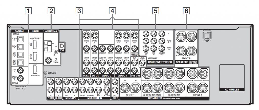

      Looks like that receiver only has HDMI pass-through. No audio can be decoded from the signal.
      You need to go into the receiver setup menu and change AUDIO,5 AUDIO SET, DIGITAL ASSIGN: VIDEO 1-VIDEO 1 to VIDEO 1-DVD.
      Alternatively you can hook up a coaxial cable from the BDP to the DVD coaxial input of the receiver, this would work without changing any settings.

                Actually according to the manual, it will not do any audio over HDMI. You have to assign a digital to input to a corresponding HDMI, or assign the HDMI to a corresponding digital input. He will need a digital cable paired with the HDMI.

                    Oh ok just looked and it has an internal hdmi switch basically. so yeah no audio.

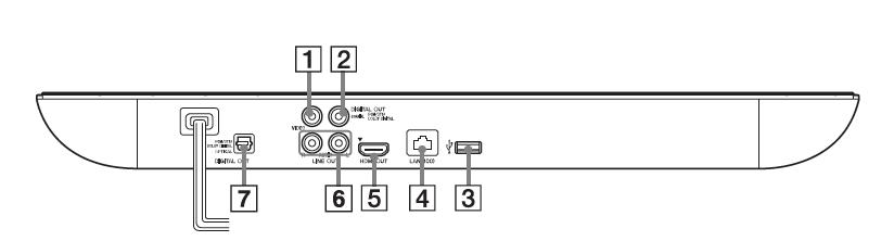

                              Unfortunately, the pic he posted is a generic bluray. The 590 does not have multi-channel outputs.

                                  Thanks for the various replies. I have to admit some of it went right over my head when you started using acronyms that I am not familiar with. As to the images I used, I took them from the manuals of the device themselves - so if the manual uses generic diagrams then my apologies. I did have a digital optical cable and that seems to be working. I'm sure the various other suggested hookups would work as well, but for my purposes everything is now working and when I use the TV I now have the surround working which for years I didn't, and I didn't have to spend any extra money on upgraded equipment, so I am content. Thanks again.
