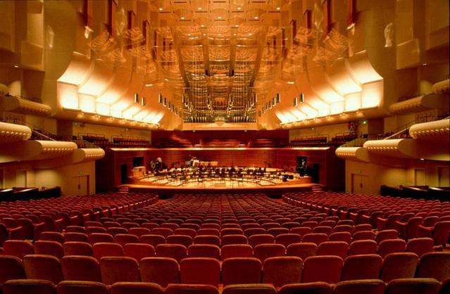

                  When was the last time that you found a concert hall with carpet!!!!:B

                    It's not the same, concert halls do not play recorded music.

                      And even at that, concert halls have room treatments up the gazoo.

                        Well, if I could get all my favorite artists and Hollywood stars to come perform for me in person, (like a concert hall) then I wouldn't mind hardwood floors in my theater.
                        Otherwise, I'm sticking with carpet.
                          I never said no room treatment I am just talking about floors that's all. :T
