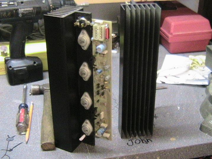

    The main reason for the dismantle is that this amp is a forced cool unit , and I can't just turn off the fan and let all the parts cook.So, I'll reassemble with the heatsinks on the outside which will be fine.The heat sinks are huge..pics to come tonight!

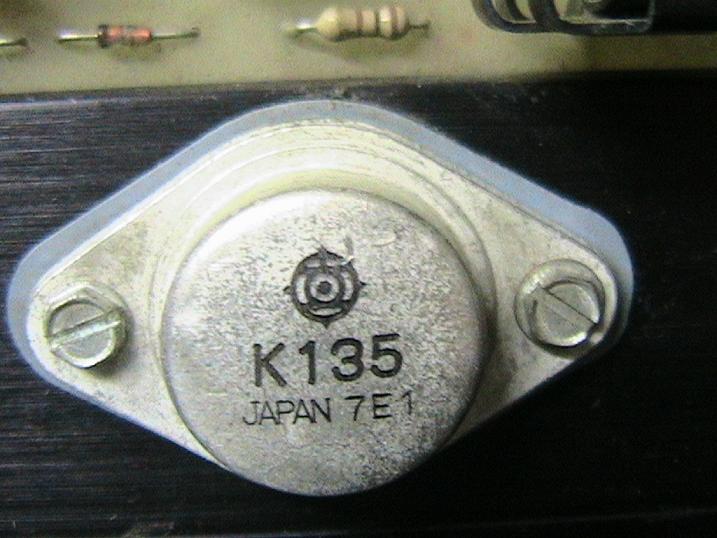

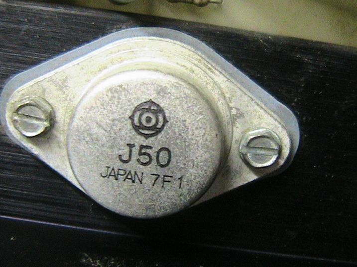

    Here are some pics of the output transisters.

                  There are two heat sinks per amp.They are 12" tall.I like the vertical orientation.There will be three per side.
                  Fans would be too easy .I'm not real worried about the heat.I ran the amp with the fan turned off for about three hours and they were hot to the touch, but not that hot.If I mounted them to the side out in the air of the room they'll be fine.
