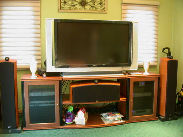

    I had an HTM1 on the bottom shelf of an entertainment center. Basically, it was on the floor. It worked well enough. This spring I reconfigured the EC and moved the center up a bit. This would be similar to placing the HTM1 on a stand. See attached picture. This made a noticeable improvement in the center channel's performance. I have N804's for LR. The drivers of the HTM1 are identical. Getting the drivers closer in height to the 804's made a real difference.
    I believe three identical floorstanding speakers would be even better, and awesome for HT. Aesthetically, If I could get away with it, I would.
    Hope this helps.
      • 1540
      Nice! Salamander racks too!

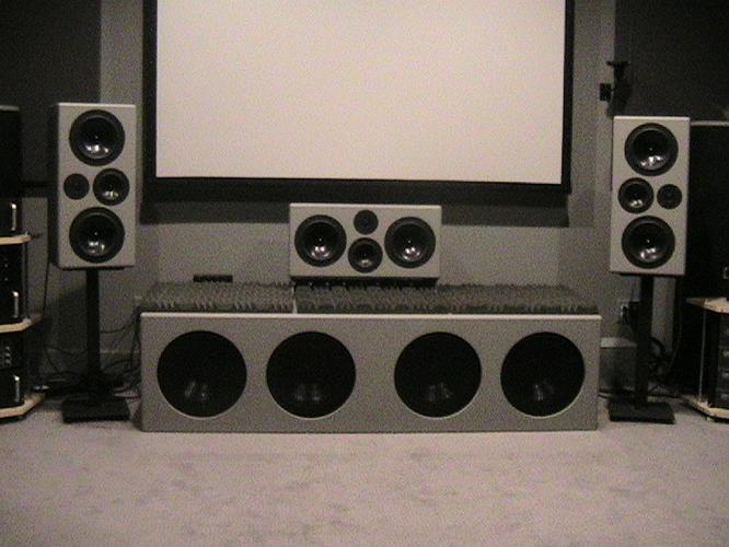

            What seems to be a must is the orientation of the tweeter and mid.Thats why a threeway center works so well.The tweeter is above the mid by design.
            So, back to your OP.Three identical mains would work great.I built three RS centers for my mains and they sound fantastic.For 400.00 each, including someone else building my cabinets for me, they are a steal.

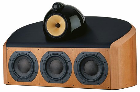

              That's what makes the HTM1D such an attractive choice, you get the same thing as the 802D but sideway's, ( basically), debating on that or the HTM2D as my next move
                        upgradeitis still not cured
                        Kurt
                        NO KIDDING! Man if I could justify that center...... ;x(
                        Not only that, but 3 woofers, the thing weighs more then the 802s!!!!
                        I keep looking for that tree that grows money....
                        Something about a 205 lb Center channel..... :E
                            Continuing in the spirit of this thread , it's close, but the baffles between the mains and center are different.

                              In the spirit of the forum, I have decided to build some over due speaker stands for my mains so they are tall enough.In the mean time I am using my old paradigms to get them up in the air and back on their sides with the proper orientation.After rewiring my equipment racks I now have more room to play with.
                              KG
