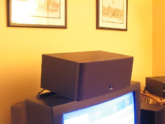

    Centre channel mount...
    My centre channel speakers sits atop my TV and I think there must be a better way for mounting it. I don't think this is the best place for the speaker to be mounted. Is a shelf coming off the wall the best way to create a stable and isolated platform for the speaker or is there a way I could give the speaker a good platform atop the TV.
    Anyone have a design or an idea for this mounting dilema?

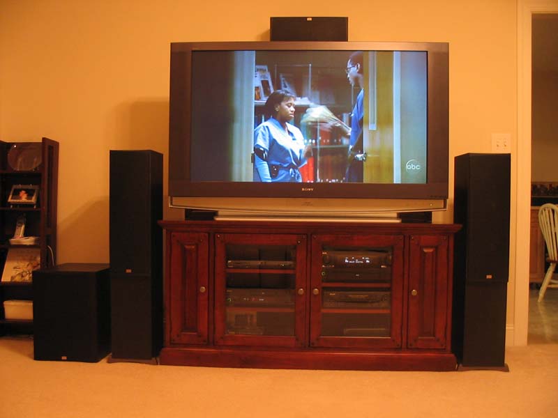

        • Shane Martin
          • 2852
          The problem with Snaps setup would be that the firing area of your tweeter is too high. You want to properly angle your center speaker towards the listening position for the best results.

              I agree with Shane the speaker needs to be tilted towards the listening area. A couple other things:
              The speaker should be flush with, if not in front of, the display and it should also be far enough away from the rear wall not to cause boundary issues (especially if it has rear firing ports!). Also try not to have it sit inside a cabinet surround.

                • Shane Martin
                  • 2852
                  The Lowes shelf puts it too far back IMHO.

                    I have experimented with set top placement and found it just not acceptable aesthetically. For me, any AV furniture must be able to accommodate the center channel speaker under the TV. My center channel aims upward slightly, which makes a shelf under the TV the perfect location.
                    My old and current setups:

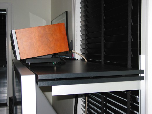

                    • Anton
                      • Oct 2004
                      • 75
                      I would kill to have my centre channel mounted on a dedicated shelf under my tv, them I could isolate it with spikes or the like. But the fact is that my whole lounge room is small and the area under the tv is obscured by the coffe table, bummer.
                      I've spent so much time positioning, re-positioning, leveling, toeing in, isolating and using alchemy to get my left and right mains the way I like them, and my poor centre is sitting in the worst possible spot atop a big plastic box.
                      I think that the pic attached explains the set-up I would prefer the most, sleek and simple, and I can isolate the centre channel with spiked feet.
                      Any thoughts?
                      Canadian heart, Aussie home!
                        • 8938
                        Anton, THAT's the idea. :T For an above-mount you want to separate the speaker from the shelf/TV cabinet and then angle it so that it's pointing directly at ear-height at the listening position. That way, you minimize interaction with the TV cabinetry which can add boominess or cause the sound to be muddy.
