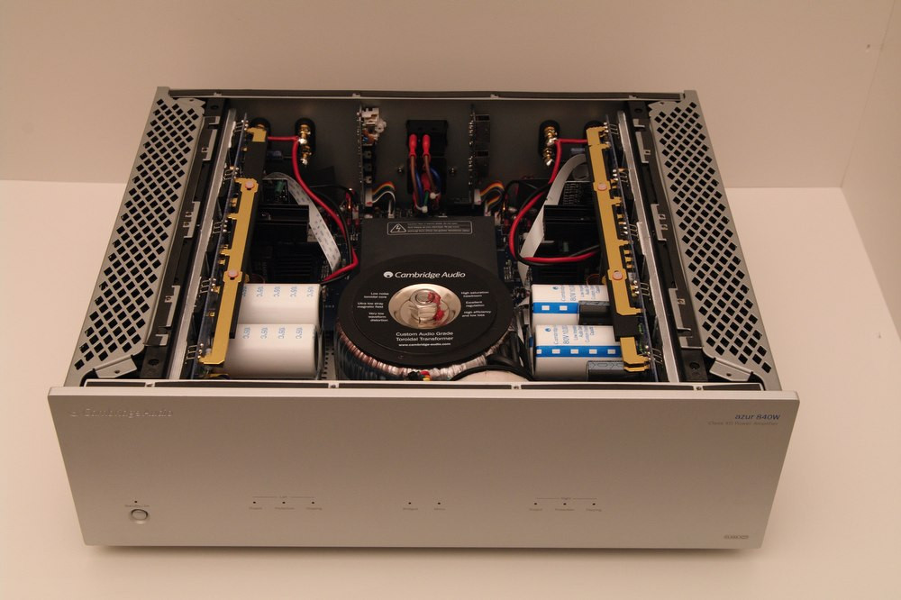

    In a past existence, prior to my metamorphosis to state most know me now it, I was involved in high power audio design, including consulting at times for professional audio and high end audio applications. This is not a very difficult endeavor, as familiarity with the high power RF turbo injector circuits used in the typical pod racer give one a substantial background in elementary physics and advanced electronics, if you survive the experience.
    Of course, the modern way being what it is, the interesting details are usually hidden out of sight... necessitating a small effort at dis-assembly.
    In this case, removing the top chassis cover is sufficient to inspect the interesting technological aspects.

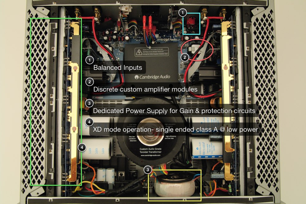

    But since the majority of you won't know what you're looking at, I will add some labels and commentary to "enhance" your experience- if you are not Force sensitive to technology configurations, these explanations will have to suffice.
    XD mode operation bears some explanation, but if you are not familiar with most of the standard amplifier linear biasing techniques, the details may confuse you. The important point is that the biasing system operates the output stage in single ended Class A in the lower power area, and shifts the crossover point to a much higher signal level for Class AB operation. While Cambridge reportedly have a patent on this concept, perhaps they should refrain from claiming exclusivity, as the XA seris high bias AB amplifiers from Pass Audio do the same thing. The intent is better purity of sound under typical lower level listening conditions, and high power with lower distortion than typical AB amplifiers- judging from the specifications and reviews, they may have achieved both.
    But apart from technical marketing, other interesting features abound- especially for those conversant with power electronics.

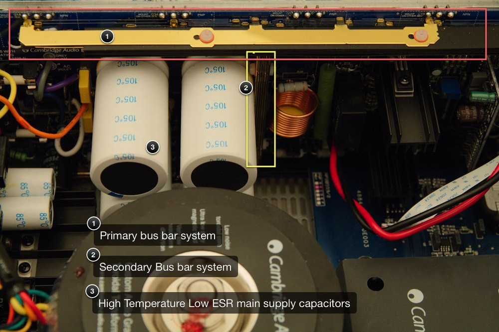

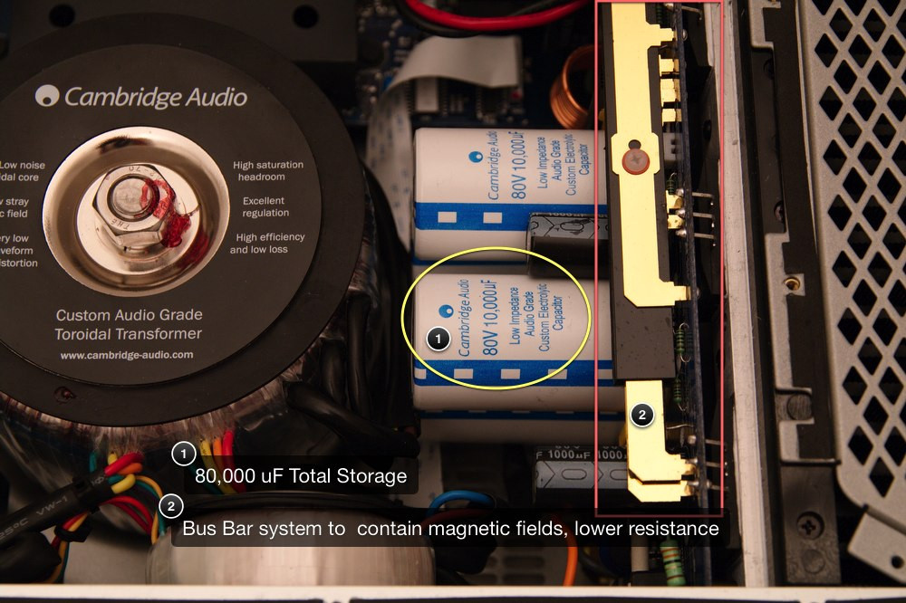

    Overall power storage is well above average and for it's weight and power class. And even more intriguing, a dedicated low resistance, low inductance (if configured correctly) power bus system is used.
    In fact, two bus bar systems are used, though the secondary one is not as easy to spot.

      Thanks Evil Twin, that's very interesting. I thought Pass had a patent on the type of variable bias technique he uses in his XA amps. I read in Stereophile recently that Panasonic had a patent on variable current biasing of the output stage. So, Pass got around it by biasing at high current but varying the supply voltage to reduce power dissapation at low output, or something like that.
      Maybe varying the crossover point on this is slightly different from what Pass does on his XA amps? I don't have a clue, just a thought. But, that would be more of a variable current biasing like Panasonic does.
      John unk:
        There is only a small variable element to the XD biasing, according to the Cambridge white paper. The biasing is single ended, at a power level, with a separate current source under active control, NOT a biasing of the main complementary transistor pairs. This allows setting up the main complementary pair at a class B bias potential resulting the lowest possible output stage crossover distortion- high bias AB such as Aragon and many others use can actually degrade the open loop output distortion- Douglas Self has a good description of this in his book, and I've verified it to my own satisfaction back in the mid 90's, when I was doing a lot of output stage development work for other parties.
        Obviously, in some regards, features must be different between what Pass Labs does and Cambridge does that they aren't stepping on each others toes, at least not blatantly.

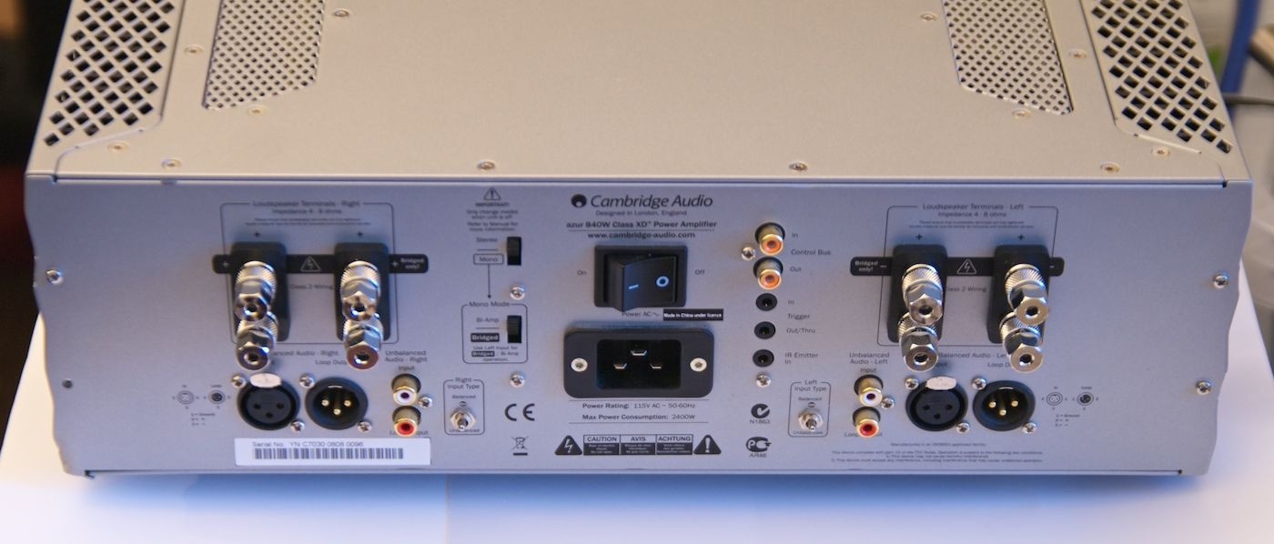

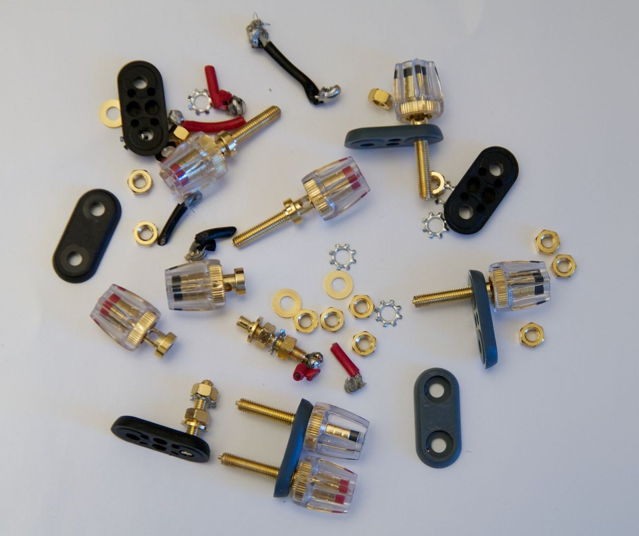

          Well, the Cambridge Audio 840W has also generated some annoying disturbance in the dark side - the binding posts look fairly decent from the outside, but they're not well constructed. At first I thought they just weren't installed properly, that they didn't have double nuts or lock washers, because they were becoming loose and wiggling around! Quite a bit, in fact, enough to fear having shorts from the posts to the internal chassis!
          Well, that turned out not to be the case...
          More about this shortly, and the fix for it.
            • 16178
            Very annoying, but fixed!
            Well, in the spirit of a picture is worth a thousand words, plus or minus, here's a relevant picture- all the binding posts removed from the Cambridge Audio 840w.
            Note, while taking these out, a couple of the binding posts literally came apart, because what looks like a long continuous piece is actually two pieces pressed together- you can see one red and one black binding post, and the separate rear part of the post which is pressed into it. Basically, with slight mechanical stress, they start to separate, and the tightening of the nuts and lock nuts has no effect on keeping it together- actually makes it worse by increasing the tension to pull the two parts apart.

            Well, this just won't do, of course, so being the sort of guy that I am I reached into my parts draw and pulled out a bunch of Cardas Rhodium plated solid machined binding posts, and installed them in the 840w.

            Lucky for me the panel mount holes exactly matched what the Cardas need, both in diameter and spacing, so it was a soft of easy refit, apart from puling the top and back off the amp!
