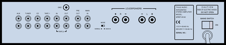

    How can I connect a subwoofer to an stereo integrated amplifier and also my pair of B&Ws?

    If your sub supports it you can run speaker-level connections, ie. run the L/R speaker cables to the sub's speaker inputs and then run on to the speakers from the sub's speaker outs. Then set the high- and low-pass filters on the sub to suit your listening preferences.

      Based on the diagram, you could also run a line level connection from the "pre-out" section.

          And how do you control the volumen of the loudspeaker and the sub? Both from the amp?
          • dyazdani
            • 7032
            You'd set the level on the sub itself to "balance" with the mains. I'd set it up at normal listening level to do this. Then you'd control the main volume from the integrated amp.
