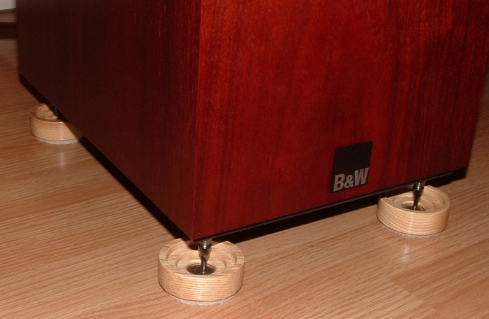

    I have my speakers (B&W 703) on spikes that stand on dimes that are in hardwood coasters with adhesive floor savers under them (what you would stick under your chair or table feet). I did this because I wanted to use the spikes, but I have a hard floor instead of a carpet. I think the sound is better than with the rubber feet, and a lot better than the speakers right on the floor without nothing. I guess that there is less vibration going into the floor, so a cleaner sound. Again, someone has said that this is not true (that you need damping to do so)
    I might add a photo of my speaker "feet" later on...

                                                                  Here is a picture of the support for my B&W speakers, wooden horizontal feet with adjustable height screws. They provide isolation from the hard floor to avoid parasitic sounds, and a firm support, and a slight angle backwards. I believe they improved the sound substantially from the standard rubber feet.
                                                                  • jim777
                                                                    • 831
                                                                    csuzor, what about sticking some "feltak" floor savers under your wood pieces? I'm not sure that the hard wood on a hard floor doesn't vibrate.
                                                                    Here is a photo of my setup with those "feltak" things under them.
