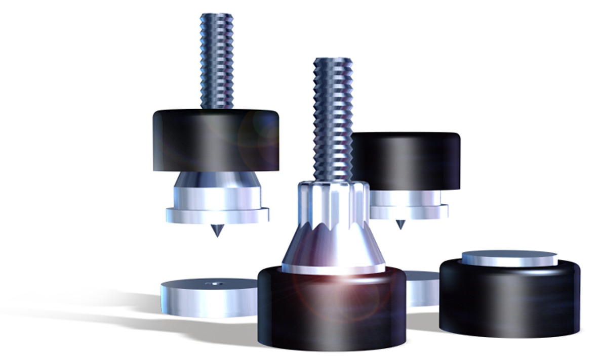

        Start lifting weights. Those little floor plates/pads have never been an issue for me.
        More options and larger pads: https://myesound.com/Points_n_pads.html
