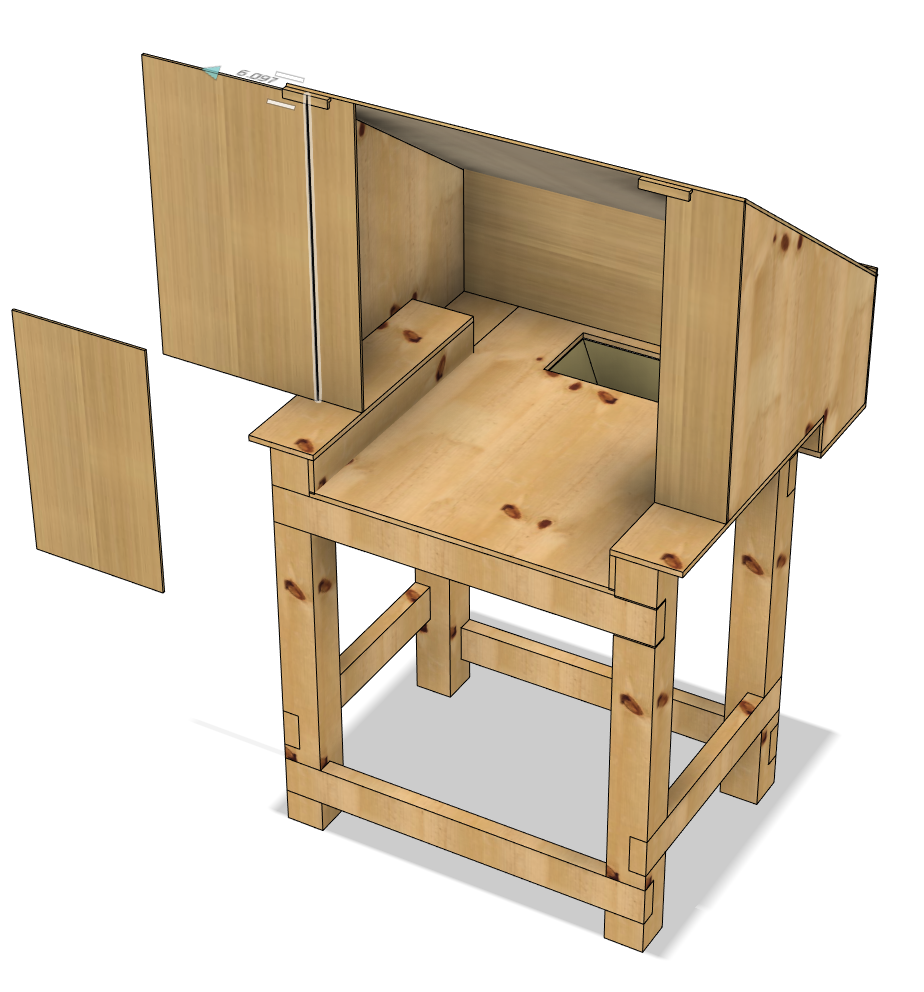

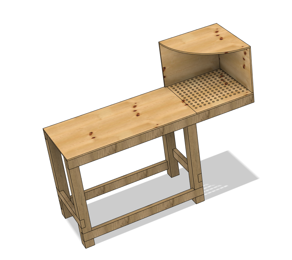

    One thing I have read is most of these non-industrial systems are designed to move air, but not at high suction. They are meant for tools that are hooded or have some capture path and the dust collector clears that path. They are not really meant for low flow, high suction that you would have on a handheld tool like a router or track saw. I use a either a Makita dust collector, or my Ridgid shopvac with HEPA filter for collection at the tool. For the compound saw I built a cabinet and the Oneida is hooked to the cabinet while my Makita is hooked to the saw itself. For the router I built a shrouded work table and the Oneida is connected to a cavity below the work surface and the Makita to the router. Oneida now makes a SuperCell that may perform both tasks (high flow and high suction) well, but I don't know much about it.
    Click image for larger version  Name:	saw cabinet.png Views:	0 Size:	536.4 KB ID:	950571 Click image for larger version  Name:	router bench.png Views:	0 Size:	386.3 KB ID:	950572
