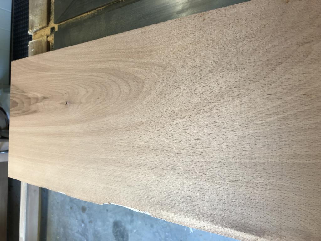

      There have been some time with very little progress, so not mutch to write about.
      But now I have finally got some stuff done.

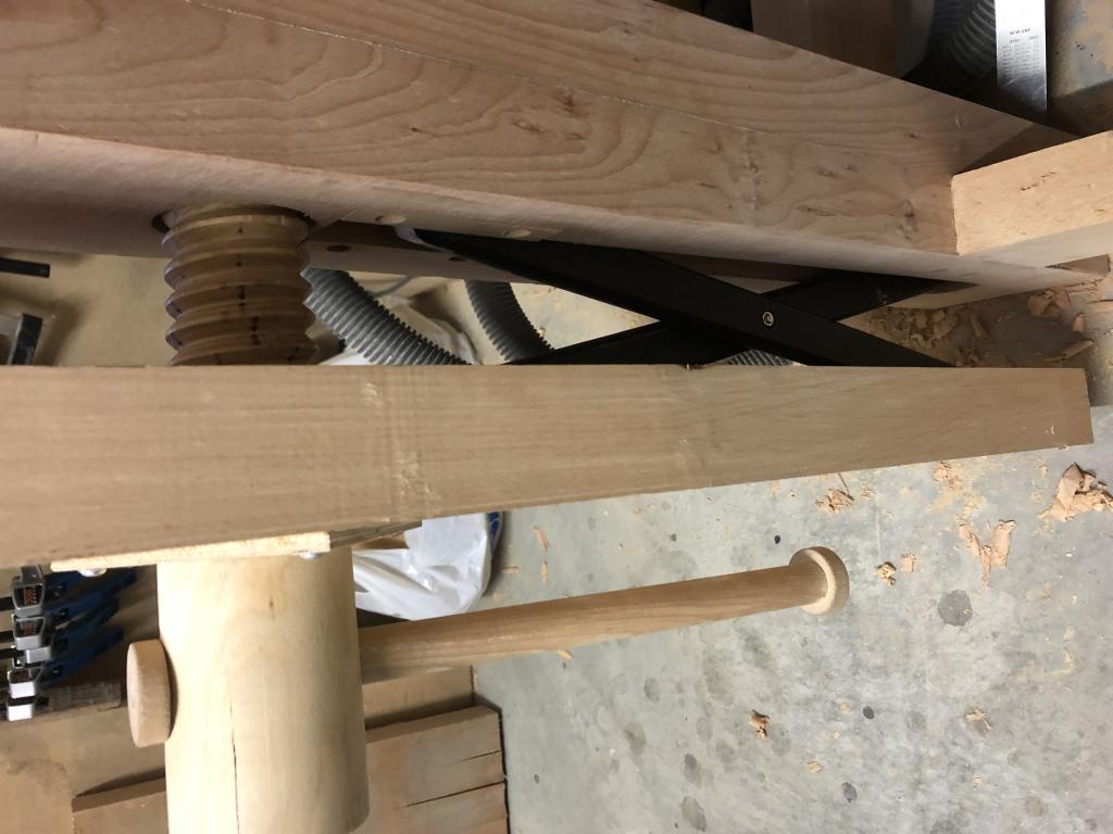

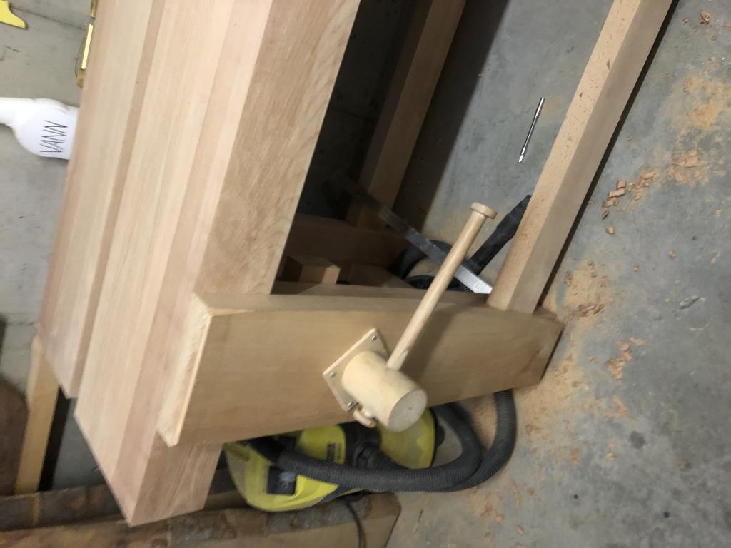

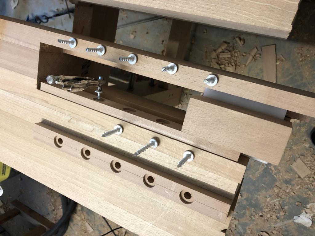

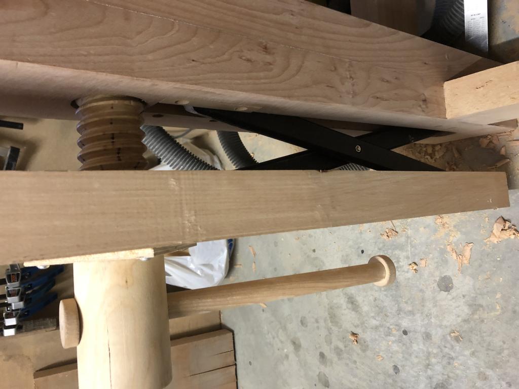

      I have started on the wagon vice. I’m following mostly the same design that Lake Erie uses in their kids.
      (https://www.lakeerietoolworks.com/co...se-premium-kit)
ID:	864391Click image for larger version
ID:	864390Click image for larger version
ID:	864389Click image for larger version
ID:	864388Click image for larger version
      To insert the screws was a bit challengin as there was very little room, and I did not have a suitable tool, but I managed to figure out a solution.
      Also, on the outside the wood was tonthin for the screws, so I had to first screw the screw in until I felt the tip on the other side. Then I cut the screw shorter and used it.

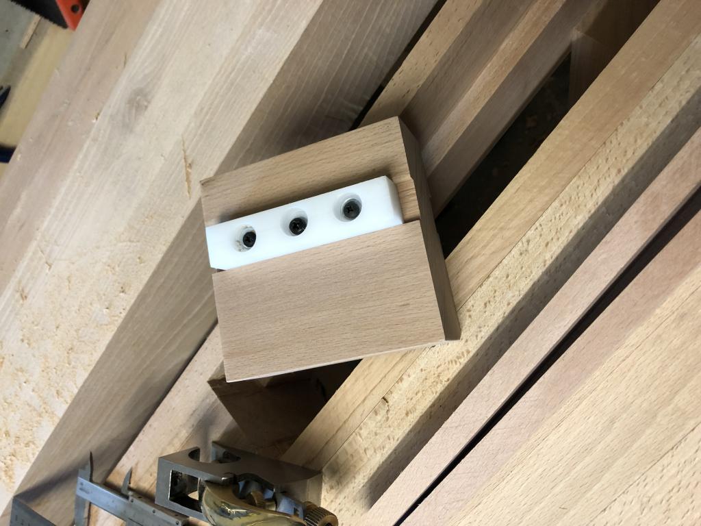

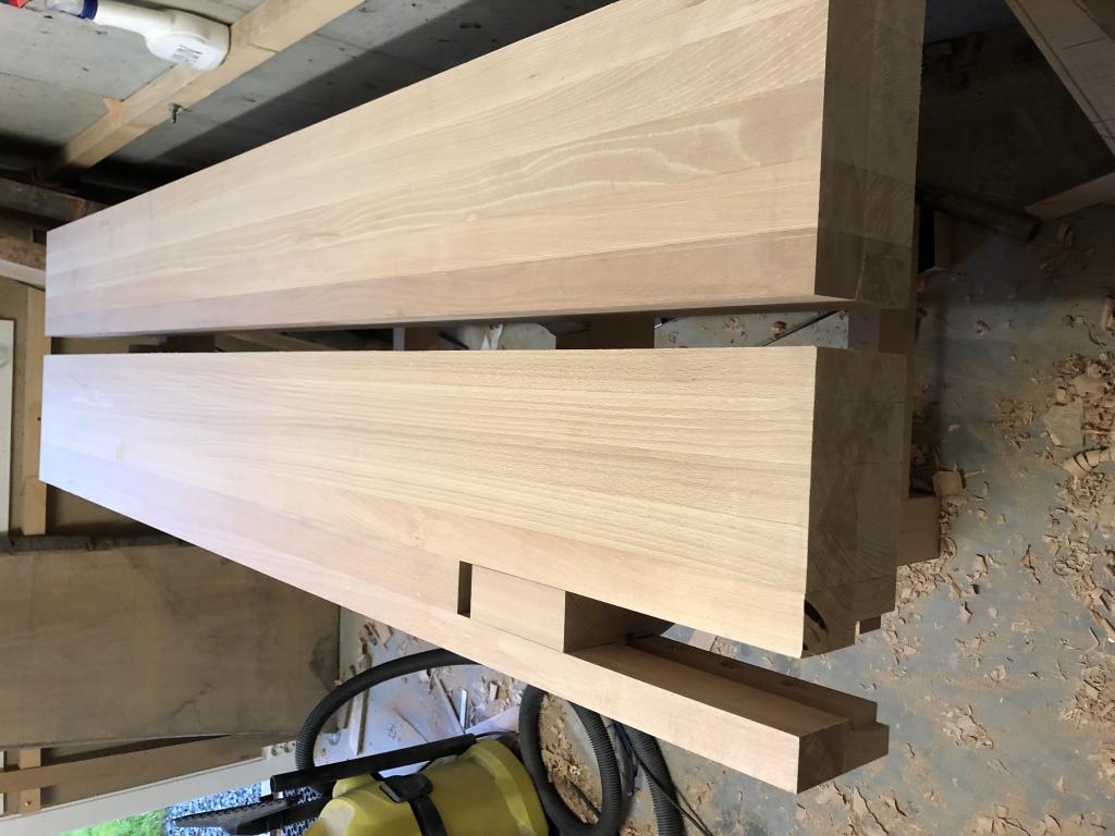

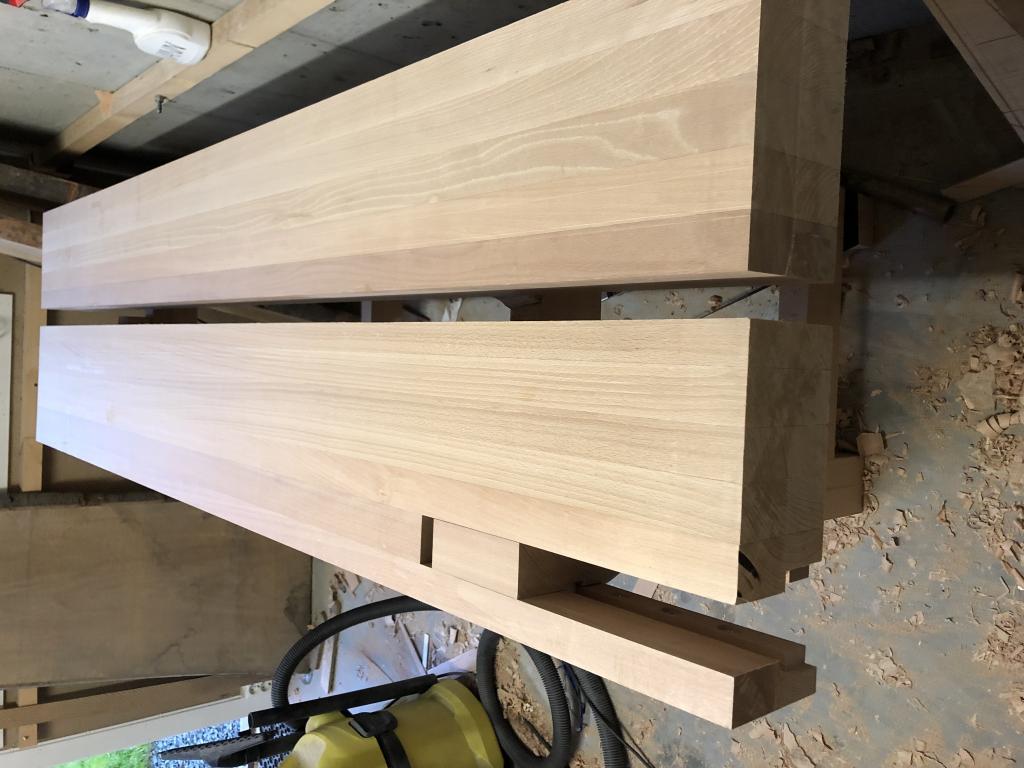

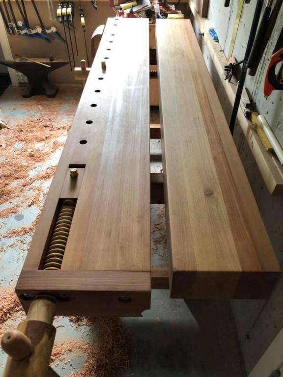

        And this is the top...
        Still not mounted down on the legs - thats next in line, right after making the track for the sliding deadman.

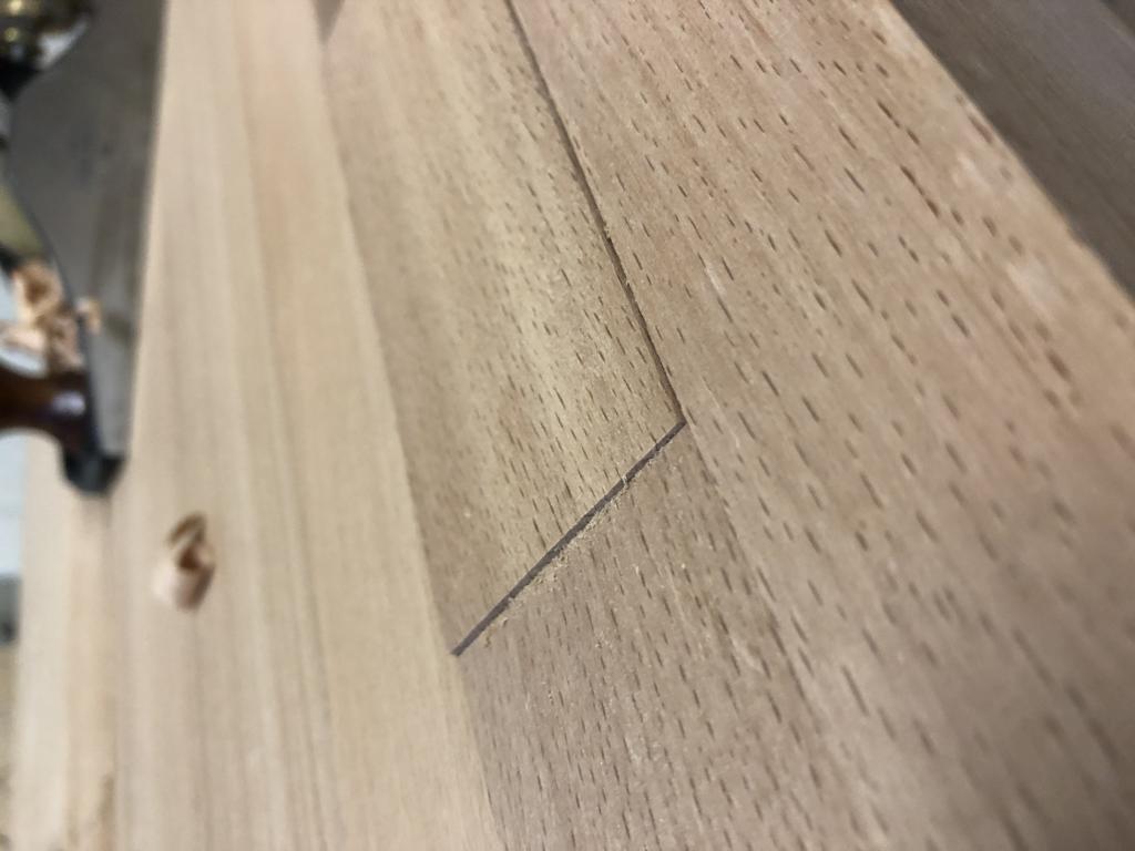

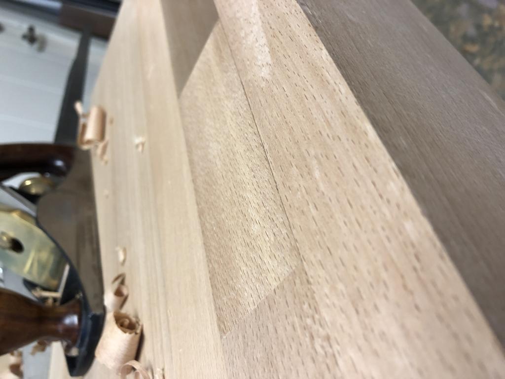

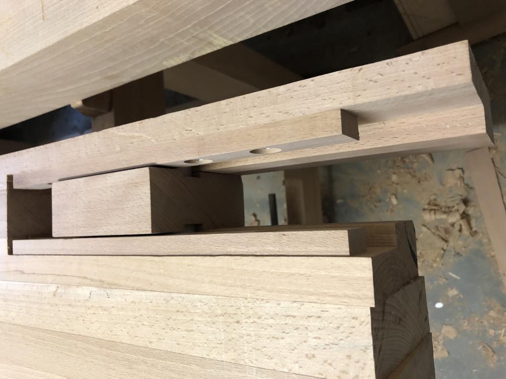

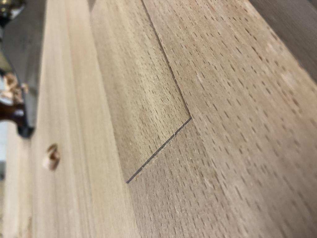

        Some details from the wagon install.
        I mounted the wagon so that it extruded a bit over the table, and then used the jointer hand plane to align it with the rest of the top. Worked very well!

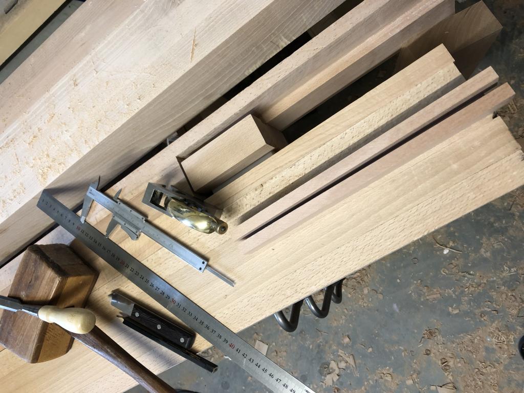

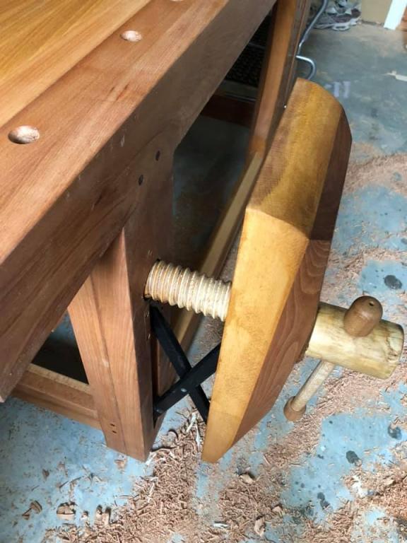

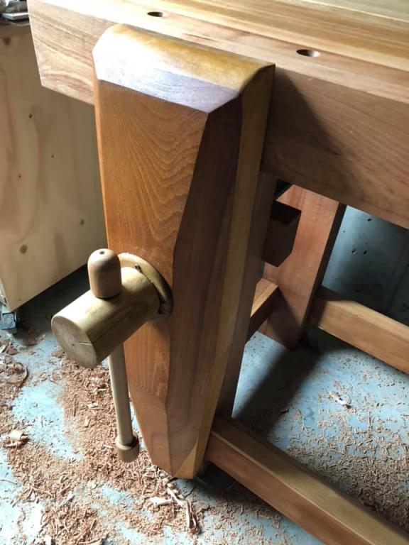

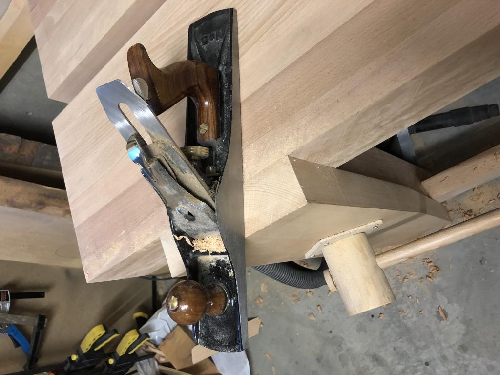

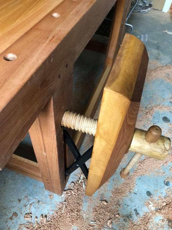

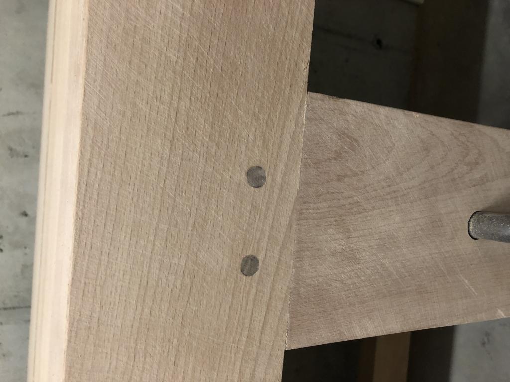

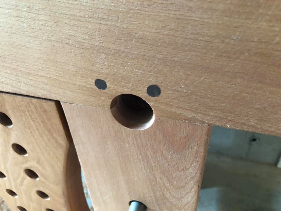

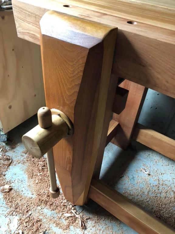

                OK, I have had some progress the last days.
                Updated todo list:
                - make track for the sliding deadman
                - mount the top to the stand
                - finish up all drawborn holes
                - make a bew stronger criss-cross for the leg-vice
                - mount the leg-vice
                - make screw and nut/endcap for the wagon vice
                - make endcap for the other half
                - make dog-holes
                - make sliding deadman
                - make dogs
                - make center divider/planing stop
                - make benchfast holes
                - make bottom-table (between the legs)
                - flatten bench top*
                - beef up the leg vice*
                - sand down and apply some finis
                * new task

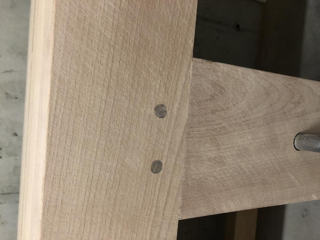

                Some progress:
                The new criss-cross is made from a 120cm
                long crowbar, and it is working very good!

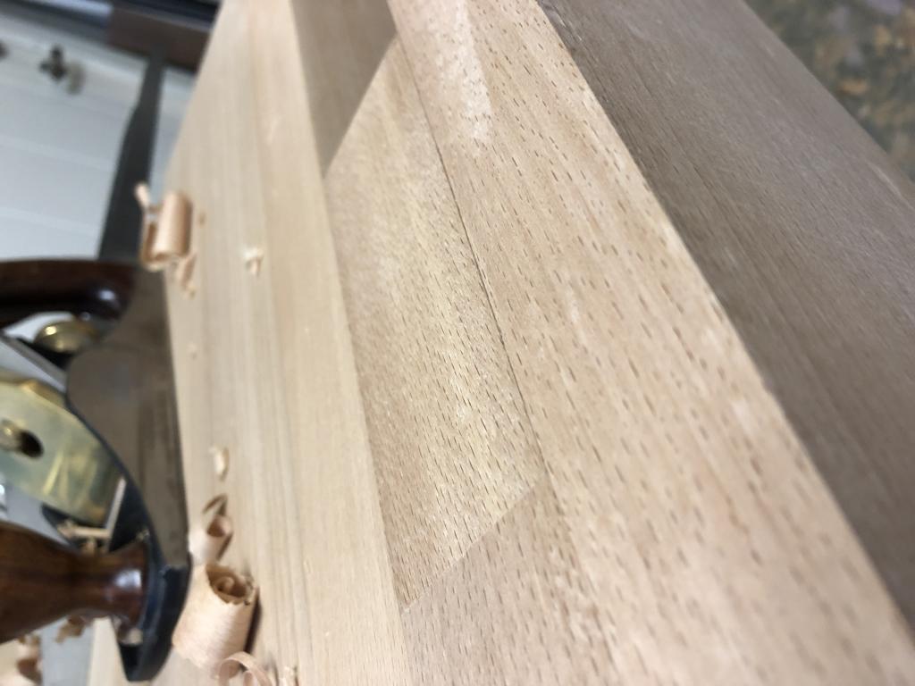

                  #188

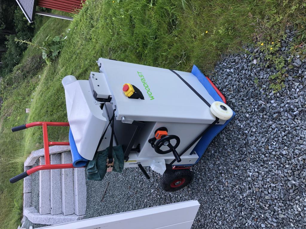

                  Extending the workshop with a new tool :-)
                  I envy those of you having your workshop at the same level as your driveway!
ID:	864423Click image for larger version
ID:	864424Click image for larger version
                  Looking pretty good straight out of the planer

                    You do like to buy the machines from far it seems. If I remember correct the table saw was from US and this one seems to be Australian
                    How wide is the cutter - seems 310 or even 410? A nice looking machine and result for sure.

                        The machine was actually got from Norway.
                        It's has 31cm planing capacity.
                        I did A LOT of research, but in the end I was unable to find a chinese supplier that could deliver at a lover price then one of the norwegian companies.
                        But it's hard to jugde. I tried to compare a lot of different machines, but the specs were the same, they looked the same - and the price was very different. And that was also in the local marked.
                        So, if I compared self import to the expensive norwegian ones - it was a lot to save. But if I compared to the machine I got, there was nothing to save.
                        Honestly - I have a hard time seeing what could be better on the more expensive machines.
                        My current guess is that the importer just is good at keeping the prices low, and that there are fewer middelmen.
                        For example, the more expensie norwegian suppliers required approx 150usd to get it from their location to my house. The supplier I selected only required approx 40usd.

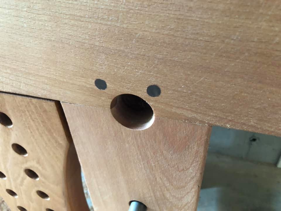

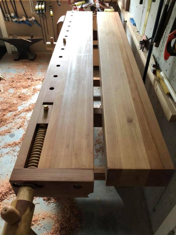

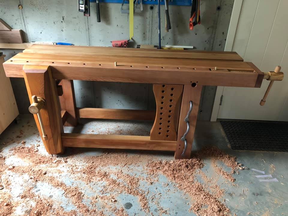

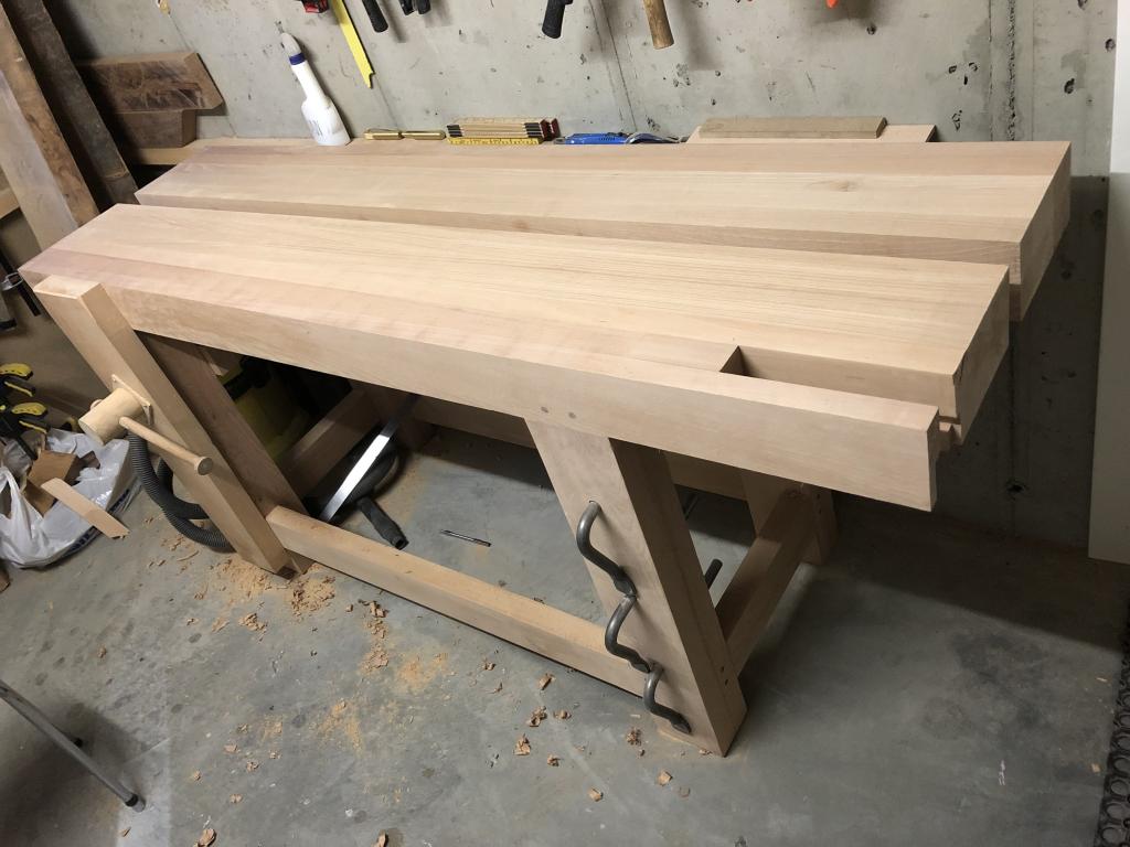

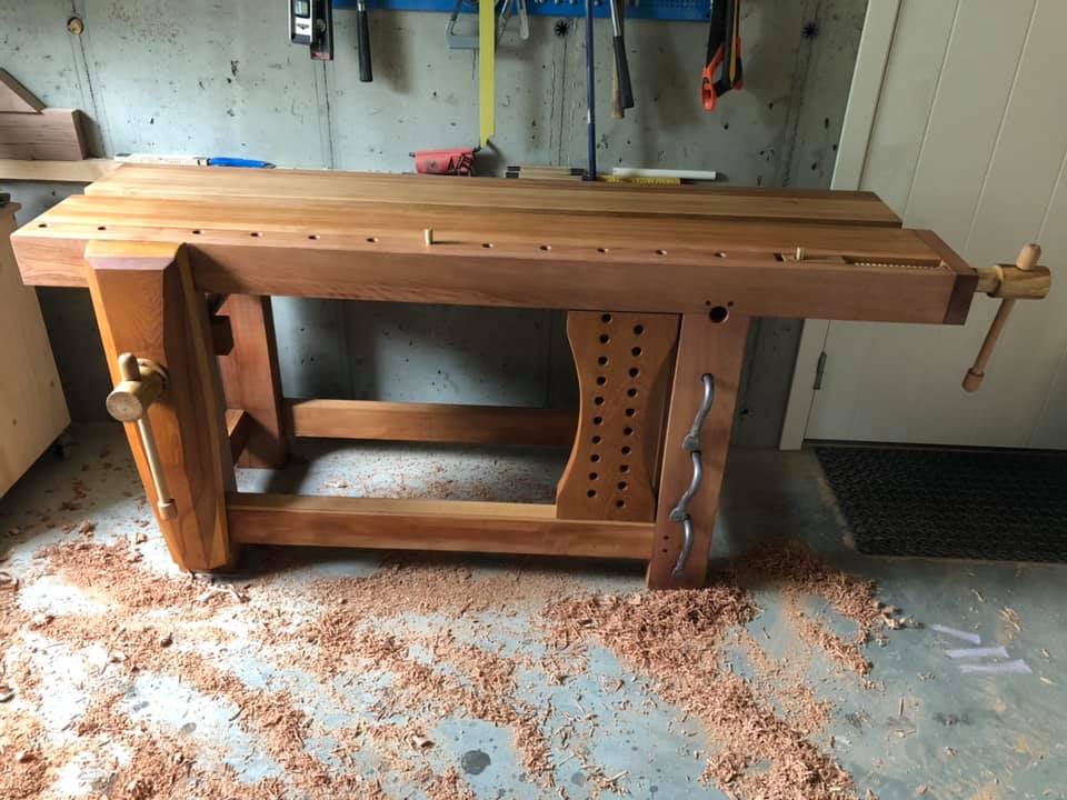

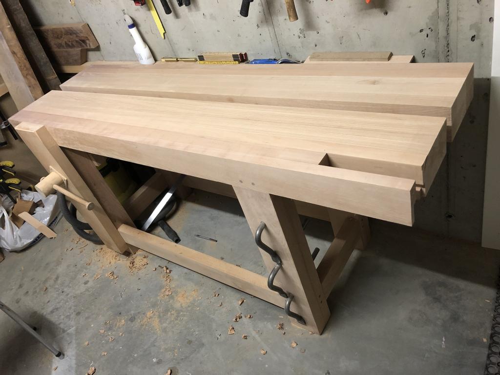

                          And the bench is completed (at least for now, I will be adding some feature in the future - but this will do as competed for now):

                                  #196
                                  TEK, I forgot to ask ..... is the saw dust on the floor just for the picture.
                                    #197
                                    He, he
                                    The saw dust is from shaping the leg vice - using an electrical planer as well as hand plane, orbital sander and regular sandpaper.
                                    I though it looked better than just the concrete floor with boiled limseed oil stains, so I left it there.
                                    But yes, it’s real saw dust from real work done on the bench. The leg vice was attached to the bench top with the wagon vice when working on it 8)
