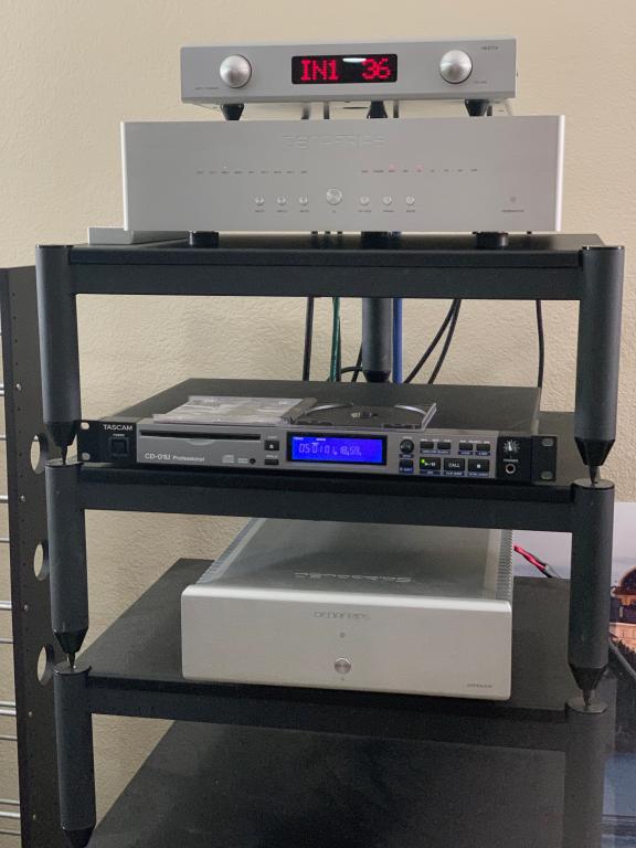

    I have have been itching to put the Hyperion on the bench, but I figured the way it's sort of pushed as a set with it's "matching" preamp I ought to get one of those to test, too. Specs are almost too good to believe, especially at the price. But that's almost become the norm for Denafrips.

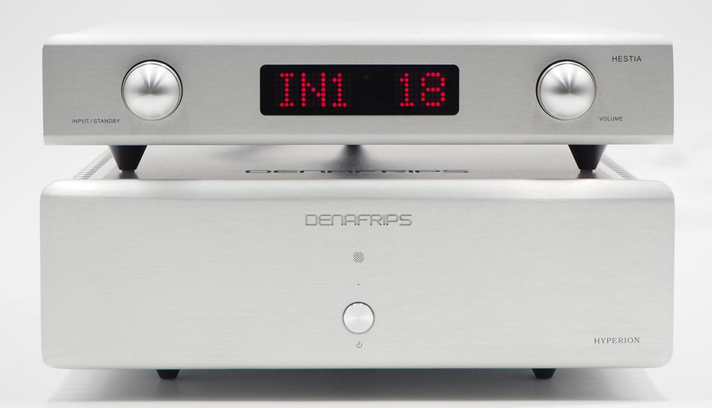

    So a silver sample of the Hestia was ordered early this week, quoted ship time is 5 days.
    This are smaller than they look; keep in mind the amp is just 80W per ch at 8 ohms. But with fully balanced operation and THD+N < 0.001, I have "Great Expectations" as Dickens would say...

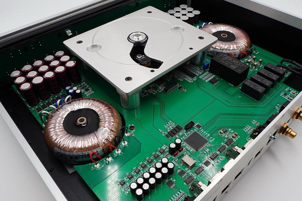

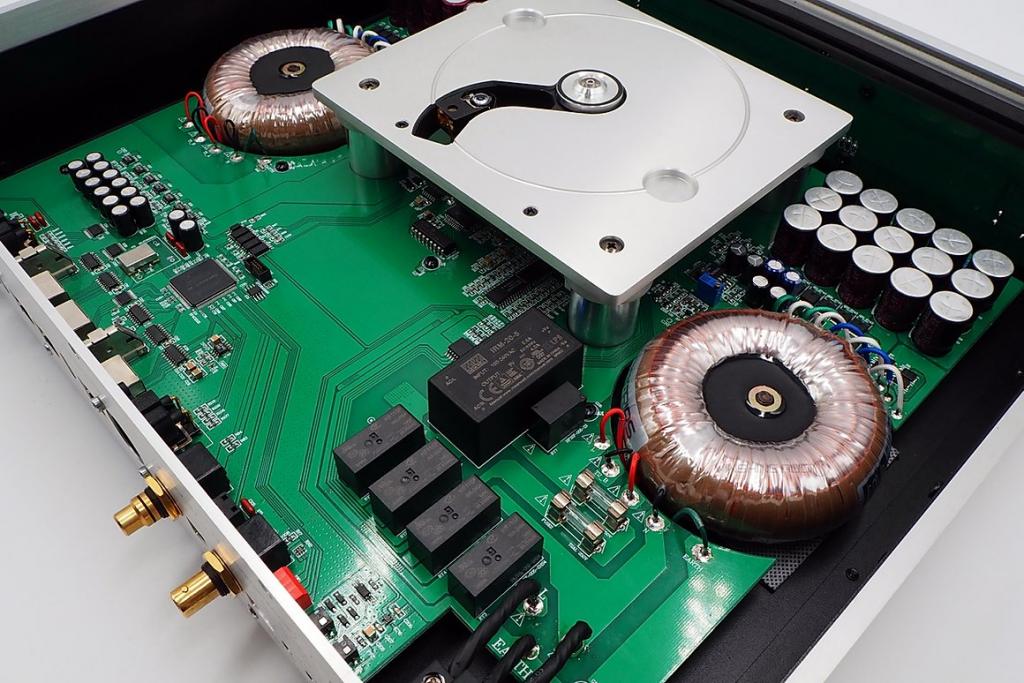

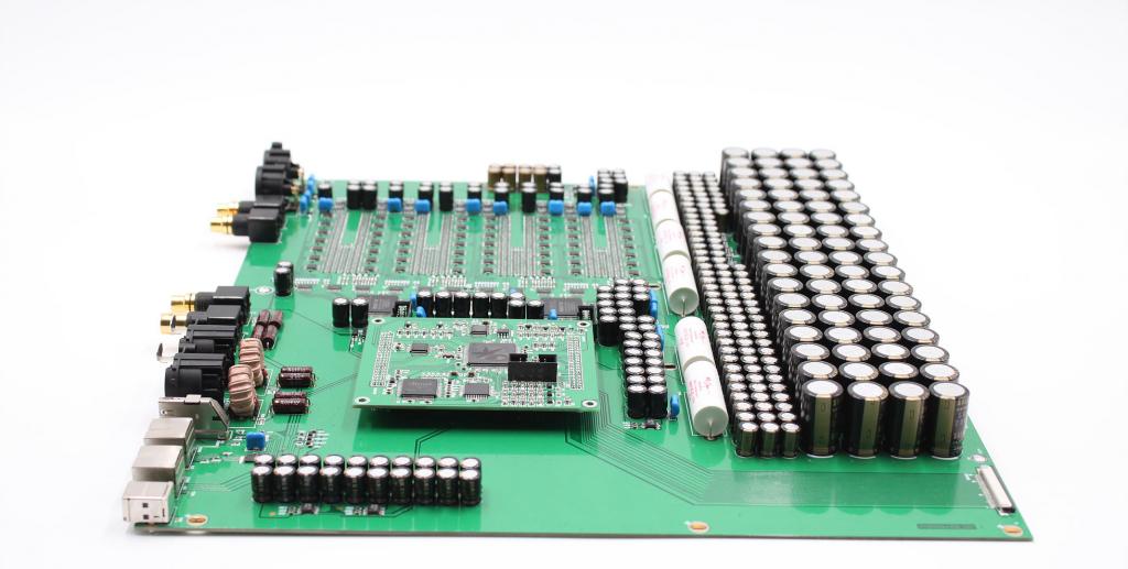

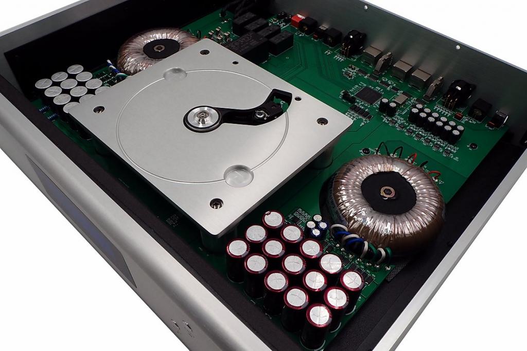

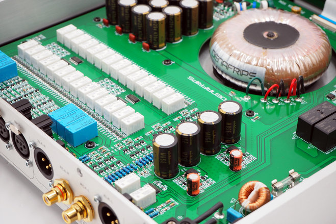

      Denifrips does have above average industrial design; but what really caught my eye was the interior design- much of that comes down to things that are actually electrical design choices (like using many multiples of small caps (because the net ESR and ESL are lower and the self resonant frequency much higher)- this continues with the new products.
      Terminator mainboard
        • 1578
        Those are real pretty Jon. Judging from the pictures, someone had a little OCD on this one. With the exception of maybe 3-4 caps in the middle, they look perfectly vertical.
          • 16205
          I did pop the cover off the Terminator I got shipped last year, and it looks good- very good.
          I do love the way it sounds- so far, one of the few units in the same ballpark roughly as my TotalDAC, and the only one under $10K you can say that about.

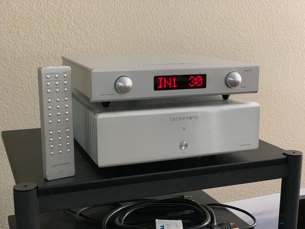

                DHL kept their word, delivered yesterday
                OF course, without pictures, it's not real on the Internet.
                One thing scary about the Hestia preamp- the remote makes my Halcro DM10 remote (*in storage in Idaho) feel cheap in comparison....
                • It's heavier, and clearly well made/machined from a solid billet of aluminum....
                • It works (the Halcro has been dead for a while and resisted attemps at resuscitation
                The preamp isn't all that big, but it weighs so much it almost feels like it's a solid block of aluminum, too.
                Scary if you're a conventional competitor- such as Auralic from Taiwan, as the Tarus Preamp might be one of the most similar competitors. See my test results for that unit in this forum. The Taurus Preamp has a bit nicer industrial design, but only has one set of balanced inputs, instead of two like the Hestia- something many reviewers of the Taurus wished for.
                Oh, and the Taurus is about 2X the price.
                Interesting.
                Time to put some hours on this, then put it on the bench and to some listening tests.
                  • 16205
                  Note also that the analog inputs are not arrayed as you might think from a casual glance at the back panel. The Hestia has very high channel separation specs, and that comes because the connectors are laid out with bilateral symmetry; so connecting to both Inputs 1 requires using the far left and far right XLRs...
                  but the results are quite promising...
                  The big thingie under the preamp is the DAC! all 50 lb worth!

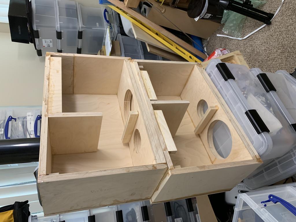

                          • 16205
                          Two different front panel configurations to test- one with the woofer toward the top. Getting the woofer in an MT system away from floor bounce is important. We'll see if this makes any worthwhile difference. I've got to model it in VituixCAD, too.
                          BTW, even though I paid for two licensed copies of VituixCAD back when Kimmo was selling it, I still donate to him now- he keeps updating regularly and adding useful features- a first class guy!

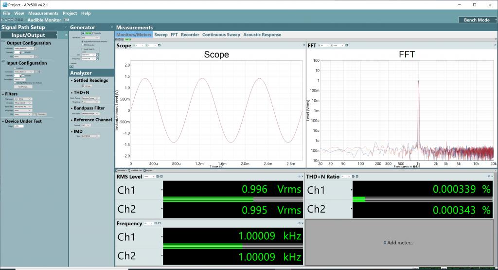

                            The factory specs are quite good- so I've been itching for a while to see how well they're realized.

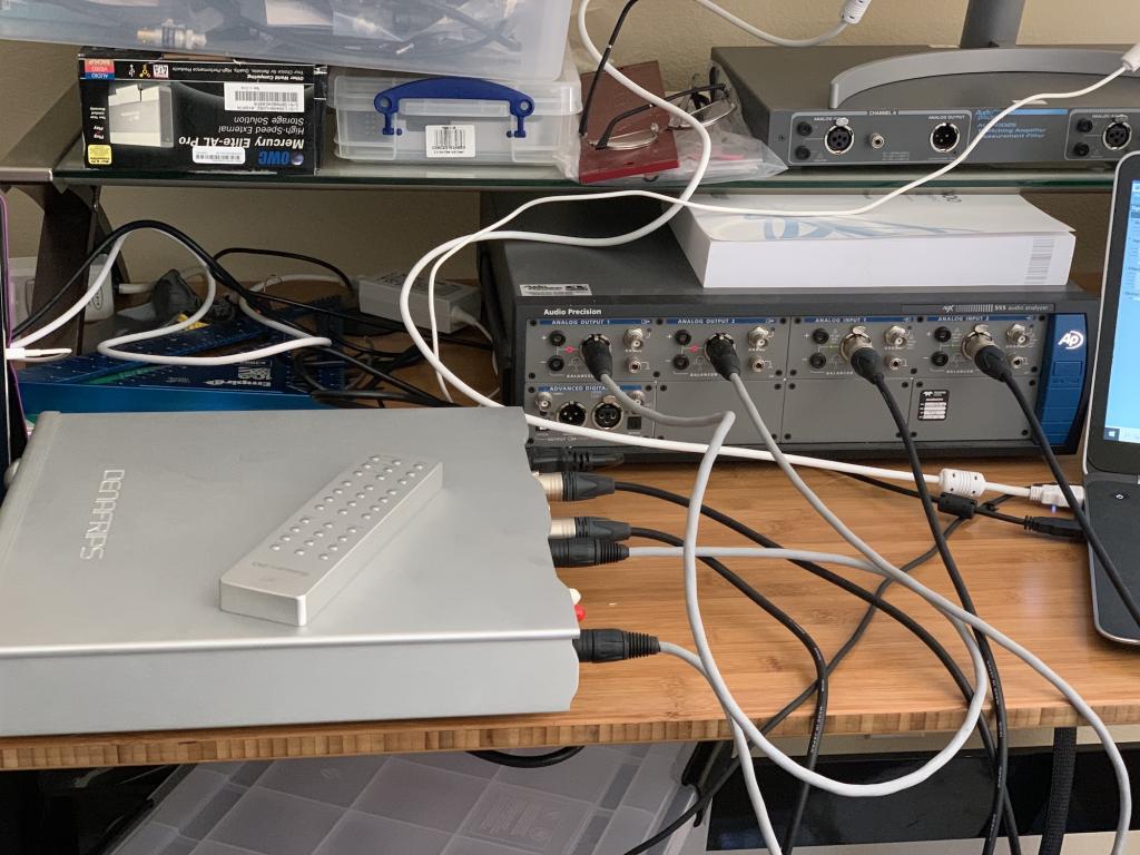

                            I did let it "idle" on the bench with a middling level signal, about 1V RMS, which is typical for fairly loud playback with "normal" input range power amps (1.5 to 2.0VRMS for rated output)(I say normal, because there is some industry movement to higher input voltages for full output in order to allow preamp S/N ratio to be better optimized.)
                            Note that this measurement is showing the THD with an A weighted measurement, while all the other measurements have no weighting curve.
Name:	Hestia Monitor.jpg
                            In this case, I would say the preamp is already pretty well optimized for the conventional dynamic range requirements, because these are very good numbers for 1VRMS- at this level, the results are usually dependent on signal to noise ratio more than circuit nonlinearity.

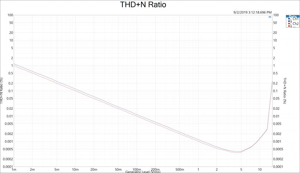

                            Next up is the THD+N at 1kHz sweep, going up to 15VRMS.
Name:	THD+N Level Sweep.jpg

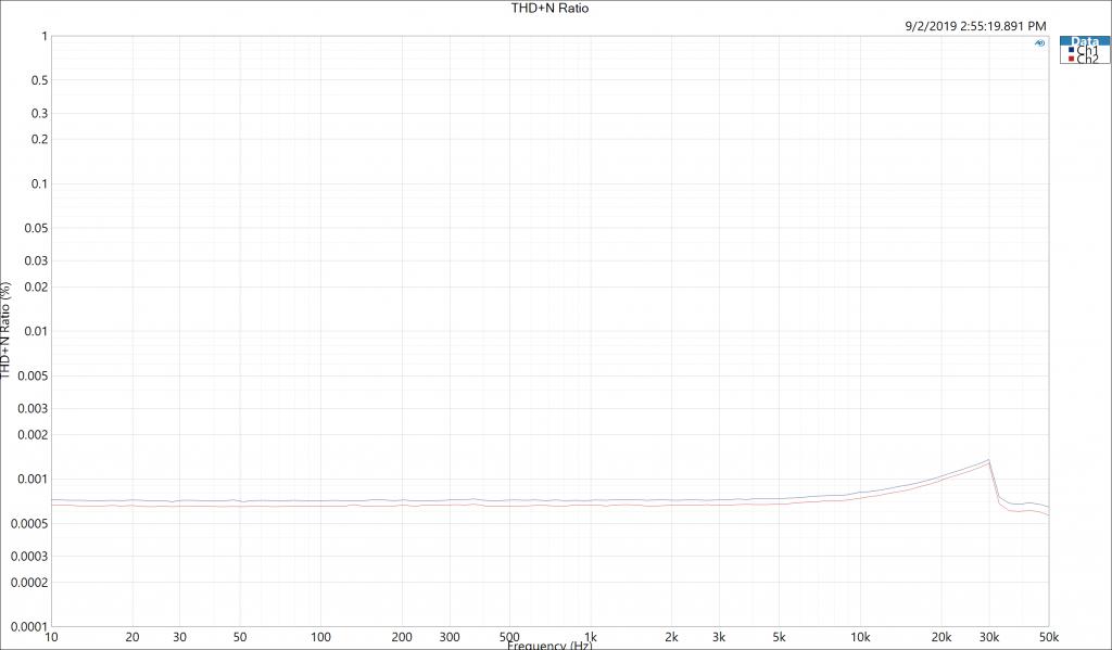

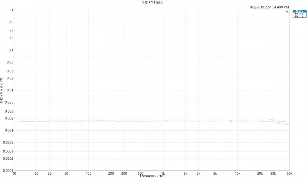

                            Let's look at some distortion versus frequency sweeps.
                            This is at 600mV RMS, which correlates with some moderately loud listening levels in most systems- probably 3-6 dB below clipping.
Name:	Hestia THD+N Ratio 630mV.jpg
                            This is a level sufficient to push you to the edge of clipping with most typical amplifiers.
Name:	Hestia THD+N Ratio 1.60V.jpg
                            Here we're seeing a bit of rise in the high frequency distortion, but it's still under 0.001% at 20kHz.
