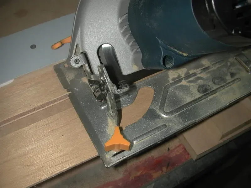

                        I noticed that this one has 2 different slots on the baseplate for lining up cuts- one for 90 degrees and one for 45 degrees. That sounds good.

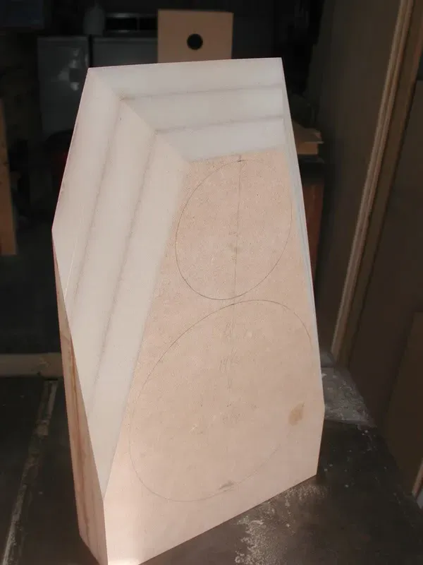

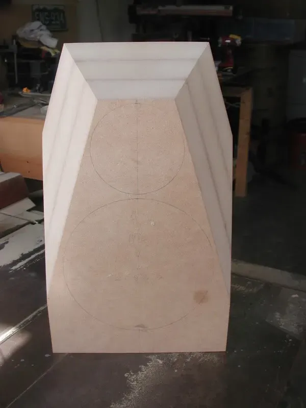

                          You really don't need to cut the full depth. With the Festool I cut from both sides at a 45 degree angle using the supplied guide (it's VERY accurate) and just finished the remaining center piece with a hand saw. Since the Festool has done most of the cutting the hand saw is guided with the cuts from the power saw. At their widest point my facets are 4.5 inches and took all of about 20 minutes to cut and finish. Thomas has seen them up close and personal and he didn't run from the room laughing so I think they probably turned out OK. If you need pictures I can get some, but this was done with the smaller Festool saw and is way safer than anything else I can think of or tried. I play guitar and I'm anal about protecting my fingers and this method with a ~6.25 blade it will cut ~1.5 inched at 45 degrees. Small, accurate, light and worth every penny I spent on it.
                          ColoradoTom
                          • ColoradoTom
                            • 332
                            Pictures here
                            https://www.htguide.com/forum/showthread.php?t=26030&page=11&highlight=Colorado Tom
                            Look about midway down the page and you'll see the redesigned facets on my speakers.

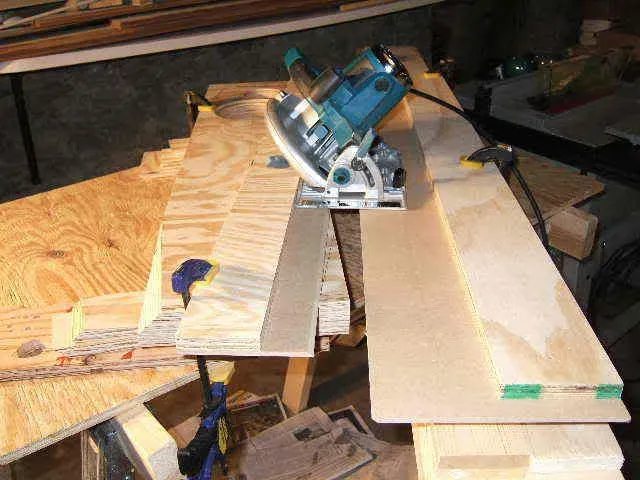

                                                  So here’s an idea, subject to change...
                                                  Get an 8.25” saw like the Makita. Then make a saw board like here:
                                                  Discover the latest breaking news in the U.S. and around the world — politics, weather, entertainment, lifestyle, finance, sports and much more.
                                                  Cut the saw board with the saw at a 45 degree angle. Then I can use the saw board to line the saw up to the exact cut line I draw on the front baffle. Make the saw board base from 1/4” hard board (peg board without holes) so I don’t loose too much depth from the saw. Use something thicker and sturdier like 3/4” plywood for the guide ripper, to provide more strength to the assembly. Make the saw board longer than the baffle corners to cut. Support each side of the overhanging saw board with stacked up ply wood, to support the weight of the saw and saw board, to prevent any flexing, etc.
                                                  With the deeper cut available from the 8.25” saw I can make one, clean cut and have less chance of messing things up with having to cut from 2 sides and/or using a hand saw.

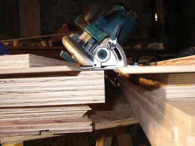

                                                          Exactly. But this aspect of thing is my main source of concern regarding using a circular saw and saw board to cut the facets. Because of the angle of the saw blade at 45 degrees, basically, the weight of the saw and the saw board will barely be touching the baffle. They will just be on the corner of the baffle. So I'll have to support the saw and saw board with stacked ply. There won't be any stability from the baffle itself. Will have to be careful about clamping and such. I think it will work well, but I'm not 100% sure.
                                                            On sawboards: I don't think it applies for a 45 degree cut since the motor is up in the air, but remember that the guide edge material height DOES limit cut depth for a 90 degree sawboard, since the body of the motor can/will run into it at some point.
                                                            Also, with the specific way these are being cut, a sawboard would have to be resting on the scrap material. That, to me, is very risky.
                                                              Not really. For a 45 cut, the narrow side of the saw base rides on the board which sits on the baffle. That said, it will be tippy with the heavy and wide part of the saw hanging in space over the scrap so good technique to hold the saw flat is needed. A sawboard built with a slot for the blade might help -- it would support the whole saw and you could prop the board up if needed before making the cut.
                                                              Edit: I probably made that sound harder than it is. With a little practice, it's not hard to hold the narrow side down on the board. Both hands on the saw and push down as much as forward with a bit of sideways torque, keeping the saw base flat on the board.

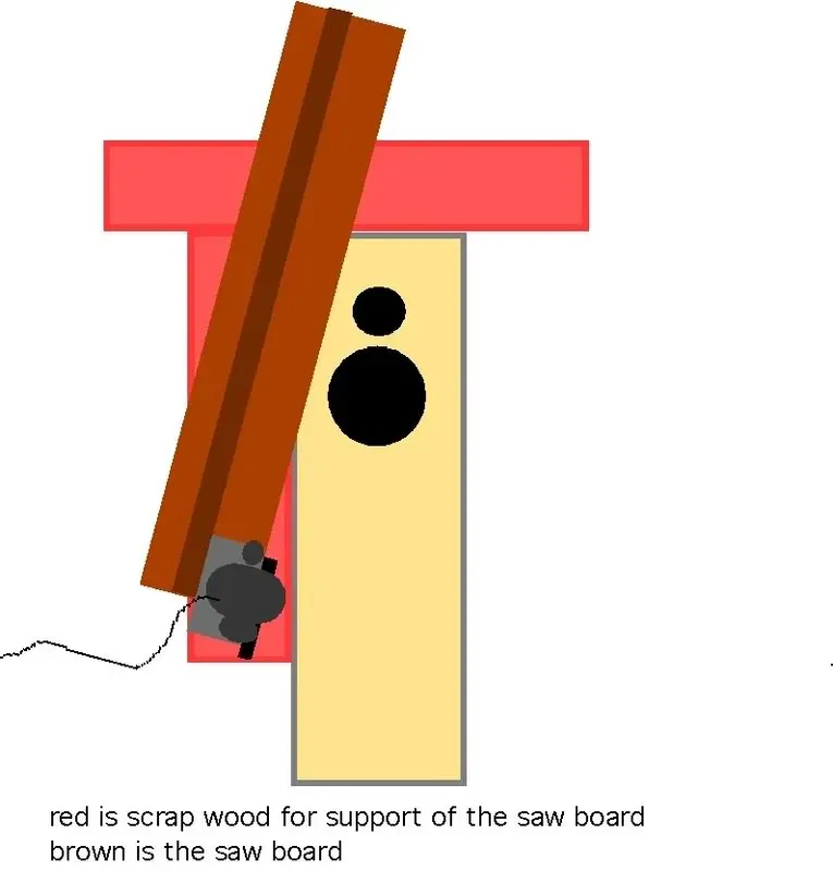

                                                                Maybe we are getting a little confused on the specifics? A picture might help here. I drew this up in about 12 seconds:
                                                                When you have the circular saw at the 45 degree angle, the motor is up in the air and the blade is angled underneath the large part of the base plate (and the motor). The small part of the base can rest on the baffle that we are trying to cut. But the large part cannot. So it will be tough (but not impossible) to just run the saw base atop the baffle to make the facet cut. That’s why I was thinking the saw board would be good here, helping to support the saw. The saw board will also help line up the saw to the exact cut line. But it will only overlap with the baffle at the corner to be cut. You’ll have to be careful about placing the saw board. Scrap wood will be needed to support it on either side of the baffle corner. And you’ll have to be a little clever with all your clamping. You will also need to cut through all the (red) supporting wood.
                                                                At least that’s how I’m thinking about it. I’d go try this out for myself, except my current, old, cheap circular saw cannot even hold the blade perpendicular to the base plate. Probably not worth much effort, considering I’d have to make the saw board, glue up some test baffles,etc. Then do that all again for practice with the new saw. Then make the real cuts. So I’d like to have a better idea if this method will work before buying the Makita. Thanks.
                                                                • Ray Collins
                                                                  • 257
                                                                  JonW,
                                                                  Looks like it will work. I am sure you realize that the scrap material jig needs to be flush with the baffle surface. After the first cut, just rotate the baffle 90* and cut the other side starting from the top. Looks like a plan...
                                                                  Ray
                                                                  BENJAMIN FRANKLIN
                                                                    Jon, what you drew is what Chris described. Propping up the ends will help with the danger aspect. If the board is stiff enough not to sag, the blade probably won't bind. However it will still be quite inaccurate because the cut will be offset from the line by the width of the blade -- if you put the board on the line, you will cut 1/8" too much. Also the bottom 45 deg edge of the board is obscured by the overlapping top edge so it would be a bit hard to line up perfectly even if you could estimate the 1/8" or so blade width.
                                                                    Move the board to the right, so the left edge of the board is on the line. Move the saw to the left hand side of the board and you've got it.
                                                                    You probably won't even need to prop up the ends if the board is stiff and you clamp it to the cabinet well. In fact, the supports at the ends will probably just get in the way. To do this, you need to get the saw into position, with the guard retracted so it's riding on the board, before you ever pull the trigger.
                                                                    Edit: words bad, pictures good. The saw runs along the left side of the guide.

                                                                      Jon:
                                                                      Why wouldn't you reverse the sawboard and saw so that at any given moment your saw is sitting on solid cabinet that is not being cut off or supported scrap wood? That way the saw board will not possibly twist or warp because some of the cabinet is cut through and ready to fall off.
                                                                      Dennis beat me to it. :T
                                                                      • JonW
                                                                        • 1601
                                                                        OK guys. Yes, moving the saw board more onto the baffle, and then putting the saw on the left side of the board seems to make sense. Although then you have very little of the saw base plate being supported by the saw board. But I do see the reasoning behind what you’re saying. And it will make for much more accurate cuts because the saw will cut right at the line you mark on the baffle.
                                                                        Revised pic below.
                                                                          I'd do it like this. Clamp the sawboard to the baffle.
                                                                          • JonW
                                                                            • 1601
                                                                            Thanks Dennis. That all makes sense. It seems simple on paper. We'll see what happens when time comes to try it out on scrap wood. Maybe this weekend I'll glue up some scrap 3 layers deep. And order the Makita. And see how it goes before cutting into the real baffles.
                                                                            I've started a little bit of the cabinet construction. It's fun. When I've got something decent to look at, I'll post pics. Thanks again.

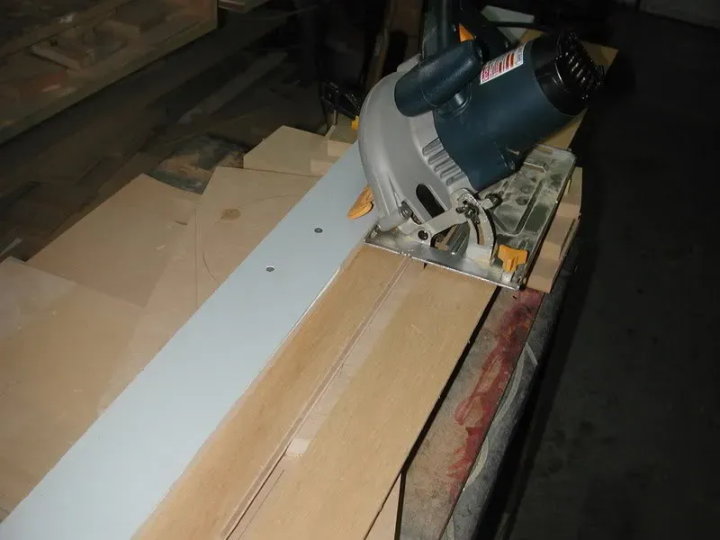

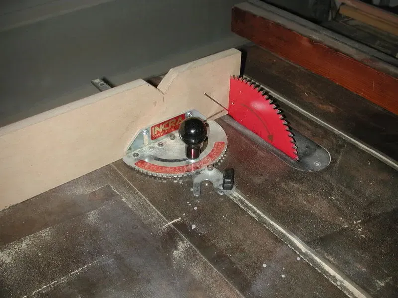

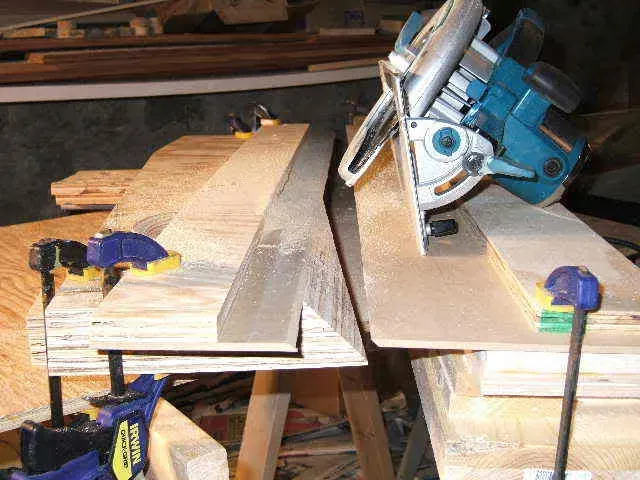

                                                                                    Jon and I have been discussing how to cut facets without hurting yourself and making a cabinet that looks good, even excellent. I have followed this discussion on and off line and have told Jon that I would cut a set of facets this weekend at home.
                                                                                    I have a table saw that will rise to 3 1/2" at 90 degrees and 2 3/8" at 45 degrees. I also have an Incra miter gauge that is very accurate. Using the tabel saw has been my first inclination to use both for accuracy and ease of use. But Jon has a smaller table saw and it might not work as well for him.
                                                                                    I also have a radial arm saw that might prove useful for cuts like this!
                                                                                    So I am also using the circular saw with saw board method everyone has discussed. Here are the pictures of the 'jig' before the first cut this morning.
                                                                                    I have opted to use drywall screws to hold key points in alignment so that there is no slippage. Clamps are used at the rear and front to hold the supporting blocks in place.

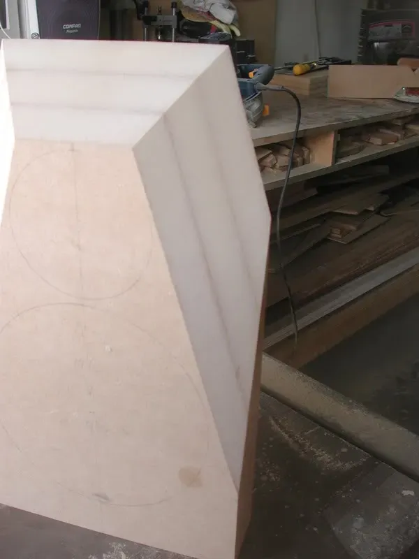

                                                                                    • chasw98
                                                                                      • 1360
                                                                                      And here are the results. I did the left side with the saw board and the top and right side with the table saw. The saw board takes a lot of time to set up but it was very easy to push the saw through the material and keep it up against the saw board. If you set it up firmly and correctly, it works very well.
                                                                                      The table saw takes almost no time to set up and it is very easy to make adjustments before committing to the cut. It is also just as accurate.
                                                                                      Except for my miscalculation in my angles, my baffles came out just fine. It really depends upon what you own for tools. My table saw will cut all the way through a 2 1/4" slab. My circular saw will not. I can also use my table saw for longer baffles like Jon is building by adjusting the miter gauge to a different angle and clamping the long piece to it.

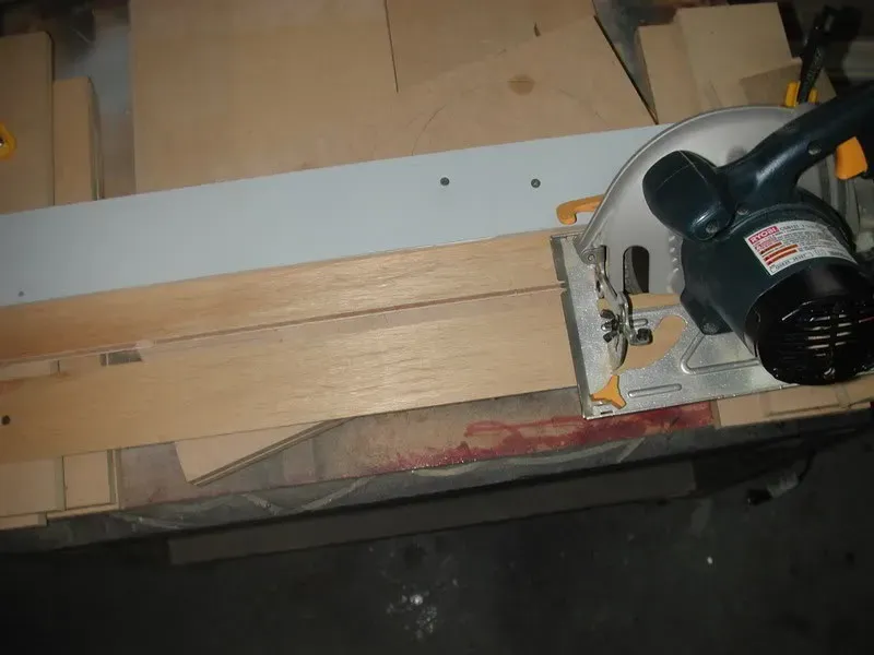

                                                                                        • JonW
                                                                                          • 1601
                                                                                          To revive this thread...
                                                                                          I got the saw (Makita 5008MGA),glued up a few pieces of ply to make a practice baffle. And I tried cutting the facets. They came out just OK. Not super, not awful. Some of the cuts were deeper than others. Sometimes I cut deeper into the saw board and that made for deeper cuts than I wanted.
                                                                                          I think I had 2 problems with this method. The first is that the base of the saw is teeny (maybe ~1”) on one side. So when you run the saw across the saw board, it’s not necessarily moving totally flat. Any tilt up or down of the saw will make the cut deeper or shallower. The other side of the base was resting on a second saw board.
                                                                                          The solution might be to make sure that everything is really flat- especially the second saw board that is supporting the other side of the saw. So the second problem is that my “work bench” (ahem) isn’t too flat- it’s some scrap ply on saw horses. And I can’t do this on my floor because that’s not terribly flat either (old house).
                                                                                          I’d like to do a little better. But it might be OK as is. Maybe making more effort to keep things flat will help. And the practice certainly helped get a feel for things. This will probably work OK and I don’t have any better ideas at the moment. I’ll think about it a bit before I cut into the real baffles.
                                                                                          And just a pic of the test baffle leaning against one of the real cabinets:
                                                                                          Last edited by theSven; 24 July 2023, 09:22 Monday. Reason: Update image location and remove broken image link
