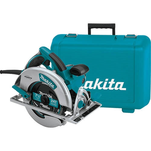

                        I noticed that this one has 2 different slots on the baseplate for lining up cuts- one for 90 degrees and one for 45 degrees. That sounds good.

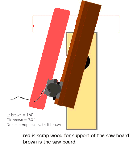

                                                                Maybe we are getting a little confused on the specifics? A picture might help here. I drew this up in about 12 seconds:
                                                                When you have the circular saw at the 45 degree angle, the motor is up in the air and the blade is angled underneath the large part of the base plate (and the motor). The small part of the base can rest on the baffle that we are trying to cut. But the large part cannot. So it will be tough (but not impossible) to just run the saw base atop the baffle to make the facet cut. That’s why I was thinking the saw board would be good here, helping to support the saw. The saw board will also help line up the saw to the exact cut line. But it will only overlap with the baffle at the corner to be cut. You’ll have to be careful about placing the saw board. Scrap wood will be needed to support it on either side of the baffle corner. And you’ll have to be a little clever with all your clamping. You will also need to cut through all the (red) supporting wood.
                                                                At least that’s how I’m thinking about it. I’d go try this out for myself, except my current, old, cheap circular saw cannot even hold the blade perpendicular to the base plate. Probably not worth much effort, considering I’d have to make the saw board, glue up some test baffles,etc. Then do that all again for practice with the new saw. Then make the real cuts. So I’d like to have a better idea if this method will work before buying the Makita. Thanks.

                                                                • Ray Collins
                                                                  • 257
                                                                  JonW,
                                                                  Looks like it will work. I am sure you realize that the scrap material jig needs to be flush with the baffle surface. After the first cut, just rotate the baffle 90* and cut the other side starting from the top. Looks like a plan...

                                                                    Jon, what you drew is what Chris described. Propping up the ends will help with the danger aspect. If the board is stiff enough not to sag, the blade probably won't bind. However it will still be quite inaccurate because the cut will be offset from the line by the width of the blade -- if you put the board on the line, you will cut 1/8" too much. Also the bottom 45 deg edge of the board is obscured by the overlapping top edge so it would be a bit hard to line up perfectly even if you could estimate the 1/8" or so blade width.
                                                                    Move the board to the right, so the left edge of the board is on the line. Move the saw to the left hand side of the board and you've got it.
                                                                    You probably won't even need to prop up the ends if the board is stiff and you clamp it to the cabinet well. In fact, the supports at the ends will probably just get in the way. To do this, you need to get the saw into position, with the guard retracted so it's riding on the board, before you ever pull the trigger.
                                                                    Edit: words bad, pictures good. The saw runs along the left side of the guide.

                                                                        OK guys. Yes, moving the saw board more onto the baffle, and then putting the saw on the left side of the board seems to make sense. Although then you have very little of the saw base plate being supported by the saw board. But I do see the reasoning behind what you’re saying. And it will make for much more accurate cuts because the saw will cut right at the line you mark on the baffle.
                                                                        Revised pic below.
                                                                          I'd do it like this. Clamp the sawboard to the baffle.

                                                                            Thanks Dennis. That all makes sense. It seems simple on paper. We'll see what happens when time comes to try it out on scrap wood. Maybe this weekend I'll glue up some scrap 3 layers deep. And order the Makita. And see how it goes before cutting into the real baffles.

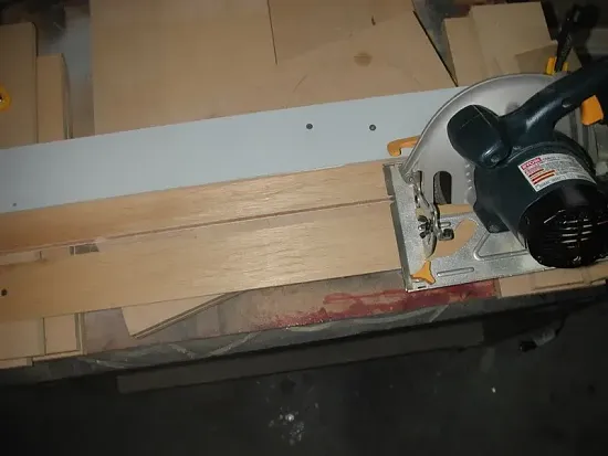

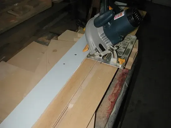

                                                                                          To revive this thread...
                                                                                          I got the saw (Makita 5008MGA),glued up a few pieces of ply to make a practice baffle. And I tried cutting the facets. They came out just OK. Not super, not awful. Some of the cuts were deeper than others. Sometimes I cut deeper into the saw board and that made for deeper cuts than I wanted.
                                                                                          I think I had 2 problems with this method. The first is that the base of the saw is teeny (maybe ~1”) on one side. So when you run the saw across the saw board, it’s not necessarily moving totally flat. Any tilt up or down of the saw will make the cut deeper or shallower. The other side of the base was resting on a second saw board.
                                                                                          The solution might be to make sure that everything is really flat- especially the second saw board that is supporting the other side of the saw. So the second problem is that my “work bench” (ahem) isn’t too flat- it’s some scrap ply on saw horses. And I can’t do this on my floor because that’s not terribly flat either (old house).
                                                                                          I’d like to do a little better. But it might be OK as is. Maybe making more effort to keep things flat will help. And the practice certainly helped get a feel for things. This will probably work OK and I don’t have any better ideas at the moment. I’ll think about it a bit before I cut into the real baffles.
