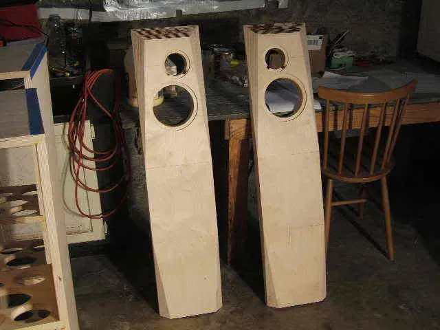

    Other than only have two drivers holes , looks good to me. :T
    • JonW
      • 1601
      I've got a 3 way in mind. That's my next project. :twisted:

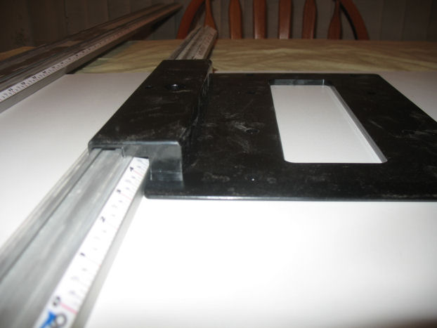

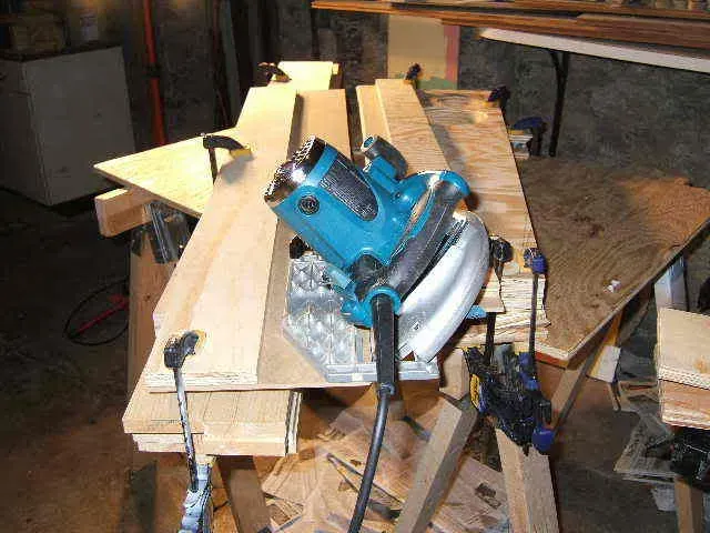

          You definitely DO NOT have a stable enough surface for the saw to sit on. I can see from the pictures that the 'non edge guide' part of the saw board needs to be closer to the sawboard actually providing the guide and needs better support so that you do not sag or move in the horizontal plane. A picture is worth a thousand words in this case. If you look at my pictures I had a much smaller gap between the sawboard and the supporting sawboard to make my cuts. Oh well, good practice and a way to get a feeel for how the saw handles. BTW, did it cut deep enough?
          Chuck
          • JonW
            • 1601
            JRT,
            Interesting idea. I hadn't thought of that. Do you think there is a good way to align things such that you could get a good cut of the facet?
            Chuck,
            I think you're right. I need to get everything more solid and stable. Not sure how I'll do that. Maybe use the test baffle as my support for the second, non-cutting side of the saw. That might be more solid and less mobile. And I'll move the second, non-cutting saw board closer to the blade. Good ideas. Any others?

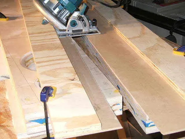

                I made my “real” fact cuts. Here’s what I found…
                I used the method that Chuck and I both posted photos of, above. JRT- your method may be something to try in the future. For now here’s what I did.
                I made some more practice cuts and could not get things to align perfectly when I made a cut on one side, then tried to do the same on the other. So here’s what I found to work OK:
                Start with the cut you’ll make with the saw in the middle. You’ll be pulling the saw out toward you to make this cut. (Not really pulling the saw toward you- that would be dangerous. But for the sake of orientation here, from where the photo is taken.) Let’s say this will be the top left corner of the baffle, when looking at it.
                See how deep the cut was made. Then, on the other corner, mark an equivalent cut with a pencil. We’re on the top right corner now. Make the pencil mark on the top edge of the baffle, that you are looking at when looking from the ceiling down onto the speaker, if it were standing up.
                I used a three-sided ruler to mark the cut line- that makes it easy for drawing the 45 degree cut line. This isn’t the one I used but it’s about the right idea:
                Then align the saw boards and put the saw up to the baffle. Here the cut will be made standing where I was when taking the photo. I will push the saw forward. I arranged the saw boards and saw such that I could see the blade lined up right onto the cut line I made with the pencil. This photo doesn’t really show it well. But the idea is that you kneel down and look along the edge of the saw blade. Make sure it’s aligned with your cut line that is on the top edge of the baffle. Then make the cut. (Note this photo was from practice, not the real cut.)
                If that makes any sense I hope it might be useful to others.
                And the final product:

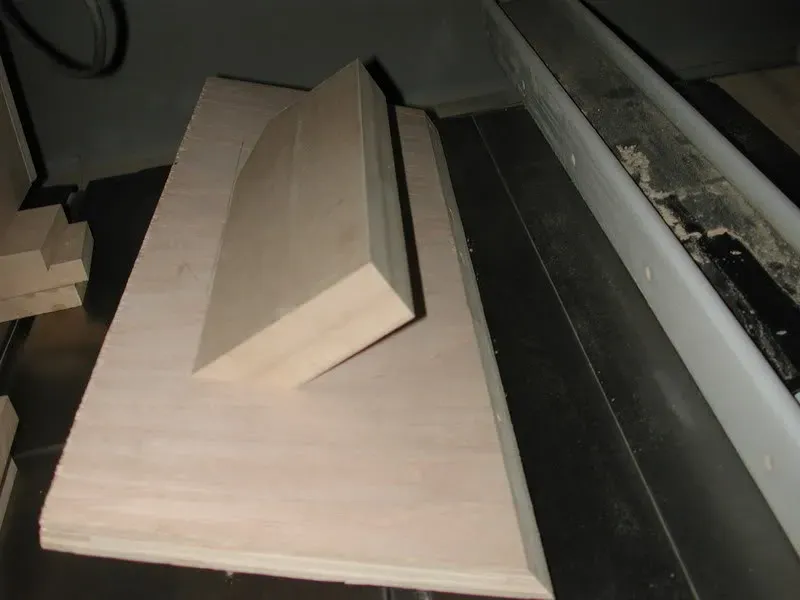

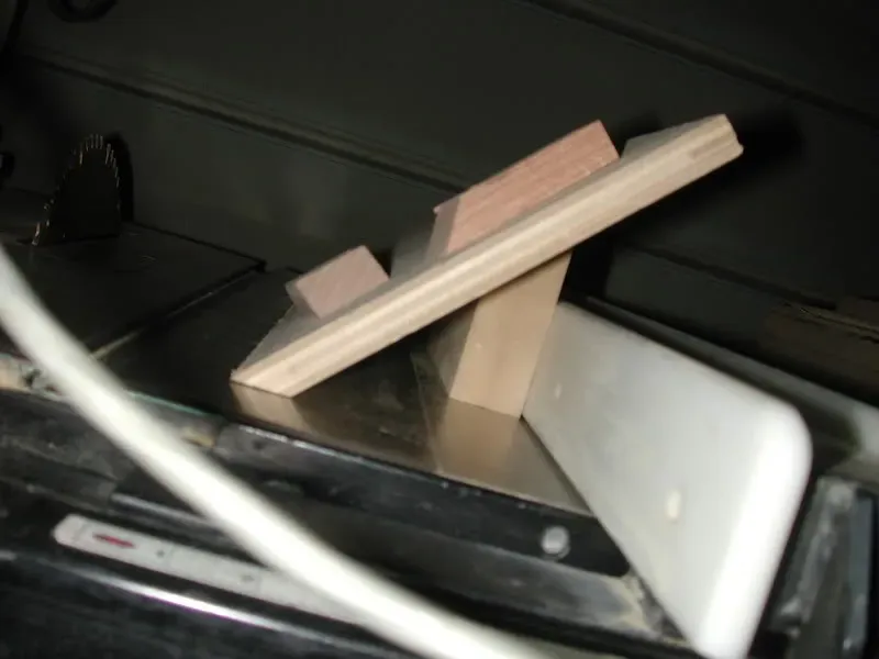

                  Here's another option using a table saw. Look about mid-way through the thread.
                  https://www.htguide.com/forum/showthread.php?p=250091&highlight=facet+jig#post2 50091
                  The jig holds the baffle at 45 degrees so that you can get the maximum depth from the table saw blade. With a 10" saw you should be able to get 3 inches deep.
                  ColoradoTom

                    I plan to use a jig like yours, Tom. Did you consider attaching a runner on the bottom (at the appropriate angle) to ride in the t-slot, rather than the angle jig against the fence? That's what I'm leaning toward.
                    • CraigJ
                      • 519

                          • ColoradoTom
                            • 332
                            Good idea...but be careful because you have to run the baffle through opposite sides of the saw blade to cut the facets on both sides of the baffel. With the setup I had I just unscrewed the handle and attached it to the other side, moved the fence to the exact same distance on the opposite side of blade, and made the second cut.
                            Tip: Draw the facet cuts on the baffle before you cut... that way you'll be able to look at your setup prior to actually cutting to be sure you've aligned everythin properly!! You'll also be able to see the blade track the lines you've drawn as you make you cuts!
                            Tom
                            • Paul Ebert
                              • 434
                              Good points, Tom. My first reaction was that I could flip the jig and run it in the slot on the other side of the blade, but they are not equidistant from the blade (one is 4", the other 5). I wonder why they did that?
                              Of course, there are four facets to cut per baffle. I'll have to think about this some more (when I'm not so tired).
                              However I make the cuts, I will certainly mark out the cut and make test cuts. Fortunately, I have a good bit of scrap for such a purpose.

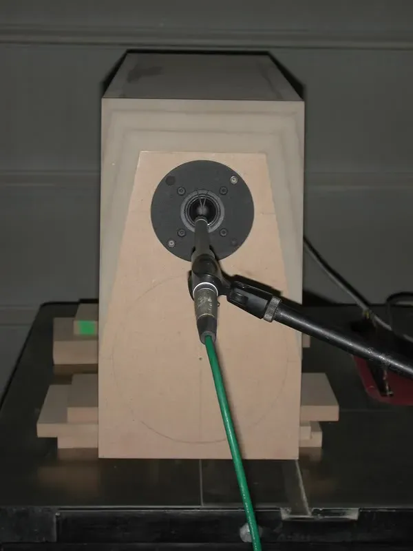

                                    Faceted enclosures... What's the advantage?
                                    • JRT
                                      • 51
                                      It can help reduce ripple associated with edge diffraction, though not as well as large edge radii.
                                      You can play with this simulation tool to see how things are affected.
                                      Edge treatments well away from the tweeter or small midrange are just for aesthetics.
                                      • peter_m
                                        • 227
                                        And round-overs? Are they also for mid-range and highs?

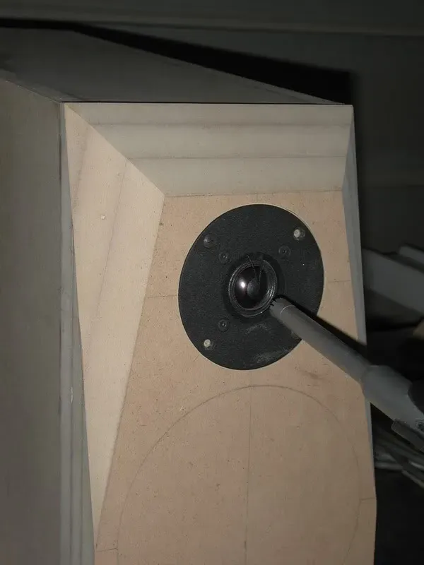

                                            Hi Peter,
                                            If you just have square edges to your cabinet, sound can come from the tweeter, bound across the face of the baffle, and then load up at the edges. The result is some frequencies will be more pronounced than others. So smoothing out the edges with a roundover or facet,etc. will help some. Do a search on "baffle diffraction" and you will find a lot of reading on the topic. If you want to play around with some simulations and learn for yourself, look for the programs "Baffle Diffraction Simulator" or "Edge."
                                            I used BDS and came up with some interesting tidbits that helped me understand things:
                                            I'm designing my first speaker, a simple 2 way MT, and I’m currently looking into various cabinet styles. How might one best control baffle diffraction effects? There are two good free programs out there: Edge and Baffle Diffraction Simulator (BDS). I’ve been trying out various baffle designs to see what looks good. I’m new to
                                            And if you want to see actual measured data, I tried a few different cabinet configurations and the results are here, on pages 10 and 11:

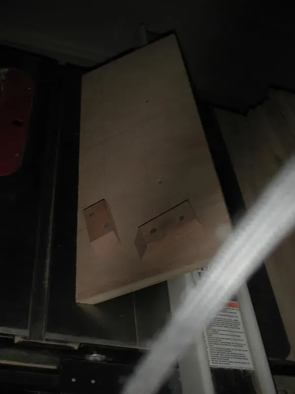

                                                        Jon.....
                                                        ColoradoTom
                                                        Well, I was making some test cabinets today and they are faceted. I finally gave up, admitted defeat, and took Tom's advice. In the end I do not know why I wasted my time with a sawboard and radial arm saw, etc. I was able to make a 'compound sled' in less than an hour and then have accurate facets cut in less than 15 minutes. I made it out of old wood lying around the shop and it works great. If I were going to make a permanent unit, I would change some things, but for ease of use this is it. Thanks Tom!
                                                        Top view of Jig
                                                        End view of Jig.
                                                        Bottom view of Jig.
                                                        Results!
                                                        Chuck
                                                        Last edited by theSven; 23 July 2023, 21:30 Sunday. Reason: Update quote and image location
