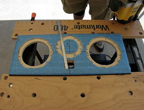

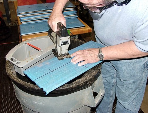

    If one is using the P.E. ready made cabinets, And a Jasper Circle jig how does one NOT ruin the finish on the baffle ? Should you lay out everything on the unfinished side and cut out ? Would like to get some input on this.
    Thank You.
    Cover the baffle with blue easy release painters tape

      Thank You Thomas i belive thats the picture of what i was looking for. And thank you again Thomas as i will be trying to find a workmate like the one shown that sure makes it look alot easier to do things.
        That's from the first generation of Workmates ever build (big and heavy). I doubt you'll find one like it..

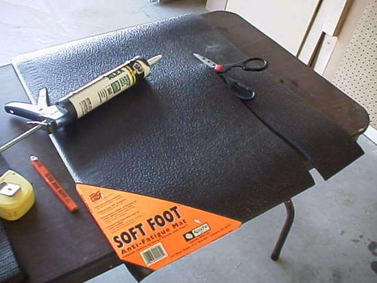

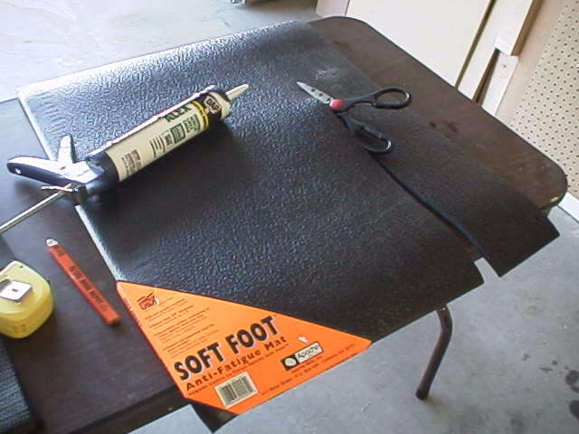

          I did some checking and i did find a newer model " Workmate 425 " I will check out our local Home Depot and Menards...Also would like to ask, i have read somewhere (link unknown) that Home depot sells a foot fatigue mat called Soft Foot and someone wrote that this could be used in place of acoustic foam to line enclosure walls ? its a grey foam material according to the picture i seen. If i can find a way to send it from my work email account to my home email i will post a picture of it thursday. (work frowns on sending out emails not work related)
            Fatigue mats are made with closed cell foam that's of no use in this application.

                  Here is the picture of what i was talking about with the fatigue mat.

                    Originally posted by dawg1161
                    Thank You, I'll check that out also.
                    Here's a rule of thumb. If you can't blow through it, you can't use it inside a speaker. I'd suggest at least 1 1/2" - 2" thick foam inside of the cabinet behind and on each wall behind the woofer, holding back from the front baffle about 2" so the driver can breath.
