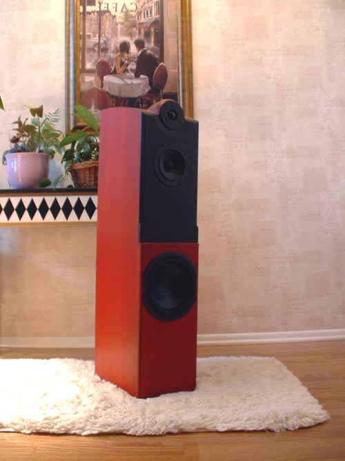

                Here's my first attempt at veneering. 10 mil paper-backed light ash applied with the titebond/iron method. Have to say I am very pleased at how it came out and how relatively easy it was. The seams are almost invisible in room light but show up in the camera flash much more.
                Finish was a couple coats of tung oil, wipe-on, wipe-off.

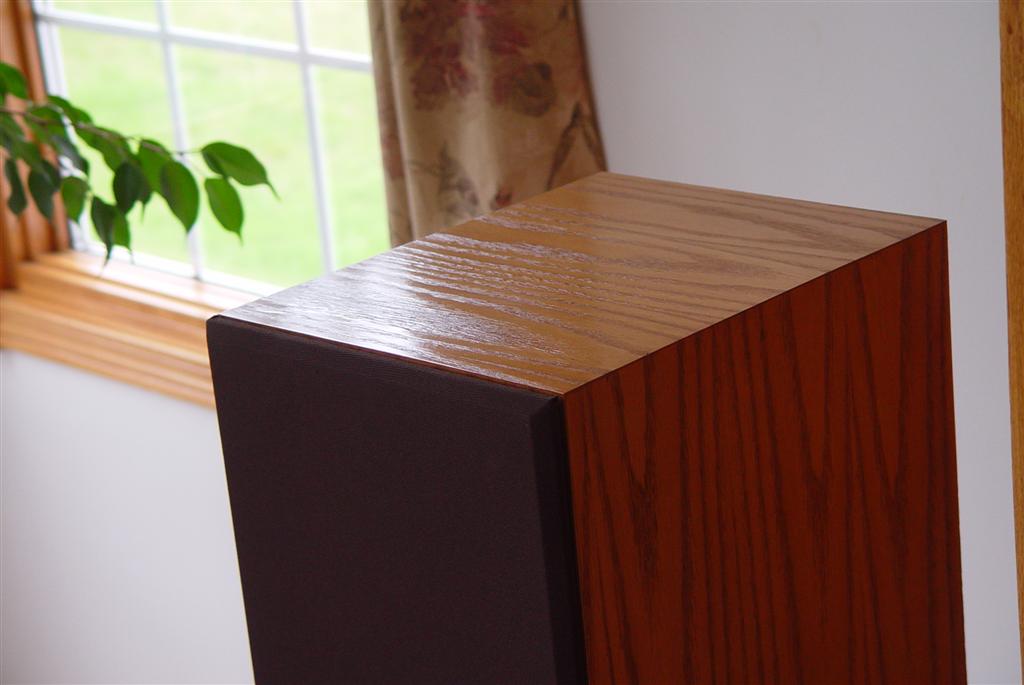

                  Yes, that is exactly the Crystalac I used. A quart might be a stretch for a pair of floor standers but you'll have a lot of the gallon left over for other projects.
                  I bought a Wagner HVLP fine spray setup after quite a bit of research. It was about $100 at both Lowe's and Menard's. It is very easy to use and has extremely low over-spray which was a requirement for me. I'm happy with it.
                  I've attached a picture of the top of one of my cabinets that will give you a bit of an idea of what to expect.
                    Very nice! With the light reflecting from the window, you can still see some wood grain. So it's not a thick candied shell like on a guitar. But that could be nice as well. This might be a good route to go.

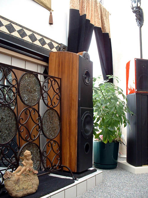

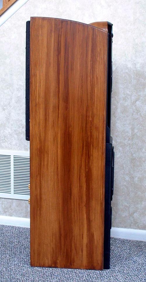

                                                      Well, actually, I'm an amateur furniture maker with a couple of luthier friends, so...... as much as I'd LOVE it, I'm not a guitar maker!!!! Here's a link to something very similar to what I showed ThomasW.
                                                      Spitcoating will give a professional finish to your project. It may look like a long and difficult process, but it is surprisingly easy and very durable.
                                                      Watching a true professional French Polish is really fun - the technique looks SO easy when done by someone that has a lot of experience!! Unless you have a lot of practice, edges can be a challange - and the M8ta seems like it's all egdes! I quickly moved on to easier options.
                                                      If interested I can send a high rez photo for posting. I start with several coats of Tung Oil lightly sanding between each coat until there was a solid base. On the example I showed ThomasW I had added about five "spitcoats" of oil-based Poly. Remember, for most non-professionals the quantity of time spent on preparing the surface and finishing typically correlates the the quality of the finish - I figure that I'll probably spend close to two weeks on just the finish work.

                                                            Tom's spitcoating is one of the most impressive speaker finishes I've seen. I've seen finishes on speakers costing $115,000/pr (Dali Mega-lines) that didn't look as good.
                                                            • JonW
                                                              • 1601
                                                              That's an excellent endorsement. The one photo in the link he provided:
                                                              looks pretty good. Would you say that's representative?

                                                                        I left my camera at a party last night and should be able to retrieve it tonight. As soon as I do, I will email ThomasW some high rez pictures and see if he can post them somewhere when others can view them.
                                                                        Now.... these are my thoughts and opinions and this is free advice and probably worth less than what you are paying for it, so here goes!
                                                                        #1 I use veneers or real wood in my projects. If I were to use just MDF/HDF and wanted to finish it I'd probably go with one of the "truck liner" options that have been mentioned in the past. Sounds easy and the results seem to look quite reasonable.
                                                                        #2 If you are working with wood and have limited experience with finishing I'd look at Tung Oil. You basically flood the surface by brushing it on, wait a bit, and then wipe it off. It is ridiculously easy to do, hard to screw-up, and will get you 70 to 80% of the way to kickass professional looking finish. There are many fine furniture makers that use this as their dominate finish technique for their work. Unless you have friends that are fine furniture makers, most people would assume a Tung Oil finish was done by a professional and not a DIY'er. The major drawback is that each layer will take you about 24 hours of time and you'l typically need several layers (proably more that 4 to get the best results). Here's a link:
                                                                        If you use the technique that David describes you will have a VERY professional looking finish that requires minimal knowledge and no tooling investment.
                                                                        #3 Guitar finishes - well, if you think audiophiles are the only crazed, anal retentive group, then you need to visit some of the guitar forums. One of the reasons that lacquer and "french polishing" techniques are popular with guiter makers is that they allow very thin layers for the resulting finish. These thin finishes allow the guitar to keep it's "tone" while at the same time allow the instrument ot become an object of beauty. There are many discussions on the different types of guitar finishing techniques and the effect on the tone of the guitar. Slapping on a thick coat of poly on a fine acoustic instrument has the possibility/probability of ruining it's unique sound. (I understand that this probably isn't the case with solid bodied guitars like a Fender Strat, but mine still has a Nitro-Cellulose Lacquer finish and I would guess that most guitars both electric and acoustic of recent vintage have this type of finish because it's easy/fast to apply in a production shop and it's also easy to repair). Keep this in mind when you use a guitar as an example, some of the isssues that dictate the finish on an acoustic instrument may have nothing to do with what you are concerned with as a speaker builder.
                                                                        #4 - My goal with the finish on my M8ta's is to try something different (always fun), try to make it as easy as possible, and try to make it look like the finish on my guitar collection. I do have a small compressor, but the ability to setup a spray booth isn't realistic at this time and that makes the lacquer option a NO for right now (although I've heard that there are brush on lacquers). So far the "spit" finish has come the closest in reaching all my criteria. I agree with ThomasW that taken to an extreme you end up with something that looks like a table top in a "Hooters" bar, but if you use a little common sense when applying the finish it can look pretty good and the technique is very easy to master. I've been applying the poly/mineral spirits mixture with a linen handkerchief and wipe it on slowly so that I don't create bubbles. In my tests I can typically apply new coats after about 8 hours of drying time and this allows two or more coats per day!! In the end I may be able to prep and finish a pair of M8ta's in less than a week and have a finish that is >90% of the "piano" finishes shown earlier in this post with only elbow grease and a couple of handkerchiefs as and investment - as my daughter would say "Way Cool!!"
                                                                        Just some thoughts...............more to come later!
                                                                        Tom
                                                                        • ColoradoTom
                                                                          • 332
                                                                          Got my camera back early and sent a very high rez photo to ThomasW. The test piece is a veneer of Santos Rosewood the comparison piece is a recent 50 year anniversary version of a 1954 Fender Strat with a high gloss lacquer finish. The Santos Rosewood was finished with two coats of Tung Oil followed by five coats of the "spit" finish (1 part poly to 3 parts mineral spirits). The Tung Oil will darken the rosewood and give it "character" IMHO. If you want to keep the rosewood (or any wood) a lighter color you can seal it with a coat of diluted blonde shellac as a first step and then follow with Tung Oil.
                                                                          I choose not to stain wood and instead pick the species to match the color I want. If I need to modify a natural color I use dye. If you want to know why, go to a woodworking store and compare the results of using an amber dye and an amber colored stain. The stain lodges in the pores of the wood and emphasizes the grain structure while the dye will add a uniform color the the entire surface and highlight the figure of the wood.
                                                                          The finish on the Santos Rosewood in the example was dulled to a semi-gloss with 0000 steel wool - prior to dulling the finish it looked too much like "Evil Twin's" head piece 8O

                                                                                Here's a link to a pic of Tom's sample walnut spitfinsh next to a pretty cool guitar. NOTE to those on dial-up the pic is 2.7 megs!!!

                                                                                  I've used MDF and faux painted wood grain on it with craft paints. Came out quite well and was pretty easy. Coated with oil based semi gloss poly.

                                                                                  • ColoradoTom
                                                                                    • 332
                                                                                    Originally posted by moreants
                                                                                    I've used mdf and faux painted woodgrain on it with craft paints. Came out quite well and was pretty easy. Coated with oil based semi gloss poly.
                                                                                    OK, I'm sorry, but this is REALLY good - I know this is a picture but this looks better than some REAL wood photos ;x(
                                                                                    Tom
                                                                                    • moreants
                                                                                      • 39
                                                                                      Tom
                                                                                      Thanks. Experimented with a red finish first. As you can see it didn't really work. Ended up going with a more neutral tone and am quite happy. Plus they don't clash with my "Sonus Fakers". :rollhead:
