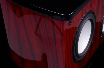

    If you can afford Rosewood, that's the ticket! Rosewood veneer, on a Piano gloss finish is pretty much Nirvana!!!
    Last edited by theSven; 05 August 2023, 19:24 Saturday. Reason: Update image location

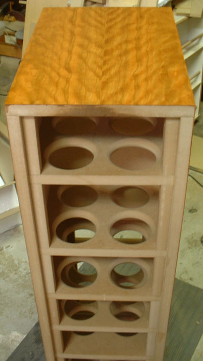

        I really like the figured cherry with a linseed oil finish Brian used for his bit RS 3 ways.

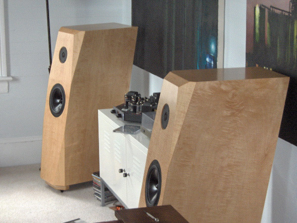

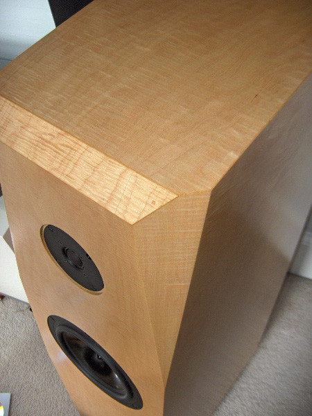

        The finish on Jon's M8ta's look pretty sweet too although I'm not sure exactly what type of veneer he used.
        Click image for larger version  Name:	M8ta2JPSS.jpg Views:	0 Size:	78.5 KB ID:	946919
        Click image for larger version  Name:	M8ta5MP.jpg Views:	0 Size:	87.9 KB ID:	946920
        Last edited by theSven; 05 August 2023, 19:32 Saturday. Reason: Update image location

            That rosewood is pretty. Not really to my tastes, but it’s very nice. The gloss helps, too.

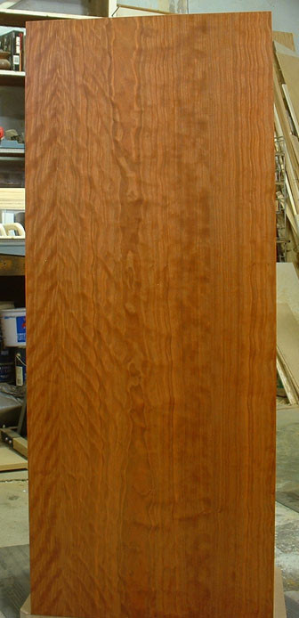

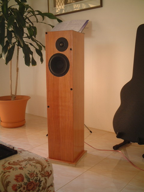

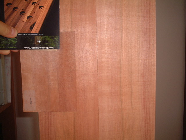

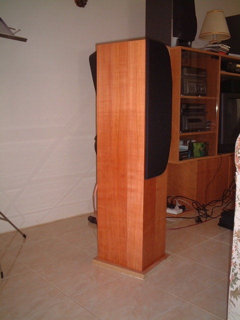

                  Tasmanian Myrtle- raw unfinished veneer is a lovely pink colour.
                  Last edited by theSven; 05 August 2023, 19:19 Saturday. Reason: Update image location

                        I like the RS3ways and M8ta veneer where the figure is beautiful but doesn't blast you from across the room. Its more subtle. I am with Bob and JonW on this one for the most part.

                              That Tasmanian myrtle looks really nice. :T
                              Can’t argue with that mappa burl, either.

                                  Dotay,
                                  That veneer is figured cherry, not maple. It's much the same (might even be from the same sheet) veneer I used on this subwoofer:
                                  Images not available
                                  Last edited by theSven; 05 August 2023, 19:27 Saturday. Reason: Remove broken image links

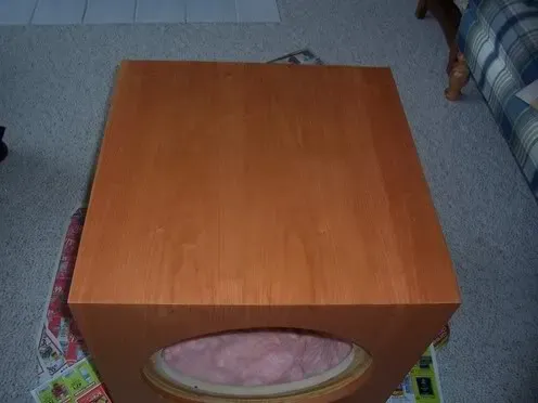

                                            From the little experience I have had so far I favor Cherry on account of I know I like it. I'm sure if I experimented with other veneers and other stains, I would find some other nice looks no doubt.
                                            The first pic is Cherry with Fruitwood stain and the second is with Vermont Maple. A few things to take into account is how different the outcome can be with how many coats you apply. The stripe in the second pic reflects one coat of VM stain while the rest of the enclosure reflects five or six coats.
                                            When applying stain you will achieve a better more consistent outcome if you apply the stain and then take a dry rag and wipe the excess away while being careful to blend as you go.
                                            Last edited by theSven; 05 August 2023, 19:20 Saturday. Reason: Update image location

                                                              The point of the book matching is that it creates mirror symmetry of the wood grain. They do this for the front face of acoustic guitars, too. Definitely not easy, but your brain holds a strong relation between symmetry and beauty.
                                                              -Joe Carrow

                                                                  • Brian Bunge
                                                                    • Nov 2001
                                                                    • 1389
                                                                    You could do the same thing with the paperbacked veneers that Hank linked to above. Just just apply wood glue to both surfaces, let it dry, and then iron it on. Not to mention that the PE veneer is over twice the price of Tape-Ease's red oak veneer. The PE stuff is $45 for a 2' x 8' sheet, whereas the Tape-Ease red oak is $30 for a 4' x 8' sheet. So that's double the veneer for 2/3 the cost of the PE veneer.

                                                                                  Originally posted by JonW
                                                                                  No, I didn't even realize the photo veneer is book matched- that's how little I know about this. So do you cut it down the middle and then put the two pieces together? I'd think it easier to just start with one big piece. Probably more expensive, though.
                                                                                  ....Do people just order veneer over the web, sight unseen?
                                                                                  ....Although I'm not really up to the "Fine Woodworking" level yet. Years away from that. But I'm working on it.
                                                                                  For book-matching you clamp the two pieces together one on top of the other using a shop-made clamp, rough-trim the edge and then finish-trim using a router bit with a flush-cutting bearing. Your clamp must be dead straight or your join line will have gaps. You should be able to find conveniently sized pieces of veneer without the need to book-match. Aficionados will look to see whether the matching sides of your cabinets use matching sheets of veneer - another reason to start with something simple!
                                                                                  Many on-line veneer suppliers show photographs of the veneer stocks. Your local specialist hardwood stockist will probably keep some and might have samples of others that he can order for you.
                                                                                  I was an armchair woodworker for years - there's a lot you can learn in advance. I put a subscription to Fine Woodworking on my Christmas present list one year and struck lucky first time! If you're serious about getting into woodworking, Taunton Press publishes a four-volume set of woodworking books that is really excellent. Can't remember the titles off-hand.
