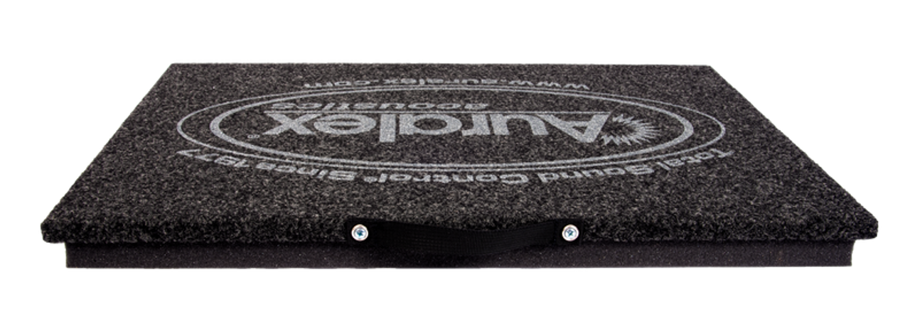

        Greg, maybe post the link and a pic if possible so the rest of us can play along
          THESE are supposed to be amazing for preventing sub vibrations from transferring to the floor itself. Word on the street is the they make the bass sound quite a bit better as well. They of course can't prevent the bass waves from passing through the floor.
