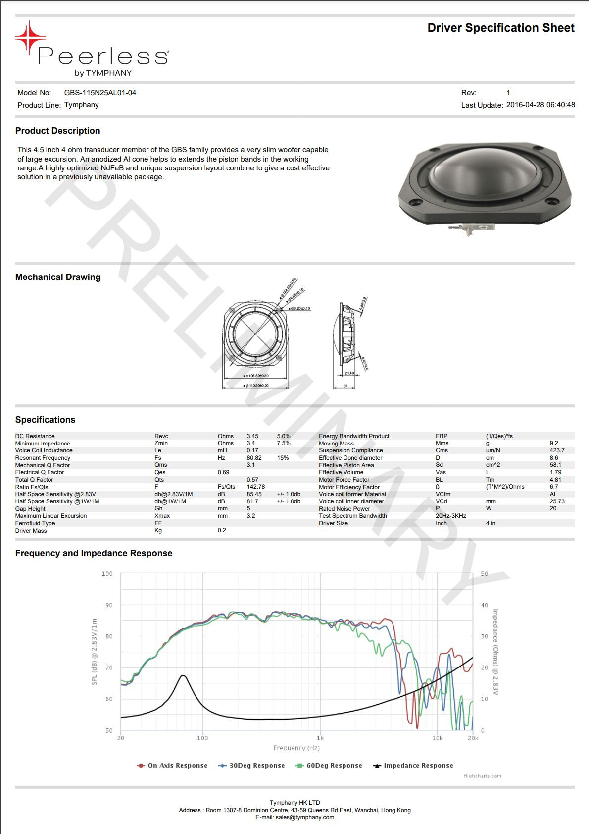

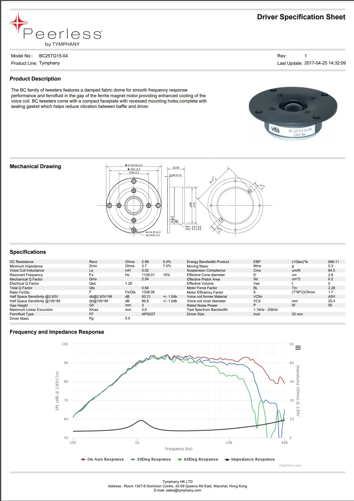

    To this end I have acquired a number of drivers to test and play with,

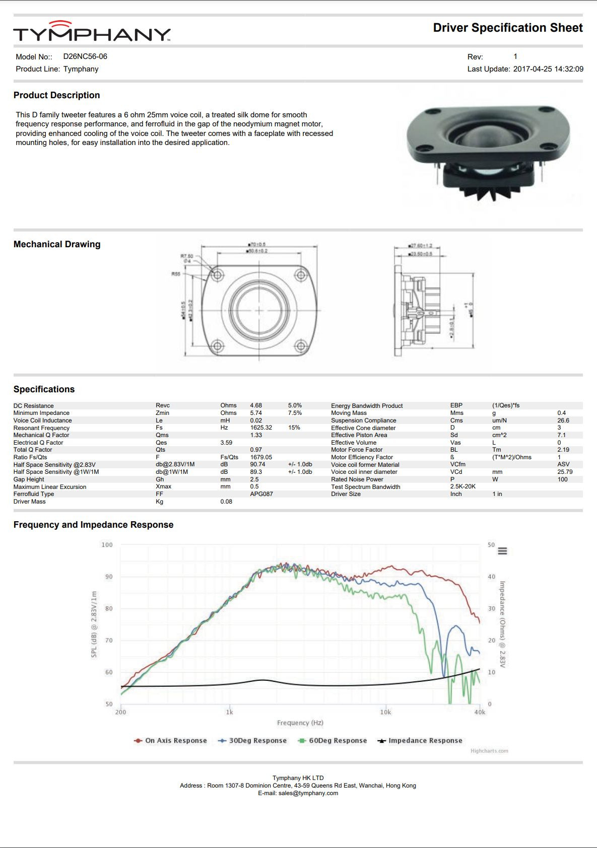

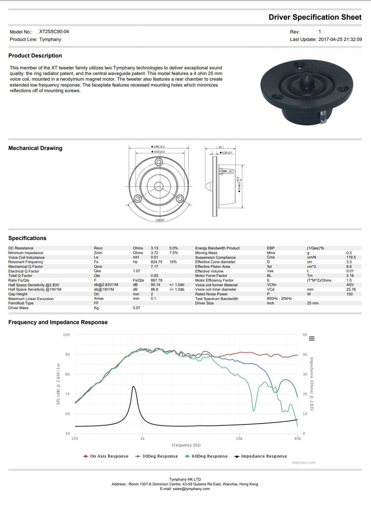

    Peerless Tweeters,
    $19.91, D26NC56-06
    $14.66, BC25TG15-04
    $13.91, XT25SC90-04

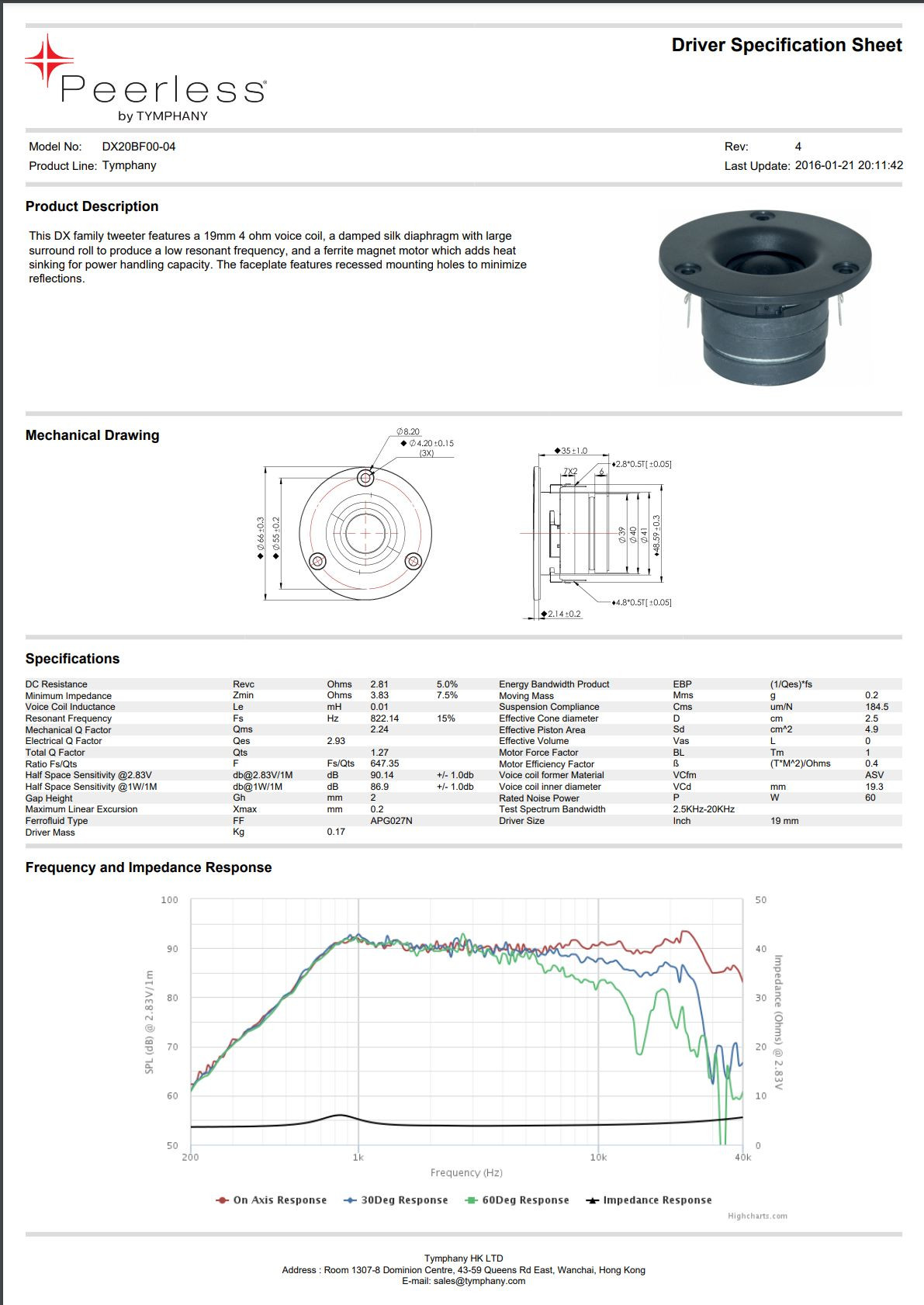

    $12.17, DX20BF00-04
Name:	D26NC56-06 spec sheet.jpg
Name:	BC25TG15-04 spec sheet.jpg
Name:	XT25SC90-04 spec sheet.jpg
Name:	DX20BF00-04 spec sheet.jpg

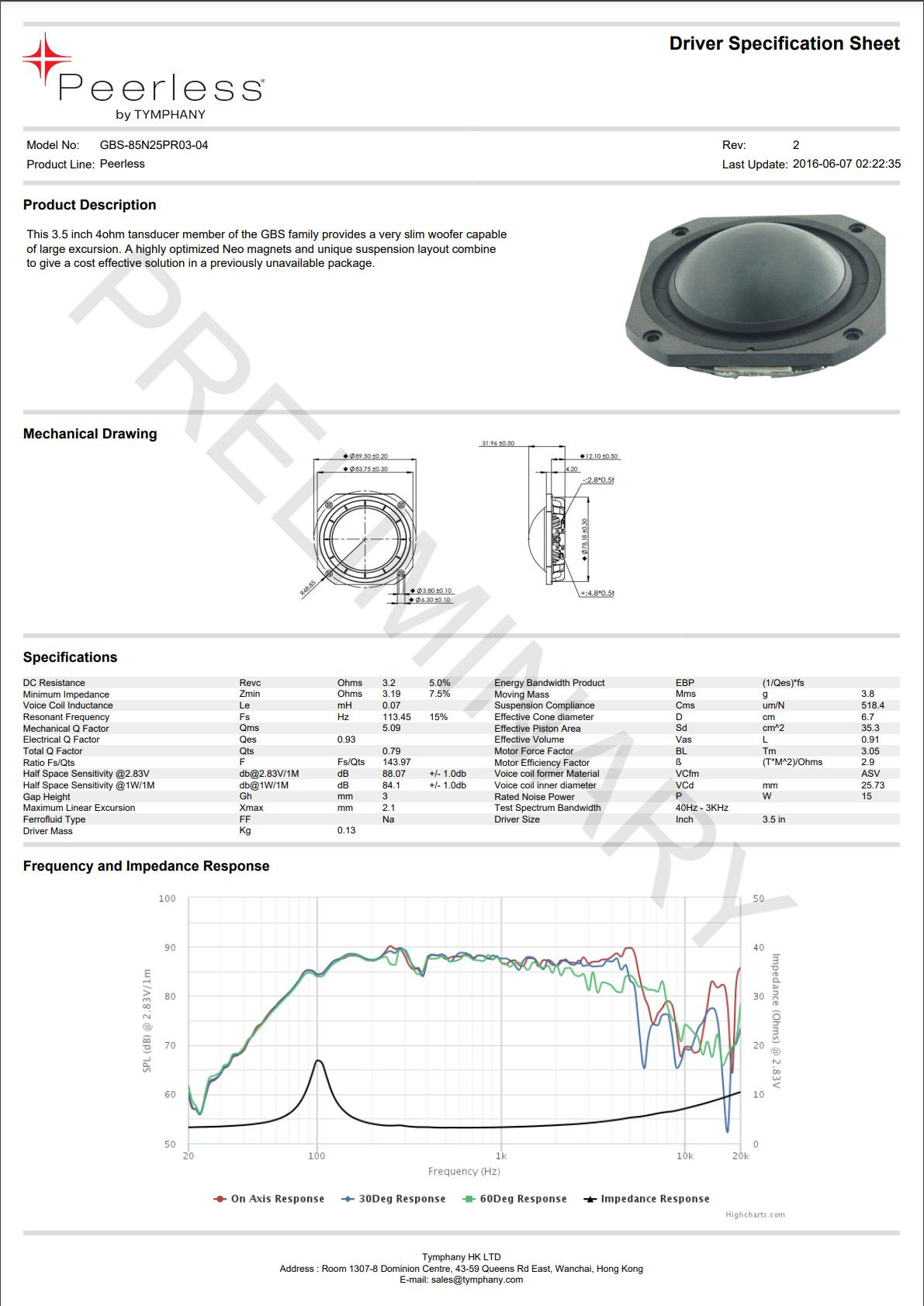

    Peerless Mids,
    $16.08, GBS-85N25PR03-04 (x4)
    $20.73, GBS-115N25AL01-04 (x4)

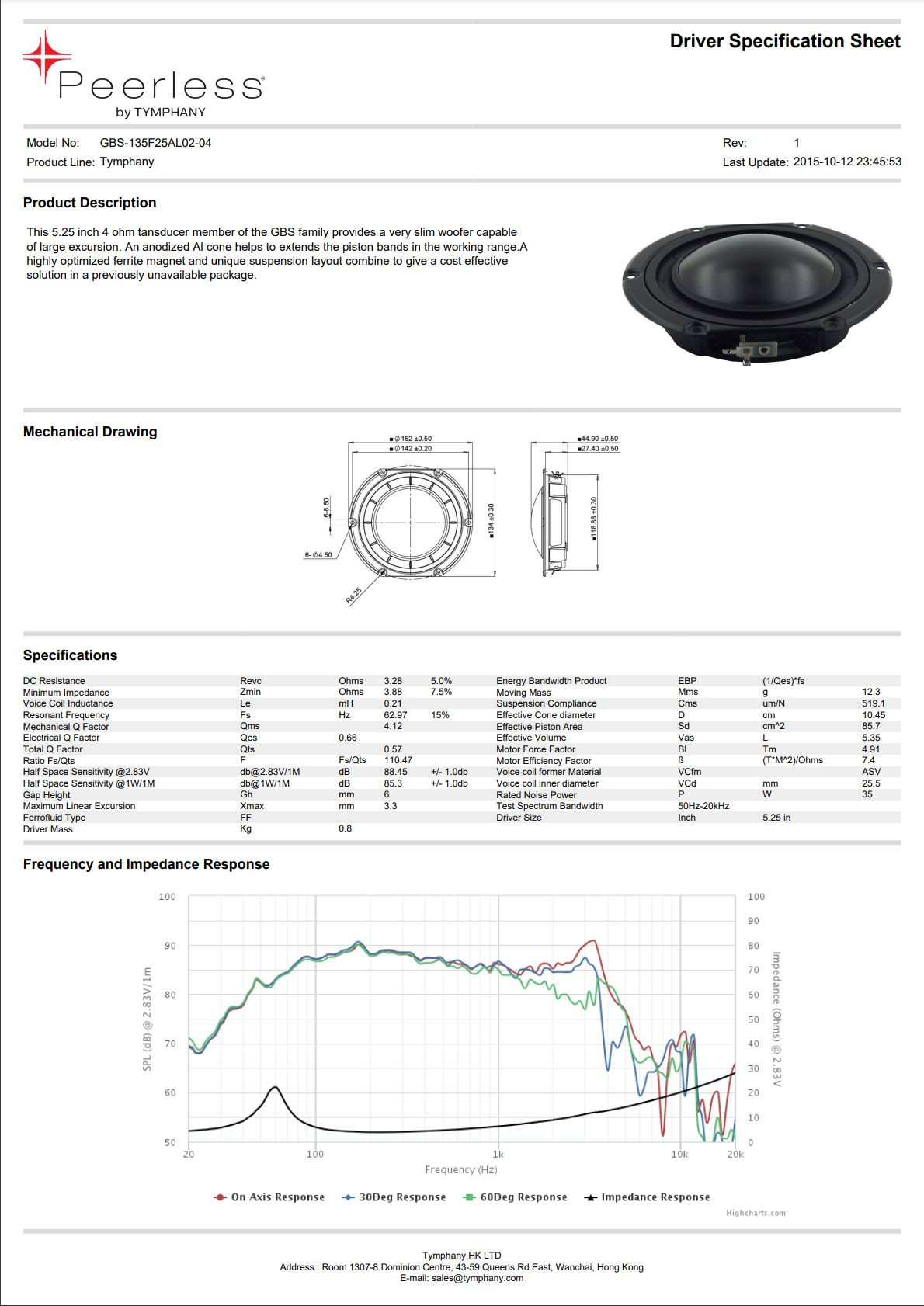

    $18.19, GBS-135F25AL02-04
Name:	GBS-85N25PR03-04 spec sheet.jpg
Name:	GBS-115N25AL01-04 spec sheet.jpg
Name:	GBS-135F25AL02-04 spec sheet.jpg

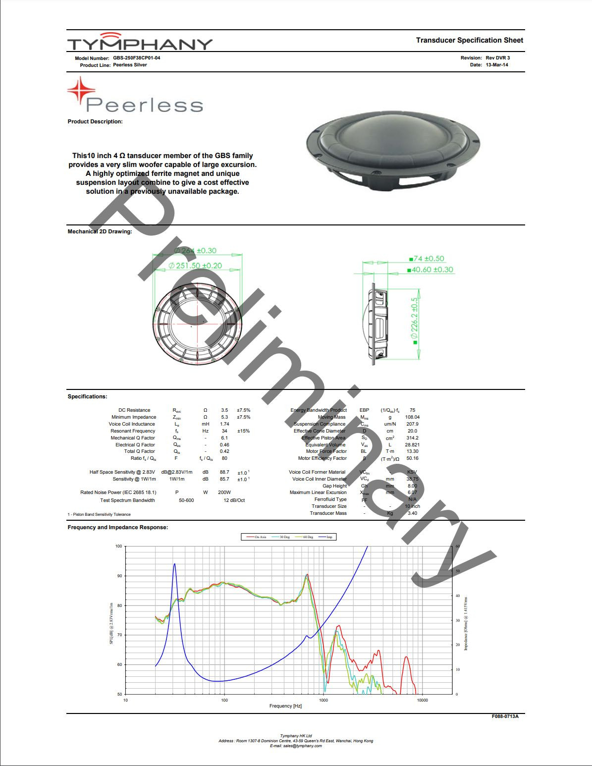

    Peerless Woofers,

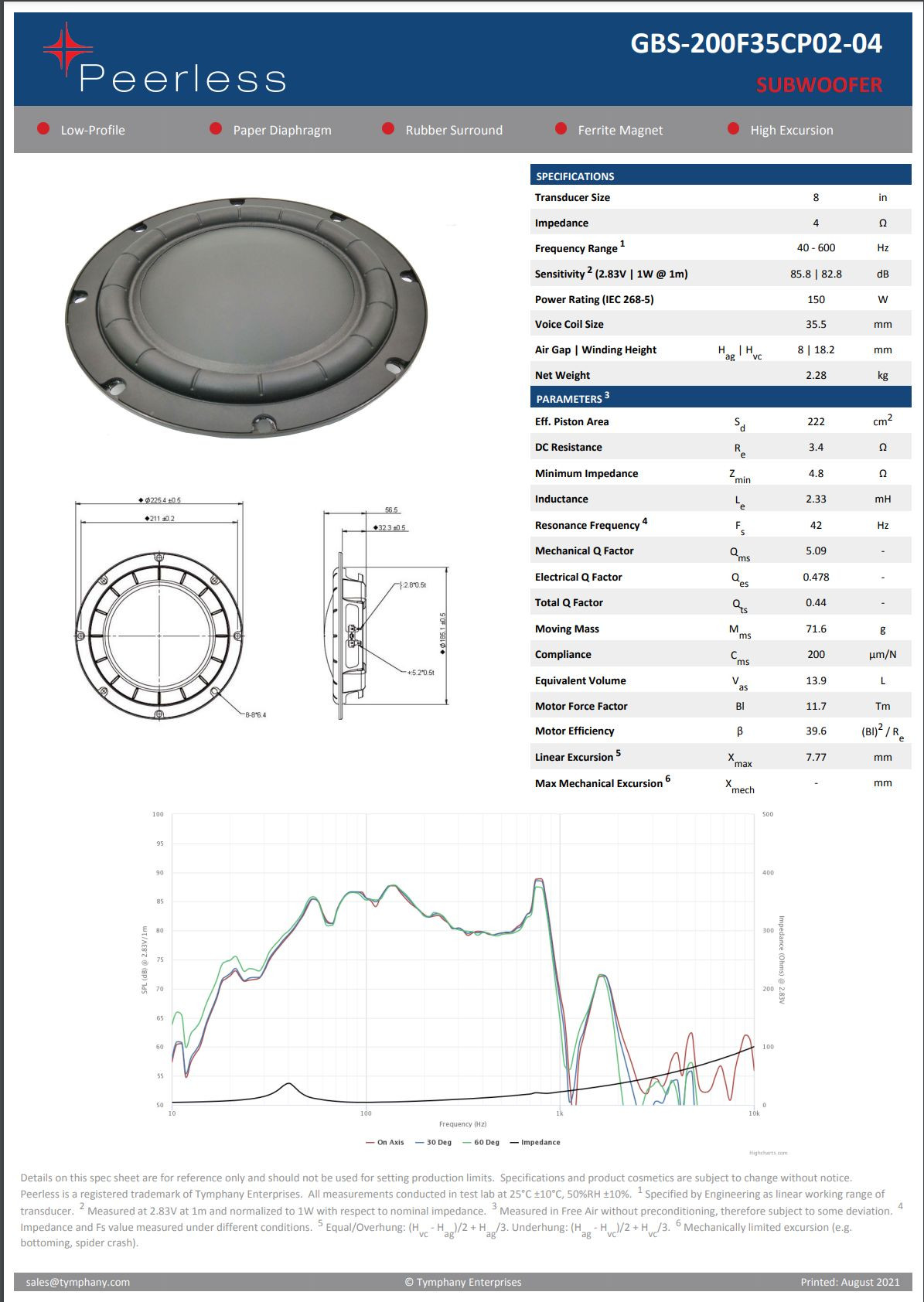

    $33.87, GBS-200F35CP02-04

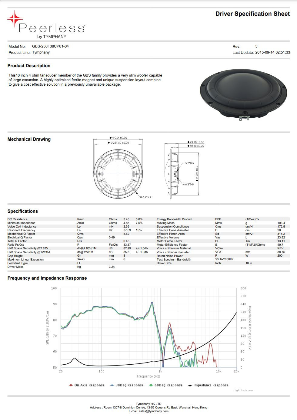

    $78.04, GBS-250F38CP01-04
Name:	GBS-200F35CP02-04 spec sheet.jpg
Name:	GBS-250F38CP01-04 spec sheet.jpg

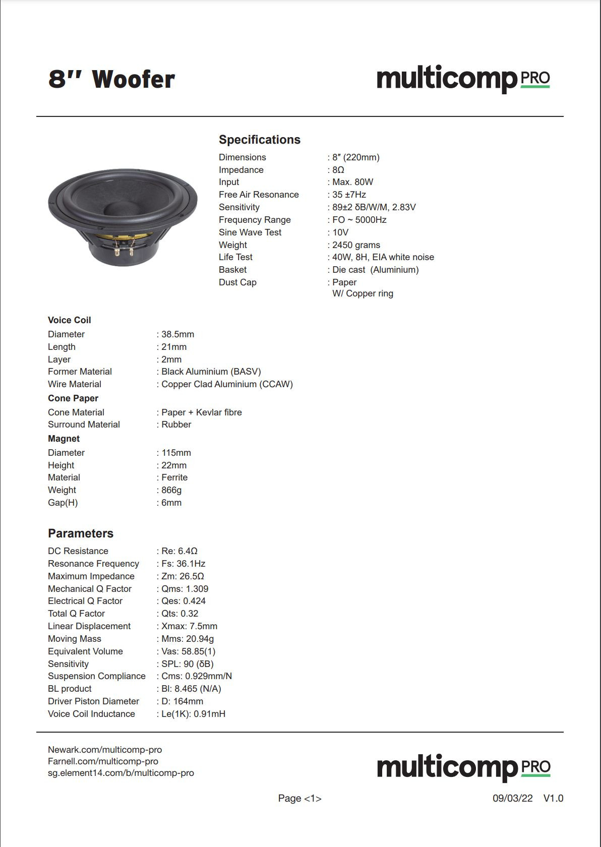

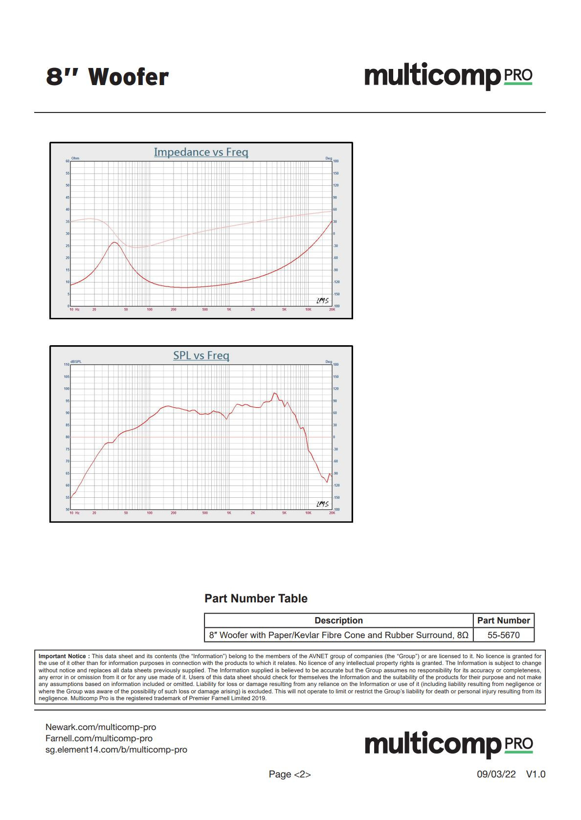

    Newark/Farnell Multicomp Pro Woofer,
    $39.99, 55-5670
Name:	55-5670 spec sheet 1.jpg
Name:	55-5670 spec sheet 2.jpg

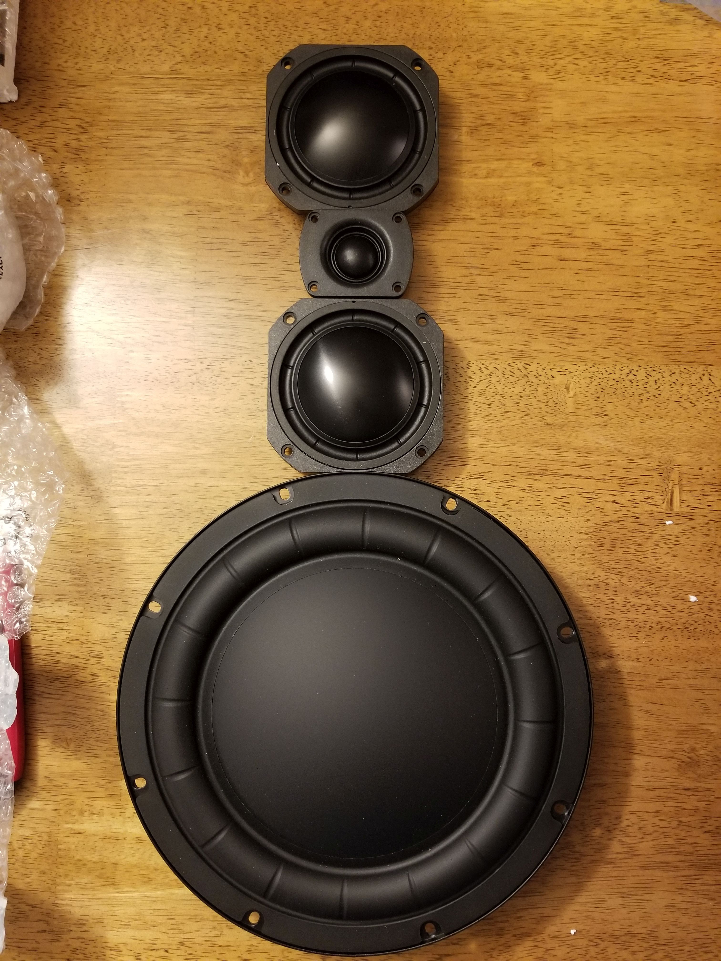

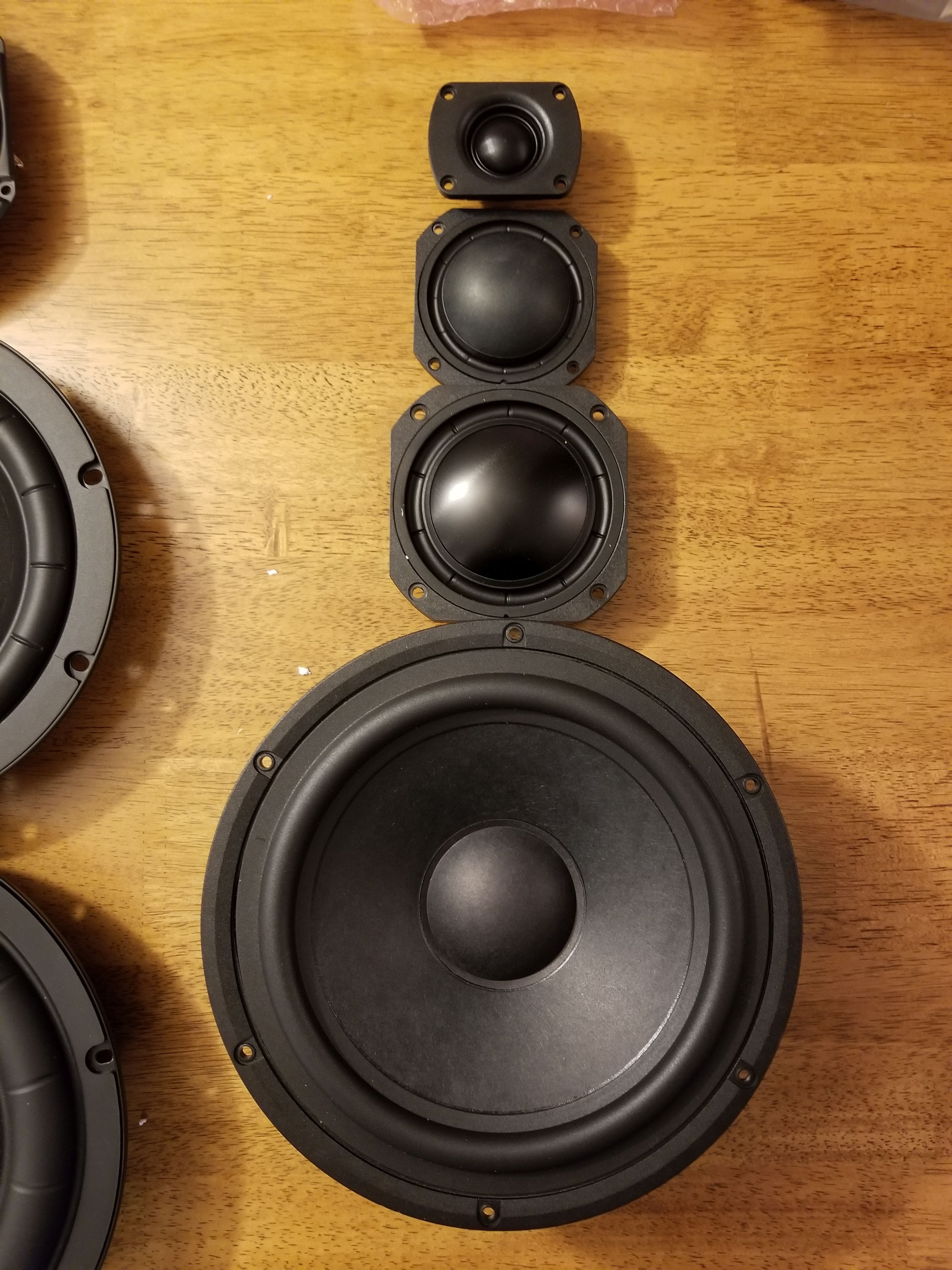

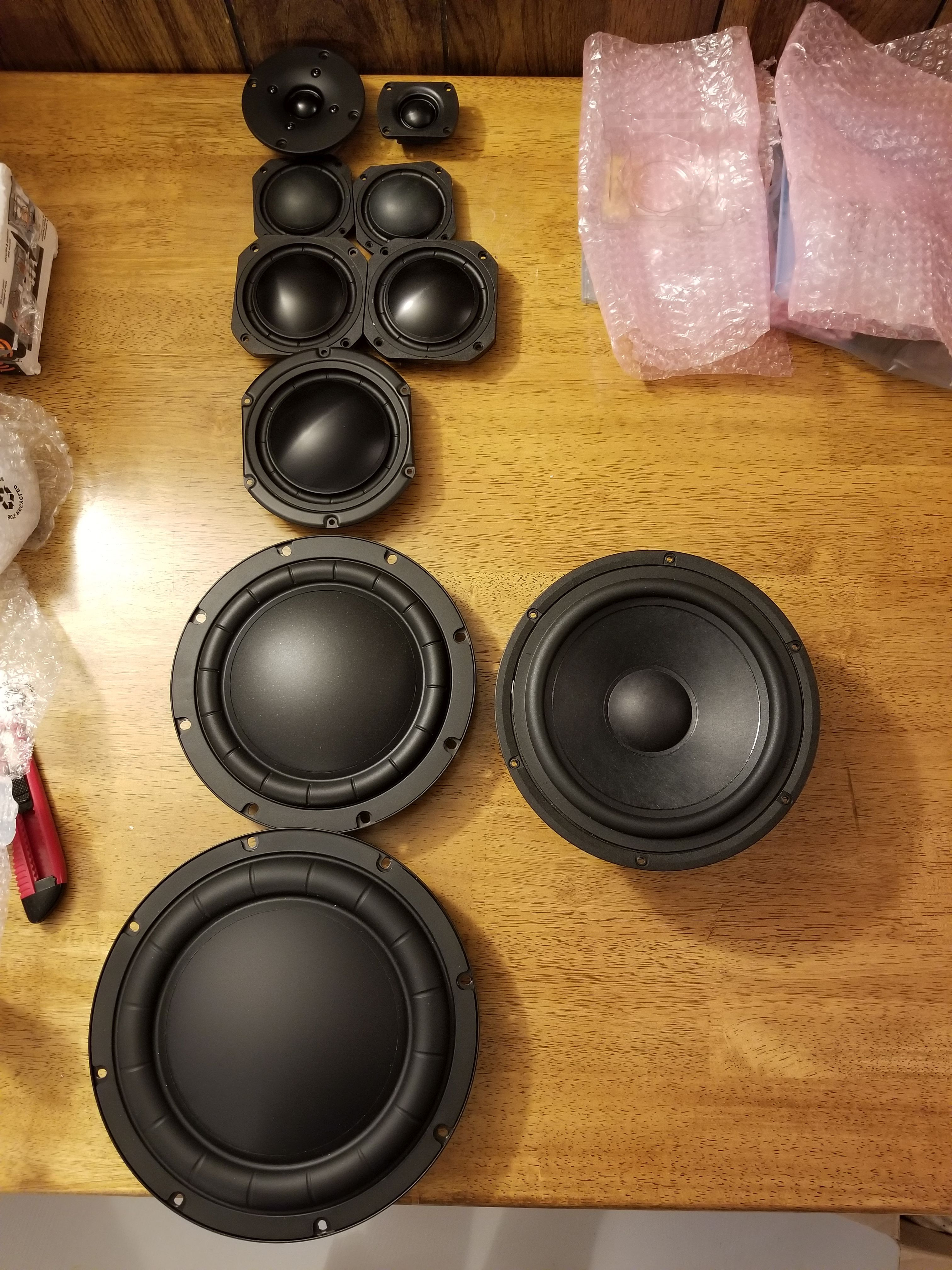

    Here is a pic of most of the drivers out on a table,
Name:	all drivers.jpg

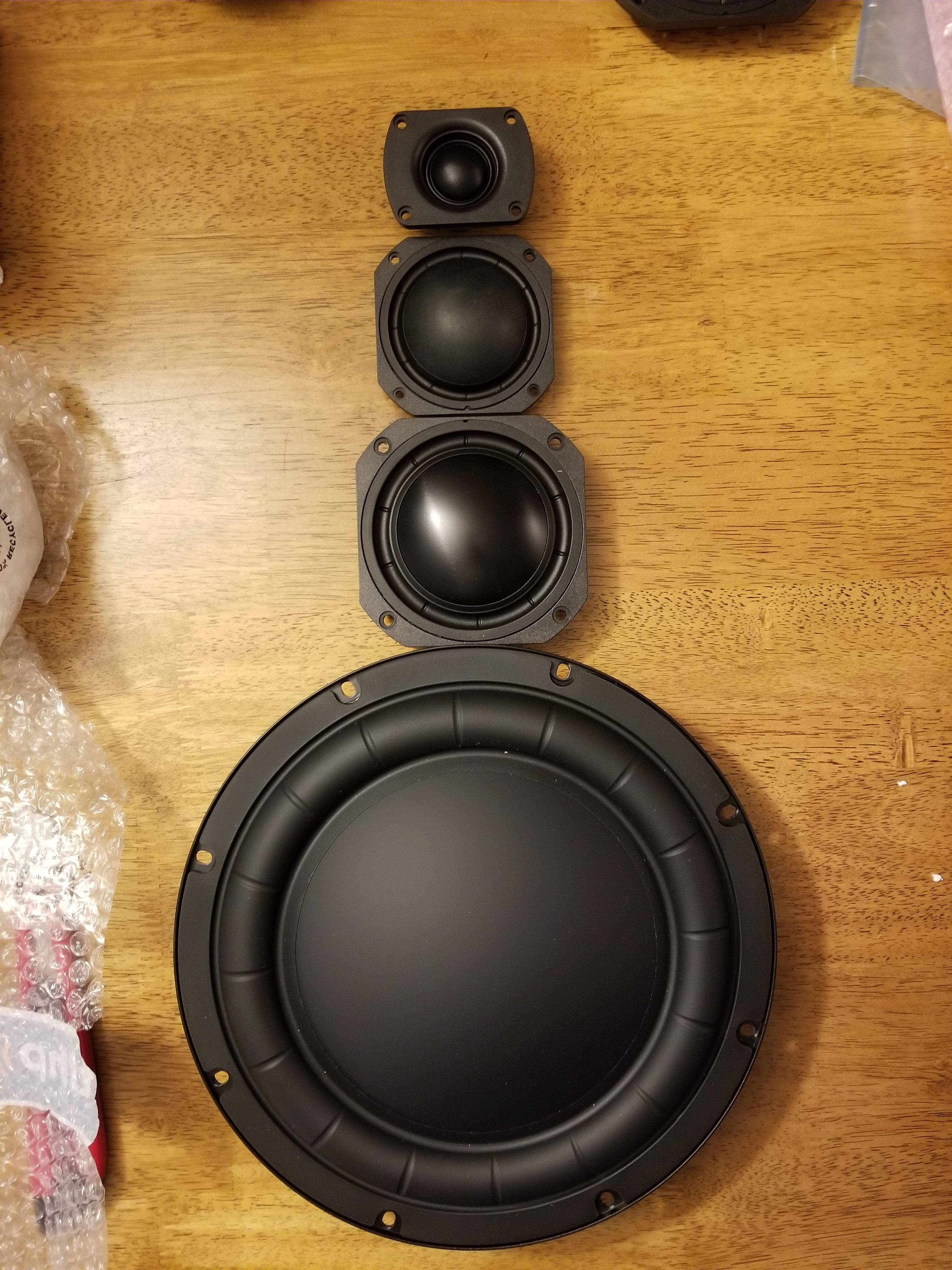

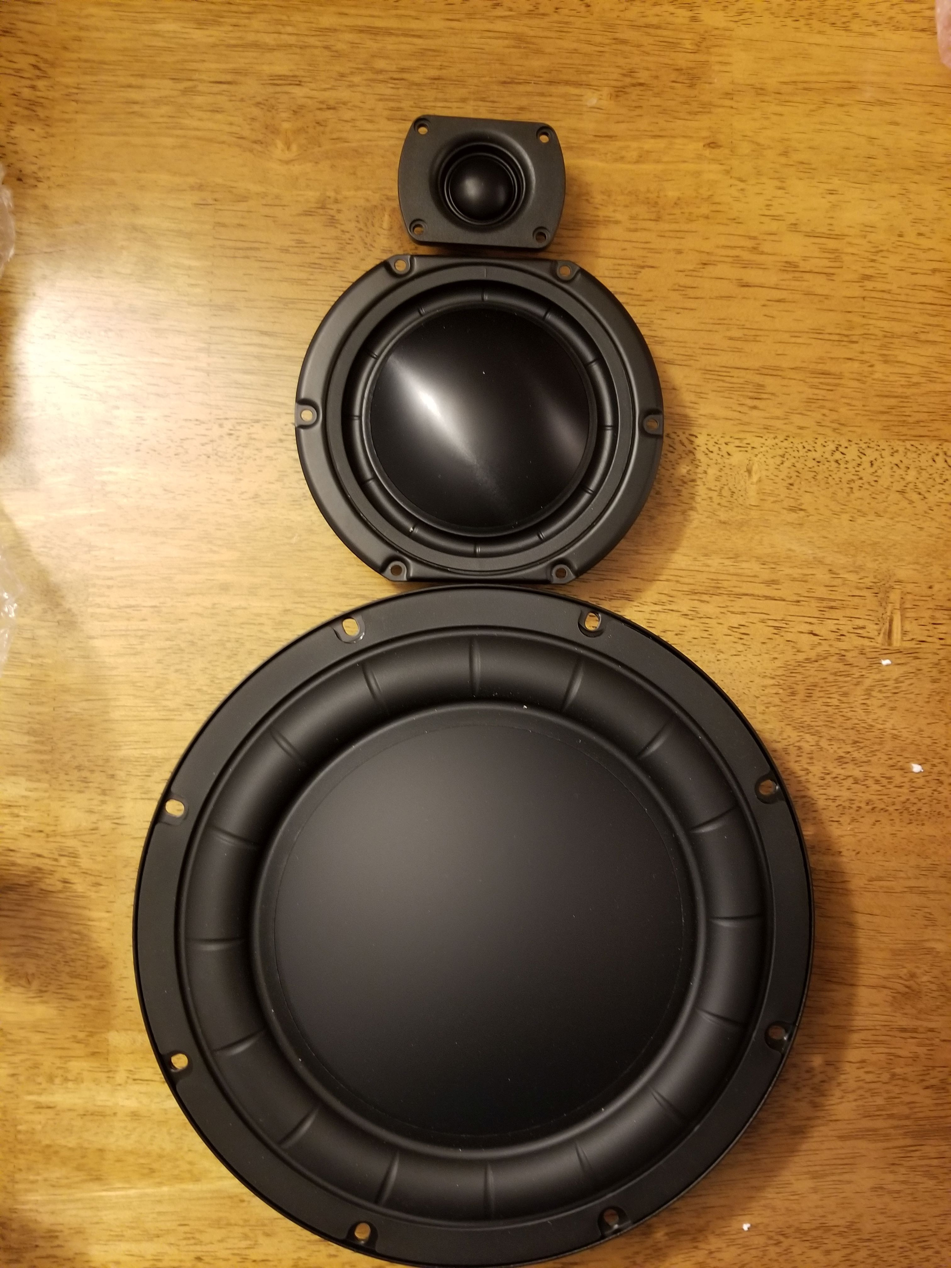

    And several possible configurations,
    $19.91, D26NC56-06
    $16.08, GBS85N25PR03-04
    $39.99, 55-5670
    total $96.71
    $20.73, GBS-115N25AL01-04​
    $19.91, D26NC56-06
    total $139.41
    $19.91, D26NC56-06
    total $134.76​
    $19.91, D26NC56-06
    total $116.14​
    You get the idea...
    I think I will come up with a standard box width and make a number of stacking boxes with single drivers in each, like stacking building blocks, to measure different configurations, at least in horizontal axis anyway to determine potential.
    (note, I think the Peerless 8" dome might suck, but time will tell...)
    Thanks for watching at home...
    David.

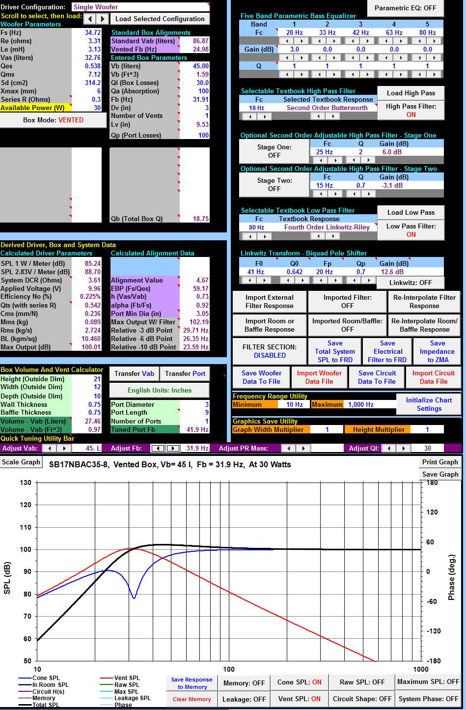

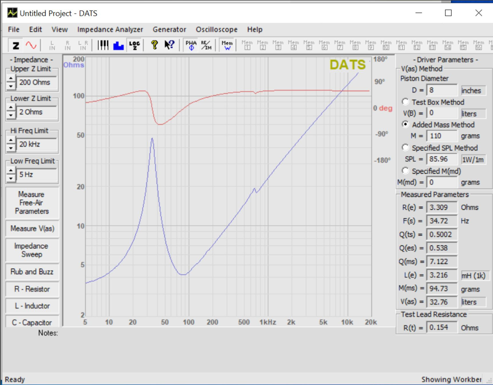

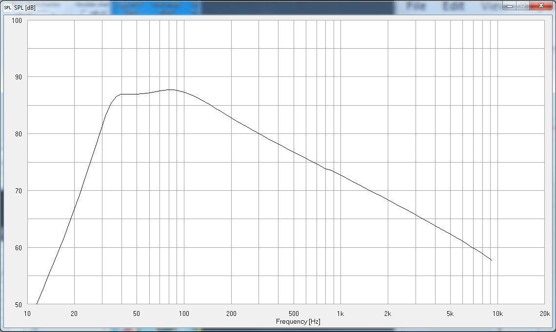

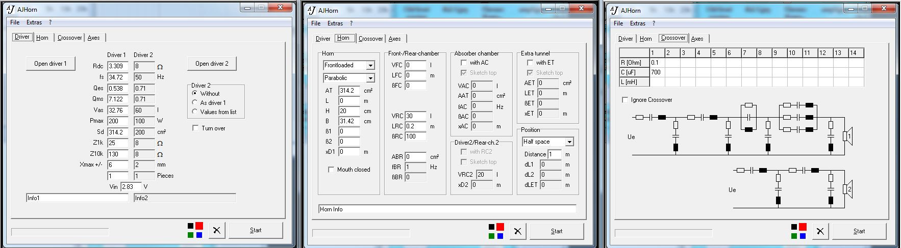

      The first driver I have looked at is the Peerless 10" "dome" woofer, ran a DATS 3.0 sweep and did some modeling,
      Click image for larger version  Name:	GBS 10 DATS scan.jpg Views:	1 Size:	319.0 KB ID:	949083
      Ported 45 litre box,
      Click image for larger version  Name:	GBS 10 Bagby ported box sim.jpg Views:	1 Size:	520.3 KB ID:	949085
      Then I was wondering how it would look in a German GHP (geschlossen mit Hochpass​/closed with high pass) sim'ed with AJ Horn 7,
      Click image for larger version  Name:	GBS 10 AJ horn setup.jpg Views:	1 Size:	198.1 KB ID:	949082
      Click image for larger version  Name:	GBS 10 AJ horn response.jpg Views:	1 Size:	112.2 KB ID:	949081
      Looks like a closed box of 30 litres with a series capacitor of 700µF yields an F3 of ~35Hz.
      I think I need to build a box for this and test it!

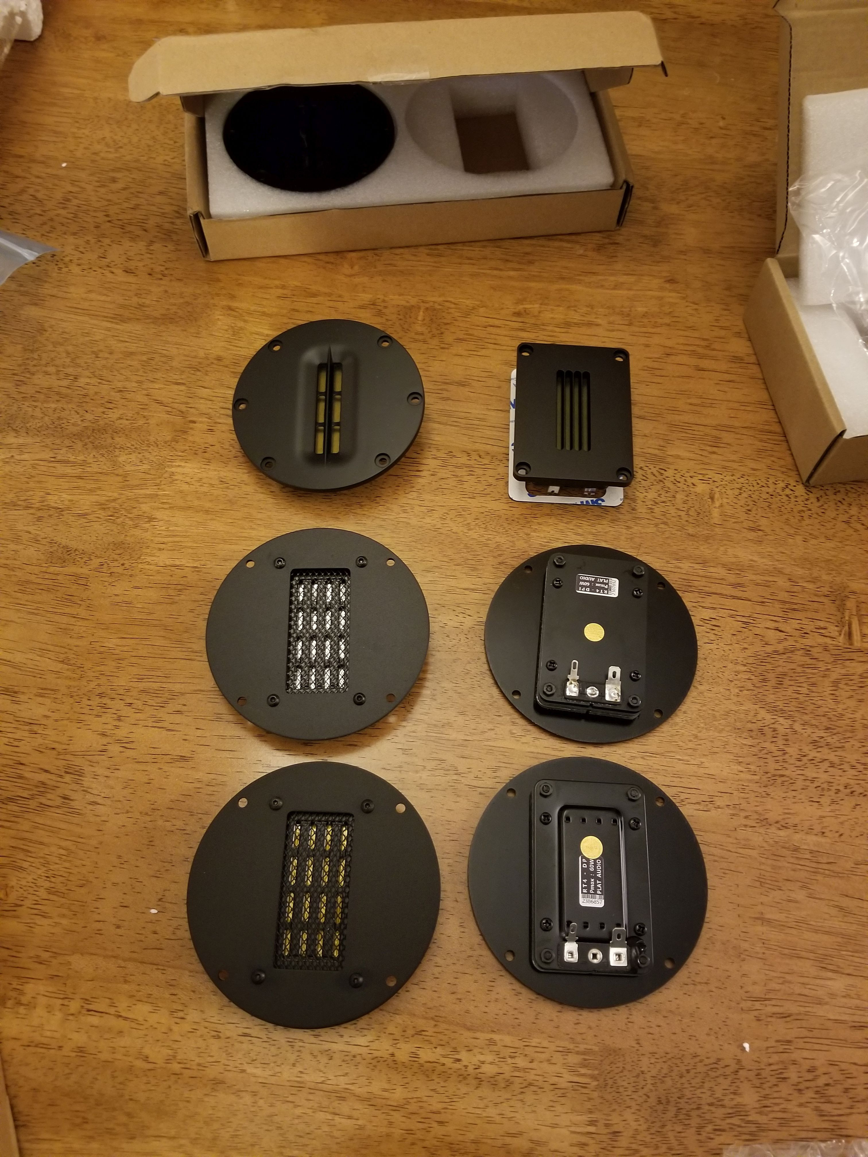

        Also had five maybe different Planer tweeters show up from Aliexpress and Taobao, very interested to see if these are useful or a waste of money. Prices range from ~$13.00 USD to ~$29.00 USD each, well within the cheapo budget of this build.
Name:	bunch of planer tweeters.jpg
