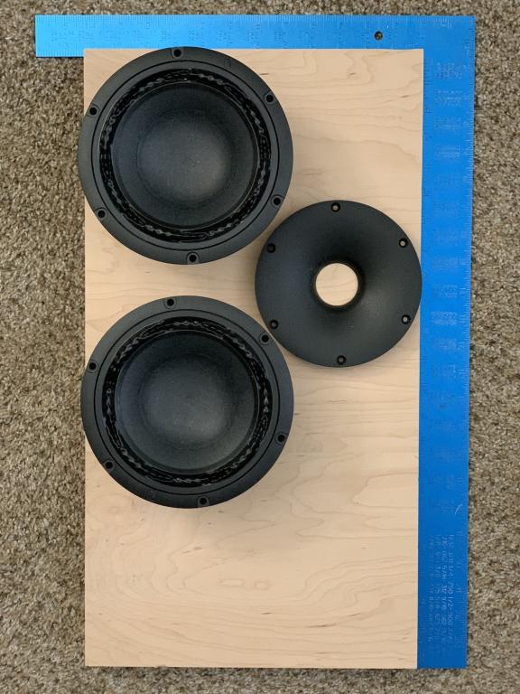

                        Well, we'll keep you posted as soon as I have time to get back to this. A shoot out between the RS180 and other driver solutions is planned. That could include SB Acoustics parts and Anarchy woofers.
                        There is also what we call a Natalie P Ultra in development- and the aluminum cone PuriFi 8 ohm woofers just got listed for ordering- so you can roughly imagine where that is headed. Also, it's intended to use a waveguide setup, most likely with one or the other version of T34. The T34A makes more sense, value proposition wise, as with the right crossover approach the break up peak and resonant mode amplification of distortion products can be dealt with.
                        I've done EDGE analysis of several driver layout, and the best performing ones are a bit bigger than the original NatP.
                        This is my favorite so far, and has given the best EDGE results, as regards baffle step behavior.

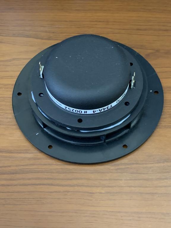

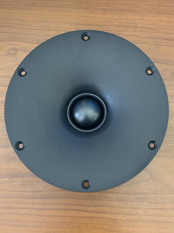

                        The waveguide experiment with the T34A was fairly promising, worked out better than I expected.
