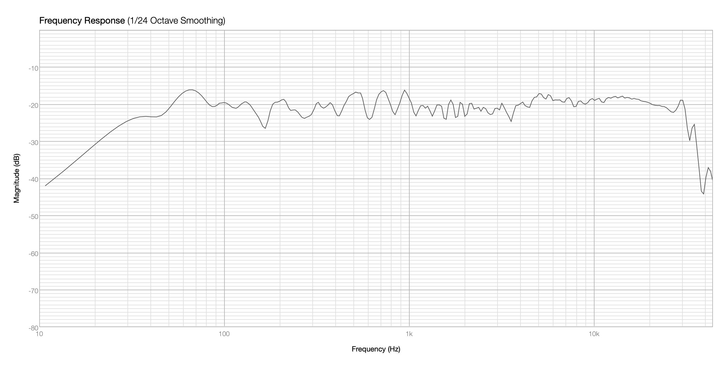

                    While reviewing the recently measured data and curious behavior of Jonmarsh's test system during Force Meditation, I sensed a disturbance in the Force due to what might be a control integrity issue with the CAM system...
                    Click image for larger version  Name:	Meditation Module.jpg Views:	0 Size:	566.0 KB ID:	928612
                    The unusual 60Hz response and the ripples in the measured response and some aberration of the calculated impulse from convolution of the since chirp response suggested the possibility of a signal feedback loop at higher output test levels... perhaps due to cross feed between the measurement channels.
                    A brief investigation today uncovered exactly this problem, partially due to a poorly documented monitoring control setup which could allow cross feed of both channels with repetitive presses of the monitor button...
                    Some of the previous example measurements were repeated, and the results are shown here... and comply closely to rational expectations.
                    LF output with Solen equipped Crossover
                    Click image for larger version  Name:	LF Solen Check SS.png Views:	0 Size:	80.5 KB ID:	928613
                    NAA Midrange output with recent component updates
                    Click image for larger version  Name:	NAA Sweep Check Update SS.png Views:	0 Size:	90.3 KB ID:	928614
                    ​​​​​​​Full spectrum Test at 1.5M
                    Click image for larger version  Name:	Isiris Full range 1.5M SS.png Views:	0 Size:	91.1 KB ID:	928615​​​​​​​
                    These results appear to be most satisfactory....
                    Of course, these events and outcome might suggest a lesson to be learned from this story...
                    Never send a moderator to do a Sith Lord's job...

                        To celebrate this milestone, I made a purchase from HD Tracks of the frequent evaluation album, "Fourplay 2020 remaster Greatest Hits" in 24/192 format for Mr. Marsh.
                        As a "hint", I present this measurement result in room with a very long gating window but 1/3 octave smoothing, as regards the overall balance and response. This is for the "value" version crossover using the PTT6.5M04-NFA-01 driver. with 250Hz and 1800Hz crossover points in LR3. All drivers connected in positive polarity.
Name:	Jantzen LF-MF-HF Value updated SMOOTH.png
                        The subjective results on a small selection of albums was most satisfactory...

                          #327
                          Wich tweeter is used? Do you like the mf version better than the alu-midbass?
                            • 1578
                            #328
                            Was this using the inline filter we've talked about previously?
                              #329
                              All of the current tests are with the TB34B-4 tweeter.
                              At this time, we will prepare another version of the NAA crossover, moving the upper crossover point down from 2250 (as both were originally designed) to 1800Hz, and may test it with the "value" version of the HF crossover, and probably prepare a modified version of the PURfectionist crossover with an 1800Hz crossover point.
                              The MF version was better subjectively than expected with the "value" build crossover; I plan to investigate whether this is due to an advantage in off axis polar behavior. The data sheets do not indicate any such thing clearly. Of course, reducing the crossover frequency for the NAA version may change that.
                              ​​​​​​​The NAA version has lower measured distortion- in reality as well as the data sheet, but both are well beyond the capabilities of more "typical" drivers.
                              ​​​​​​​The test cabinet will also be moved to a location in the great room that will likely be more "neutral" in the mid bass and on down, without nearby room doors creating a bass trap and variable boundary characteristic.
                              ​​​​​​​I am also seriously considering giving the crossovers a "subtle" switches level capability for midrange and treble in order to produce a relatively neutral presentation whether fairly close to a wall boundary or out into the room- this will require on the order of a 2dB step, based on current measurements.
                              At this time, there is no inline filter employed- the intent is to "tune" close to flat on axis, and let inline preamp modifications or subtle crossover switches modify the response from that point.
