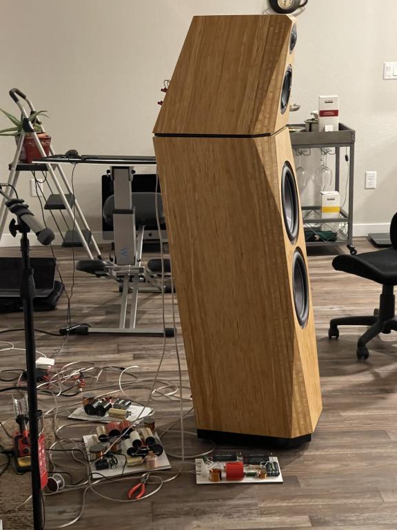

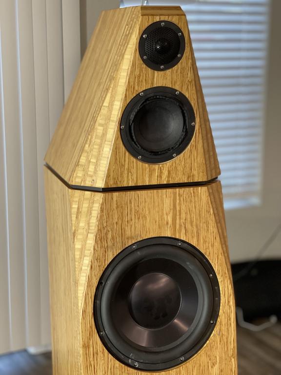

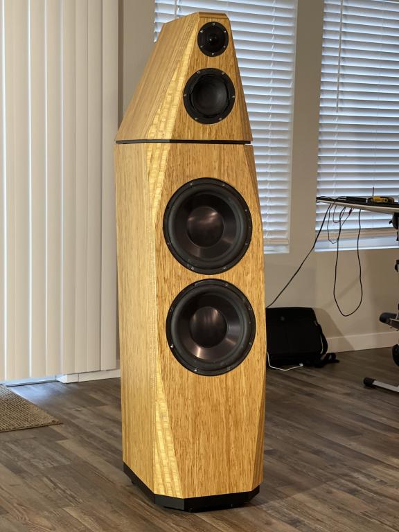

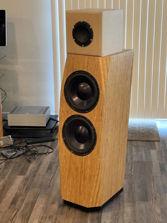

    Re-assembly of the first modified woofer cabinet was completed this afternoon... and if anyone thought the previous cabinet with Aurasound woofers was heavy (I did), then, as Bachman-Turner Overdrive would say, "Baby, you ain't seen nothing yet!" with the RSS315HFA-8 drivers, which must be about double the weight of the Aurasounds...
    But feels like more...
Name:	Isiris TA1 AssembledSS.jpg

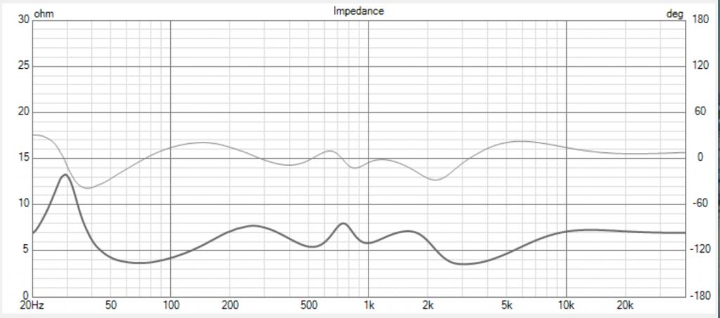

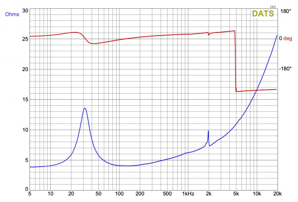

    Impedance plot has no surprises... sometimes I hate surprises! Fb is right where I expected based on Unibox and VituixCAD, about 32Hz.
Name:	Isiris-RSS315HFA impedance.jpg
    More measurements to come soon- possibly tomorrow. There's a lot of logistics travel on the agenda most of the rest of the week, though.

  • Efalegalo
    • Jan 2007
    • 162
    Damn, that's pretty!

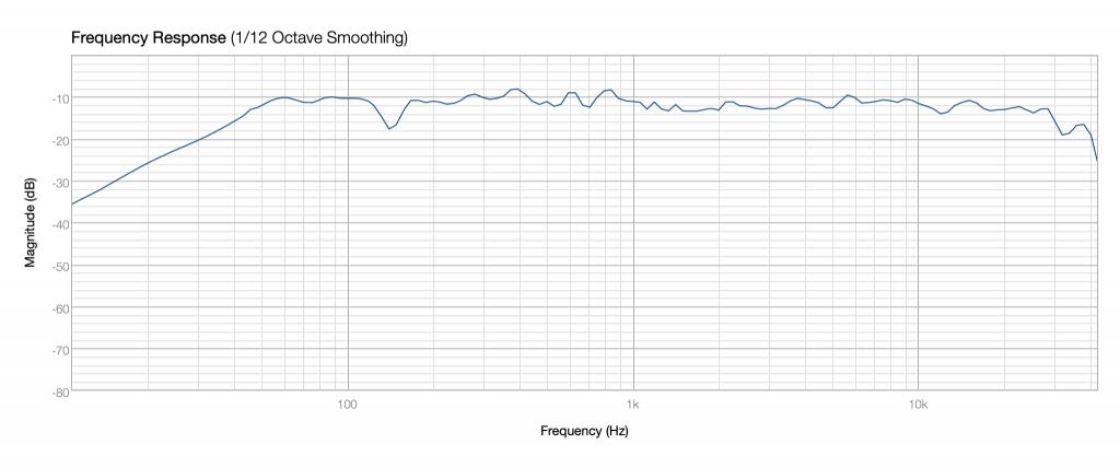

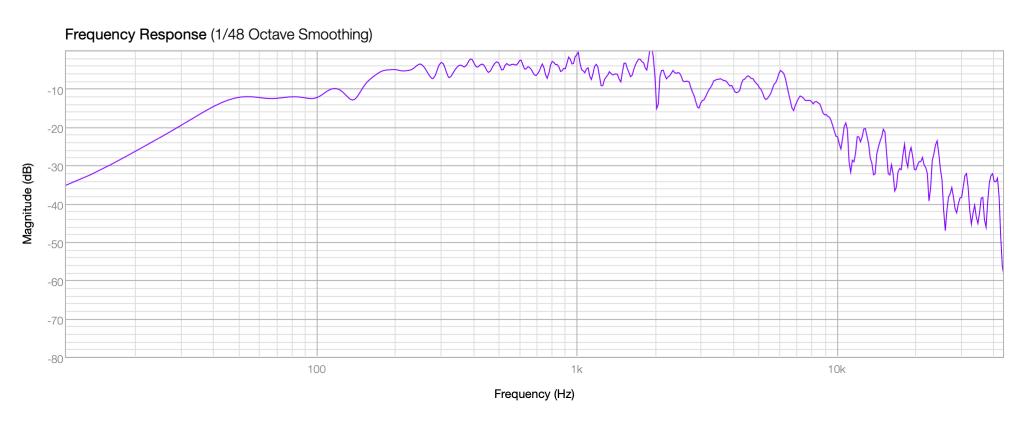

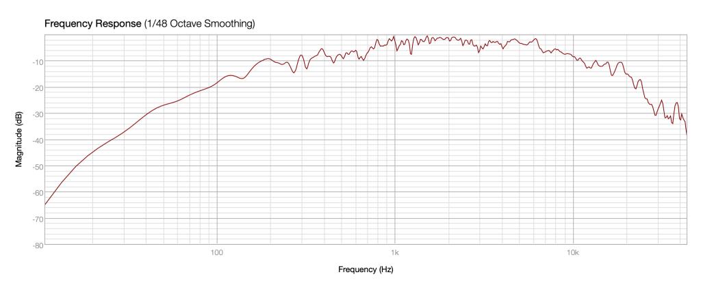

          Basic RSS315HFA-8 acoustic measurements
          Some more basic measurement data on the RSS315HFA-8 update-
          Nothing fancy here, had a very busy day logistically on a variety of topics including getting ready for the run to CA tomorrow (and another on Friday). But after a late lunch, I figured it couldn't be too hard to get a few SPL checks at different measurement distances, and get a basic HD2+HD3 check at "reference level", which is 2.83VRMS (monitored with oscilloscope), which for these drivers would produce (in theory) 91 dB in 2pi radiation (IB). Of course, the cabinet isn't IB, but it is big...
          This kind of measurement for this kind of cabinet is a bit of a tradeoff in setup because one wants to see proper baffle step, and one doesn't initially want to see tons of room reflections, and having two drivers complicates things (because they can interfere with each other causing dips or near nulls.
          So, this SPL measurement is at 1 meter (I'd recommend 2m possibly for a cabinet this size, and did take some additional preliminary data for FRD files for crossover development) and with Half-Hamming window filtering, but a reasonably long window (100msec) and with the cabinet out in the room like it would be setup for a Cardas style playback setup. Mic is centered between the drivers.
Name:	RSS315HFA CNTRD SPL.jpg

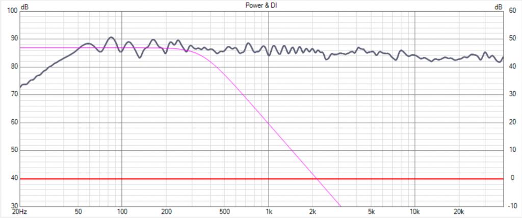

          No surprises here... and the SPL response matches well what is predicted with Unibox. With Cardas positioning there will be some boundary boost in the low bass below 40Hz, and things should be pretty neutral, though probably a bit warm in the 40-65 Hz area.

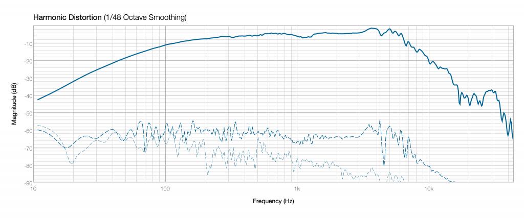

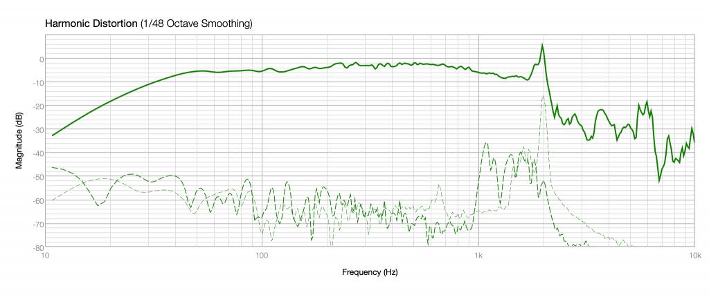

          The distortion measurement was taken under similar conditions, but a bit closer to NF distance- I.E., 24". No change in drive levels, though mic gain was adjusted downwards.
Name:	CNTR 1M Disto.jpg
          Interestingly, there's not much difference in the HD2 and HD3 levels... this is promising as regards the overall motor BL force linearity and cone positioning.
          Certainly I have no qualms about proceeding based on this data- though I have all the original measurement data, I'm going to redo those for the midrange and tweeter, and double check Z axis origin time alignment. But that will have to wait until the following week, due to planned travel.

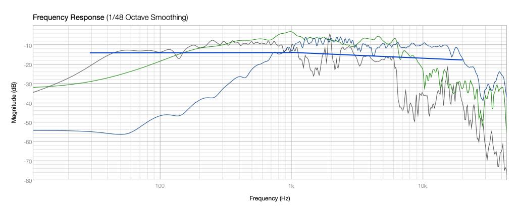

            Some more measurements completed in preparation for the crossover design
            Here are a few of the desired measurements before starting the crossover design, to fully assess if the actual in cabinet response matches my predictions and double checking former measurements:
            First, an overlay from one microphone position at the listening position, not changed for any measurements, along with what the expected target response level will be:
Name:	LVL CHK Overlay+Target.jpg
            Then, a couple of combination files to be used as an aid for double checking Z axis alignment with the individual driver measurements, and to illustrate the characteristics of the cabinet design:

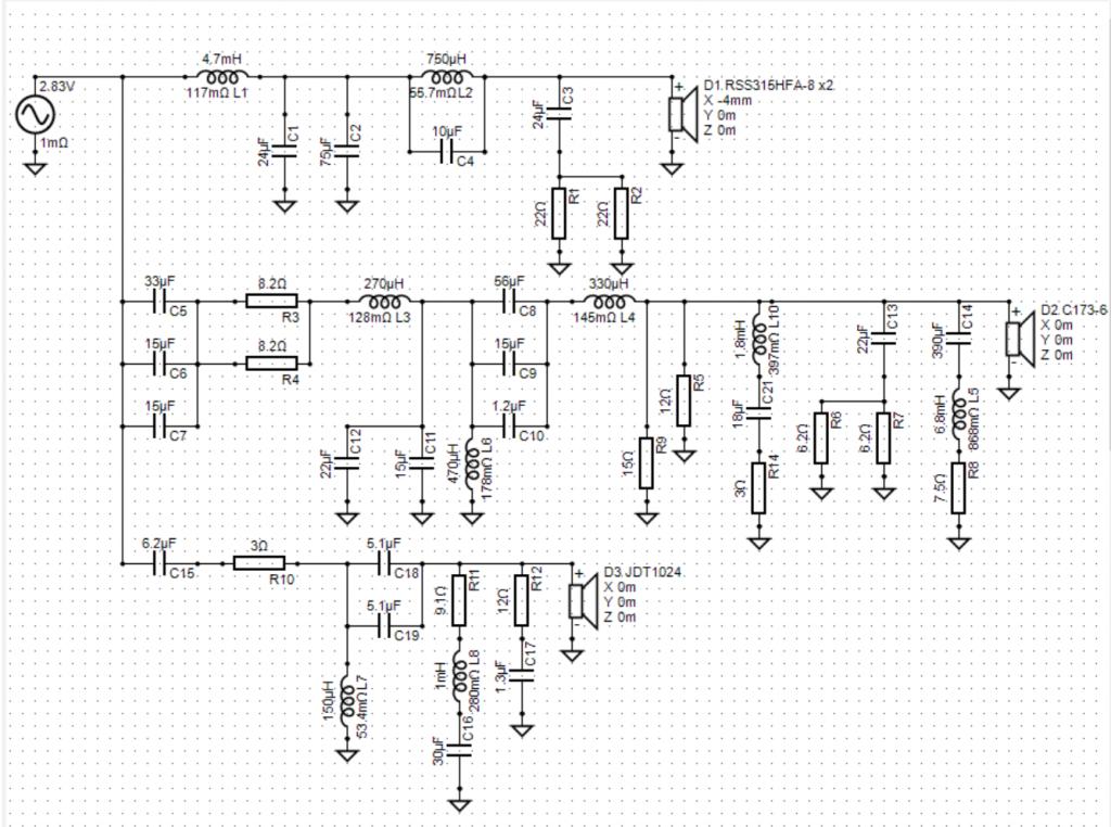

              Things came up with the real estate stuff that had to be addressed at the last minute, but necessitated skipping the planned trip to CA on Friday.

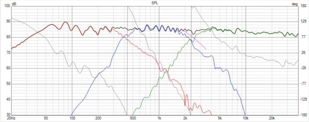

              But this gave me some time at home to work on a crossover trail design based off the TA6 update planned back in 2014. I'd say it's mostly looking pretty good, though NOT inexpensive!
              In this VituixCAD layout, I decided to do some of the component breakout I usually leave to preparing the BOM and component choices for the production schematic, as I already had a good idea of how that would to based on the TA6 schematic, for which I already have a full set of components (since 2014!)
              Nice looking results, so time to make a donation to Kimmo again. :T
Name:	Isiris VTX2 New Data TA7-5 XO-schema-1A.jpg

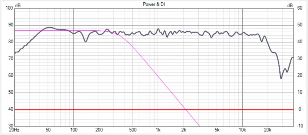

              Of course, with a 4 ohm woofer load instead of 8 ohm, that section will be completely redone. However, there were a lot of "adjustments" made so now I need to see what parts overall I will need when I'm ready to do a new build on this.. (which depends on free time availability - much logistics stuff still to do this summer)
              Crossover points are ~500Hz and ~2600Hz, based on polar response capabilities and driver distortion profiles at elevated playback levels (fancy way of saying "LOUD")
Name:	Isiris VTX2 New Data TA7-5 SPL-2.jpg
              With the need to up the SPL on the midrange and tweeter, to match the higher woofer sensitivity, the overall impedance does dip to 4 ohms a couple of spots- but the current phase is near zero, I.E., resistive, so this shouldn't pose problems for any normal 4 ohm capable amplifier, much less something like the Cambridge EDGE W, or Halcro DM68.

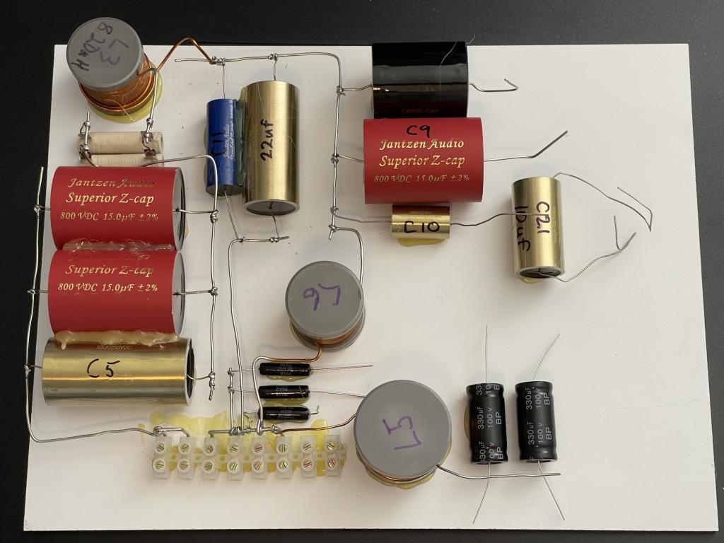

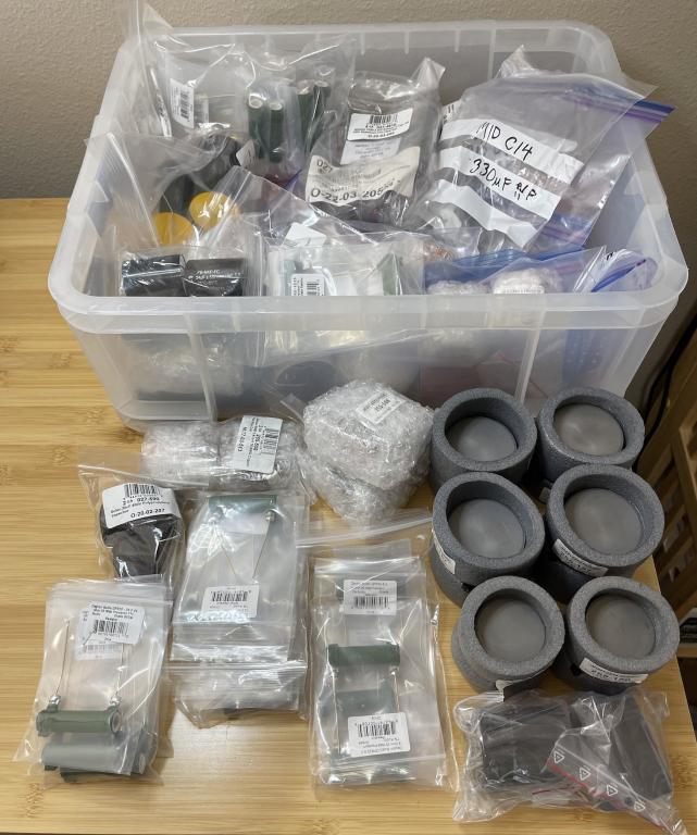

                too much multi-tasking going on- just got back from another logistics trip. Need to unload from that now.
                But all the crossover parts I ordered a week ago have been arriving, and getting sorted- ready to start board layouts as soon as I have some spare time.
                With Liubov's younger daughter's family arriving tomorrow from CA for a few days, that won't be for a while...

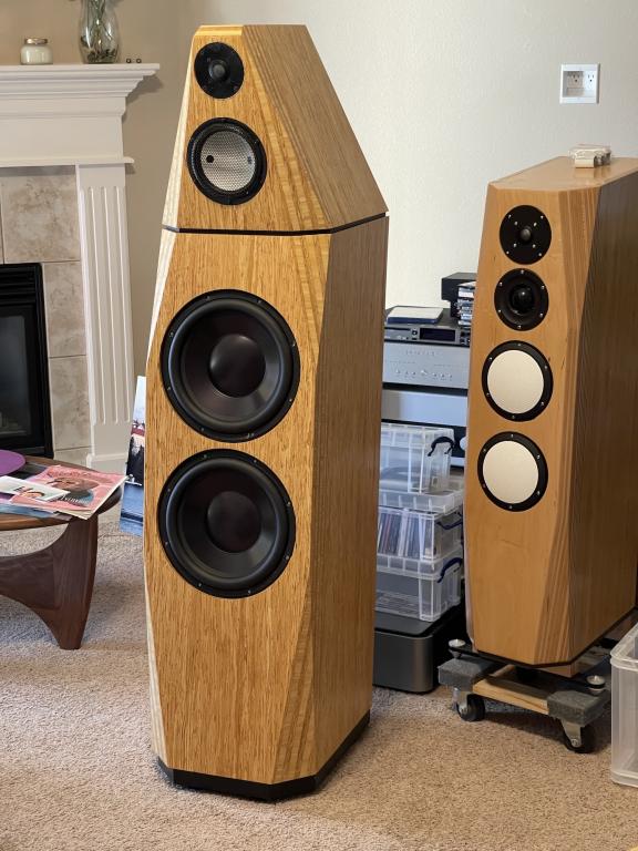

                                  A quick reminder regarding regarding the Osiris with pictures Michael took- note, his Isirs are quite a bit deeper, he wanted ported versions. It's the old monkey coffin problem. Construction material is MDF, if I recall correctly. Beautiful paint job.
                                  My Isiris, at Beverly's, back around 2015.
                                  Constructed with fossilized laminated bamboo plywood.

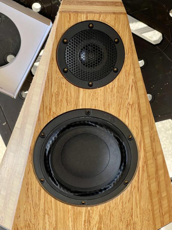

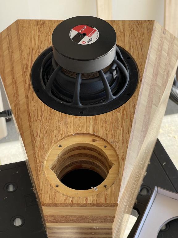

                                    just getting back to this...
                                    Dang, the last two months have been busy, but not with audio stuff!

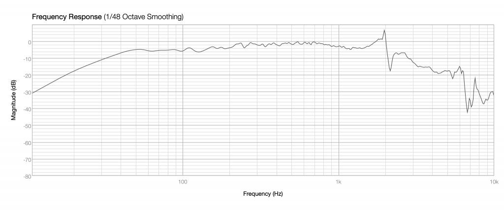

                                    However, I've measured the proposed PuriFi midrange driver in a small test box, and decided to proceed with that, and I'm moving forward in evaluating using the T34B (packed away in relatively inaccessible storage at the moment) and moving forward with T34A stand-ins.
                                    Quasi near field measurements show very good SPL and distortion characteristics, quite competitive with the C173-6-90, probably superior in fact.
Name:	PTT6.5MF04 Distor.jpg

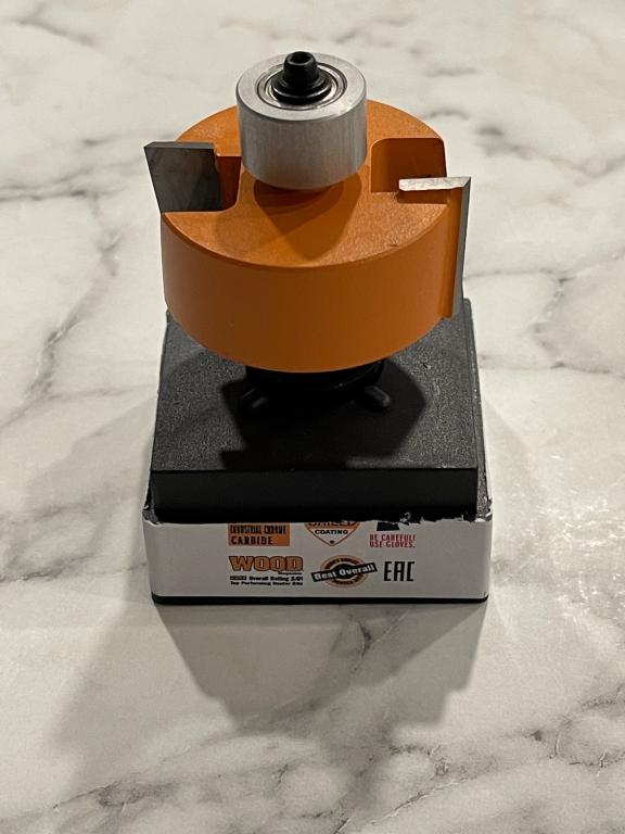

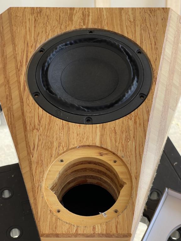

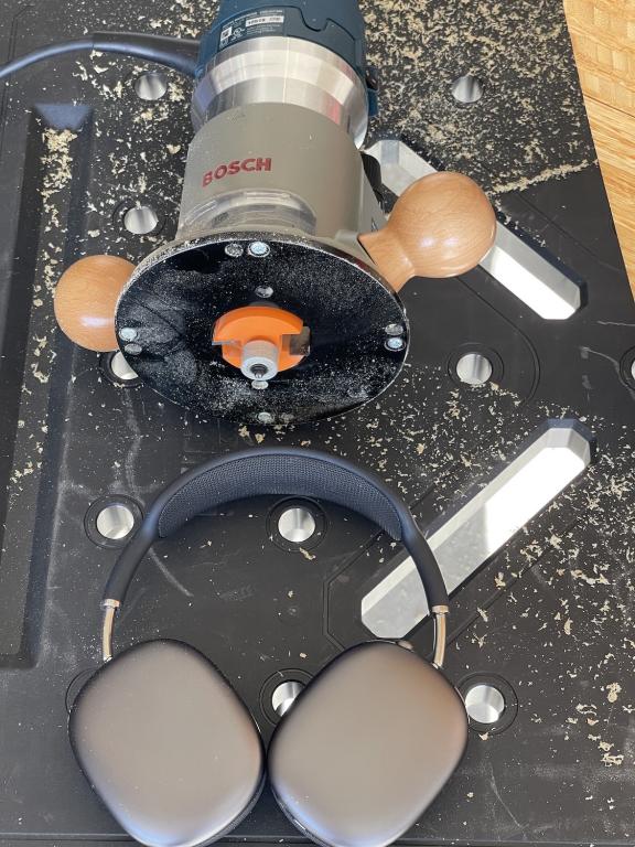

                                    The physical dimensions are not quite compatible for the rebate, but I have a rabbeting bit ordered that should solve that issue.
                                    I note with a little surprise that these are still not listed on the PuriFi web shop and don't seem to be available through PuriFi vendors yet- I guess it helps to know people and order direct for early samples. Maybe they're going to be OEM for a while.

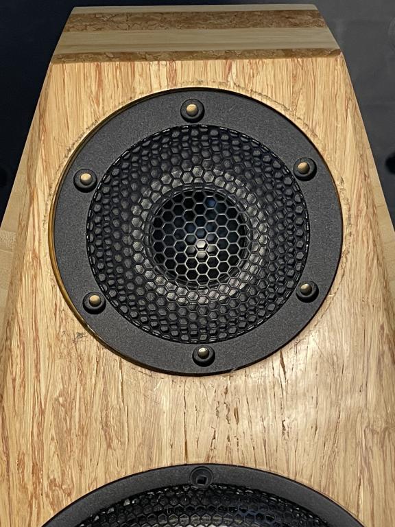

                                    This weekend I "verified" the mechanical compatibility of the tweeter- not that I expected any issues, based on data sheet information- even the input terminals are located in a similar fashion at 180 degrees.
                                    The new tooling should arrive this week, so I hope to have midrange measurements in the system enclosure by the weekend, as well as all the RAW FRD files prepared for the complete system.

                                            Originally posted by Bear
                                            The availability comment was more targeted at the C173-96E (?) -- or was the original using the -95E? I didn't think those were available to us mere mortals. The -96 is still on their site, but I don't see the -E anymore.
                                            The original midrange driver is a higher level of unobtanium, the C173-6-090. This one has the acoustic dampers and has a much flatter distortion plot, largely free of resonance amplification in the desired passband. Madison appears to still have some... at a fairly dear price.
                                            The C173–6–090 is a 6.5 inch midrange driver with ultra hard ceramic dome. Anti-resonant cutout fills in the ceramic dome provide for damping of the 6 kHz dome resonance.
                                            The 96 is not as clean and not as easy to work with, lacking the cone dampers, but it is less expensive.
                                            And the E version is pretty much gone, as you note.
                                            In the good news department, tracking data shows the special router bit has made it's way to the Nampa transit center from FL... should be delivered in the next day or so.
                                              • 16203
                                              Voila!!
                                              Delivered yesterday...
                                              Exactly what's needed, but not inexpensive... beautiful bearing from CMT. It should be, considering the price.
                                                    The new router and rabbeting bit were assembled today (I like dedicated tools- just a budget basic Bosch model) and since my ear guards are in storage, I figured I'd try my Ear Pod Max headphones with the noise cancelling turned on- worked like a charm.
Name:	Rebate Check.jpg
                                                    as calculated, from the inner hole, the 5/8" rebate was pretty much perfect...
                                                    And the data sheets didn't lie, the inside holes required were essentially identical.
                                                    So, just to get a peak at the new esthetics...
                                                    Now I've got to review the cables and connectors and back plates, and decide how to proceed- I'm leaning toward keeping the Kimber cable and existing plates for measurements, maybe for crossover prototyping, but I've got a mess of 4 pole SpeakOn connectors and cables, and 90% sure I'll update to those in putting the final configuration together.
                                                    Now I've just got to put this back together and get some measurements in this cabinet.
                                                      My god the perspective on the Purifi driver, with its wonky surround, does weird things to the eyes in those images.

                                                        Maybe my eyes deceive me, but is that a double height guide bearing? I could make use of those...
                                                          • 16203
                                                          Yeah, the guide bearing is at least double the usual value, that and the OD, plus meeting the unusual 5/8" requirement are what decided this one for me.

                                                            Time to realize the power of the Dark Side
                                                            Now we are ready to realize the full power of the Dark Side in the three way design study.
Name:	DarkMid Closeup.jpg
                                                            I clearly see the potential of these new drivers... after all, black is back!
                                                            Do note that this project is a further development of the original "Three Way Evil Design Study" initiated in 2012...
                                                            I will be watching closely over Jonmarsh's shoulder to be sure that his ongoing efforts fulfill my original vision...
                                                            It would be most unfortunate if they do not- one need only to consider the fate of Grand Moff Tarkin

                                                                      A surprising amount of work later...
                                                                      Slow work takes time... and planning.
                                                                      This is just a quick post to share my thinking and some points about targets and progress.
                                                                      Oh, and I have another simulated frequency response plot, that doesn't look all that different, but a number of issues have been addressed with positive results.
                                                                      First, I'll share my base targets and concerns, and how that impacts design.
                                                                      • New midrange and tweeter, and woofers, hopefully all working together to provide a lower distortion floor, and likely some increased output capabilities
                                                                      • New crossover points to optimze based on THESE driver capabilities- in practice, this meant the woofer to midrange crossover frequency was lowered slightly, taking advantage of the new midrange driver output capabilty, and the tweeter crossover point was lowered slighly for the same reasons.
                                                                      • System sensitivity is raised to 86-87 dB range, BUT, as all driver sections are now 4 ohm loads, special attention had to be paid to keep the impedance up, especially in the low frequencies, and hit target responses without creating a current monster like the Avalon Indra or Isis (look at reviews, see LF load reaching 2 ohms in mid bass).
                                                                      • Phase tracking is always important, and the easiest test of that is reverse null behavior; the updated network fares far better than the one responsible for the first shown SPL graph. Yes, as is often the case, the SPL graphs look quite similar... but the underlying behaivor isn't. That's always a significant part of the challenge, and necessary to avoid off axis lobing.
                                                                      • Only a single measured axis was used for this "rapid prototyping" of the network design- I've found that the 15 degree axis is usually represenative of a significant part of the total power response, as well as the a plausible listening axis- and as the drivers measure nearly the same at 30 degrees, the 15 degree axis data was used for fast development. Putting these cabinets on a turntable is not realistically within the ken of most mortal men. Of course, ET could manage it, but he wasn't available when measurements were done. We still can't do anything about earths gravitational field.
                                                                      • Yes, there's lots of little wiggles in the data files, because even in a large room that's what's happen when you capture at 1/48th octave smoothing with reasonable duration measurement windows for capturing data. No makeup or wigs here to make things prettier.
                                                                      • ALL of the drivers have notch filters for upper end breakup, to tame resonance amplification of distortion products as well as bury as much as possible the resonant peaks from affecting the base response. Looking at the result, you'd never guess ANY kind of BlieSMa T34 tweeter is used in the top end. Breakup peak? What breakup peak? Even the T34B would require this kind of network, and I think it would be interesting to see if there is a benefit to the B version or not if both the A and B have such a network correctly implemented for each dome material type. We'll get to that some day.
Name:	Development SPL TA8-9.jpg
                                                                      Next task is to put together an actual component BOM, and check the bins for parts already on hand!
                                                                      While I had what I thought was a good first pass crossover design for the RSS315HFAs to go with the original midrange and tweeter, that has gone by the wayside.
                                                                      • tktran
                                                                        • 703
                                                                        Looks great.
                                                                        I too, have found that sometimes looking at the 15 degrees off axis is instructive, because it's not filled with all the lumps and bumps of the diffraction effects, and I get overly distracted trying to massage it all out.
                                                                        How did you settle on the 400Hz HP pass on the Purifi? It looks like it could take 200Hz or so..
                                                                          • 16203
                                                                          Originally posted by tktran
                                                                          Looks great.
                                                                          Past experience with the earlier version which ended up using a higher crossover point, and with the X1 SLAMM clone;
                                                                          wanting to keep the excursion down on the midrange at high SPL,
                                                                          Wanting to keep the crossover cost as reasonable as possible; (remember, system cost down with improvement in performance was 1/2 of the dual goals)
                                                                          Well designed motor of the RSS315HFA means that distortion is monotonically decreasing with increasing frequency to beyond 1kHz on the top end; very similar to the Aurasound woofers. And quite different from most 12" "sub" woofers.
                                                                          location of effective BSC for the bass cabinet versus the midrange module
                                                                          Keeping a taller source up to 350Hz at least, and minimizing floor bounce effects.
                                                                          Foiks have commented on why I had relatively high crossover points on the Wavecor Ardents, too, but it was for the same reason.
                                                                          It's handy to take a electronic crossover with variable frequency points, like a variety of the Behringer models, and like the ones I used to design for the company I worked for back in the late 70's, and explore in real time the basic impacts.

                                                                            Well, I was expecting the 2nd batch of crossover parts to be delivered today, 2nd day UPS air, but I guess, 'tis the season, and now UPS is saying Friday. Disappointing, as I have the first woofer, midrange, and tweeter boards close to completion...
                                                                            Although I'm exercising reasonable care in the overall system design to keep costs down, including the crossover, a solid build with key parts of high quality won't be inexpensive- around $800 per speaker for the complete crossover BOM, not including boards and connectors. A lot of that is premium capacitors in key locations in the midrange and tweeter crossovers.
                                                                            So, a sneak preview of the test board being built for the midrange- some parts not in yet, but it's getting close.
                                                                            This is pretty compact compared with the original Isiris midrange crossover.
                                                                            So far, things seem to be on track for bringing this in at about the same component BOM cost as the Wavecor Ardent, about $4k. That's a huge reduction form the $10K of the original version, and I think this one will have some performance advantages.

                                                                                Wow your trying real hard this time, I don't think I have ever seen an Electrolytic in your xovers before.
                                                                                  • 16203
                                                                                  It's for the Fb LCR zobel for the midrange driver, with a resonance down around 110Hz; high enough that I want to kill any impedance interaction in the crossover (especially since it's high Q) and low enough in frequency it needs big components. But will not be really involved in anything handling any significant signal level, over -40dB.
                                                                                  And 660uF in film caps would be pretty outrageous cost wise, even for cheap ones, in relation to the functional impact.
                                                                                    • 16203
                                                                                    Step by step, inch by inch, now the more interactive phase of fine tuning has started
                                                                                    Sunday morning I finished wiring up the test crossover boards for one speaker (only bought parts for one- this is development phase) and made some quick cables for hooking everything up to the cabinets.
                                                                                    This is not my idea of an ideal room for listening or testing, as the hardwood laminate is everywhere, and it makes things very lively in the midrange. But for 2 meter tests at the nominal seated listening height, things aren't far off what I expected.
                                                                                    Initial results were very close to the VituixCAD simulation, but that plus some listening using the VOX app on my MacBook convinced me to tweak levels a bit, and also to make some slight adjustments to the midrange bottom corner Q, nudging the crossover point down to a bit below 400Hz.
                                                                                    Here's what that resulted in...
Name:	Isiris DA8-11A SPL.jpg
                                                                                    The top level SPL line doesn't look all that much different, but think of it like a submarine- it's what's going on below the surface layer that may be more critical.
                                                                                    I did a fair mount of listening with uncompressed cuts stored on the MacBook for this purpose- of course, it's just going through the test system DAC. But it still gives a good idea...
                                                                                    Material like Edie Brickell ("What I am", with Jerry Garcia on guitar), Hiromi (Spiral), Spyro Gyro (East River Blues), my cuban CD, "Hoy Se Cumplen Seis Semanas", Daria "All or nothing at all", Jacque Loussier, "Chorale No. 1_Sleepers Awake_ Live", The King James Version, "Corner Pocket", Emily Remmler "This is me", and some cuts from the first Robert Plant and Allison Krause album.
                                                                                    I have NO regrets at all about moving forward with the Purify 6.5" midrange driver- it's superb. And the pairing that's been achieved with the BlieSMa T34A is quite remarkable even compared with my hopes and expectations. I don't say things like this lightly.
                                                                                    Moving on to checking distortion, the T34A. is showing NO signs of resonant amplification of distortion products, it's curves are very flat, and below -70 dB for both HD2 and HD3. And you can see from the SPL curve that the tuning I simulated with VituixCAD for the notch filter has been successfully realized- the ultra low ESR/DF Alumen caps in the notch filter are a big factor in my opinion.
                                                                                    OTOH, the experiment with the Jantzen cored inductors isn't working out as hoped- it's like there's a flat distortion noise floor at about -50 dB for the midrange and woofer, with HD2 and HD3 nearly identical, so I suspect core distortion, and have ordered some alternative parts to try for the midrange crossover first.
                                                                                    All in all, a good day with some real progress...
