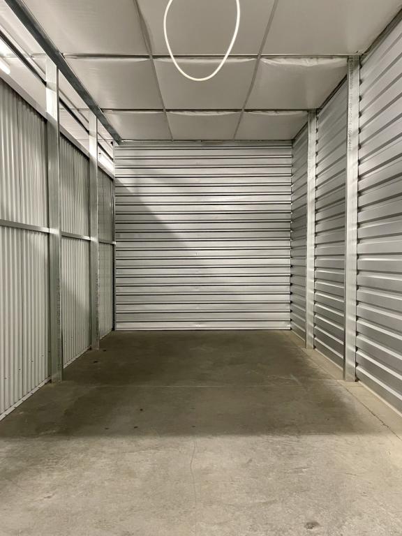

                  At least, I can report that the two opposite thirds of the garage (north and south) have been mudded, sanded, fully primered and the south side painted today- tomorrow is the north side, then assembling steel shelves from Costco on Friday and relocating the big stack of boxes in the dining area (taken out of storage) into the north side of the garage.
                  And one storage unit is completely emptied and turned in!
                  Now, to put this in perspective, keep in mind that this unit was packed front to back- you couldn't walk into it at all, in early April. And things came out of it like, a large elliptical trainer machine, for example (in pieces of course- I'm not superman- that thing weighs a ton assembled).
                  Slow work takes time, but there is definitely progress.

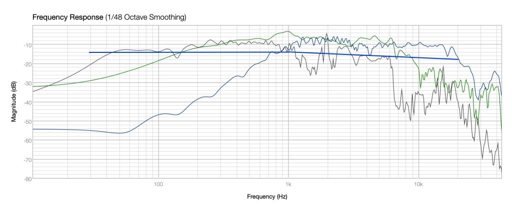

                      I forgot to ask re: this
                      All drivers measured at the listening positioning, which mic from one position
                      What's your reason for doing this?
                      Is this your method of determining the required baffle step compensation, and approximate attenuation required for the other drivers? And how come you choose that particular target response (flat to 1KHz, and down 4dB by 20Khz).
                      I take it as your in-room target response, or is it the anechoic target response?
                      best regards,
                      Thanh
                      Last edited by theSven; 21 February 2023, 20:26 Tuesday. Reason: Updated URL for htguide
                        • 16205
                        #236
                        This was just an in room measurement for all the drivers to make sure that the raw response (overlapped) made sense from the viewpoint of sensitivity and a target system design. They were not necessarily windows to the same measurement gate, but each was measured at the same level.
                        The blue target line assumes flat response to 1kHz and then what may be a "voicing" in the final design (per discussion in other threads, re voicing module) about HF target.
                        Then, to get a feel for the raw relative phase, I like to measure the woofer and midrange simultaneously,
                        And the midrange plus tweeter.
                        There will be some destructive phase combination at the outside of the band, but I've found this kind of check useful to be sure my assumptions about the driver positioning and Z axis relationships are sound for the intended design.

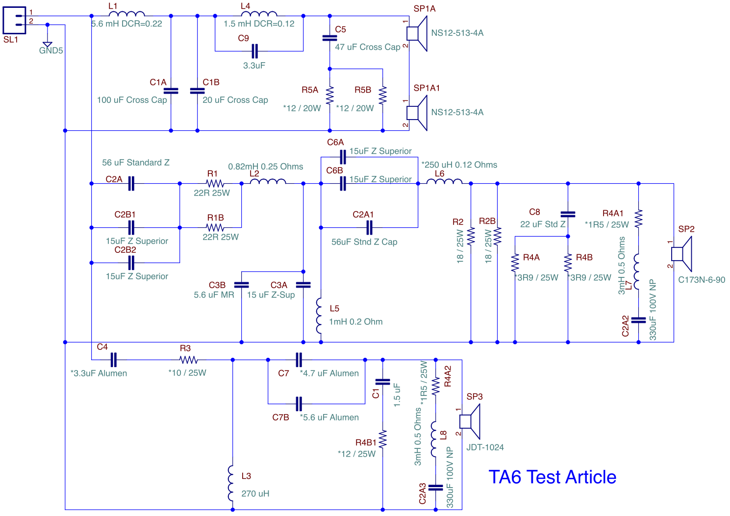

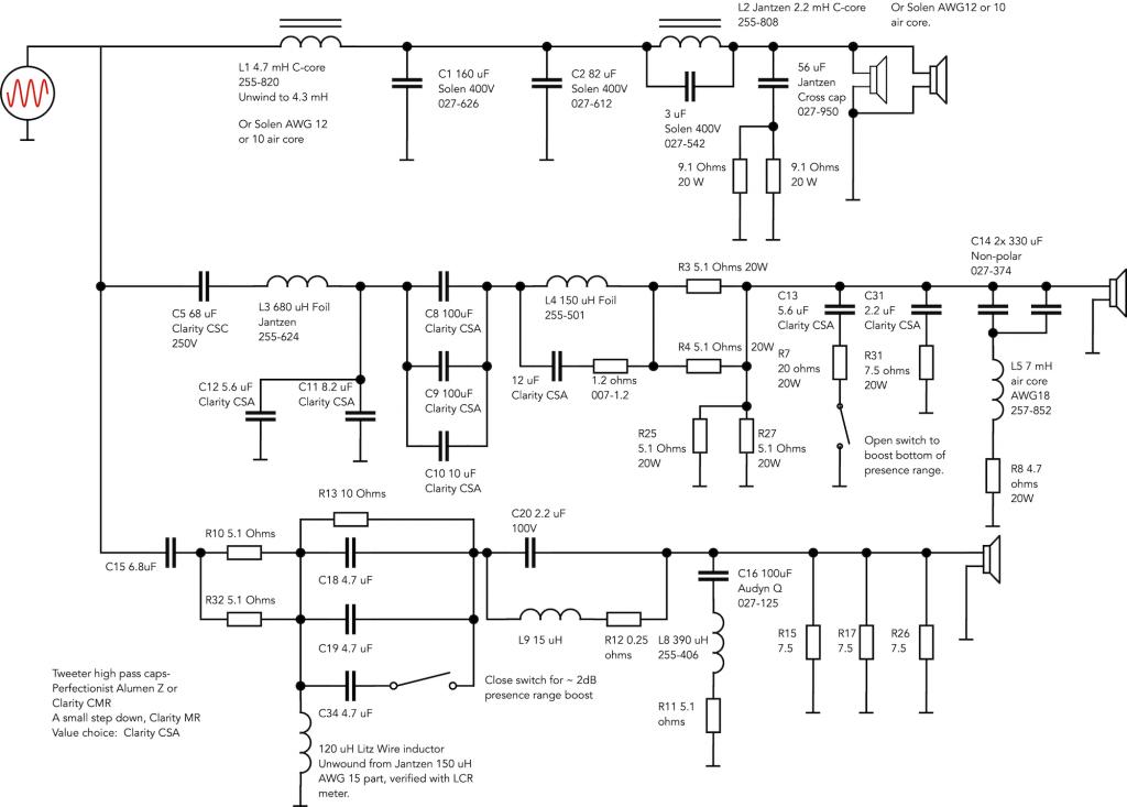

                            OK, this is not a "design update", but a schematic update to reflect an updated BOM being prepared reflecting an effort for a value oriented approach for the crossover, especially for a couple of forum members that I know are seriously interested in following up on this...
                            Key concept is component choices, particularly capacitor choices, and paring down the number of parts but keeping a good quality level considering the impact on sonics, as I've generally experienced.
                            This is NOT the LR2 alternative design, which is still to be finished (partly assembled boards are in bins, getting move over to the new house tomorrow, even!)
                            This reflects the topology and summed component values of what I've been testing and listening too, but doing things like consolidating the number of caps, specifying certain high value proposition components in the midrange, and alternates in the tweeter crossover.
                            So, on the woofer, Solen 400V PP caps. For the midrange, mainly Clarity copper connect CSA caps, probably one of the best values on the market right now. I'd even recommend them for the tweeter if controlling costs is mandatory. But if you have a few extra shekels under the sofa cushions, I'm suggesting either Clarity MR, Jantzen Alumen Z, or Clarity CMR caps, in progressing order of financial pain.
                            This is NOT a final recommendation; that is subject to further testing and listening sans the echo chamber of the rental house.
                            And you will notice there are a couple of switches in the crossover, which can be used to trim the presence range; in the current crossover configuration I've been listening to, there is about a 2 dB dip in most of what would be called the presence range, between 1kHz and 4 kHz. Open the RC zobel on the midrange, and switch in the 4.7 uF cap in the tweeter crossover, and VituixCAD tells me it should be pretty close to dead flat in the presence region. That is YET to be verified, but let's just say it's advance information based on best available data.
                            The speaker set that was modified at the rental will be moved to our new place on Tuesday. The other speaker TO BE modified is already there, as are most of the parts to do that.
                            Also, one more thing, note I will be testing the T34B and providing an adjusted circuit for any brave souls interested in the Beryllium tweeter. It's funny, the FS impedance bump is essentially identical between the two parts, and the breakup mode for the aluminum part is at about 29kHz, and for the Be part at 31 kHz, BUT, there is a roughly 2dB difference in the on axis level between 7kHz and 20kHz, with the Be part being the flatter, higher output part.

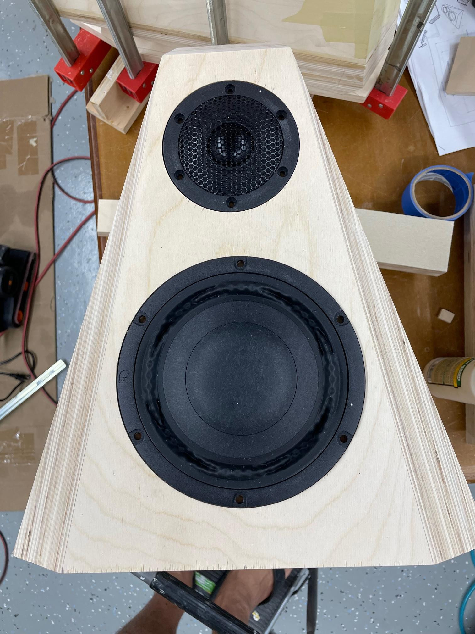

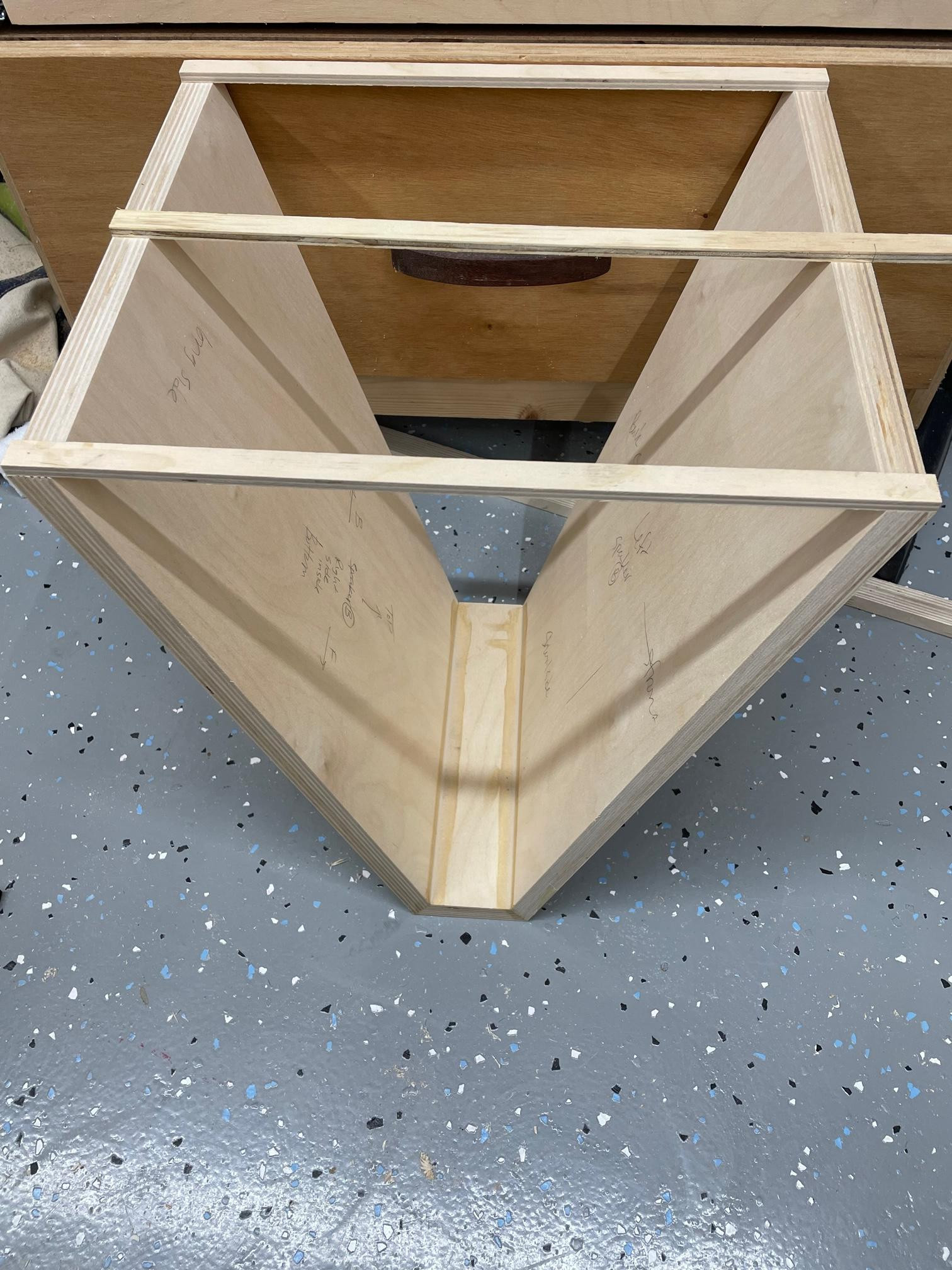

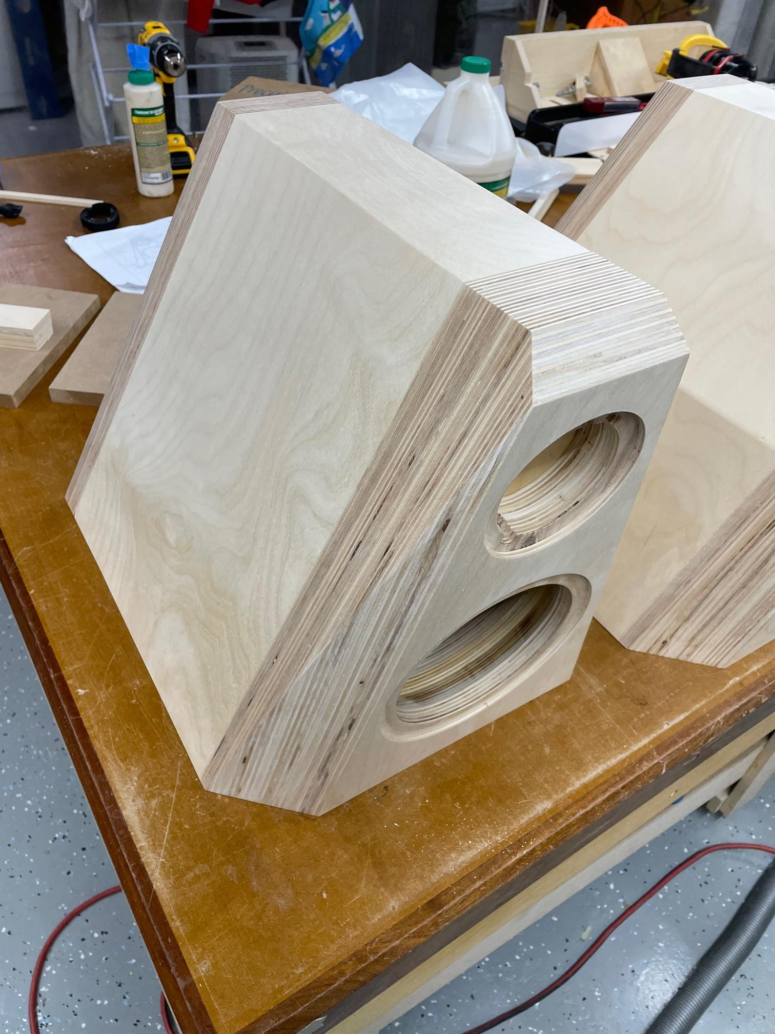

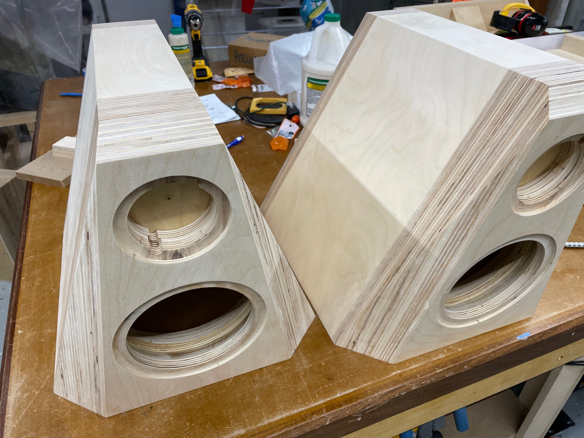

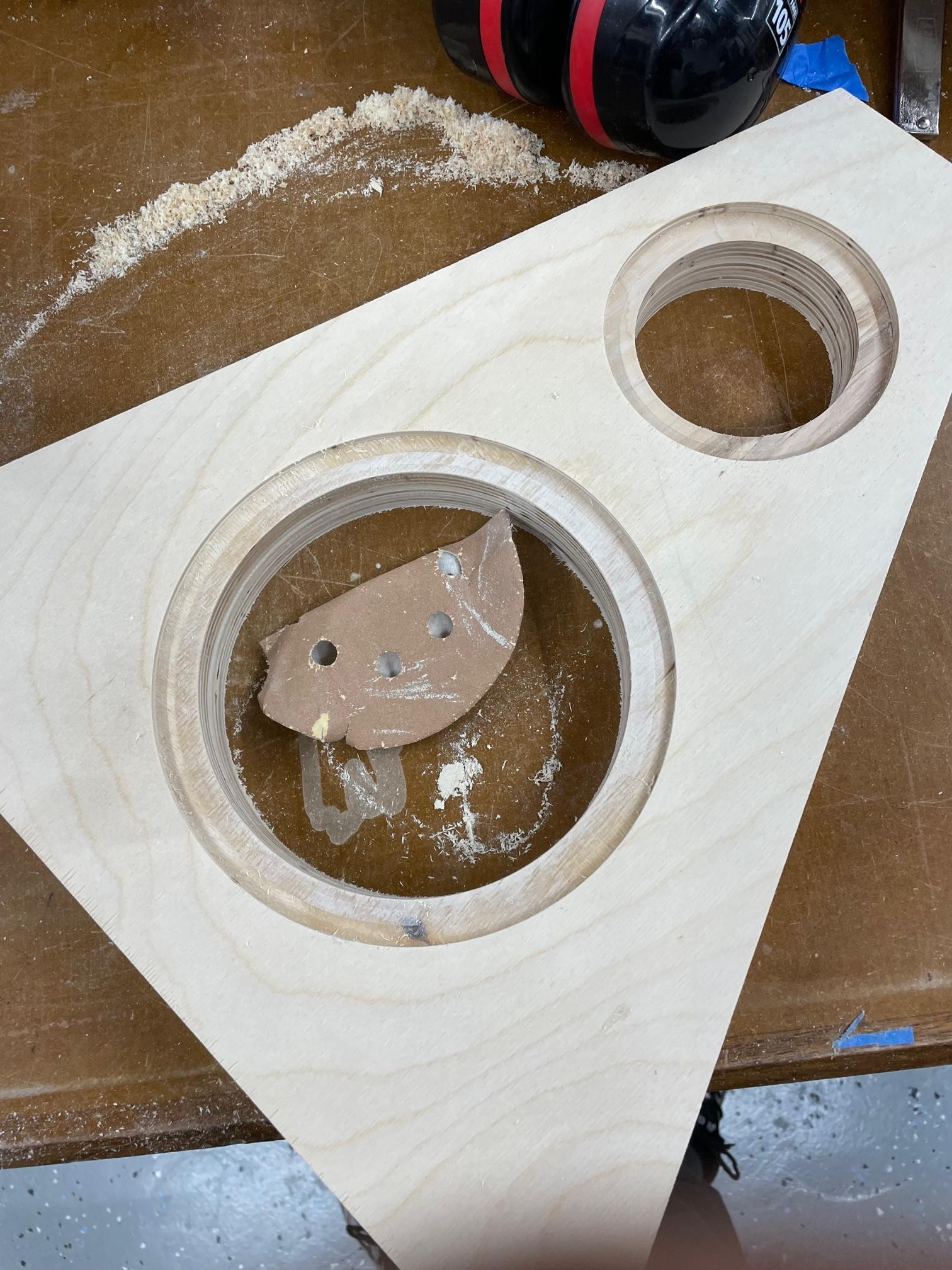

                                    Its beginning to look a lot like the Isiris :-)

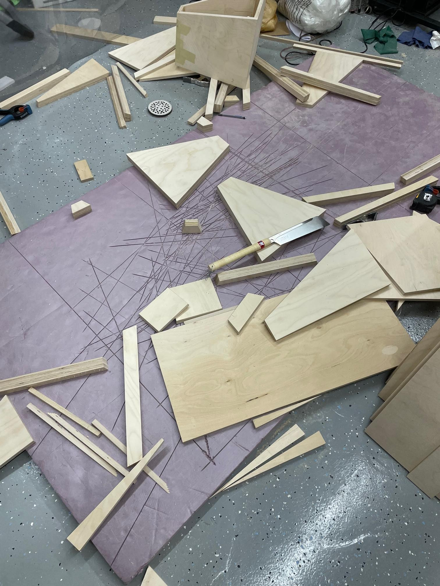

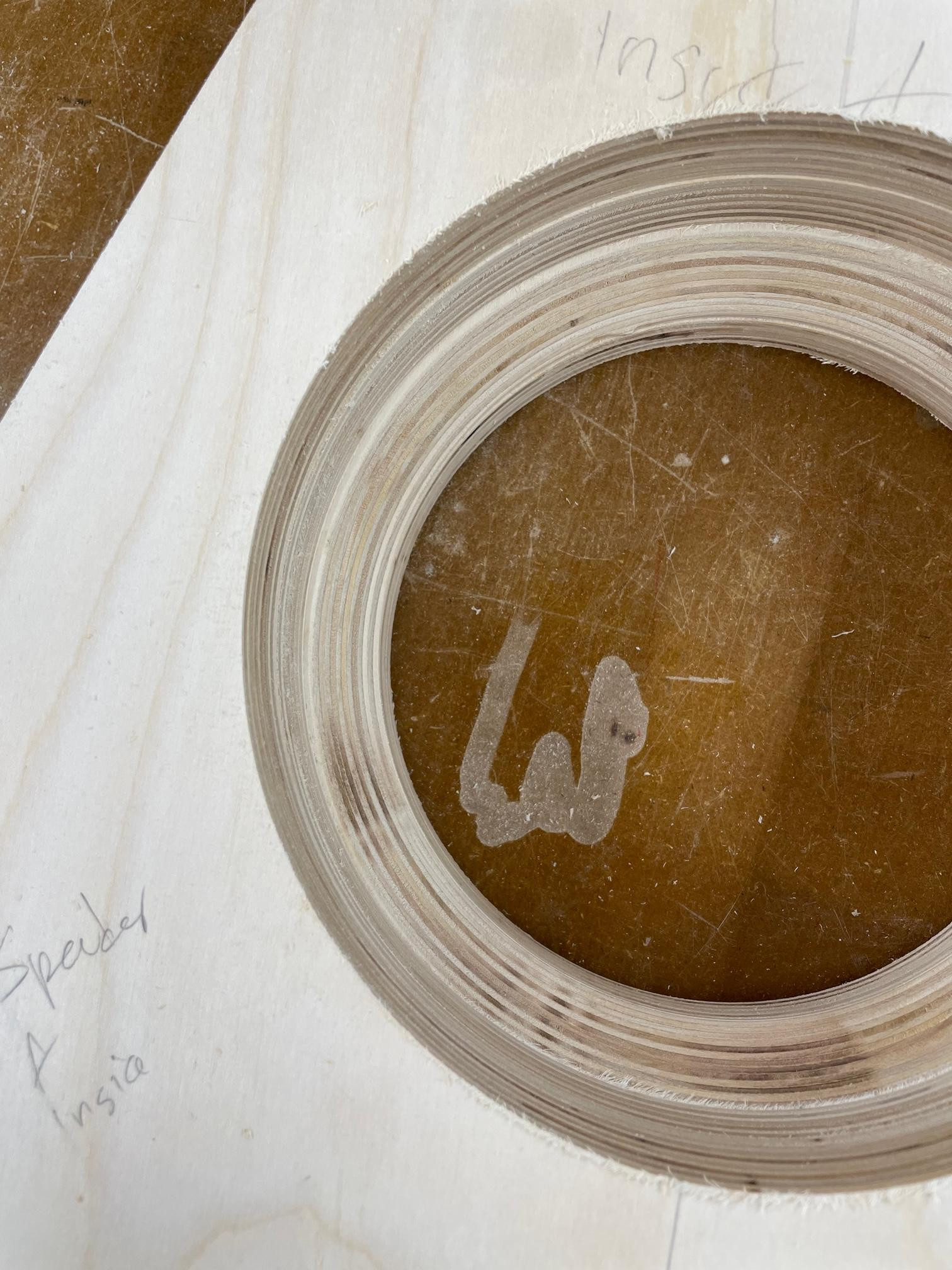

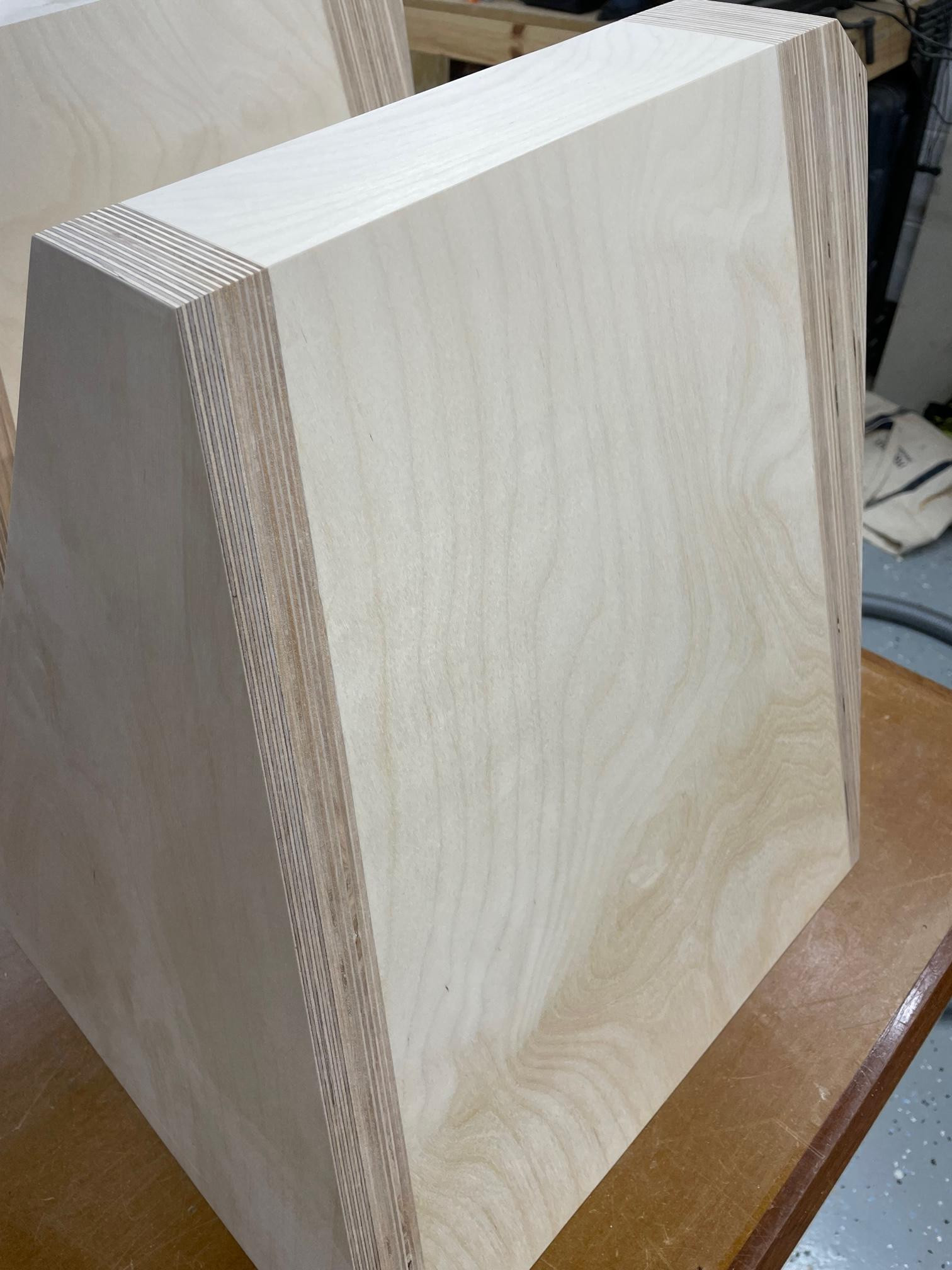

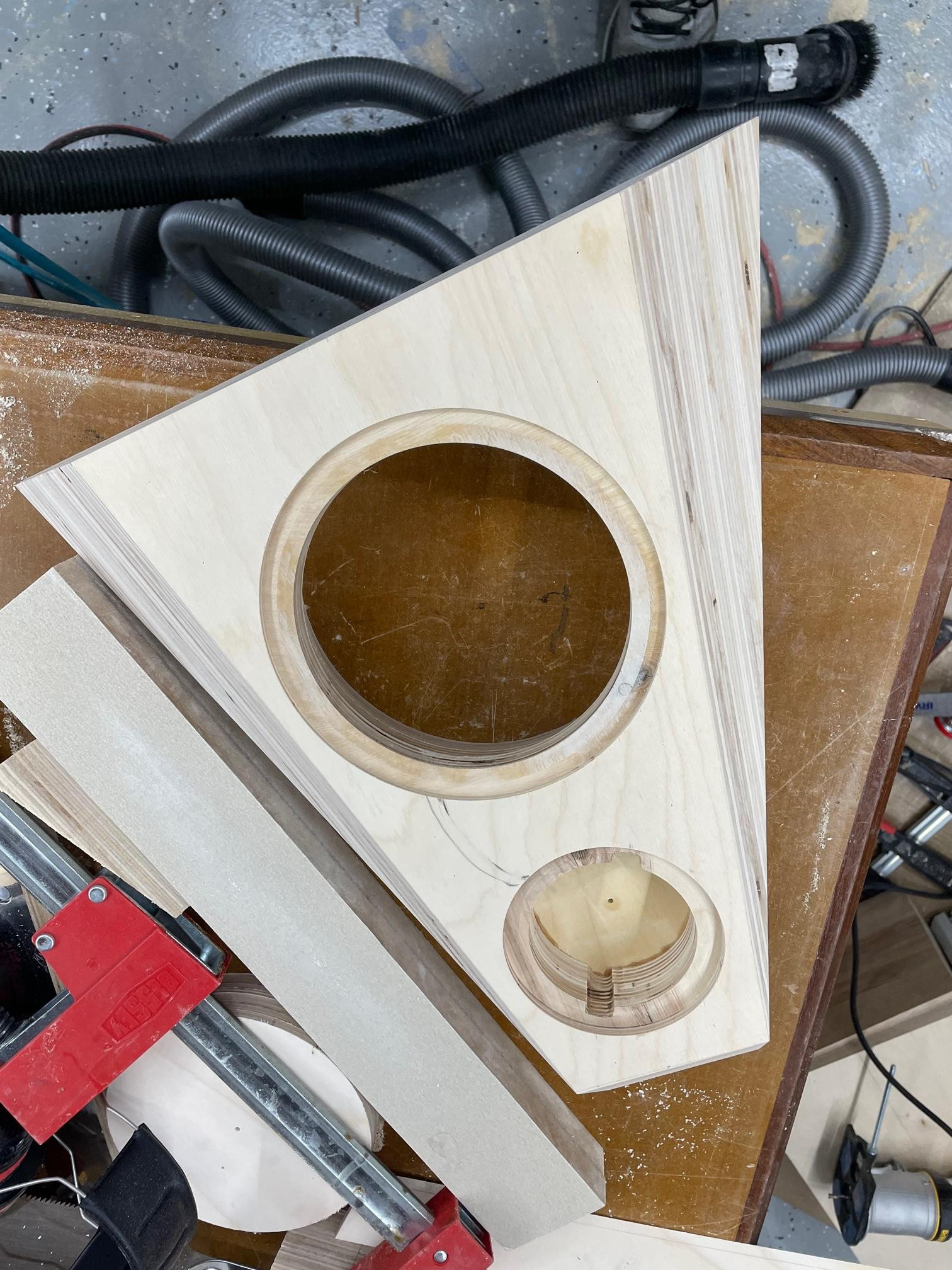

                                    I figured I should share some pictures from my current build. This is going to be a very slow build for me, but I had a kick-start while focusing on it 100% during the week of July 4th (my work gave us the whole week off).
                                    It took me about 50-55 hours of shop time to get to this point. I'm a slow builder because I'm still very much an amateur woodworker, and my woodworking has been solely limited to building speakers :-).
                                    The top for me was VERY challenging..... VERY challenging. Not just because I'm an amateur builder, but I really do think it is difficult to build. In hindsight, it's worth every penny to pay Steve Manning to build it.
                                    Perhaps I was being too difficult on myself, insisting on getting perfect cuts - but that's because I didn't want to use any polyurethane-based glue (which has excellent gap filling properties, but it is not as strong as traditional wood glue).
                                    PS - I made many incredibly stupid cosmetic mistakes along the way (e.g., tilting the palm sander, cutting too close to the facet like with the pull saw, etc. ---- so many). But structurally - they are 10/10 (e.g., perfect glue-up, no gaps, fully sealed, etc.).

                                      • 16205
                                      #243
                                      Isiris in July
                                      well, I never said these would be an easy build, BUT!
                                      Just look at how the cabinets turned out in your final pictures! the proof is in the pudding, and this pudding looks pretty tasty to me!
                                      Congratulations and good work!
                                        • 2142
                                        #244
                                        As someone I know likes to say "slow work takes time" Your putting in the time and the results are looking very nice.
                                          • 16205
                                          #245
                                          Exactly! Assiduous efforts can produce very nice results!
                                            #246
                                            Wow look at that. Those are coming along very nicely and that plywood looks as if it machines really well. Those are some crisp looking cuts!

                                                                        OK, with the progress over the weekend in moving stuff into the garage (no patio furniture boxes there anymore!) and organizing the electronics room, crossover wiring is starting, beginning with the HF board.
                                                                        As shown above, all the basic parts are mounted.
                                                                        Just HF schematic is here:
                                                                        Click image for larger version  Name:	Isiris VTX2 LR3 HF Only TA10-V11C XO-schema-1.png Views:	0 Size:	17.9 KB ID:	926763
                                                                        First order of business is the HF notch inductor, L9, as you can't readily buy this part. But you can buy a quality part that you can unwind to create this value.
                                                                        Click image for larger version  Name:	100uH 10uH.jpg Views:	0 Size:	514.0 KB ID:	926764
                                                                        On the right is the "starting" part, a 100uH AWG15 Litz inductor from Jantzen, purchased through Parts Express, note the part number.
                                                                        As a homework exercise, boys and girls, get out your calculators or copies of MathCAD/MatLAB or your favorite calculation too, and reverse engineer the Jantzen part. That is, using the inner diameter, and the overall length, and the AWG15 wire gauge for the wire diameter, calculate how many turns and layers it should take to create the 100uH inductor. This is your reality check.
                                                                        Then calculate what you need for the 10uH inductor. It should come in the range of 20-24 turns- I've seen a lot of variation in online tools, and have to say I wonder how they're doing the math...
                                                                        But the real point is, you don't need the math to be super accurate, IF you have a basic LCR meter that does good inductance measurements. Alas, my B&K seems to have gotten stashed away with with my ACO Pacific mics, so I ordered a new one today. In the meantime, I have pretty high confidence with the part on the left... based on calculation. But confirmation is better. If you have a sweep generator of some kind, and a scope, you could just measure the notch result, which should be 29kHz with the 3.3 uF cap for C20, (T34A) and 31 kHz with the 3.0 uF cap for C20 (T34B).
                                                                        Also, you'll need either a solder pot or a high temp soldering iron to tin the Litz wire; if you choose to use a more conventional base inductor, then scraping the insulation off and tinning will be easier. Solder pots, like my Hakko, are recommended but may not be in your budget.

                                                                            One of the key problems with high Q tweeter breakup modes is that it cases resonant amplification of distortion products of frequencies lower down, both HD and IM. This is part of where some otherwise fairly good performing tweeters in terms of their basic motor get into trouble (Peerless DA25TX, among many, for example), and get a reputation for being "harsh".
                                                                            Here, that concept was first applied to the development of the Natali P MTM loudspeaker, and incorporated into both the woofer and tweeter crossovers, and quite successfully, considering how popular that design has been.
                                                                            A much more recent example would be the Calliope system kit, as delivered by Steve Manning to the current owner of the HTGuide forum. This uses the DA25TX tweeter, for its very linear motor and wide and uniform off axis dispersion with rising frequency. But it has a nasty breakup mode up around 27-28 kHz.
                                                                            Here is the response with HD2 and HD3 distortion plotted with the complete crossover for the initial POC build, not ported, no diffraction control measures:
                                                                            And this is a polar plot set for POC build of this speaker 0-30 degrees in 10 degree increments, which highlights the otherwise excellent performance of the DA25TX:
                                                                            And this is a polar response set going out to 70 degrees off axis (speaker on turntable),
                                                                            BTW, a lot of us here do listen to high res material with high sampling rates, and energy above 20kHz. Not claiming to be able to hear that directly, but I can certainly hear the difference that the reduction of HD and IM makes at lower frequencies. And I can measure it, compared with the raw tweeter.
                                                                            The original configuration for this system used a diamond dome tweeter with its breakup mode well above 50 kHz- no notch network was used. But the motor is not as linear as say, the DA25TX, much less the BlieSMa tweeters. The BlieSMa tweeters also minimize radiation from the surround, a technique which is also a focus of the PuriFi midrange used in this update.
                                                                            In the last few years, I have seen others using this technique, and even a white paper from PuriFi on this topic. But my work and designs predate them by around 15 years.
