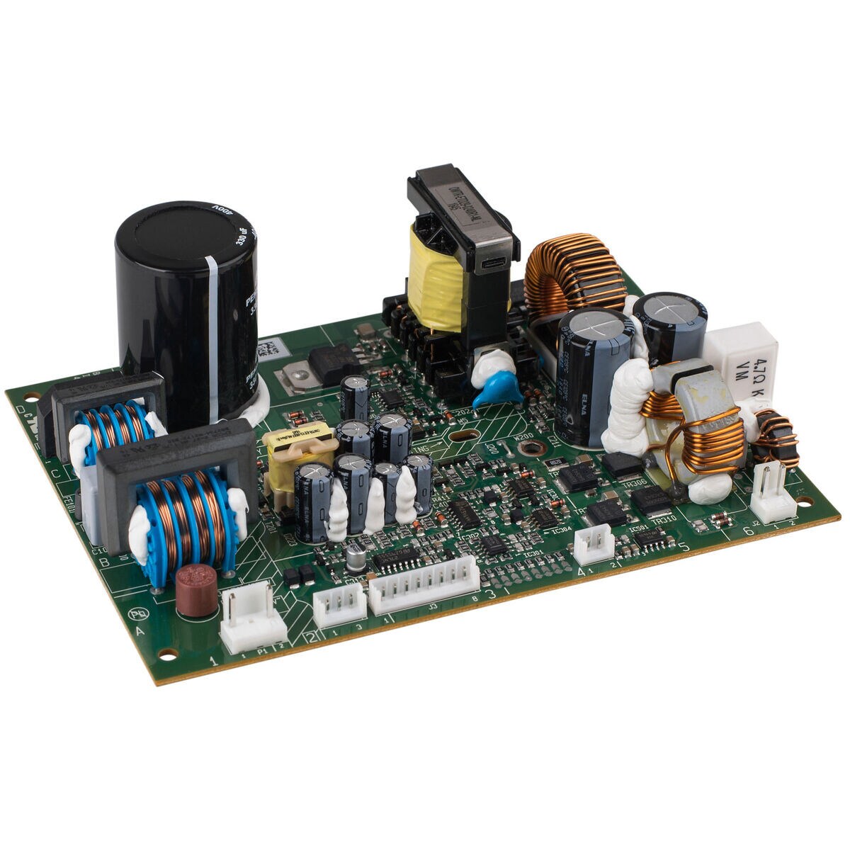

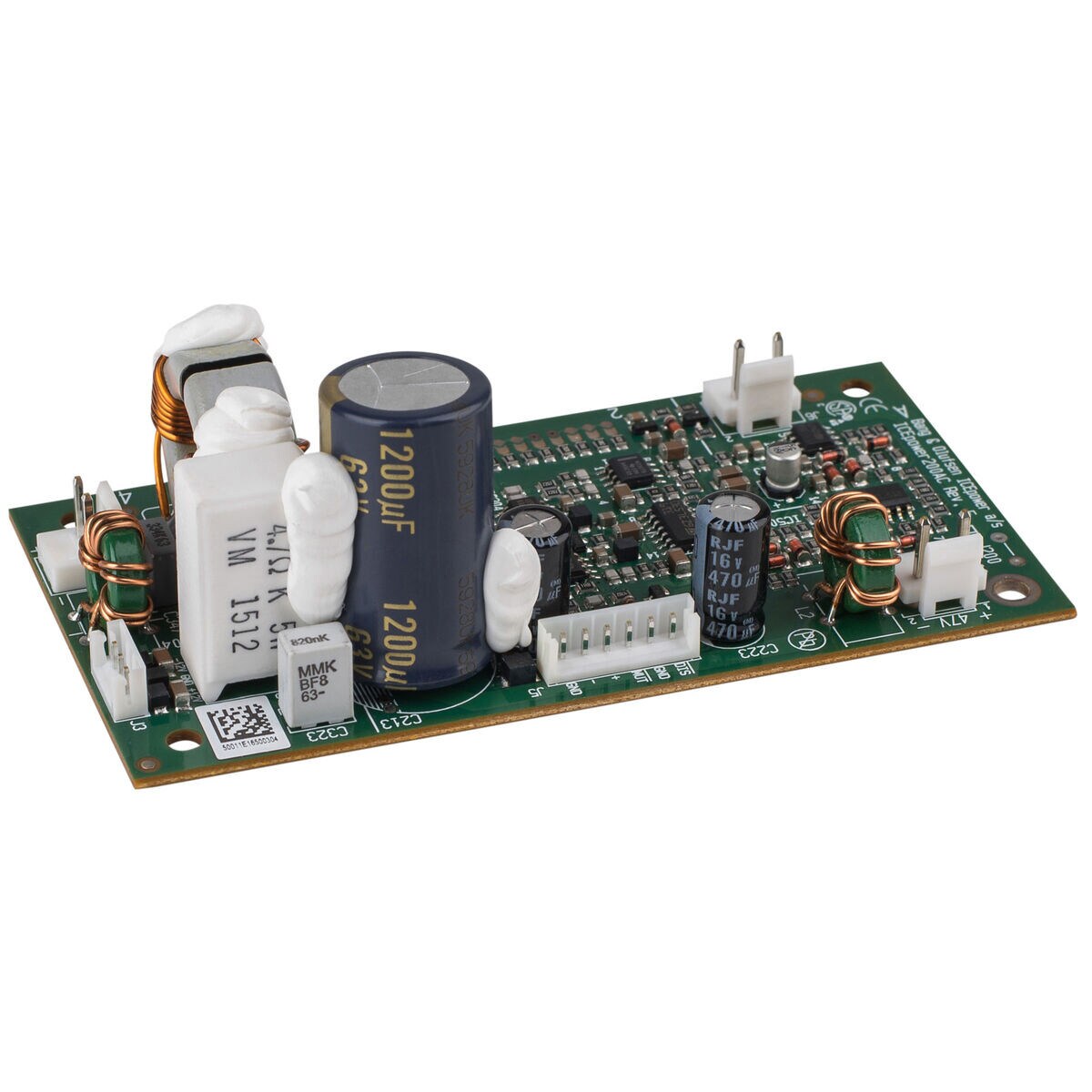

                    PE has a few of these, not just the 1kW (there are a bunch). You could also look at an ICEPower option at PE -- there are several there, too. Finally, note that it is possible to drive two subwoofer units from one plate amp. You just need to get the wiring right (e.g., don't wire two 4ohm modules in parallel unless it can handle a 2ohm load -- most can't).
                    ICEPower:
                    And then chain a 200A module to get to 2x200W.
                    There are a handful of wiring harnesses that are also required. Ghent Audio makes cases for these, and that also sells kits.
                    But if you have a couple of spare amp channels in the 200W range, then don't be afraid to use those. Not only is there nothing magical about plate amps, they are often of inferior quality than a full-range amp channel.
