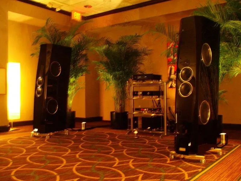

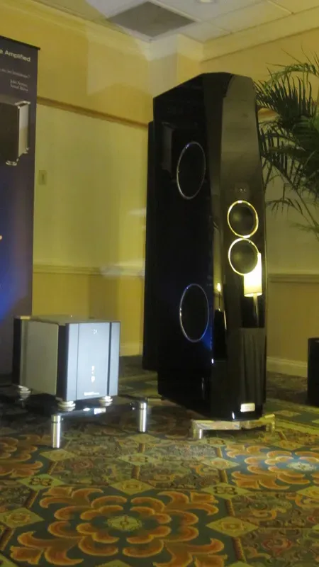

                ... I have an associate who has listened to the Tidal Audio Akira at length at their factory with material we are both familiar with and can replicate here- if in his judgment they are even vaguely similar in capabilities and characteristics, then producing some facsimile of the experience at 1/13 the direct expense, plus a large portion of sweat equity, will likely have made the effort worthwhile.
                we spend hours every year at Capital Audiofest listening to Tidal speakers.
                most notably the Piano & SunRay.

                  #278
                  You rang ...... hone:
                  Email headed your way... :B
                    • 16170
                    #279
                    But what do you think of them?
                    But Bill, what do you think of them? I hear guys at Guantanamo Bay spend hours every day getting water boarded (or will with the new President Elect), but I'm not sure they recommend the experience... :W
                    Note, these are the official Stephen Manning approved Tidal Audio Designs, with the passive radiators on the SIDE, where God intended them to be! :B

                      I'm soooo jealous of you right now
                      most notably the Piano & SunRay...
                          oh, it is definitely an experiance i most highly recommend......Tidal, that is, not the waterboarding.......though with the Syrian blood that runs in my veins, i wonder if soon i may involuntarily experiance that, too.... :rofl:
                          the SunRay's truly are a wonder to behold.....the only speaker i have heard that truly reproduces a believable level of bass one hears from a symphony orchestra along with the hall ambiance.
                          as for the Piano's, well, i will offer up an educated guess based on the many, many speakers i have heard over the years that they may approach (not meet) the same level of accuracy as one of The Maestro's master designs.
                          this belief is based on Jon's superior network design & the fact that he is not limited by commercial production restrictions in component selection & cost.
                          i promise myself one day soon, i will hear the Ardent.......even if i have to build the damn things myself.....:M

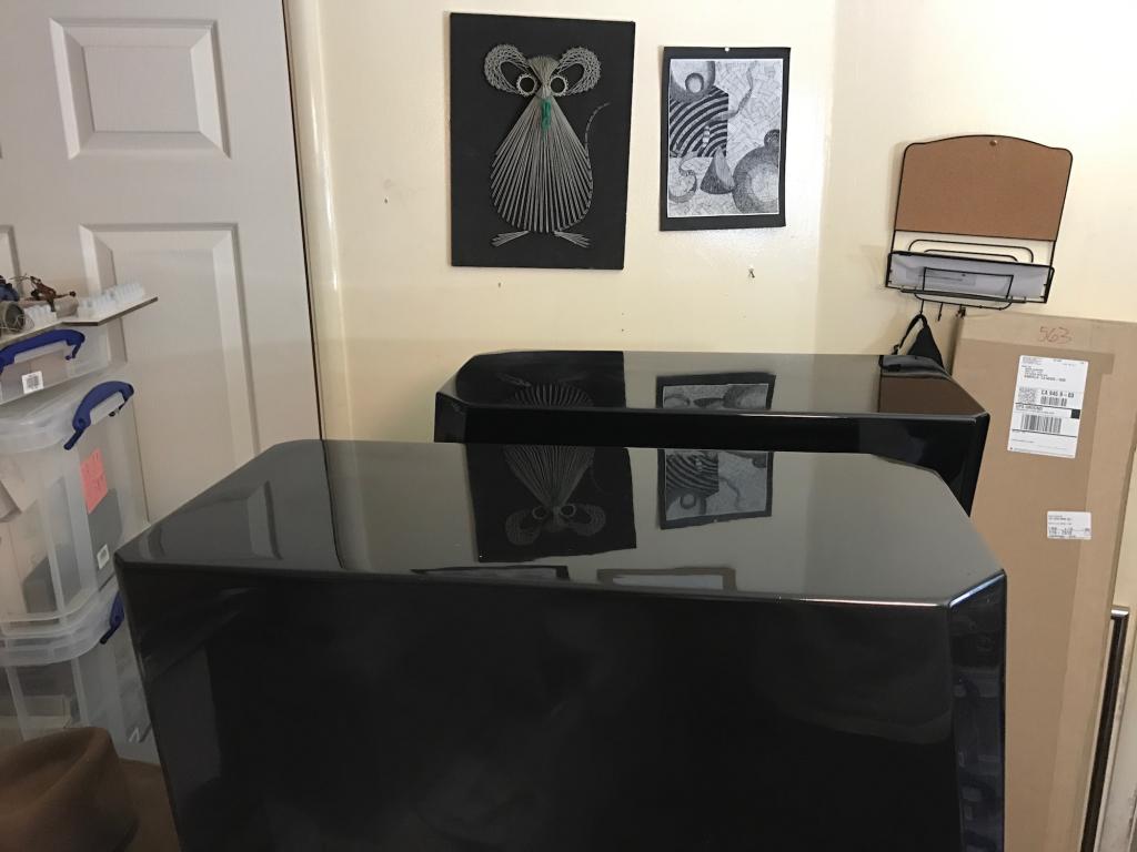

                              No, the second cabinet is actually progressing nicely now... It is remarkable how much more progress one makes when actually working...
                              That's an impressive level of craftsmanship. Well done!

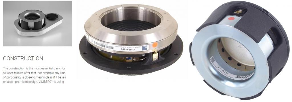

                                  I've been following this with great interest but one thing puzzles me. If you are using the tweeter from ScanSpeak how can you be certain it has the acoustic origin at the mounting plane like the Accuton Cell drivers do? Shouldn't you have used a Cell tweeter as well? :huh:
                                  Ah, but you see, it is tweeters in general that set the standard for an acoustic time orgin in the mounting plane- you could select a handful or double handful of tweeters, and do an impulse test on them, and the results would be quite similar as regards time of flight and origin- whether ScanSpeak or Accuton- whereas the matter is quite different when you factor a midrange driver or woofer into the picture-
                                  In general, exact origin depends somewhat on the location of the voice coil gap, but greatly on the attachment method and location to the radiating cone, and the stiffness/propagation characteristics of the voice coil and cone.
                                  So dome tweeters driving at the edge of the dome, with a fieldplate near the surface of the driver and a very shot voice coil assembly set the origin for all practical purposes at the surface of the baffle. A midrange or woofer driver with the voice coil 2-3" behind the front panel may have an effective original somewhere near where the VC connects to the radiating cone. The stiffer the VC and the cone, the more likely it will work out this way. The best way to determine this and account for issues (if possible) in the crossover design is by testing each driver individually, and testing with all driving simultaneously, and in a program like LspCAD, adjust the time offset values of the individual drivers until the overall response matches what was measured for the individual drivers.
                                  note, if you setup carefully, and have a program that reports the complete delay on impulse from the test time of flight, you can get a fairly close idea by setting up and measuring each driver sequentially.

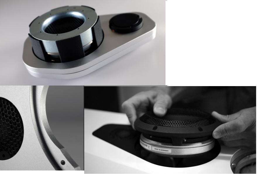

                                  Two key methods are employed in the Accuton cell midranges and woofers.
                                  For the midranges, the periphery of the inverted hemispherical dome are driven, not the rear- regardless of size, so the driving point is consistent- and a very stiff titanium voice coil is used, so the exact offset of the field plate gap is not critical or even very relevant.
                                  With the woofers, it is different- though due to the lower frequencies, a small time delay has minimal impact on phase alignment. For the woofers, an hemispherical dome is again used, but NOT inverted- and the cone is driven at the center of the cone, which is actually forwards of the mounting plane. OTOH, a long titanium voice coil has to be used, as a somewhat a conventional magnetic structure is still used. But the effects combine to put the origin in the mounting plane, and incidentally to give very good off axis dispersion compared with conventional cone geometries of the same size (about 8", 22cm).

                                      The midrange tweeter plate is not thick, and the tweeter mount is routed through nearly all the way. The mounting fixture for the midrange Cell driver from Accuton is used behind behind that panel, mounted on the main front panel, and it's design allows adjusting the time offset of the midrange to the tweeter if needed. The woofers have a very shallow rebate, and at the frequencies of the woofer and midrange overlap, if the time alignment is off by 1/4", it is a relatively minuscule phase difference.

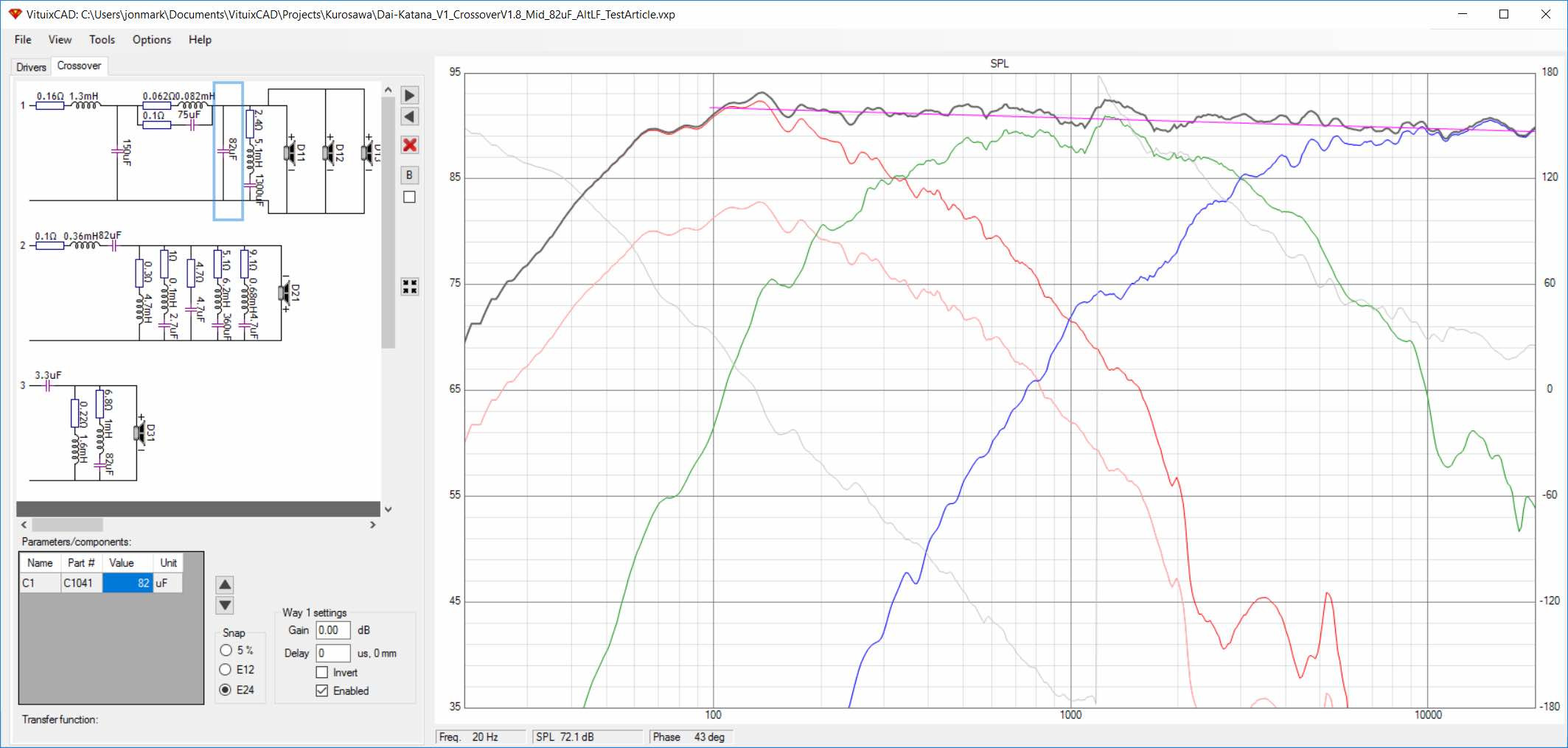

                                                    I am inclined to agree with the comments regarding the frequency span for which they're using the diamond midrange driver-
                                                    While I expect that the diamond dome will push the break up modes and distortion amplification corners up by at least one octave, there is no ready way to improve the dispersion pattern from that size radiator- while a 2" driver would perform well at 6 kHz and slightly beyond, a 4" diaphragm is another matter.
                                                    It is rumored that there are motor improvements for the Akira version, perhaps these improve the distortion at the low end. The standard version is no slouch compared to many other companies's products, but it is not the best performer from Accuton, and should benefit from using a higher crossover point, especially depending on the type and slope of crossover. Additionally, the standard construction of the basket leads to a tunnel resonance, shown clearly at about 1250 Hz in the crossover page below; these were eliminated with additional modifications to the drivers. Note also that the measured AS190 response below is without passive radiators, but instead a simple sealed box.
                                                    The crossover choices should always be made fully cognizant of the driver performance realities...

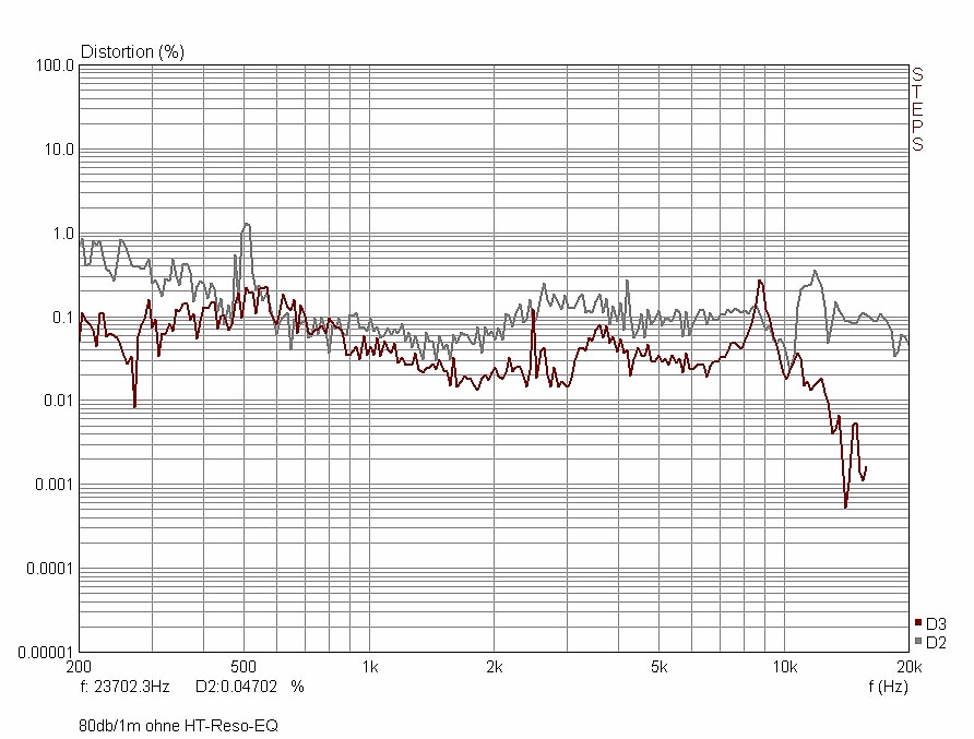

                                                      About the distortion - there are distortion measurements of C90-6-724 on the web and as was posted earlier in this thread, HiFi-selbstbau did it as well. As was noticed before with ET's midrange, 3rd harmonic is higher than second - unlike measurements from German website. That being said, it's not that ET's mids have higher 3rd harmonic, they rather have lower 2nd harmonic than the one measured on the web. From the one measured by the ET, 3rd order HD peak is at 3.1KHz and it is about 0.6% at its apex (about -44dB).
                                                      Slight digression: Recently i've been told about German DIY-er named Rainer Feile that constructed a small two way loudspeaker he named Tafal. While being nothing revolutionary in itself, it gained much popularity among the European DIY-ers because it's made with high value drivers and with a good number of smart design choices. The thing i liked about it (among other things) was that, while he did use Seas alu-dome tweeter that has break up at 26KHz, he treated it with a notch filter.

                                                      As expected, there was 3rd HD peak at roughly 8.7KHz that reaches 0.3% line. What surprised me is that when notch is applied at dome resonance, the 3rd harmonic distortion peak decreases dramatically - from 0.3% to 0.04%. What's also interesting is that it lowered 3rd order HD through the entire tweeter range. Measurements before and after:

                                                      Now, i know that this should be tested but if it works with the midrange too, then it is understandable that with Akira they could do something similar and achieve good distortion profile regardless of high crossover point - given the diamond cone and break up that is much higher in frequency. Since ET made a notch at midrange resonance, i wouldn't be surprised if 3rd HD would be lower through the whole range covered by it with crossover in place. I'm certainly testing it as soon as i deal with my notebook gremlins, but with nothing but the notch at the cone resonance.

                                                            As we all know, the reason for the peak in the third order distortion product, is because of the cone ringing, in sympathy, with the standard distortion product.
                                                            In other words we excite with a 1kHz signal, a third order, at 3kHz, is generated within the non-linear aspects of the driver and then the cones resonant peak at 3kHz amplifies the generated third order product.
                                                            At no point have we approached the driver with a 3kHz signal, unless it were to be fed with a signal of gross amounts of non linear distortion to start with, so an electrical solution, ie notch filter, tuned to 3kHz would have no effect at all on the frequency that stimulates the problem, in this case 1kHz.
                                                            The only way that a notch like this could help lessen the impact of the distortion amplification mechanism (the cone ringing) would be if the tuned notch were to present a low impedance to the driver at 3kHz and therefore provide resistance to the motion of the ringing of the cone.

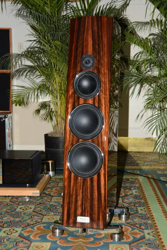

                                                                          Originally posted by Zvu
                                                                          I hear ya. But then again i never listened midrange with a cone that's rigid as that one and when such experienced guy as Atkinson is impressed and starts talking - i choose to listen. Measurements will show us one part but he is genuinely impressed by the sound - if it's not an act of courtesy. I do hope Akira finds its way into Stereophile testing facility aka Johns room.
                                                                          My real concerns goes into direction where 6000Hz is the upper crossover point. That's why i'd like to see those off axis measurements.
                                                                          Tidal Akira's test was published in October. Xo points are 250 and 2200Hz. Sadly Stereophile doesn't publish distortion measurements.
                                                                          Averaged horizontal +/-15¤
                                                                          Normalized off-axis is super smooth!

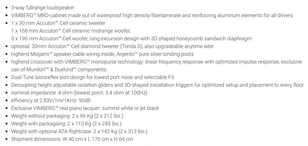

                                                                              More about the Vimberg Tonda
                                                                              Some new data points came to light today- with the Vimberg Tonda. it is not quite so direct a clone of the Akira as might be thought...
                                                                              Reviewing some pictures raised questions in my mind...
                                                                              Steve Manning confirmed my supposition regarding a different midrange driver based on the visual proportions above...
                                                                              And even though the verbiage below states otherwise, there is no way I do not recognize the C168, having tested several of them...
Name:	Midrange Driver.jpg
                                                                              Never trust a marketing person to do an engineer's job...

                                                                                #309
                                                                                It also mentions "...with a 90mm Accuton ceramic midrange woofer" but in the specs below there is no such thing.
                                                                                Joaquim
                                                                                DIY 4 way speakers.
                                                                                DIY subwoofers.
                                                                                Zaph ZD3C.
                                                                                  #310
                                                                                  Exactly....
