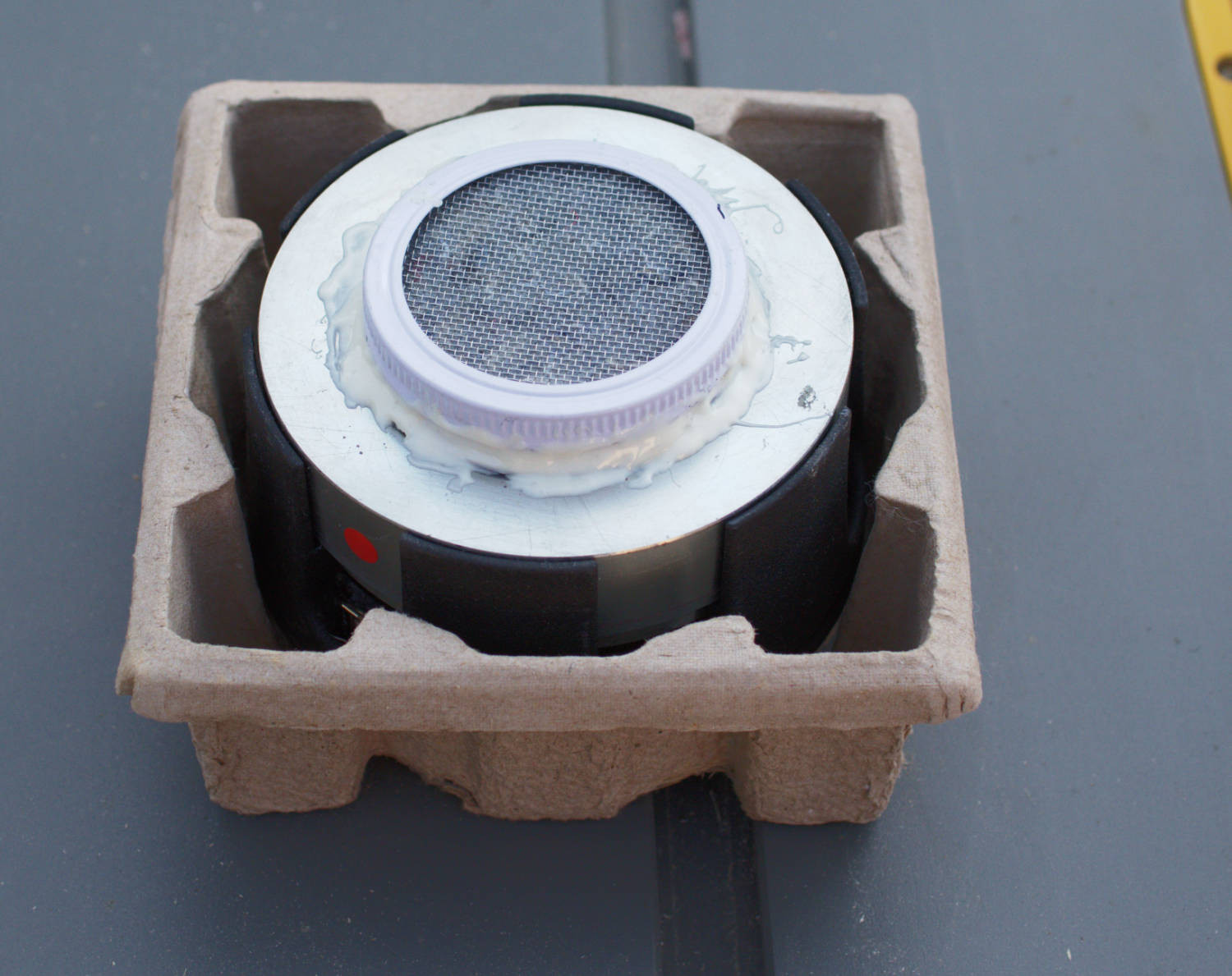

                    Solen's Technician will not be in the office today, I'm told, but will review the technical data sent to them tomorrow.
                    This is an example measurement for one of the T34A-4 tweeters. All of the tweeters were very similar with problematic impedance measurements. Clearly damaged or fault at some point.
                    Click image for larger versionName:	image003.jpgViews:	1Size:	73.2 KBID:	864131
                    For reference, a correlation measurement of a Satori TW29BN was done at the same time and also sent to Solen.
                    Click image for larger versionName:	image006.jpgViews:	1Size:	72.8 KBID:	864132
                    This is a normal presentation for this type of high frequency transducer.

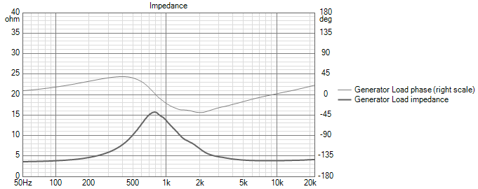

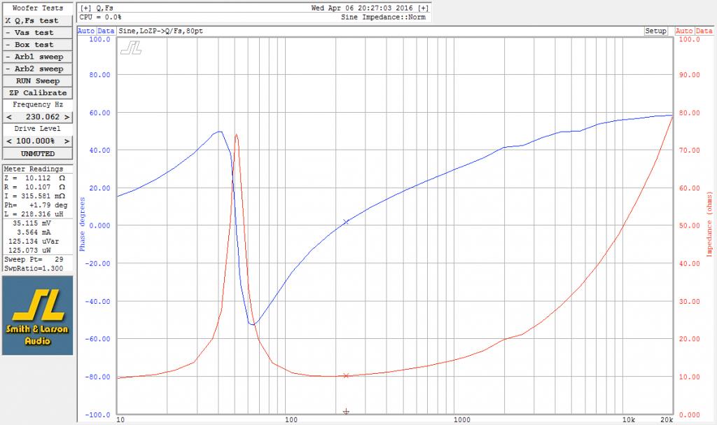

                        This is a Bliesma T34-B from OLA project. I'll measure both later today. I'm pretty sure I've subjectively verified both but not it's nagging me too. Very sad and poor experience indeed.

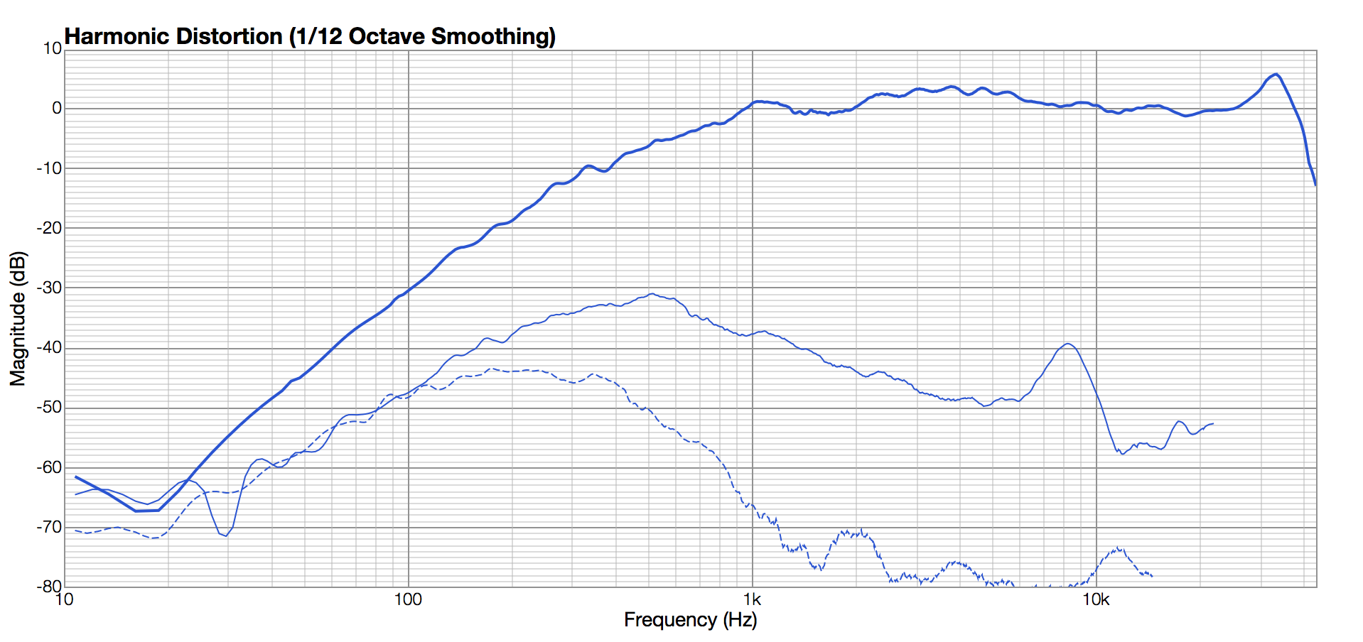

                          Much has transpired since these last posts...
                          • I have since received more BlieSMa tweeters from other production lots, and am having more success with those parts. However, at this time I do not anticipate changing over the tweeter selection- the current implementation with the D2904-7140 appears to be "adequate".
                          • I have new measurements for the D2904-7140 tweeter, full polar out to 44kHz, also prepared for the Osiris work for Michael Bell. These were incorporated into the development of the updated version of the crossover posted below.
                          • The midrange polar measurement set has not yet been updated since the rear damper system was developed and briefly tested on axis. So the existing developmental Proof Of Concept (POC) crossover proposals still show this aberration in the 1500Hz area for amplitude and phase.
                          • The updated midrange crossover employs series notch filters for the breakup mode as well as the 7140 crossover; I have done this with some designs since the Natalie P, but for some filter configurations is it more tricky to implement, as one cannot just modify the last inductor in a 3rd order configuration. This technique has been proven over and over again- most recently with the SMJ Calliope for the Peerless DA25TX.
                          • Juhazi's link for the Stereophile test of the Tidal Akira, the inspiration for this design effort (after hearing them with a colleague at the Munich High End show, who was almost persuaded to buy the show samples) reveals some interesting data but also some curious contrasts in design choices. Understand that the drivers used by Akira are ALL custom OEM version for Akira, whereas I have been working with lowly off the shelf equivalents. Some comments will follow regarding information gleaned from that review and the design premises of the Kurosawa, including my own observations of the "standard" factory parts and choices made for working with them.
                          • Do note John Atkinson's comment about "character" in the upper midrange and his measurement in the area between 1 and 2 kHz. His measured results mirror my early ones also. It seems to correlate well with the physical design of the driver and the issue I identified and for which I believe I have implemented a workable solution.
                            Last, note the step response. This is indicative of a 2nd order system with the midrange connected out of phase from the woofer and tweeter... rather like a Duelund three way configuration, as originally proposed for this implementation.

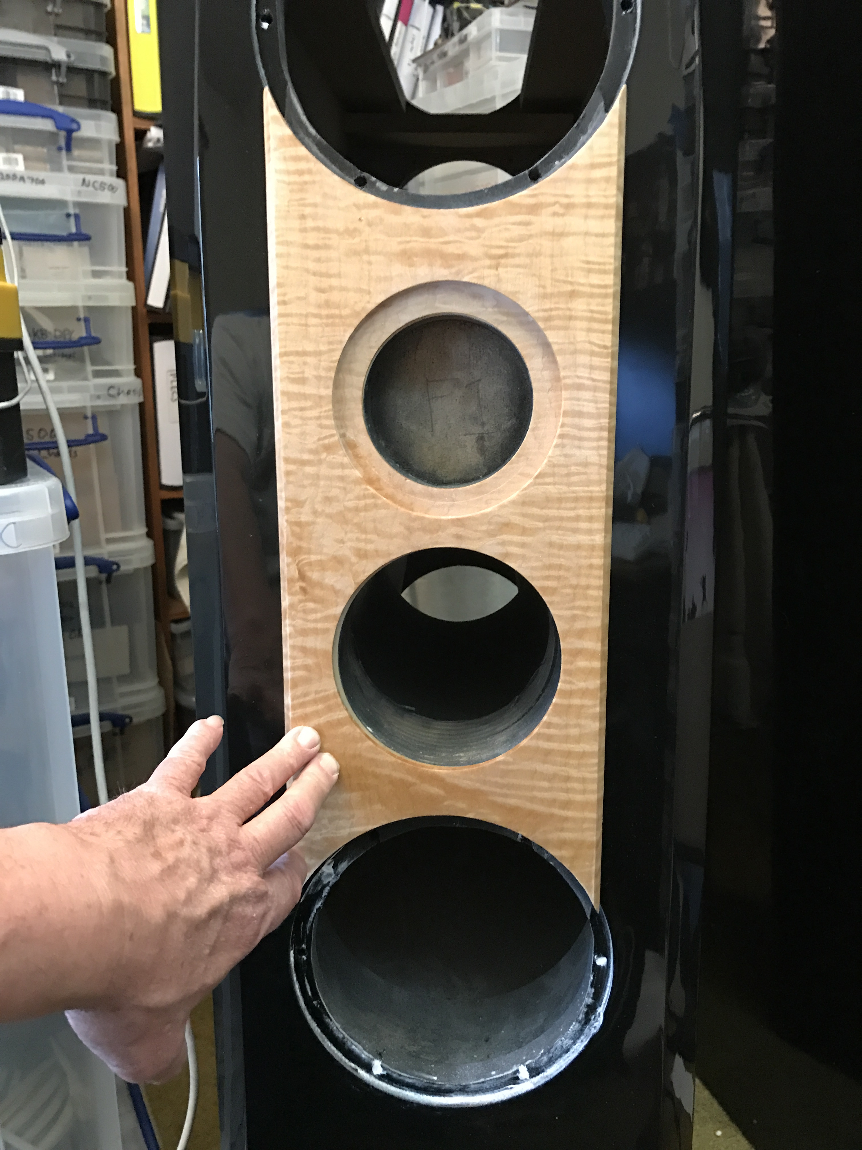

                            #328

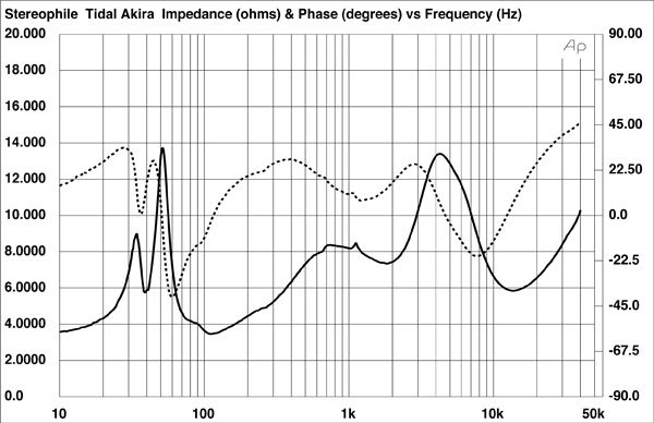

                            Some interesting takeaways from the Stereophile Tidal Akira review
                            Reviewing Stereophiles comments and John Atkinson's test data for the Tidal Akira is interesting in retrospect, if partly because this review was released more than two years after my design approach was locked in and cabinets were being constructed. Some aspects I noted partly, such as the passive radiator count. However, this this the first public disclosure of many of the design and fabrication details of the OEM drivers as well as the cutaway image of the cabinet.
                            Interesting... Most interesting, as today is my first exposure to this material, given how events and tasks have circumscribed my available time. So this post will be a bit of a contrast and compare, perhaps just to explore how close the original design and it's inspired tribute, and how far apart they are in some regards.
                            In no specific order, some "interesting, most interesting" facts about the Akira. Some previously well known, some of them new to myself.
                            • One diamond tweeter, one 5" diamond midrange, three aluminum honeycomb 7.5" diaphragm dome woofers, and 5 aluminum honeycomb passive radiators, all custom OEM Accuton
                            • 348 lb weight, of which 80 lb is reportedly a 3mm thick lacquer finish. Constructed of a proprietary material 42mm thick consisting of multiple layers, including glass hard layers with softer damping layers of MDF and HDF.
                            • Nominal impedance of 4 ohms, estimated voltage sensitivity of 87.5 dB/2.83VRMS.
                            • Impedance minima for reflex system at 40Hz- this is the system Fb.

                              Thoughts regarding this information and alternative design paths...
                              It seems the height of foolishness to propose commenting or critiquing in any manner a $200k loudspeaker of this superlative build quality and credentials. The workmanship and effort spent on numerous aspects of this design put it in a rarified territory.
                              However...
                              Some aspects raise a disturbance in the Force for me... as well as a sense of puzzlement. Without access to more inner technical details, note that in some cases I am only pondering and speculating...
                              Low Frequency passive radiator system
                              • with the non-equal number of PR's and drivers, and a non-integer relationship between them, it is highly likely that all the woorfers and PR's share a common low frequency volume.
                              • The impedance curve shows an unequal height pair of impedance peaks, with the lower one almost half of the upper. This implies a significnat offset of the Fb tuning from the sealed Fb or driver Fc.
                              • The impedance curve shows a curious anomaly in the trajectory from 90 Hz to about 175 Hz, compared with what I have observed in AS190 measurments.
                              • The system sensitivty of 87.5 dB/2.83VRMS as estimated by John Atkinson is lower than I would expect, especially for ultra low impedance/low insertion loss inductors; in fact, two "standard" AS190-9-251 in parallel should have a net sensitivity over 90 dB, given their individual sensitivity of 85 dB. And based on my measurements and the data sheet, I expect the LF sensitivity with the planned crossover to be about 92 dB for the Kurosawa.
                              • A layered 3.5 way might have some interesting characteristics- it would avoid having a tall LF course at the crossover frequency. But, it might also account for the weaker than expected midbass capability. OTOH, that also could be a factor of the listening room and setup.
                              • The impedance discontinuity he noted at 90 Hz correlates with the area where I found the behavior to be atypical for this driver familiy.
                              Akira impedance
Name:	Akira Impedance.jpg

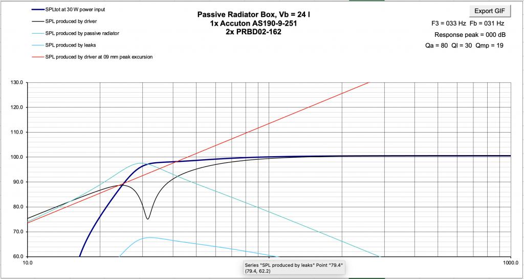

                              It is certainly possible that there are more differences between the AS190 custom to Tidal and the standard one, which I do not have knowledge of, accounting for these issue. For example, the voice coil design may be altered, perhaps for longer throw, or longer throw and a higher impedance to make the paralleling more benign, even with unusual crossover component values. The standard AS190 has a reasonable Xmax, +/- 9 mm.
                              AS190-9-251 Impedance
                              As can be seen, the actual impedance of the AS10-9-251 is not 9 ohms, but 10 ohms. However, three in parallel, excluding crossover components, will have a net minimum impedance of about 3.3 ohms.

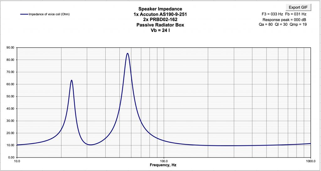

                              The other curious aspect is the PR complement and tuning. For this large and expensive a system, a 40Hz Fb followed by a sharp roll of seems to be a curious choice, in light of market expectations. Perhaps the purchares of this speaker will not be listening to Saint-Saen's Symphony #3 in C minor, the "organ symphony" as it is referred to, though a misnomer. For a high end speaker covering classical music's possiblities, the ability to do credit to the low E on the organ might seem mandatory to some. Such as myself.
                              Hence, after evaluating many potential configurations, using two Wavecor PR223BD01 passive radiators per AS190 was settled upon, and each driver and PR set is in it's own acoustic space, avoiding quarter wave column resonances that can be a problem with many tall columnar cabinets.
Name:	AS190 Impedance.jpg

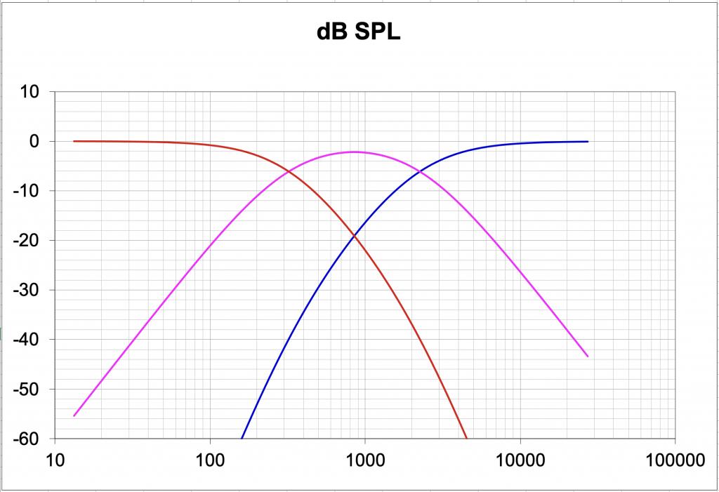

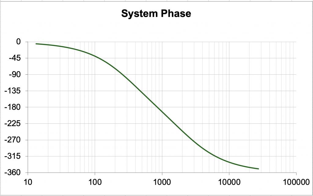

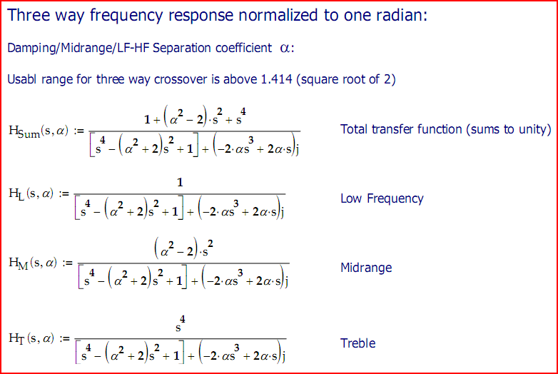

                                Crossover targets- showing the Duelund calculated transfer function and phase:
Name:	Screen Shot 2022-04-19 at 8.07.53 AM.jpg
Name:	Screen Shot 2022-04-19 at 8.08.19 AM.jpg
                                Note, my opinion for an effective implementation is that the woofer, midrange, and tweeter should track the target function down to at least -20dB, and preferably to -24 dB.

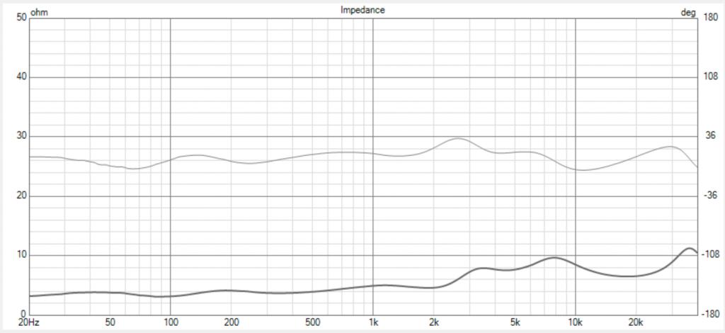

                                Perhaps just to highlight differences in conceptual basis and execution, I could share the simulated impedance curve of the current system concept with crossover...
Name:	Kurosawa Xover 2022 Update XO-Impedance.jpg

                                                              Originally posted by duvixan
                                                              Would you choose the C168 for that range, after having worked with Purifi PTT6.5 ?
                                                              This comes down to economics as well as performance. Both PuriFi and Accuton drivers carry premium prices in relation to the performance levels. I do have samples of both the C168-990 and C168-890, purchased before some of these most egregious price increases on the DIY market. The 990 currently retails for about $1300 each. Its response curve mounted in an actual enclosure is fairly easy to work with, and the distortion profile is beyond acceptable.
                                                              Polar response is well above average for this diameter of driver, due to the cone design.
Name:	C168-6-990 Polar.png
                                                              It is truly a question of budgetary matters...

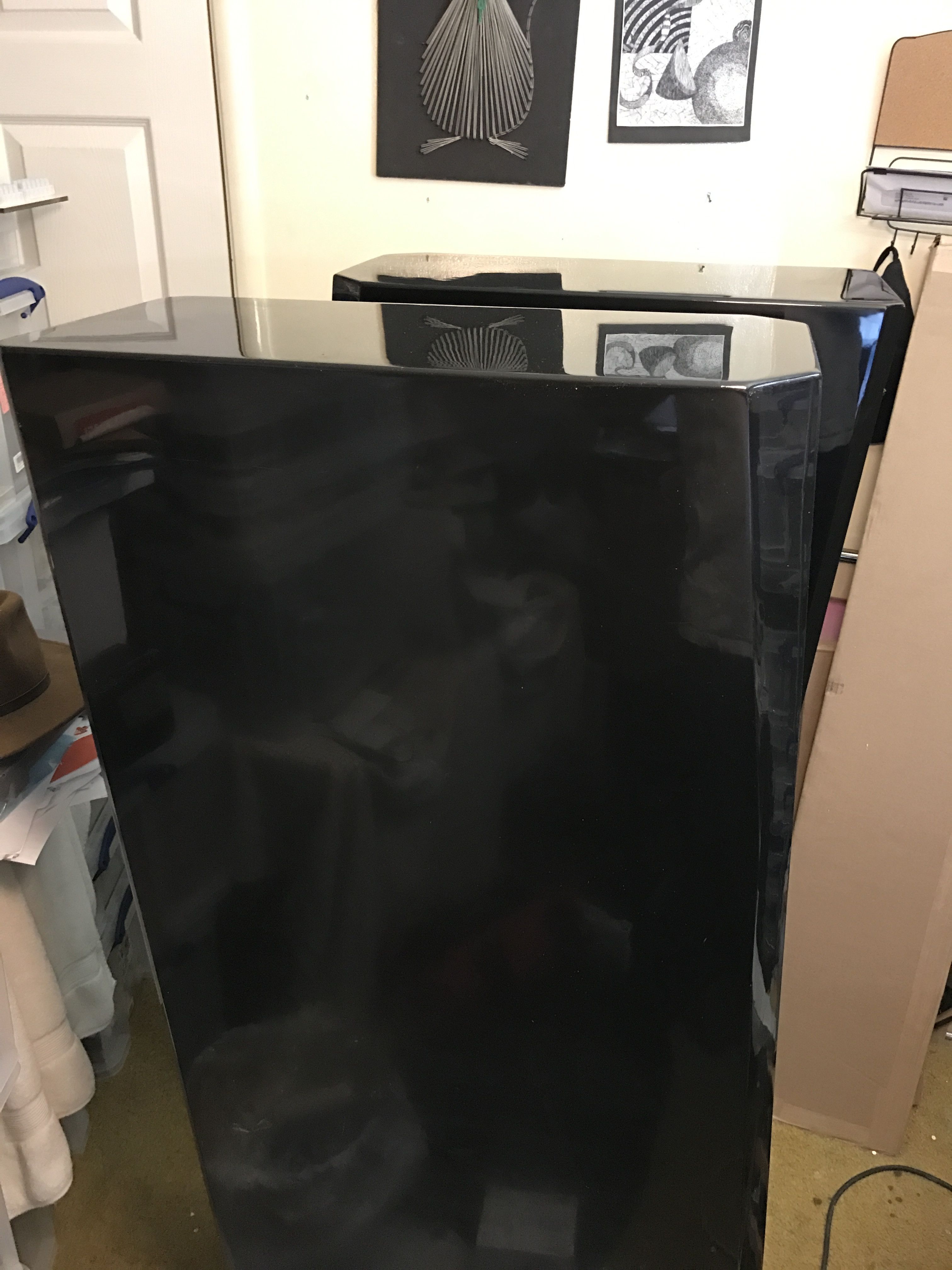

                                                                    Mr. Manning recently contacted me with some questions about the aluminum sandwich drivers such as the AS-168 and the AS-190... while he has been working on what was at one time designated as the Kurosawa Jr for Mr. Sullivan.
                                                                    (There have been a host of burdensome issues in this galactic sector as well as planetary sector of late, and speaker projects have suffered a loss of attention...)
                                                                    But this brought to mind the original Kurosawa project, and my latent Force energy was aroused to a certain degree, and against recent constraints...
                                                                    What if?
                                                                    As noted above, the FSL-0512, of which I have a relatively "plentiful" supply, has interesting performance characteristics, one might even say "most interesting..."
                                                                    And consider also, the matter of the Peerless DA25TX, which though time consuming to source, Jonmarsh has amassed a small stock which I believe I can use the power of the Force to convince him to free some up for my purposes...
                                                                    Let us consider a few additional data points...
                                                                    The ScanSpeak 7140 at 2.83 VRMS
Name:	SS7140 Distortion.png
                                                                    Low HD3, but the typical SS high HD2.
                                                                    And the DA25TX, with the Calliope style crossover:
Name:	DA25 MkII Distor.png
                                                                    Things become more interesting when one ponders the mechanical issues- such as the through hole requirements for the midranges, and the similarity-
                                                                    And even this data for the tweeters is remarkably similar, as is the actual mounting flange plate diameter...
                                                                    Then, too, there is the actual mounting configuration for the Kurosawa, which utilizes a maple plate with the machining for mounting configuration contained in the plate, not in the main cabinet...
                                                                    There seem to be some unexpected possibilities for updates... very economical updates, though as all the planned drivers are on hand, it is something of a moot point.
                                                                    Considering the efforts and resulting quality of construction and finish which went into these original cabinets, perhaps it will be time soon to revisit this effort and conclude it.
