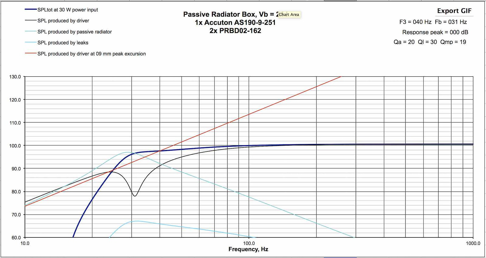

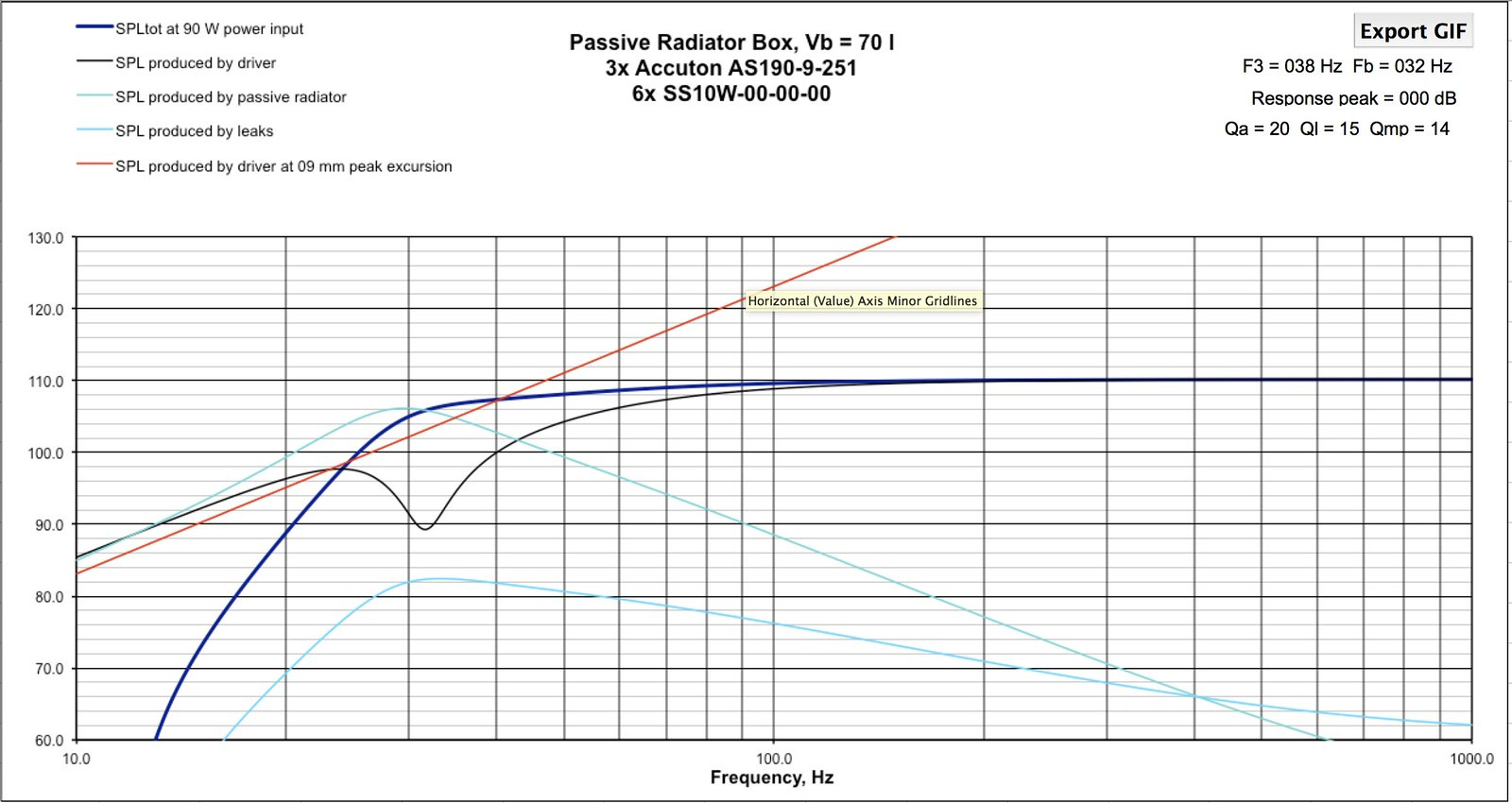

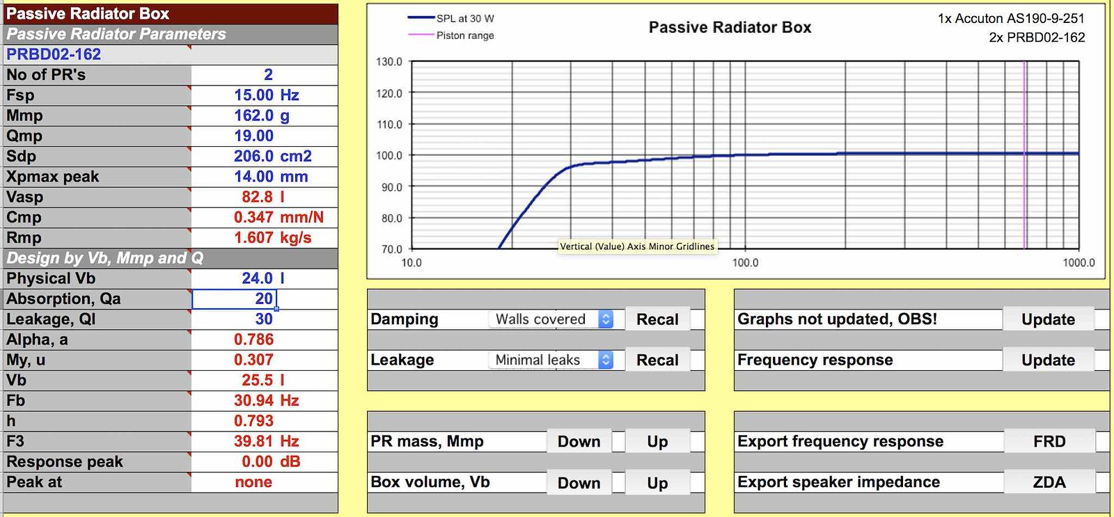

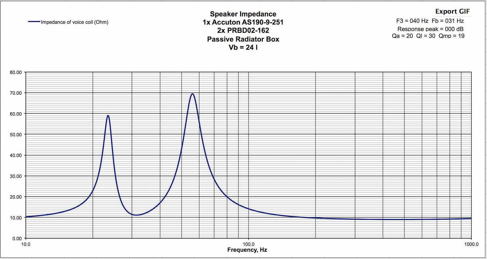

    While it is not as ruthlessly cost effective as some other single vendor designs I have completed in the past; in this case the goal is to be simply, effective.
    Frequency range: 30 Hz to 30 kHz
    Driver complement will include 3x ScanSpeak 10W00-00-00 PR
    Sensitivity after BSC correction: 90 - 91 dB

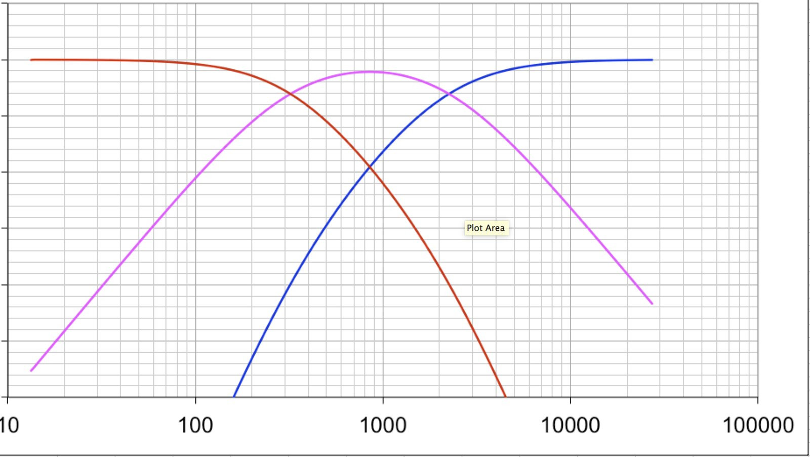

    Proposed Crossover configuration: Duelund with center frequency of 850Hz, Aleph of 3.0
    Footprint: approximately 10-12"W X 18-20" D plus stabilizing legs; height ~ 44-48"
    It could be possible to build this in a modular fashion, and that will be considered at length- possibly even for an acoustical prototype.
    With the planned sensitivity, this might be a good fit to an 80W Class A design which has been under consideration for some time- though it's likely that the maximum current operating point will need to be increased to accommodate what may be a low impedance in the mid bass, even using 9 ohm RDC drivers.
    On the other hand, the recently popular Class D designs should have little difficulty providing stunning SPL's with this system.

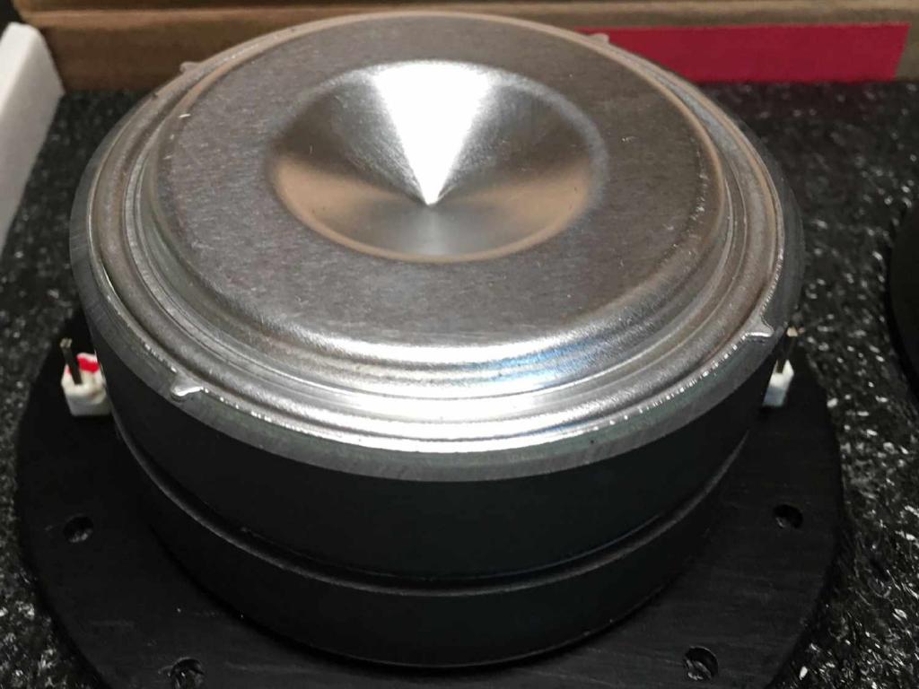

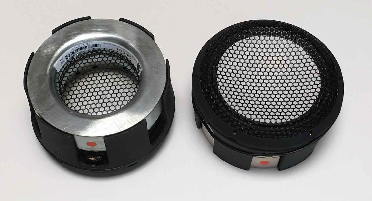

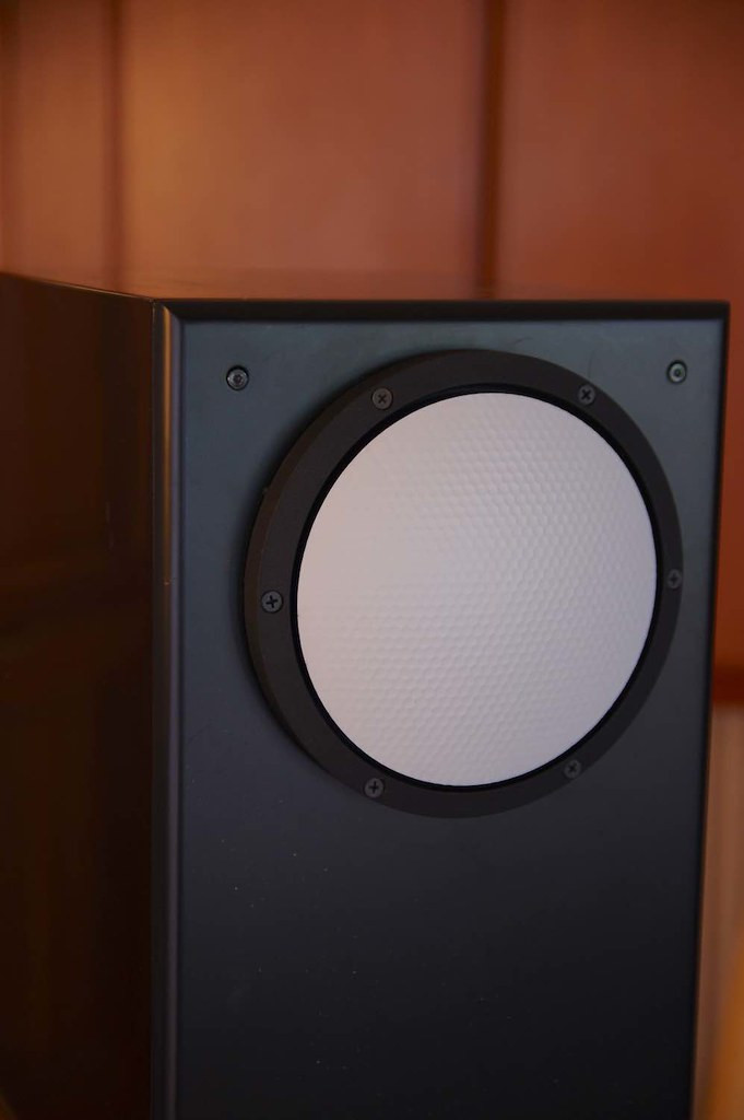

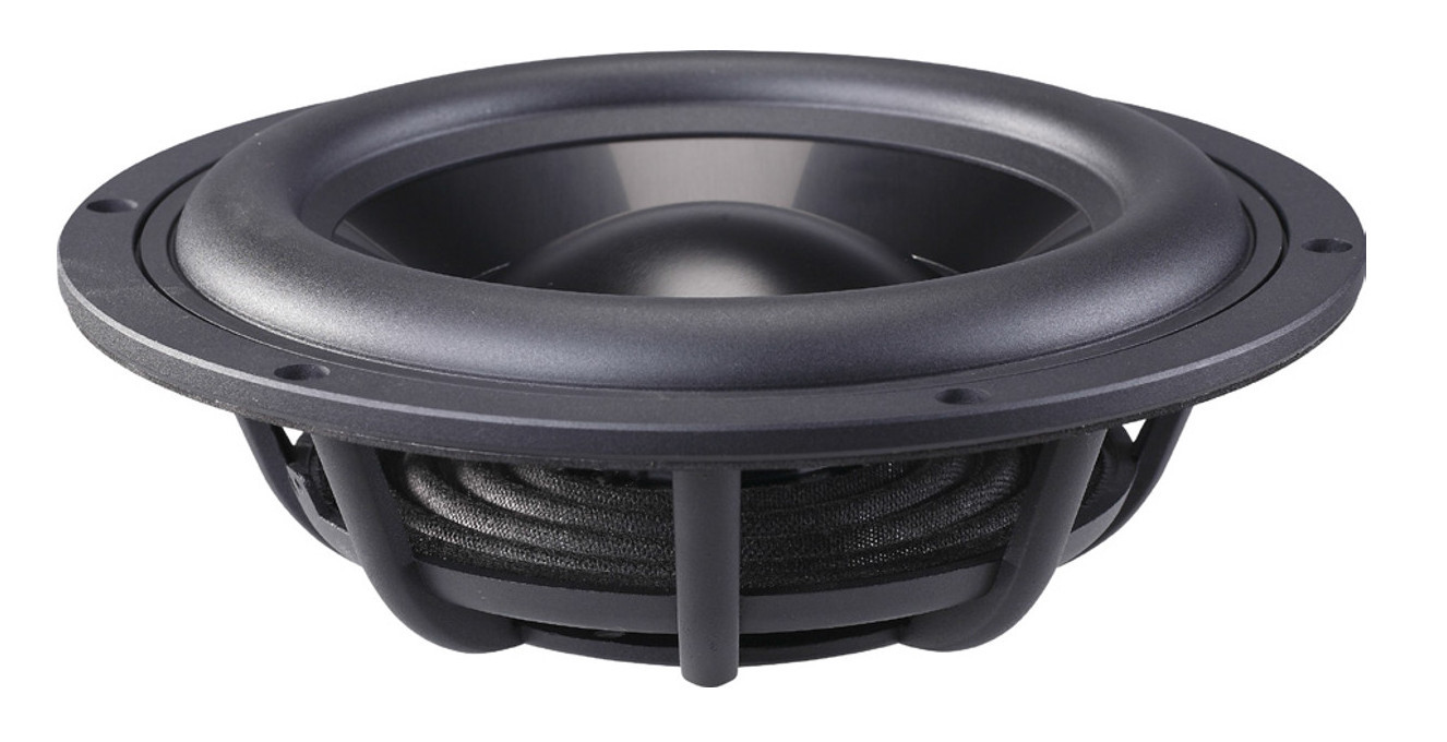

                  AS190 driver- most interesting technology...
                  Though it is likely that many might dismiss the newest Accuton woofers as an exercise in differentiating cosmetics, one would likely miss the point completely with that assumption.
                  Information obtained from captured Bothan spies indicates that performance differentiation on several fronts were sought during their development- with some curiously useful characteristics resulting toward the application of commercial speaker systems, particularly in the now popular tower format. These characteristics were largely confirmed in testing at the Seinar Lab being built up in this system on the western coastal region of the North American continent.

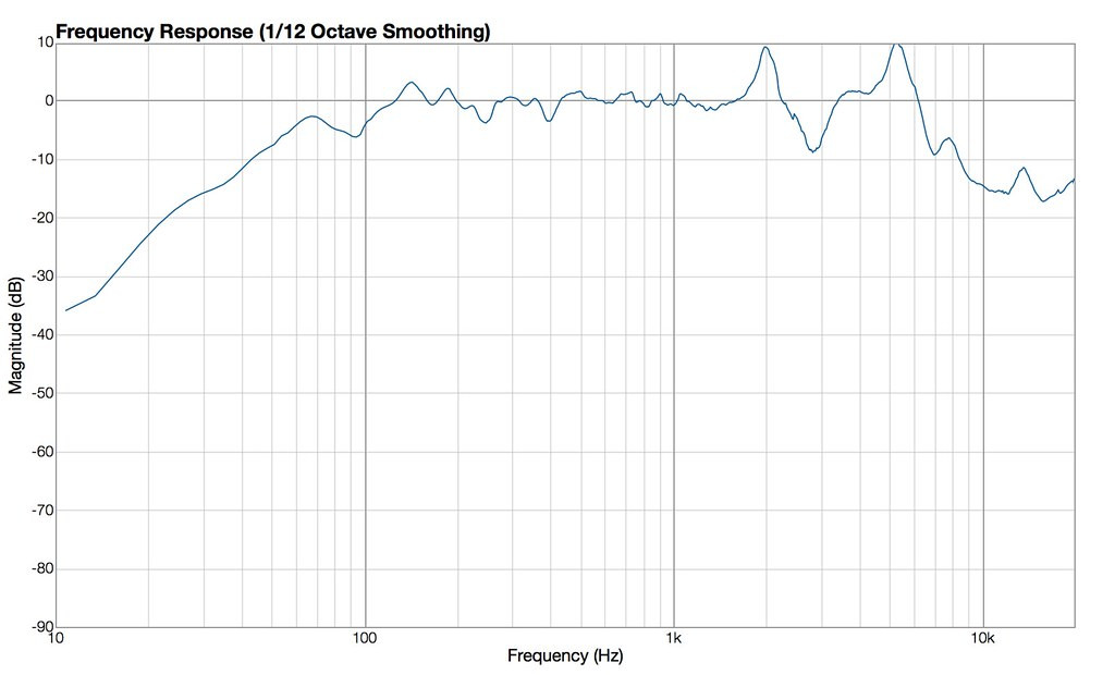

                  Here is a rendition of the test article sample in a relatively narrow small conventional sealed cabinet- behavior at 100Hz and above was the primary focus for today's tests.

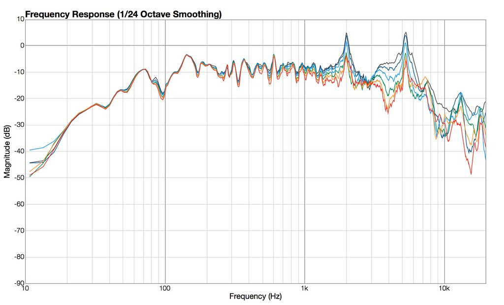

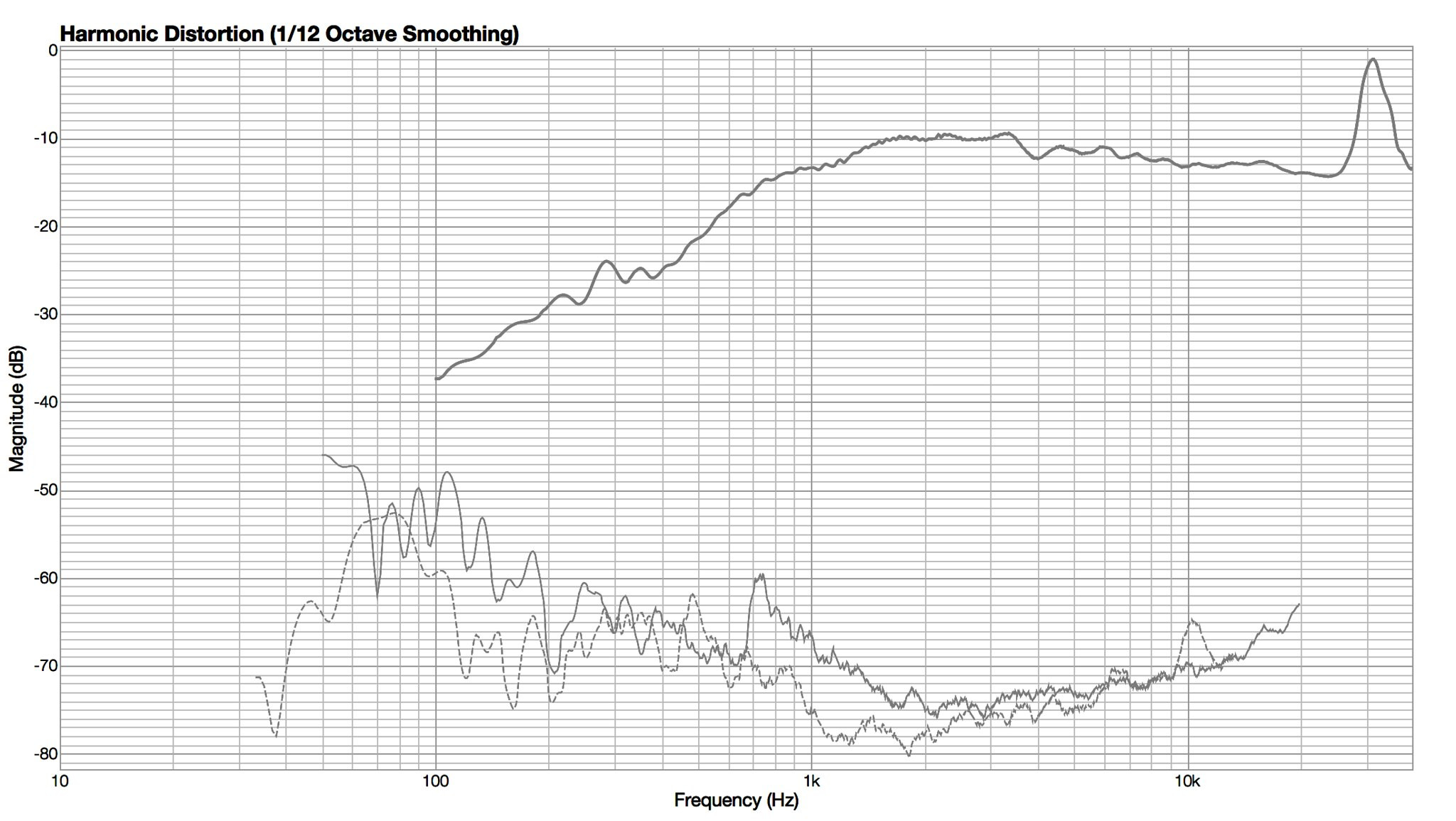

                  Tests were made both in relative near field (15cm), to verify quasi anechoic response and distortion, and a polar set was obtained using 1 meter measurements, a valid condition for the relatively small baffle Note, this cabinet was set upon other test system with a similar front baffle width extending to the floor, and this will have some impact on the overall boundary loading, though it should be relatively small...
                  Near field (15cm) Response, 2.83VRMS, normalized for graphing

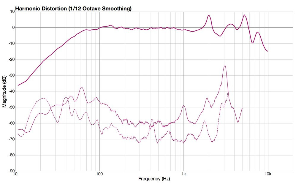

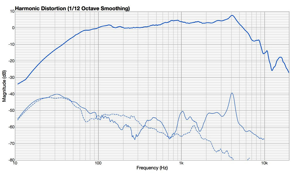

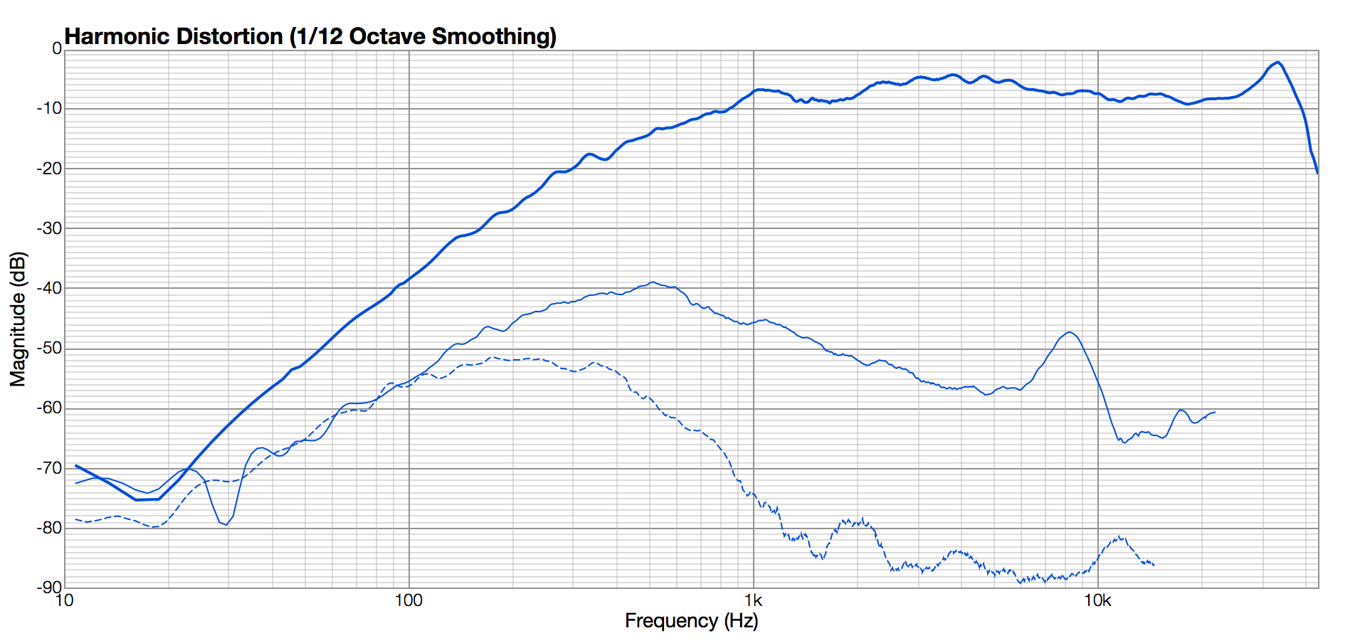

                  Near field, (15cm) Distortion and original signal, 2.83VRMS
                  Results show resonance amplification of distortion products as expected, but excellent performance to 300Hz and quite usable performance to about 750 Hz.

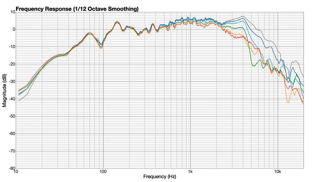

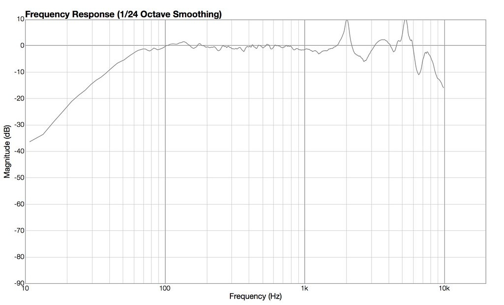

                  Next, on axis at 1 meter, same test setup, no equipment changes other than moving microphone and adjusting graphing level to normalize to 0 dB.
                  And a polar set from 0 degrees to 50 degrees at 10 degree increments.
                  Satisfactory... most satisfactory.

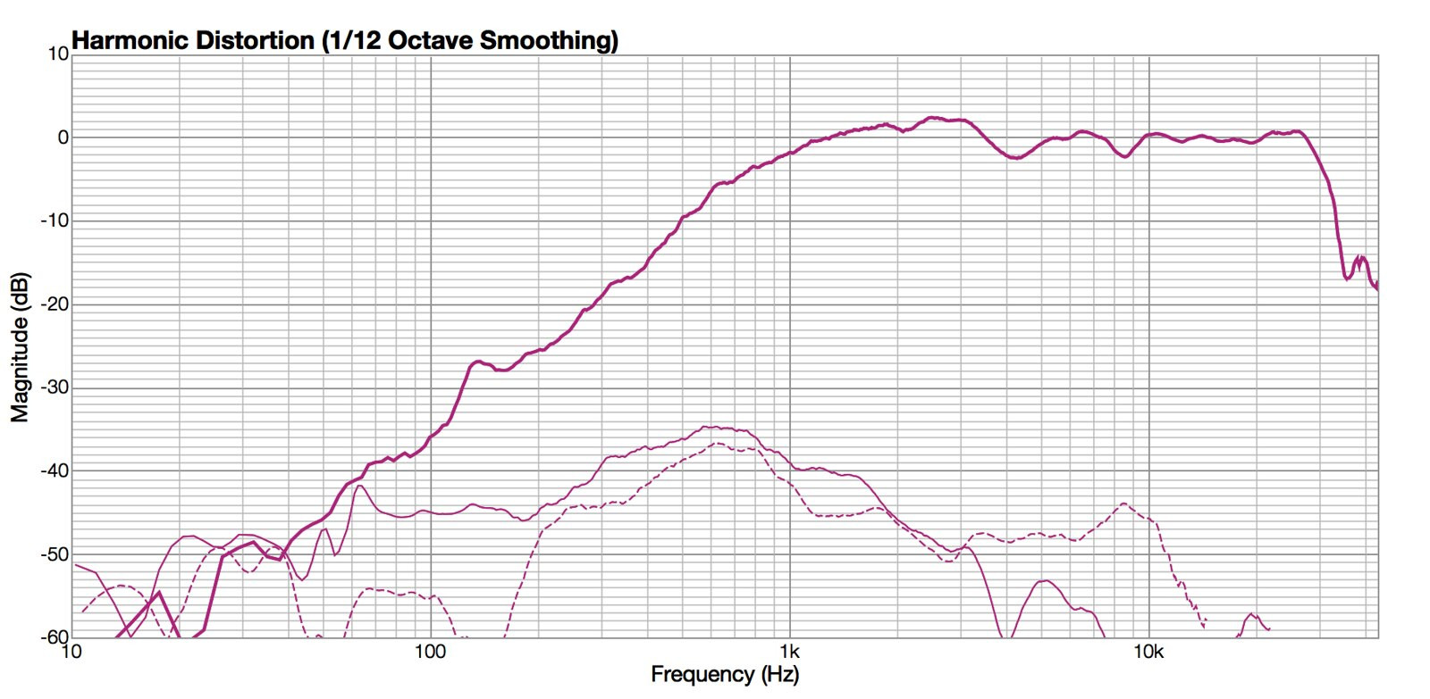

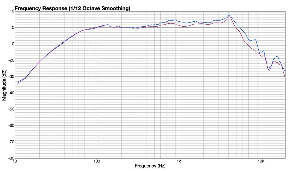

                  Now, just as an alternate data point, immediately afterwards I measured the Motus UH165WP1 driver, a 7" driver with underhung voice coil motor and as mentioned in the NatalieP Ultra project thread, a very promising looking driver.
                  UH165WP1 at 15cm and 7 cm measurement distance (going closer than the equivalent diameter of the driver distorts the results)
                  UH165WP1 Distortion at 2.83VRSM Drive

                  Very respectable results in the context of conventional expectations, and a drive I look forward to working with in the upgraded NatalieP project- clearly well designed, in a conventional sense.

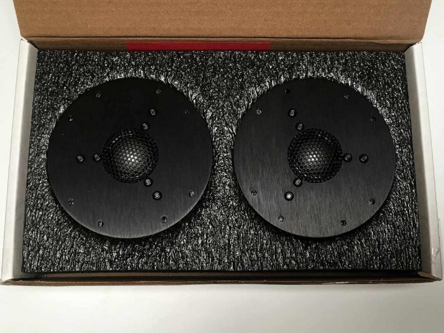

                      • Scanspeak D2908/7140
                      • Accuton C25-6-158
                      • ScanSpeak D2905/9900
                      • SB Acoustics SB26ADC
                      But considering your suggestion, and some of the system requirements for acoustic center time alignment, radiation consistency, distortion and driver impedance, you must be aware of some Dayton or Tangband components which I am not...
                      So please do inform me of an 220cm class woofer in the 9-10 ohm RDC range with 9mm of Xmax with the actual acoustic center in the mounting plane- (to facilitate crossover with critical time alignment requirements such as Duelund) if the frequency response is not so flat as an Accuton AS series, well, we can work with that in the crossover, as we have with the RS drivers and their idiosyncrasies in the past. Sensitivity should be in the 84-86 dB range.
                      Also, please do inform me of a 125mm to 150mm mid woofer which can cover 60 Hz to 6 kHz without undue effort, sensitivity of 89 to 90 dB with an underhung motor (they work exceptionally well with the proper design due to monotonically decreasing harmonic distortion with frequency), and the acoustic center in the plane of mounting (it goes a long way to facilitating a Duelund crossover with a higher center frequency). Something with 4mm of Xmax or more will do.
                      Anything meeting these requirements I will happily and graciously purchase samples to evaluate, especially at 1/50 of the cost of the Accuton drivers to me. This gives a budget of $10 for the woofer, $6.00 for the midrange, and about $4.00 for the tweeter. I am quite excited at the prospect of finding drivers with this level of performance at the pricing you suggest is possible...
                      Clearly the SB Acoustics SB26ADC-C000-4 is grossly over priced at $50, based on the information you are holding and can convey to us...

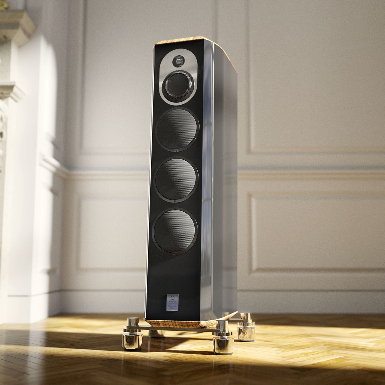

                                The Marten Coltrane 3 ($97,000 USD per pair) was a surprise. I’d never been bowled over by Marten speakers of years past, but I came away from the Coltrane 3 feeling that it’s a real step up in sound quality. Compared to the earlier Coltranes I’ve heard, the 3’s sound was much more authoritative -- bigger, and the improvement wasn’t all in the bass. The Coltrane 3 sounded as if it had been released from the shackles that weighed down Coltranes 1 and 2 -- in other words, it was more dynamically capable. I know that its industrial design is controversial among audiophiles -- one of our own writers found the two-tone baffle/body a jarring combo. But I thought the Coltrane 3 was classically proportioned, with a nice blend of high-tech and artisan touches. The last track I heard in the Marten room was of an acoustic piano, with heavy emphasis of the left-hand keys. The Coltrane 3s sounded large -- in terms of both dynamic range and the soundstage they created. My takeaway: a really nice upgrade from the folks at Marten.
                                For reference, modified or not, (and modifications may be mainly cosmetic- this appears to becoming popular with German speaker builders) the Coltrane 3 is based on the following drivers:
                                • The diamond version of the C30-6-358
                                • The C168-6-990 ceramic midrange (cell type)
                                • The AS250 cell woofer
                                Unlike many of the Tidal models, the Coltrane uses a downward firing port which helps to suppress the midrange resonance inherent in the dimensions of a tube ported system. It also avoids the substantial expense of a high quality passive radiator array; an expense often misunderstood, because due to design issues, many or the majority of passive radiators have quite different small signal behavior from large signal, and the simplest way to address this is to simply use more of the passive radiators to keep them closer to the small signal operating point... an expensive and inelegant solution.

                                          I must congratulate you on a thorough and interesting review of the topic- be assured that you will NOT be assigned to any remote desert planet with fleas the size of small dogs, or to another super death weapon project, which always seems to end badly due to meddlesome rebels- especially if you continue to exhibit such interesting completeness in your commentary. (Fail to do this, though, and the sand fleas you encounter will be of a nature to strike fear in Siberian Huskies... )
                                          A point often overlooked is that the vast majority of conventional high order crossovers require alignment of acoustical centers in order to perform in their ideal sense; otherwise tricks and modifications are required to adjust the phase in the transition region. There are other methods, such as using symmetric crossovers with time delay in DSP that can be of assistance when considering on axis behavior- what these Jedi tricks fail to realize is that the waveform becomes completely compromised when considering off axis radiating behavior and the geometry which works for a front to back alignment is completely irrelevant to the sides...
                                          For this reason, alignment of the acoustic origins is a very significant technological achievement, and brings the possibility of a coherent wavefront at whatever order of crossover is desired over a wide frontal axis, with a uniform vertical radiation axis.
                                          In this regard, reviewers sadly are often not capable of thinking fully in three dimensions, much less adding in the 4th dimension due to crossover time delay effects and the nature of the propagation of electrical signals in crossovers.
                                          It should be noted that this radiation alignment capability would also be very favorable to the Duelund alignment, which in one equation describes a complete transfer function with all the components for a three way system that sums to unity. This concept has several interesting properties, including that apart from the basic equation only the specification of a center frequency and aleph gain factor is necessary to calculate any specific transfer function variant. Additionally, with the caveat that drivers must be aligned in the same acoustic plane, at any frequency, all drivers are in the same relative phase. One phase rotation and only one occurs between the lowest frequency and the upper treble passband. The last interesting curiosity is that if the aleph gain factor is reduced below a certain level, the transfer function devolves to an LR4 crossover.
                                          The Danes as a small country on this benighted planet have made outsized contributions to the art of Audio- Steen's passing in 2005 was most unfortunate.

                                            That Cell bass driver measures quite nicely. What drive level was that at?
                                              That was at an earth standard 2.83VRMS, with 86 dB out at 1M. It is planned to investigate the behavior at higher levels, but consider that a composite set of three drivers in parallel should achieve this level of performance with 95 dB output. Obviously the next time things are setup 5.6VRMS should be added to the regime- this would correlate with for three drivers to 101 dB, certainly a useful benchmark.
                                              Presuming that the planned and calculated low frequency alignment is fully feasible, it should be possible to achieve 110 dB from each cabinet with 30 watts input per driver over most of the low frequency range with Xmax barely over 4mm at it's peak above 30Hz. This leaves some headroom for linearity and higher peak levels, given the rated 9mm Xmax.

                                                Well with the 2nd and 3rd harmonics down 60 and 70dB for the 86dB test (midrange nominal) you can assume that higher drive levels are going to look pretty good too. There's always that balancing act that you typically have to follow between absolute bass performance and trading some of that away for decent midrange too - typical of a true bass driver for the bottom of a three way, rather than a sub.
                                                Still at least you seem to be getting what you pay for here, 60 and 70dB down is impressive and something of a rarity in Accuton's catalogue/past history.
                                                  Given information obtained by an imperial agent visiting them directly, and gleaned from discussions with German loudspeaker producers during and following the Munich High End Show 2016, one might be well tempted to infer some points by "reading between the lines" -
                                                  The previously sandwich structure drivers such as the S280 were a developmental headache and did not fully realize their goals. No further development is occurring on that path.
                                                  The new cell midrange and woofer drivers were an all out effort by Accuton to address key "ideal" requirements from their primary customer base- considering their business model and the market situation, it might not be unrealistic to infer that the future of the company rested on the success or failure of those efforts, and the ability for customers to use them to achieve a new generation of high performance designs.
                                                  The Accuton engineering and manufacturing team seems to have come through, and while not perfect drivers, and while even raising the cost envelope further in some regards, this series seems to have met it's goals and then some.
                                                  The mounting plane acoustic source and the more idealized radiation pattern of the AS190 and AS250 deserve to be labeled breakthroughs- and though Accuton doesn't talk about the details of their new "proprietary" motor design, I believe we can all agree that the measured results speak quite eloquently to their success.
                                                  With this series, new performance envelopes should be opened up to those "skilled in the art", as long as sufficient monetary budget can be procured. But fully realizing their capabilities may take time and development with more than just Accuton's own accessories.
                                                    Another possibility for the LF alignment
                                                    Mssr's Manning and Marsh have brought another set of possibilities to my attention which should work better in the form factor under consideration than the larger passive radiators I have been considering-
                                                    Wavecore PR223BD02

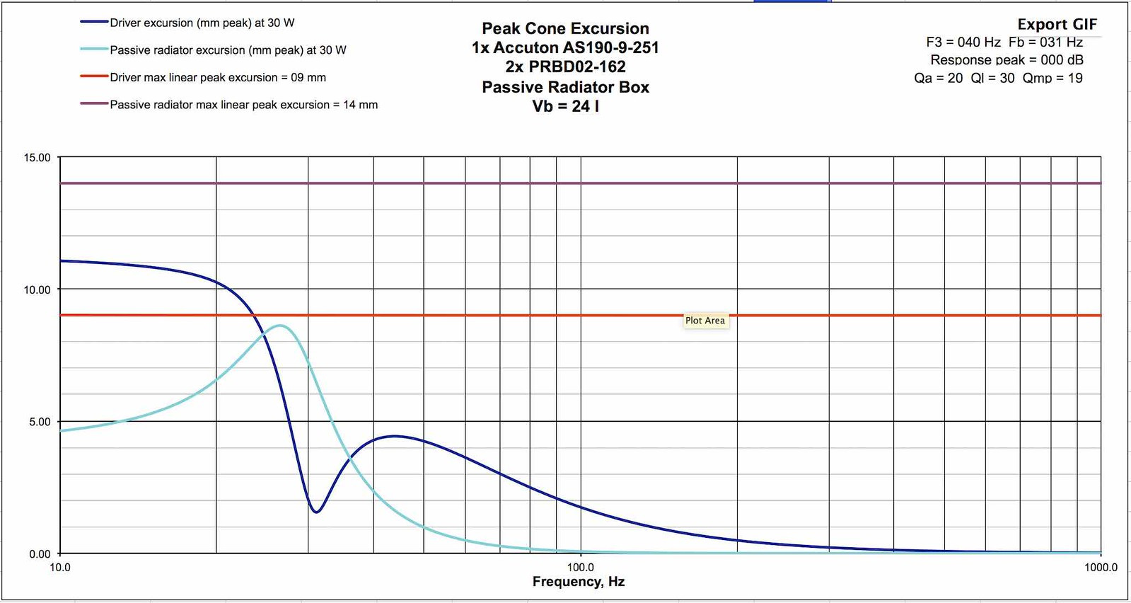

                                                    In a 24L volume with an AS190, and two of these in the stock configuration, it appears we should have a very favorable result- cross checking in another tool verifies this calculation.
                                                    This will be the first configuration tested, as it is by far the most promising of all in a complete design sense.

                                                                    Transducer Lab N26BRG
                                                                    More components with a high surface reflectivity index, this time with a more appropriate and desirable coloration....
                                                                    The grilles are optional and must be mounted carefully...
                                                                    Magnet and rear chamber plate construction is substantially different from earlier products from Transducer Lab

                                                                      I like...:T Are those the aluminum or glass fiber bobbin type? Curious what differences you might expect on a tweeter.

                                                                        Transducer Labs Tweeters look good, but still lack the aesthetic beauty of the new SS Beryllium Domes IMO - Now we just need to establish which performs better!
                                                                        • cochinada
                                                                          • May 2014
                                                                          • 661
                                                                          If I was to place a bet my money would be on the TL. 8)

                                                                            I'm looking forward to the results as well. Just wish TL would go with a face plate that didn't remind me of 1980's Peerless.
                                                                              These are the glass fiber bobbin- they were out of stock on the Aluminum, my initial choice. I expect the bobbin material impacts both the breakup mode resonance Q and to some degree the thermals- if I had to guess, slightly poorer thermals, but perhaps a lower Q breakup resonance.

                                                                                Data from the Ceramic TL shows very good motor performance- at the least, I expect lower HD2.
                                                                                Conventional wisdom might say that the HD2 will make the 7140 sound more "sweet" with a little extra "air"; euphonic colorations in the minds of some. A more relevant point may be how the throat in the mounting plate of the 7140 impacts high frequency dispersion. This remains to be seen.
                                                                                Both are in different performance categories for distortion compared with a typical $50 to $100 tweeter... even some fairly well designed ones.

                                                                                    I did measure my N26MGR-G before:

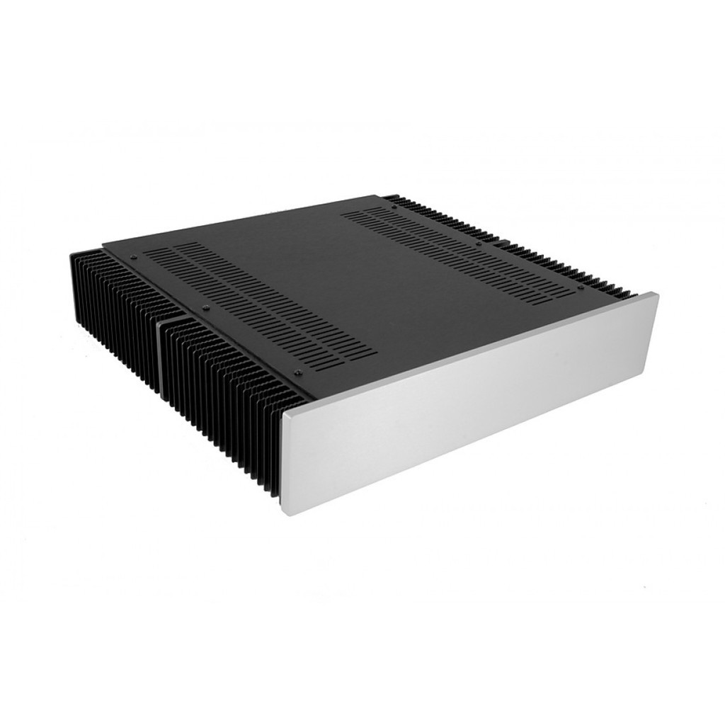

                                                                                        But then I'm the guy that thinks this 70's retro look for an amplifier chassis is just fine for my next Ncore build...
                                                                                          I've got 2 completed amps and 2 in work using that style chassis, in 4u and 5u. Obviously not class D.
