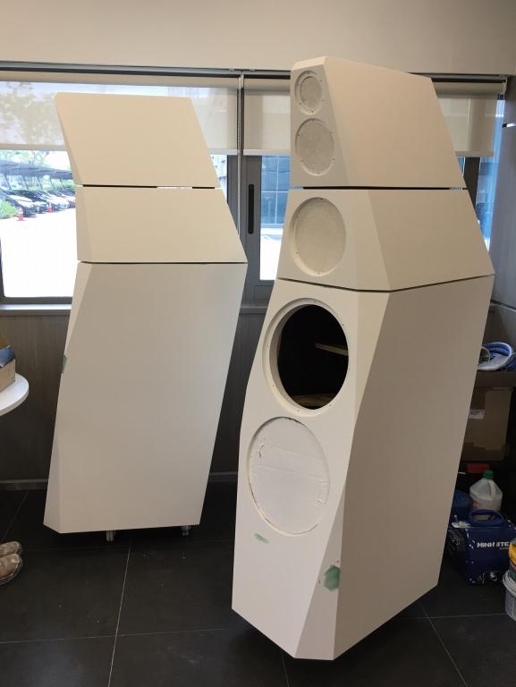

                  Progress from this past weekend...
                  1. All Cabinets now have the base sealer coats excluding the bottom surfaces.
                  2. Still need some further filling (See Green Filler), should have this wrapped up and ready for recoat next weekend. I will probably aim to have the bottom surfaces also painted.
                  3. Have finally tracked down a spray booth to use for the top coats. Thus far I have just been spraying in the workshop... and actually turning out quite well despite the lack of dust control. Spray Booth is a good size with full dust extraction/control, so is perfect to use... aside from having to transport the cabinets to the other side of town.

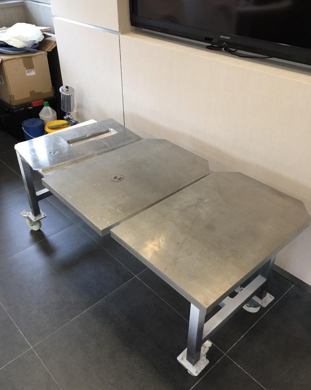

                                            #246
                                            Top separator and base plates have arrived... heavy things... opted for a 32mm thick base plate and they top 30kg each. Now for drill/tap tonight and then will need to find a powder coater! The Mid separator plates should arrive today...

                                            One area I will need to progress is the mounts for the crossover boards. At the moment, I will allow room in both the Mid and Top Cabinet for some crossovers, but will also need to incorporate a shield from the DS8.0 in the mid cabinet... um... Aluminum anyone?
                                            Expecting to be laying down some top coats in the Spray Booth this week, coupled with trying a new Mirka 8" Pneumatic Sander... Big cabinets = Big sanders, well, more of a case of equipment evaluation for the factory!

                                                • 16205
                                                #248
                                                Click image for larger version  Name:	IMG_0660.jpg Views:	2132 Size:	44.4 KB ID:	862418
                                                Some serious stuff, there, Mike! I wouldn't want to be your floor.... but then, I wouldn't want to be mine, either.
                                                The biggest problem with using aluminum as an electrostatic shield plate is keeping a reliable electrical connection to it, to connect to ground or return, however you describe it. Aluminum oxidizes in the air, and becomes non-conductive over time. The same thing can happen to simple clamp on connections to it. It is possible, but not easy, to solder to aluminum. I'd consider copper sheet foil, in this situation. If you want to limit magnetic fields, then you need to consider mu-metal or similar magnetic shielding also. OTOH, distance works pretty well, and mounted in the back and base of the woofer cabinets, I wouldn't expect much trouble, especially as they have linear power supplies.
                                                Otherwise, you could consider using a bit of Halcro technology in your layout...

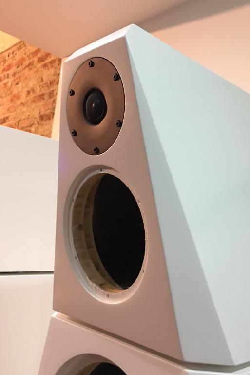

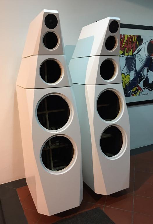

                                                    Great progress over the last couple of days...
                                                    1. Separator and Base Plates now have Red-Oxide Undercoat on them and should get their first lick of top coat later today.
                                                    2. Cabinets are home from the Spray Booth... pretty happy with the off-gun finish, but they will require a polish once the lacquer hardens... will leave them a few weeks before starting this.
                                                    3. Tweeters test fitted - Fit perfectly... I love CNC!
                                                    4. Woofer has been Test fitted, now just waiting on suitable Machine Screws to retain them.
                                                    5. DS8.0 Test fitted, will need some slight modifications, but relatively good fit.
Name:	Full Cabinets.jpg
ID:	862429 Click image for larger version
Name:	Top Cabinet + Tweeter.jpg
ID:	862430 Click image for larger version
Name:	Full Cabinets - Rear.jpg

                                                        #252
                                                        Very nice indeed! :T
                                                        BTW, what slack did you consider for all the wholes? I mean the extra size needed for the drivers to fit, considering for instance the paint and the finishing.

                                                          #253
                                                          Cochinada - Overall slack was about 1.5mm in radius in addition to the documented driver size. That said, I sealed the inside edge and limited the top coats to 2 - 3 layers, then masked them off. The Sealer/Lacquer I used has a tendency to be "high-build", so the type of material/paint you use will be a serious driving factor.

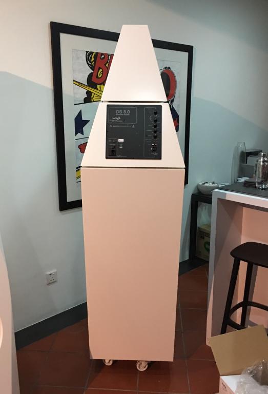

                                                              #255
                                                              Welcome to the family...
                                                              Little Brother, meet Big Brother...
Name:	IMG_0859 (003).jpg
                                                              Subwoofers have been fired up and initial impressions exceedingly positive. The DS8.0 has power to burn and now begs the question... how do the neighbors "feel" about this?
                                                              Lots to progress with whilst I await the Lacquer to harden, Base and Separator plates are currently mid-paint, aiming to complete this weekend. Focus will move to the crossover in a few weeks, but in the mean time need to get my Speaker Tester to tune the Subwoofers.

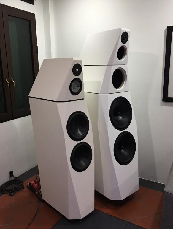

                                                                Oh, did I mention... these are LARGE! Standing them next to the first generation puts things into perspective. Granted, they are still on their roller dollies which adds probably 100mm to their height, but they still tower well above me...

                                                                    #258
                                                                    Very impressive!
                                                                    P.S. now you have a pair of monitors for the surround channels :B.
                                                                    All you need is a center speaker and perhaps a subwoofer or two with some big 18" drives .:surround:
                                                                                    What caused you to not mount the sub amp in the bass cabinet?
                                                                                    • meb46
                                                                                      • Jul 2010
                                                                                      • 398
                                                                                      #267
                                                                                      TEK - Volume requirements and how much it would remove from the final Sub enclosure. It is something that would have been better in the one enclosure, but alas not to be. Part of the driver was to bring better bass to the design from my initial version, so I wasn't going to compromise anything on the bottom cabinet.

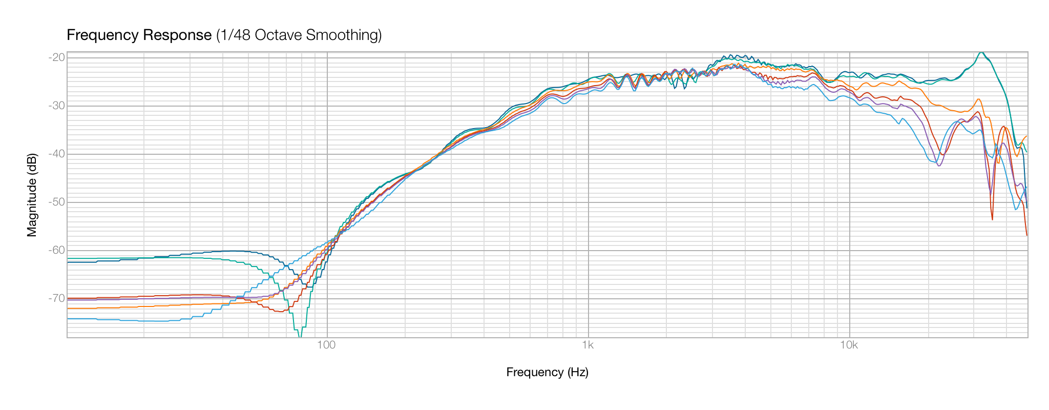

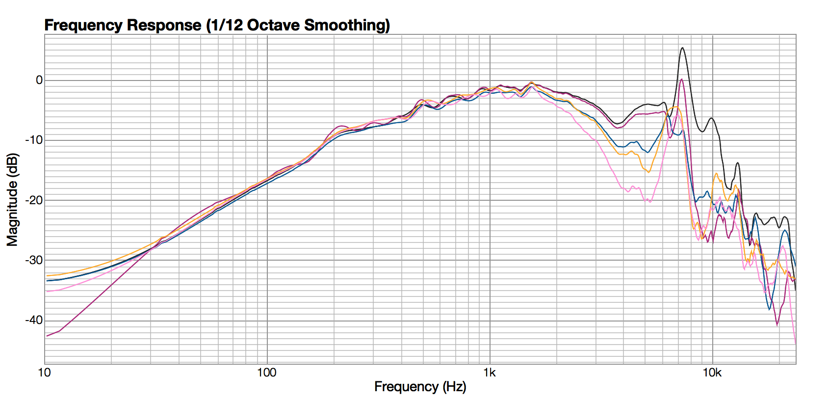

                                                                                        Some measurement updates for MEB's Osiris project:
                                                                                        Here is the composite polar plot for the C168-6-990 taken with the target enclosure design front baffle- from 0 degrees to 60 degrees at 15 degree intervals.
                                                                                        Note that the roll off from 1 kHz downwards is due to both the combination of baffle step (6 dB impact) and the actual driver roll off due to T/S parameters. Note, the C168-6-990 is the only 6" class high performance midrange from Accuton that doesn't use damping ears on the cone (the small black circles); this is possible in all likelihood because it is driven around the periphery of the driver, not at the center with a conventional voice coil, and the spider itself is actually attached at the center rear of the cone.

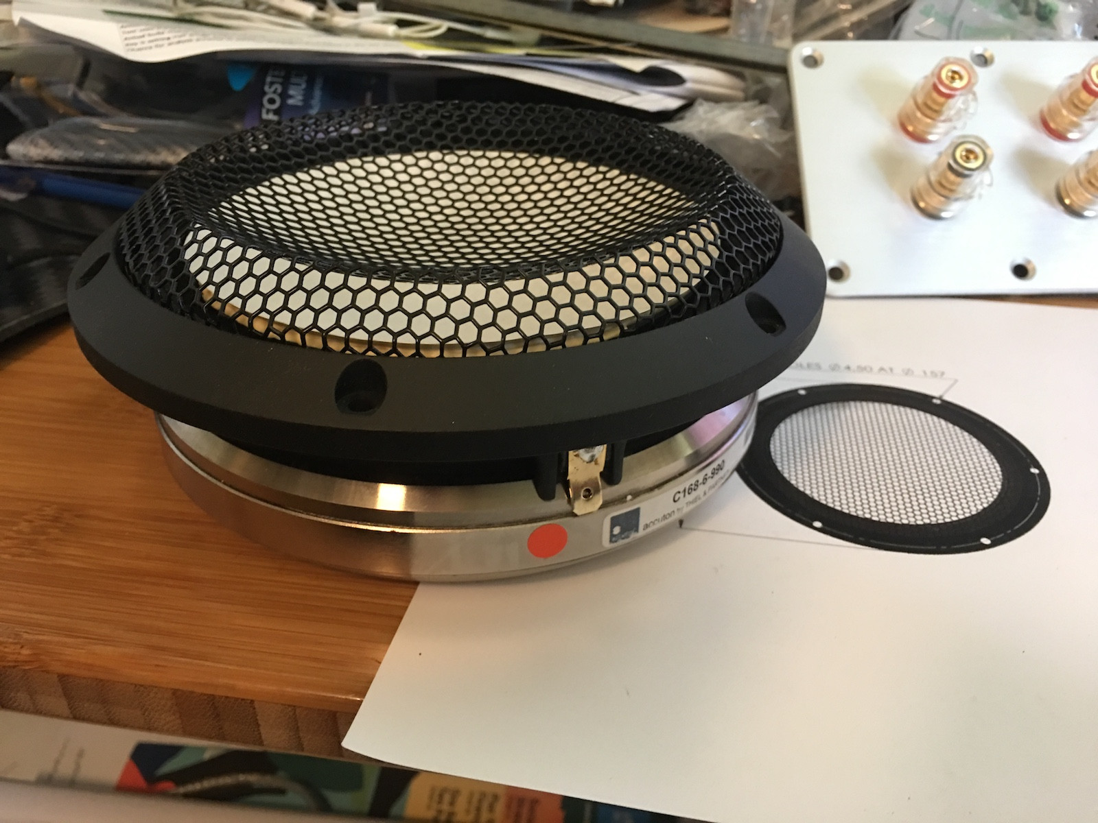

                                                                                        The motor is a relatively slender combination of neodymium and steel wrapped around the periphery of the cone, and uses a very short titanium voice coil. This is how the driver achieves an acoustic origin in the mourning plane, so that no crossover gymnastics are necessary for phase alignment of the filter behavior.
                                                                                        At 7 kHz the primary breakup mode is quite high for a 6-1/2" class driver; one thing that is striking is how high the relative amplitude remains far off axis. This will require a carefully designed notch filter and choice of crossover frequencies to make this inaudible.
                                                                                        Which brings up the polar response- this is a driver with very pistonic behavior, and that alone poses upper limits on the usable off axis response due to phase cancellation from difference in arrival time as one goes off axis and higher in frequency. With the C168-6-990, I'm inclined to go with a crossover no higher than 2000-2200 Hz, and possibly as low as 1800Hz.
                                                                                        Good thing that the tweeter for this project is the very robust ScanSpeak 7140 - it will need some special attention in the presence regions, where what is effectively a short waveguide for the dome (most likely to increase off axis response at higher frequencies) also boosts output in the 3 - 8 kHz area.

                                                                                            The C168 fit was a bit of an issue... a bit snug on this one, around the driver leads.
                                                                                            BTW, after working on this and agonizing over it, I sort of concluded that I don't really have the confidence I'd like to have in my synthesized AS250-8 model, so today I contacted Madisound and arranged a special order with them, for one driver, because they don't list it on the web site yet. (they said "Oops" over that- according to Adam, they intended to have it up there.
                                                                                            That's the good news, bad news it's probably as much as 30 days away. In the meantime I'll work on the crossover with what I have, then refine when I can measure in a suitable box with some real data.
