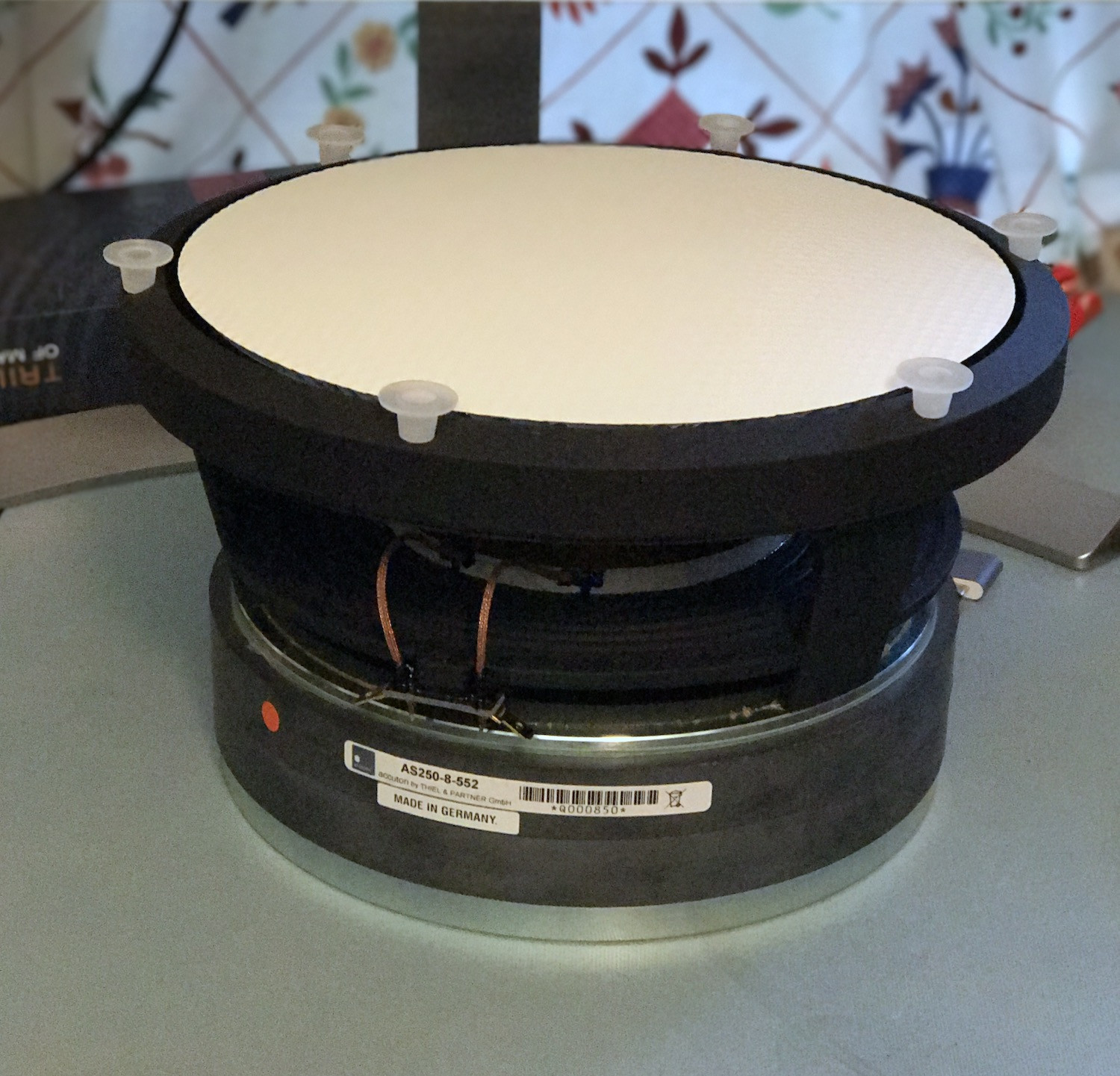

                          Well, Mike will be happy to see my AS250 test sample has arrived- it's a fine looking specimen if I do say so, not hard to figure out why they cost so much...

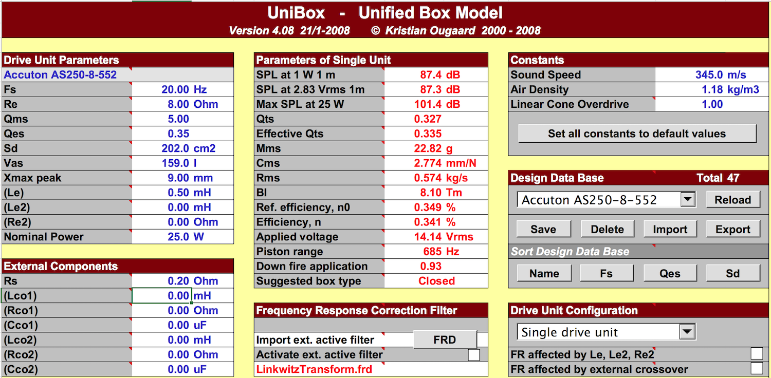

                          This means I've got to get the test enclosure put together, I'll likely re-use one of the knock down sub cabinets if I have one I haven't cut a large hole in yet...
                          What I'm tempted to do, though, is model it in Unibox, and figure out what kind of PR alignment might work favorably with it, and just build that- then I'd only have one build to undertake and store!

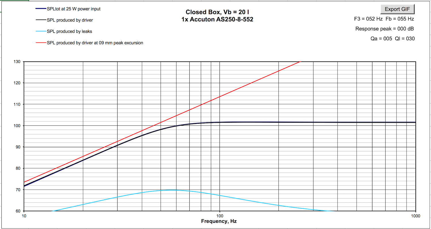

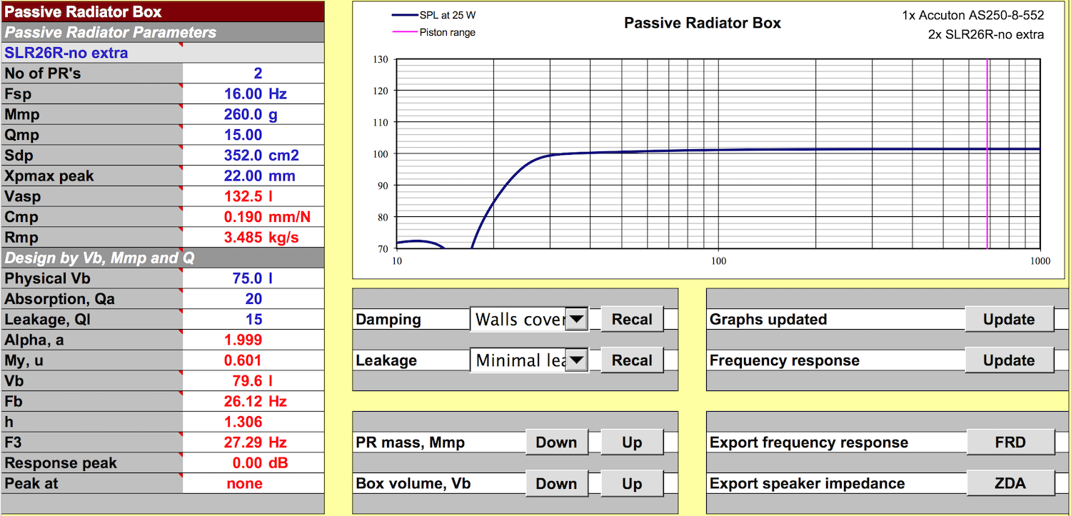

                            Following up on this and setting up what will be the needed test enclosures- for Mike we're talking a mid bass application... the drivers are so similar that the main thing to take into account is the difference in sensitivity due to Rdc. Even for the 8 ohm version, the sensitivity is pretty good, at about 87 dB.
                            The 8 ohm version is a true 8 ohm driver; the six ohm is what most companies would call 8 ohm, with a six ohm RDC.
                            Sealed in the size Mike is using should be fine as a mid bass driver, with considerable output capability above 80 Hz- below that, excursion imposes some limitations, to around 102 dB at 50Hz.

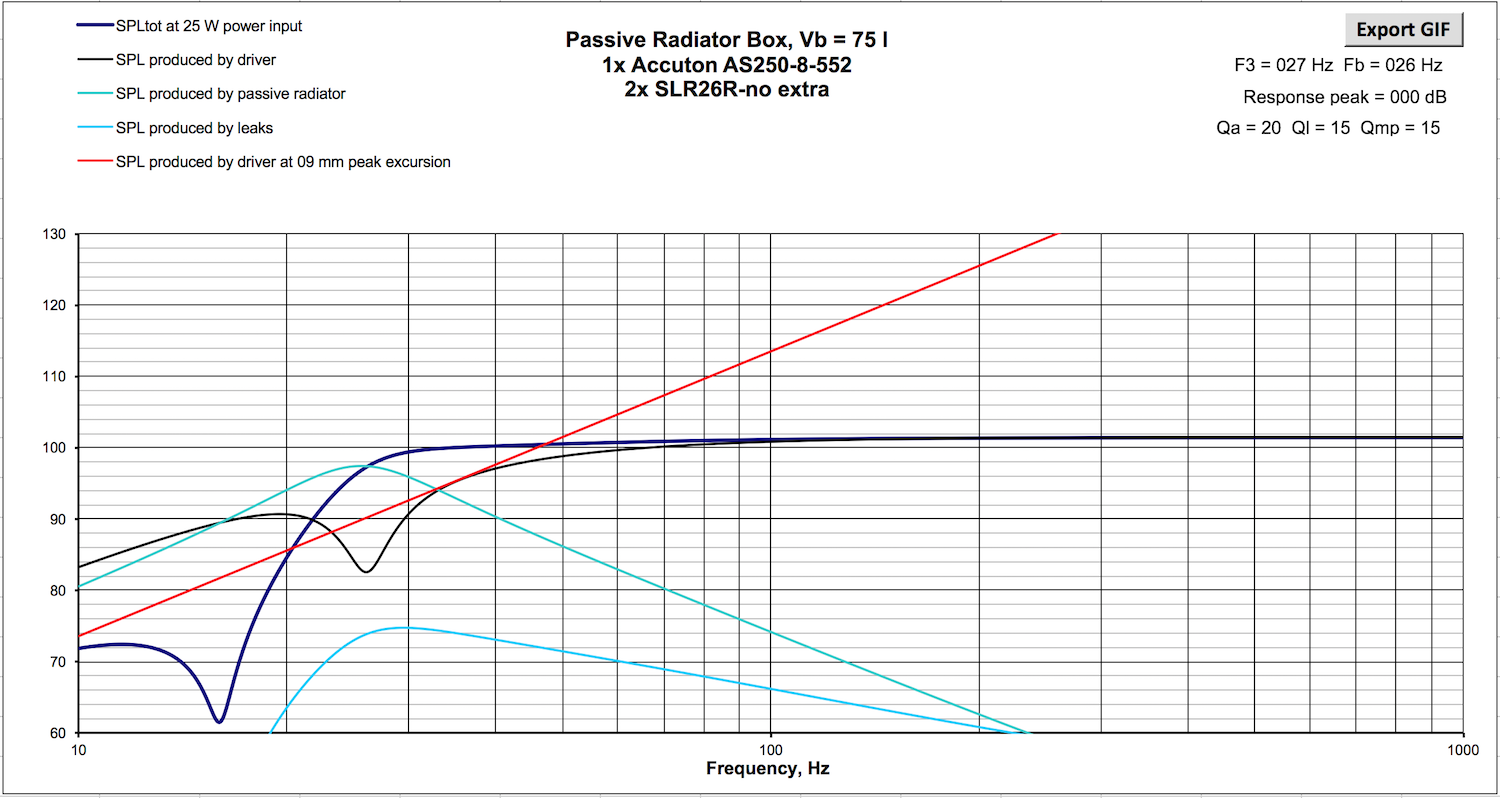

                            So what can I do with this beast after finishing testing it? Hmm, maybe a 2.1 system?
                            Because of the high sensitivity and T/S parameters, going low requires a largish enclosure- if we set an upper limit of 3 cu ft, we still can muster some decent response, and without needing a lot of power.

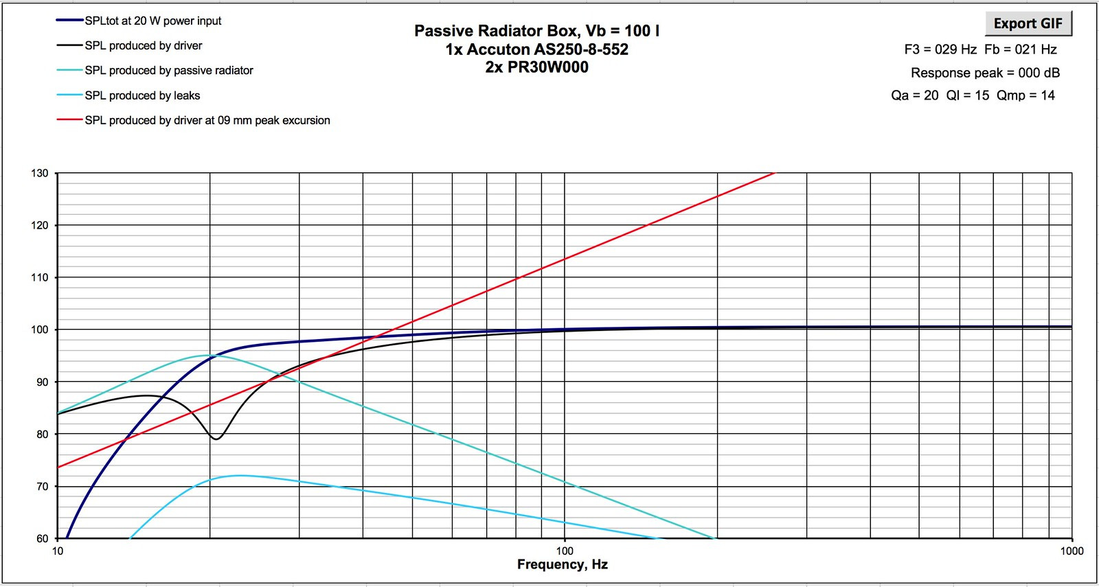

                            This alignment uses two unmodified SL26R passive radiators (*no extra weight) and is nearly flat to 30Hz, with an Fb of 26Hz before the driver starts unloading. For music this should be pretty reasonable.

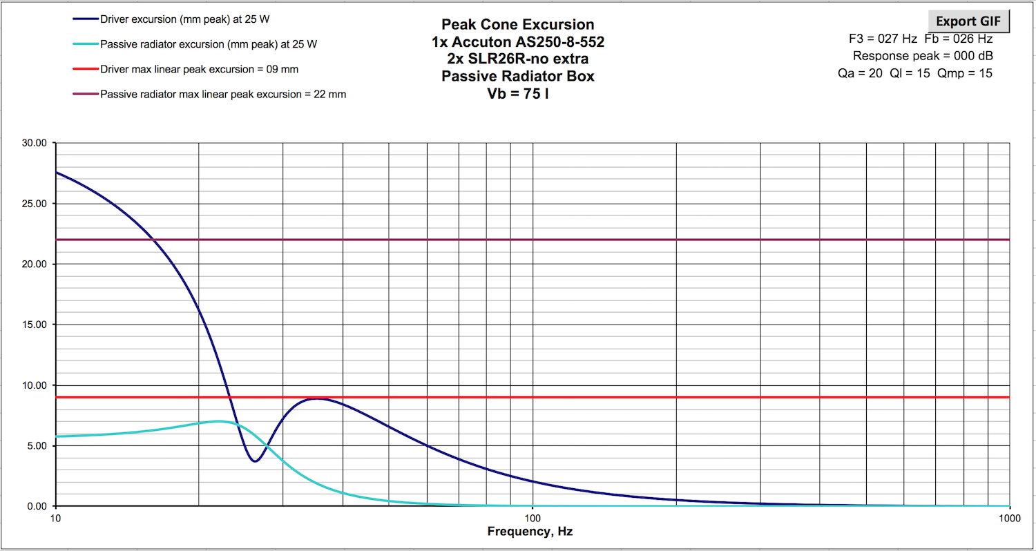

                            25 watts puts things just at the limit for the driver excursion down low-
                            The tuning is something of a compromise- one might like to have the excursion of the driver reduced more in the 30-40 Hz area, but then the PR mass would need to be reduced, and the Fb moved up to around 30Hz, and then it might be unloading too much below that point with some program material. Also, with the relatively low PR output above 40 Hz, the subjective bass quality and transient response will be determined mostly by the drive, and I think that's a good subjective choice.
                            But this isn't how I'd recommend going about designing a 3 cu ft sub, normally... it's more a matter of making lemonade if you've got a bit lemon sitting around (and I don't mean that in the pejorative sense, just to fit the saying.)
                            Some very expensive systems combine the AS250 with the AS190 as the mid bass/midrange driver- that's what Accuton has in mind. Mike is taking a bit different path... :B

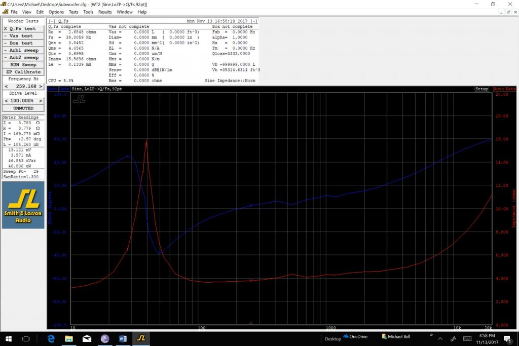

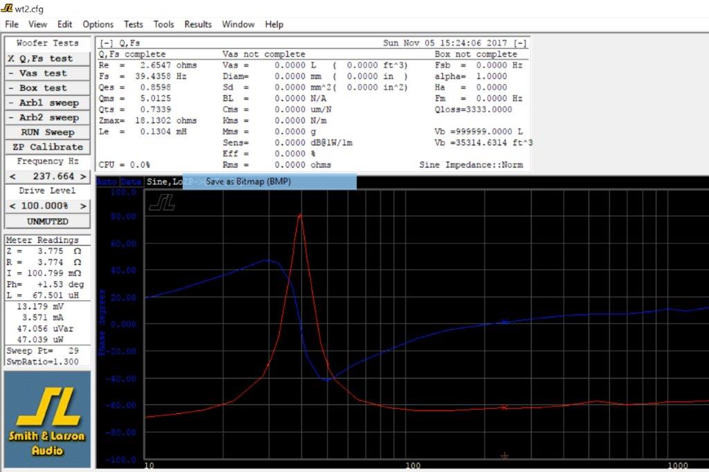

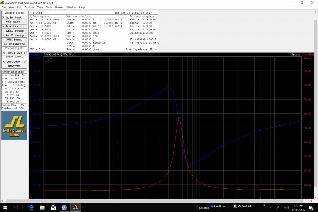

                                                      Some solid updates including wise council from Jon over the last 48 hours...

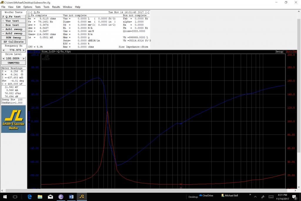

                                                      Have started the tuning process of one cabinet using the Smith and Larsen Woofer Tester. Very straight forward to use, and have been progressively adding stuffing to the cabinets and watching Fs and Qts numbers for the optimum point. I forget how large these cabinets are... thus far they have consumed 3x 5lb Bags of Parts Express Acousta-Stuff. I have been fluffing up the stuffing and slowly adding in 2.5lb increments. Still seeing reduction in Fs and Qts still okay after 15lb of stuffing. Have just ordered another 5 bags of the stuff from Parts Express as I still need to add a little more from my current measurements, and also apply to the second subwoofer cabinet as well as the same process for the AS250. Slow progress, but any progress after such a break is good progress!
                                                      Current measurements as follows:
                                                      And this currently looks as follows:
Name:	Stuffing Picture (002).jpg

                                                        Very educating experience! What were the values before filling and during the process? Did you save those charts or at least the numbers? It would be very interesting to have a table or even better another chart correlating Fs and Qts with the amount of filling used. BTW they look now pretty filled except for the sides (any plans here?) or maybe compacting them a bit more.

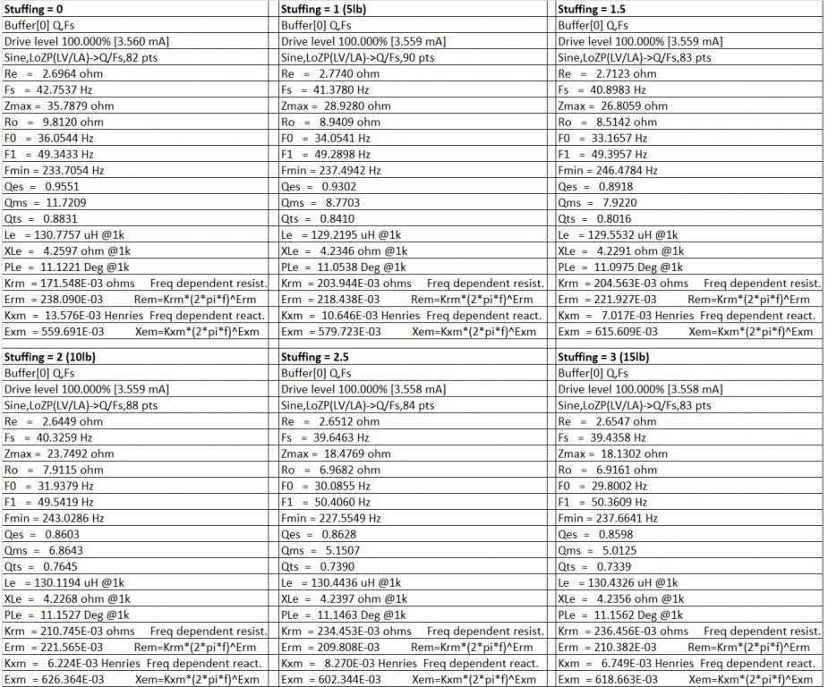

                                                          Hello Joaquin - I see your speakers have developed a lot in the past 6-9 months, great work!
                                                          For the Stuffing Test, I have only saved the numeric data, and then the current plot as shown above. The numeric data of the six stuffing configurations shows a flatenning off of the change in both Fs and Qts. I expect i will need another 1lb or so before I reach the optimum point... which I expect to be around Fs= 39.2Hz and Qts = 0.73. This is based on plotting the information you see below... and making a couple of assumptions. This will be verified by measurement obviously!
                                                          The stuffing is mainly kept in place by the internal bracing and the adherance it has to the felt lining on the walls. If you remember from earlier posts, these have a lining of Bitumen sheets, then wool felt on all inside wall surfaces. For the last 1lb of stuffing, I may just use a small about of spray adhesive to apply some to the walls in which you see bare felt.

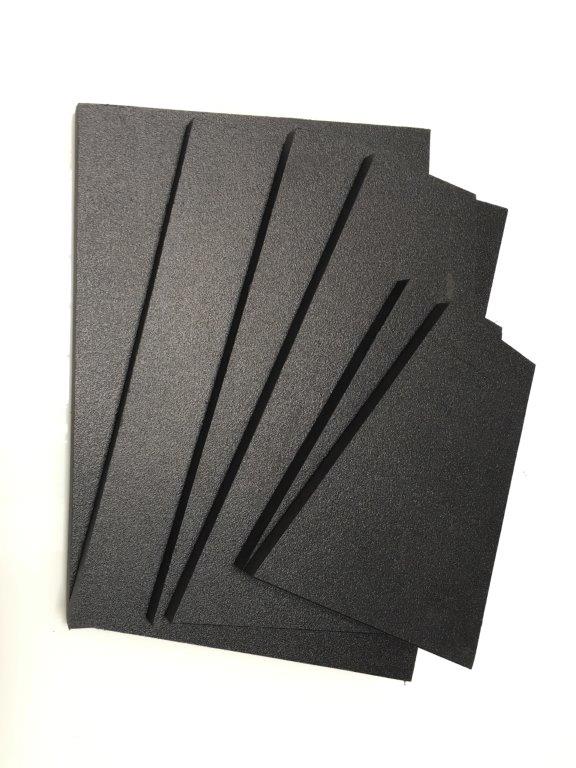

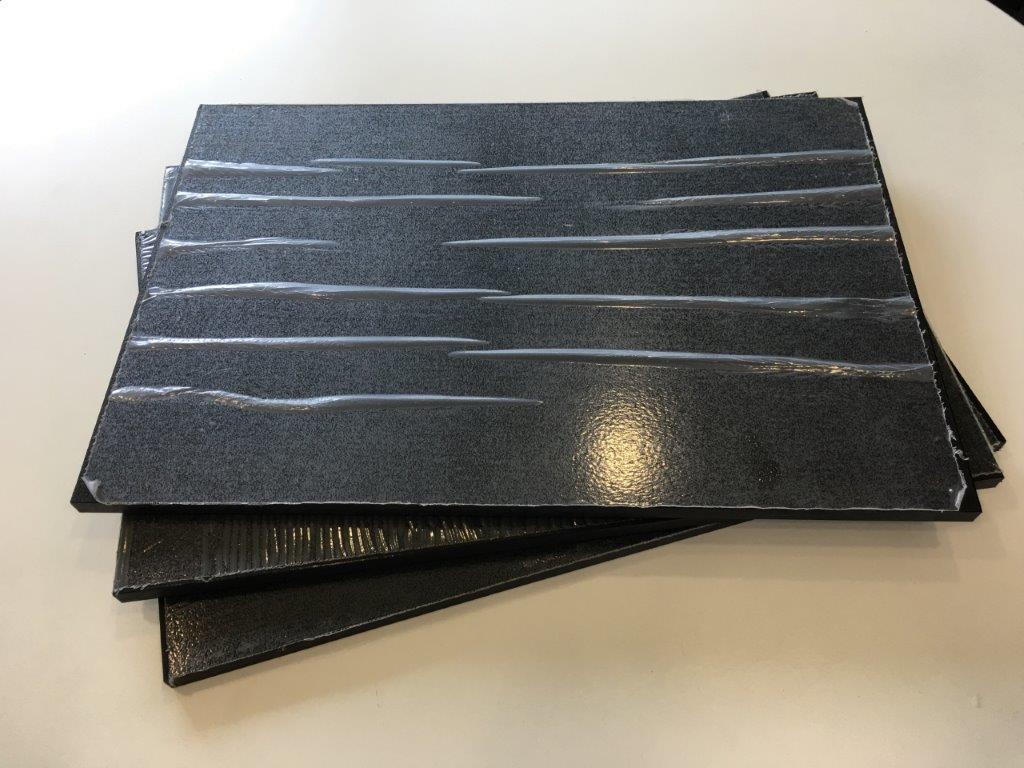

                                                          Weekend progress has now got me "jazzed" for more activity tonight... Have cracked out the plastic/ABS Sheet I purchased sometime back to build crossovers on. Will get these measured up tonight and hopefully cut toshape tomorrow. I have made allowances to put the Mid/Tweeter crossover in the top cabinet, and the Woofer crossover in the middle cabinet with some shielding between it and the Subwoofer amplifier.
Name:	ABS Sheet.jpg

                                                            Thanks Mike.
                                                            Assuming stuffing 1.5 = 7.5lb and 2.5 = 12.5 lb this is the chart I come up with (linear trends depicted as well):
                                                            I didn't use any glue on my stuffing as I didn't find the need since the material is both light and sort of sticky but maybe it's a good idea to use some spray at the walls like you mention.
                                                            Those plastic sheets for the crossover look good. How do you plan to fix the components on it?

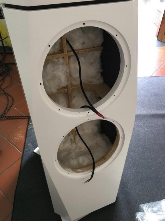

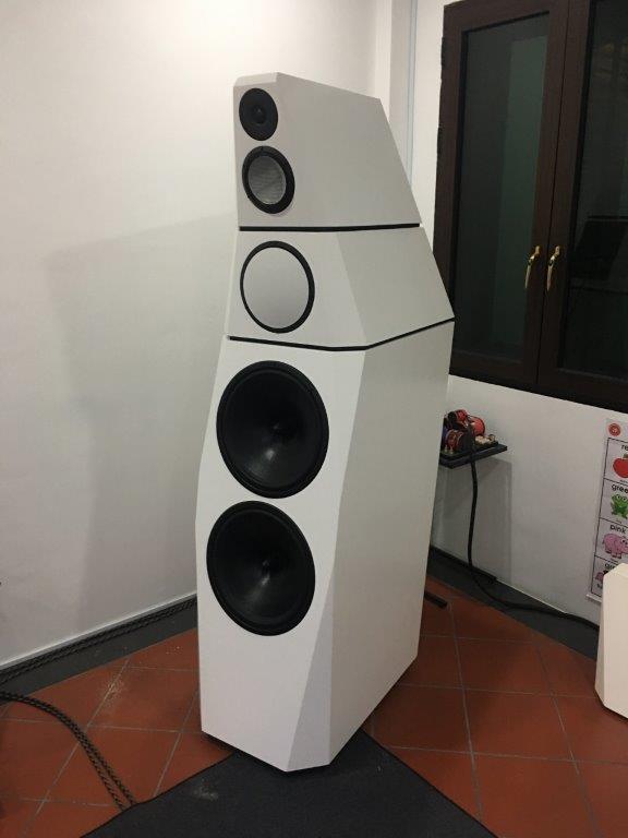

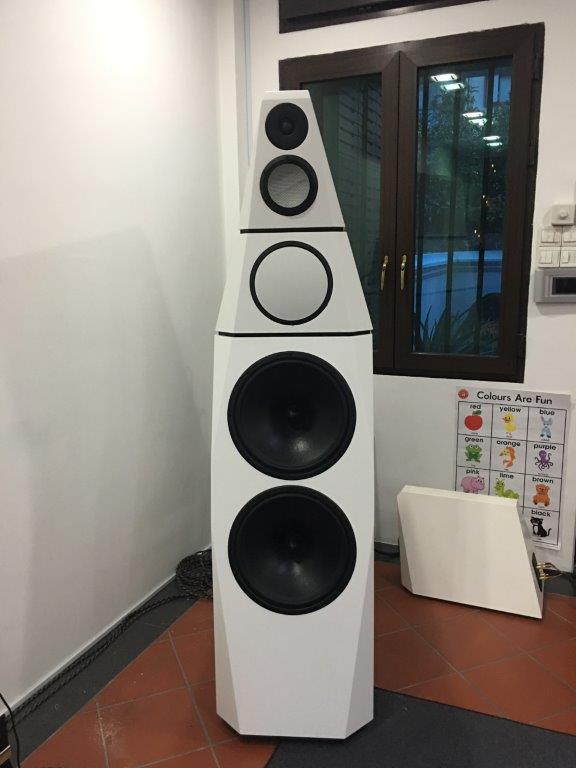

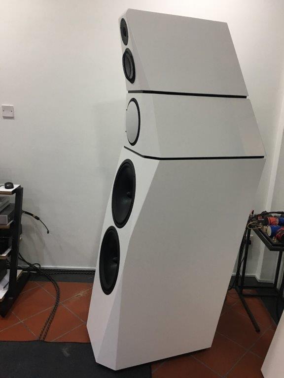

                                                                  First pictures of the cabinet with all Drivers mounted... pretty happy with the way this has turned out... but now run the temptation of connecting up the Mk I crossover to get a taste for sound!
                                                                  Jon - Once I get my final bags of stuffing, I will get the final impedance measurements and plots and send them through to you, including the mid-range.

                                                                    #303
                                                                    Those look awesome Mike. :T
                                                                    • cochinada
                                                                      • May 2014
                                                                      • 661
                                                                      #304
                                                                      x2 :T
                                                                      How much do these beasts weight?

                                                                        • 751
                                                                        #305
                                                                        Wow, just wow.
                                                                        My personal tastes run to wood finishes rather than painted speakers, but those are stunning. Wow.
                                                                        Gorgeous Mike, very , very elegant. How tall are they?
                                                                        Ron
                                                                        Ardent TS
                                                                        • meb46
                                                                          • Jul 2010
                                                                          • 398
                                                                          #306
                                                                          Hmmm - Weight... I actually have no idea. I might have to do some calculations but would expect them to be well over 200kg each.
                                                                          Height - 1930mm
                                                                          • Horio
                                                                            • Sep 2014
                                                                            • 163
                                                                            #307
                                                                            Holy moly Mike, those things look amazing! For your neighbor's sake, I hope you're walls are nicely damped. I'm looking at following your lead and painting my Wavcor Ardents which I hope to start in the new year.

                                                                                      So progress continues in the last couple of days as follows:
                                                                                      1. Completed Tuning of the Subwoofer Cabinets, with as much expected results... see below...
Name:	TD15S Subwoofer Plot.jpg
                                                                                      2. Continued with basic Impedance Tests on the Tweeter and Mid Range... see below... Still pending review and understanding these. Will work through this in the coming days.
Name:	R2908 Tweeter Plot.jpg
Name:	C168 Mid Range Plot.jpg
                                                                                      3. Managed to get all of the Crossover Boards Cut and will be test fitted for mounting locations in a couple of weeks time. The intention is to split the Crossovers into the Base Cabinet for the AS250, and then the Top Cabinet for the C168 and R2908. The later being a stacked approach across two boards, and the AS250 one in the Base Cabinet have a shield on it to protect from the DS8.0 Plate Amplifier also sharing the same cavity.
Name:	Crossover Mounting Panels.jpg

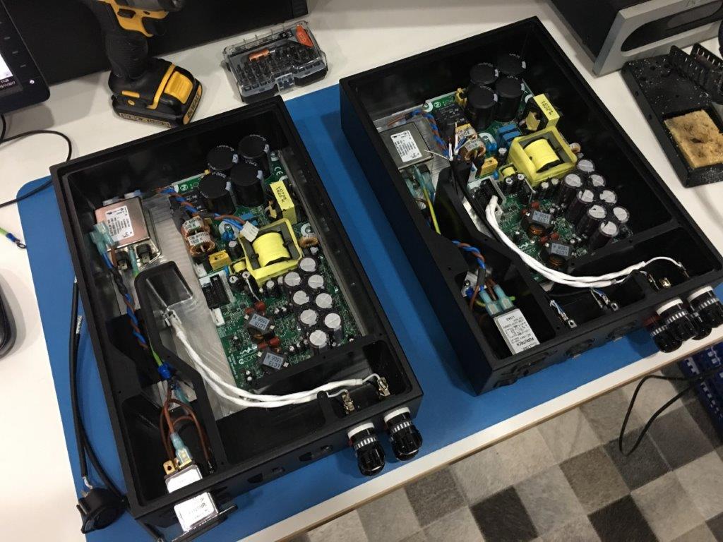

                                                                                      In terms of whats going to power these things front end...
                                                                                      1. Source - Typically using my Surface Pro 3 and Tidal HiFi for my music these days, plus on the occasion FLAC JRiver
                                                                                      2. DAC - NAD M51
                                                                                      3. PRE - Auralic Taurus PRE
                                                                                      4. Amplifier - Still using my Rotel RB1092, which has power to burn, but a very clinical sound. Current plans are to first try the beasts shown below... These are my Hypex NC502MP Powered Amplifiers that will each be run in Brigde Mode (~1KW/Channel). Failing this, if I decide I dont like these, I may switch to a NAD M22, or possibly even two M22's in a bridge configuration. Yes, it would seem I have an appetite for power, but having heard the difference on my earlier versions of speakers between the Rotel RB1092 with ~600W/Channel, and the Bel Canto ~300W/Channel, I am simply not going to power the beast with anything less than 500W/Channel. Please bear in mind, the Subwoofers are actively powered by Hypex DS8.0 PLate Amplifiers that reside in the back of the speaker...
Name:	Gorilla Amp - 1.jpg

                                                                                          Interesting the NC502b and nice cases!
                                                                                          I have found that my NC500 has no sound signature per say but I think my DAC and preamp create the sound. I bet when you get setup you could run the M51 without the pre in to hear what the DAC sounds like then add the pre in as it my give you an indication of working with the sources to get the sound you like. Going to be fun while you get them dialed in.
