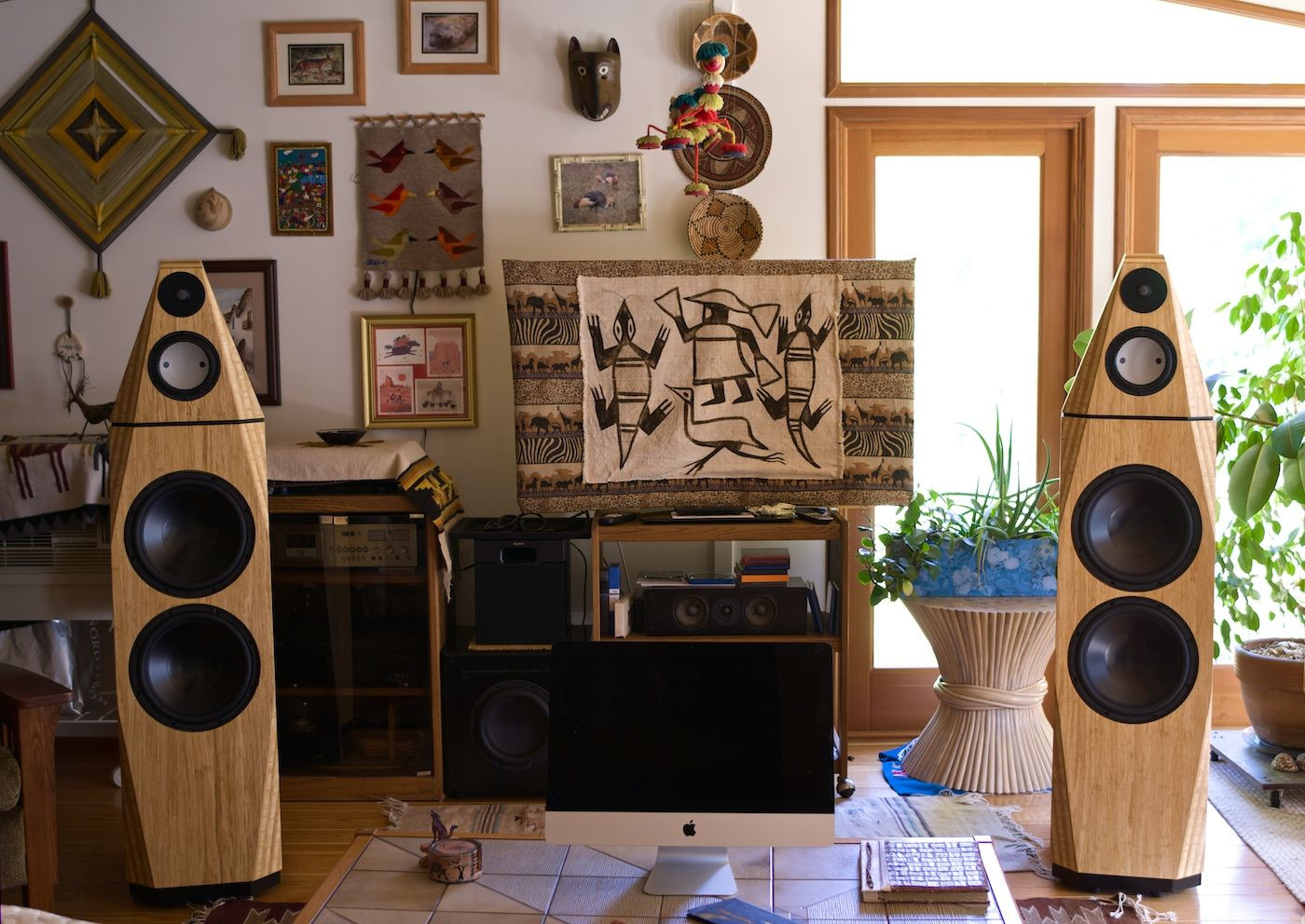

                        The 7" is playing real nice in my new centre.
                        I've been play with your Ardent cab drawings to fit the SW223BD01 in. The baffle looks to need to go to 11.25" w but the 0.75 ft^3 per driver sealed is perfect for the Ardent cab. One thing I'm not sure on though is the small mid space you have got for the C90-9-79. I was thinking 0.35 ft^3 for the C90-9-79?
                        When I get it modeled I'll post. I may have use of a 5 axis CNC to do the cabs, let me know if you want to do a full new pair with the SW223BD01.

                            Awesome! I've been excited about building a set of Avalon-ish speakers since you started this thread way back.
                            Well see about access to the 5-axis (though I think we can do it with a 3-axis as well) next week, would be a simple matter to cut a third set and flat pack it to you provided the shipping isn't prohibitive.
                            I'm modeling these guys in solidworks currently using the drawings you gave dar49 (my dad) and myself--now I'm running into some questions:
                            What are the criteria for the facet shapes? I've been pouring over as much literature as I can find on detraction but "Direct Radiator Loudspeaker Enclosures", Olson, 1953 only really tells me that facets are good, not how to design them. Additionally, it looks like you started experimenting with felt to mitigate defraction around the tweeter, I was thinking we can build this into the grill (which I think is what Avalon does?) then build the x-over that way?
                            Finally, from every picture I could see from inside the Avalon factory the enclosures all seem to be made out of MDF. If it's good enough for them is bamboo, baltic birch, ect, overkill?
                            Anyways looking forward to your reply. I have about 6 months to build these guys before I move to another city and lose access to the old mans tools.

                              Some thoughts about your questions -
                              In this case, the narrow triangular front is not concerned much with diffraction control (that's not avoidable- just having an edge creates diffraction), but rather reduces the baffle width and raises the BSC frequency- so that below that frequency, you have wider dispersion. You see this trend also in dipole speaker designs- trying to make the dispersion more uniform over a wider range of frequencies.
                              Yes, Avalon builds diffraction control felt into the grille; I've done this with other projects like the M8 and M8ta. It's the easiest way to handle it.
                              well, I'm not going to go say that you can't build a good speaker with MDF, but I'll note that my Ardent set uses bamboo in the baffle construction. Also, state of the art in loudspeaker cabinet construction is more in evidence in company's like Wilson Audio, Magico, YG Acoustics, Rockport, etc- Avalon's basic cabinet construction techniques haven't changed significantly from what I was doing in the late 70's and gave to my friend Charlie Hansen who founded Avalon and developed their first models, the Eclipse and Ascent. Actually, those early prototypes I have Charlie were a bit more sophisticated than what Avalon usually does, having multi-layer constrained damping using a form of Celotex as an internal damping layer.
                              I wouldn't personally do the Ardent without the inner bamboo construction- it's such a better material to work with, whether you're looking at strength, stability of any type of screw fastener used to attach to it, whatever... You wouldn't make a solid body guitar out of MDF, now, would you... I feel similarly about speakers, especially after finishing the Isiris construction. (No veneering either, which has some advantages, too). OTOH, good and honest men of high intent will continue to build speakers out of MDF, and generally be pleased with the results. It's a matter of expectations.
                              Go check out and listen to a set of Magico's sometime... it may recalibrate your expectations.
                              Then build a small set of a standard design completely out of bamboo... I'm pondering doing that with a set of NatalieP's or a reworked version of that design or the NeoD CC using small monster woofers, maybe Wavecor or my set of NOS Exodus Anarchy (would make more sense to use something available still). I need a set of small monitors for my music playing stuff.
                              It wouldn't surprise me if I'm looked at as being a radical curmudgeon on this DIY board, and rather wacky to my high end audiophile friends, but it's likely because I'm not stuck in either world, but try to take and use whatever is useful, and works.
                              OTOH, I can certainly see the utility of CNC MDF, and would be interested in building a set based on that just because of the time it would save, time I'm in a total crunch for with my current work situation. It all depends on how the pieces are built up, and obviously, CNC'ing a composite structure of bamboo and MDF probably isn't feasible. OTOH, just doing the whole FP out of Bamboo might be enough.

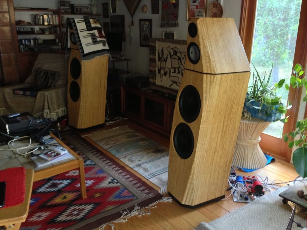

                                  I alternated sheets of high quality MDF and Baltic Birch on my curved Geddes Abbey 12a build and felt that it gave me a best of both worlds - mass and strength. I'm not sure, but my nerd instincts think that having two different materials would help with transmission of vibrations thru the panels as well. All I can say is the sides of my Abbeys are REALLY dead. Hmmmmmm.... Ardent with curved laminated sides and faceted front baffle all done in figured walnut!
                                  Tom
                                    Tom
                                    Now that would blow my mind! :T

                                                                  Hey Jon,
                                                                  Is that a picture of a Galactica variant on your post? It looks like it has an Accuton midrange with a round frame.
                                                                    • 16144
                                                                    #1518
                                                                    Originally posted by bigg
                                                                    Hey Jon,
                                                                    First it's probably a good idea to establish what is a variant of what....
                                                                    The industrial design source of the Galactica as well as the Isiris is the Avalon Isis.

                                                                    My project, the Isiris, follows as closely in the Isis foot steps as is feasible in some important regards, and deviates with deliberation in some others.
                                                                    The midrange is the same low distortion high sensitivity, unfortunately now rather expensive 6-1/2" Accuton C173N-6-90.

                                                                    While the original Avalon Isis is constructed also of MDF, the Isirs is constructed solely of LBL Bamboo- laminated bamboo ply, which is far, far stronger and stiffer than MDF. A 2-4" wide board of 3/4" MDF can easily be snapped across your knee; you will hurt yourself very badly trying to do that with LBL ply, and it won't even annoy the bamboo... :W

                                                                      Galactica? NO it's ISIRIS!
                                                                      Beautiful woodwork on the Isiris!

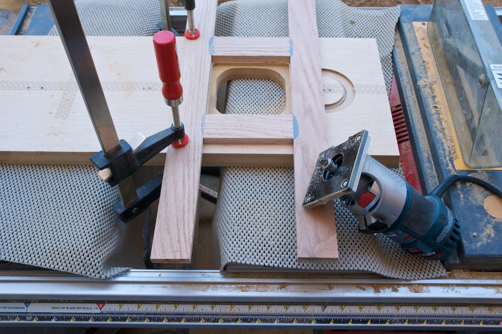

                                                                              I built a special jig for that and used a door jamb rebate router bit to cut the rebate for the C79. Worked OK, but it wasn't trivial!

                                                                                  OK, some hints from the past: Routing the rebates for the C79 midrange driver, simple fixture:
