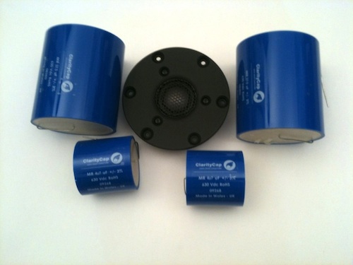

                                                                                Not so low budget speaker porn
                                                                                Got lots to do this weekend, but will be pushing out the speaker work in spite of parts needed and received.

                                                                                          Holy shit, Jon, those capacitors are gigantic!
                                                                                          -Josh
