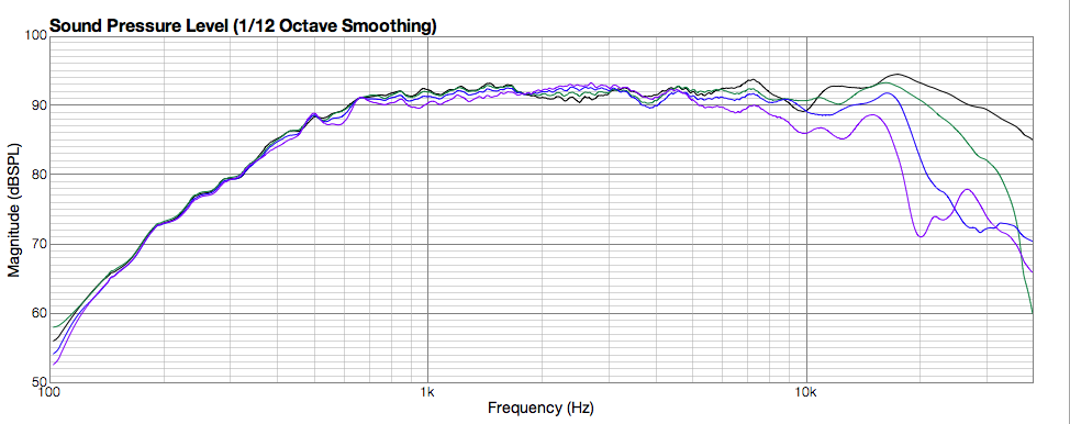

        Yeah, I've got my fingers crossed on the D2004/6020. Personally, I think Scanspeak is on a roll these days- some of that I relate to even more on the lower cost products they have, like the former HDS tweeter, now D2608. Five to seven years ago, there wasn't that much I liked in their lineup.
        I'm really hoping that the Beo tweeters will control diaphragm resonance and distortion in the way that the Accuton diamond tweeters do- but at 1/5 the cost, of course! I may be a bit too optimistic, but we'll see.
        I'm expecting similar distortion performance to the D3004/662000, but who knows... I wouldn't mind a bit less HD2! I'm going to be doing a lot of tweeter "shoot outs" the next couple of weeks!
        To my untrained eye I thought the standard 6600 or 6620 aircirc had better off axis response, but that was just looking at the SS graphs. I am very much so anticipating ETs evaluation. :drool::drool::drool::drool:
