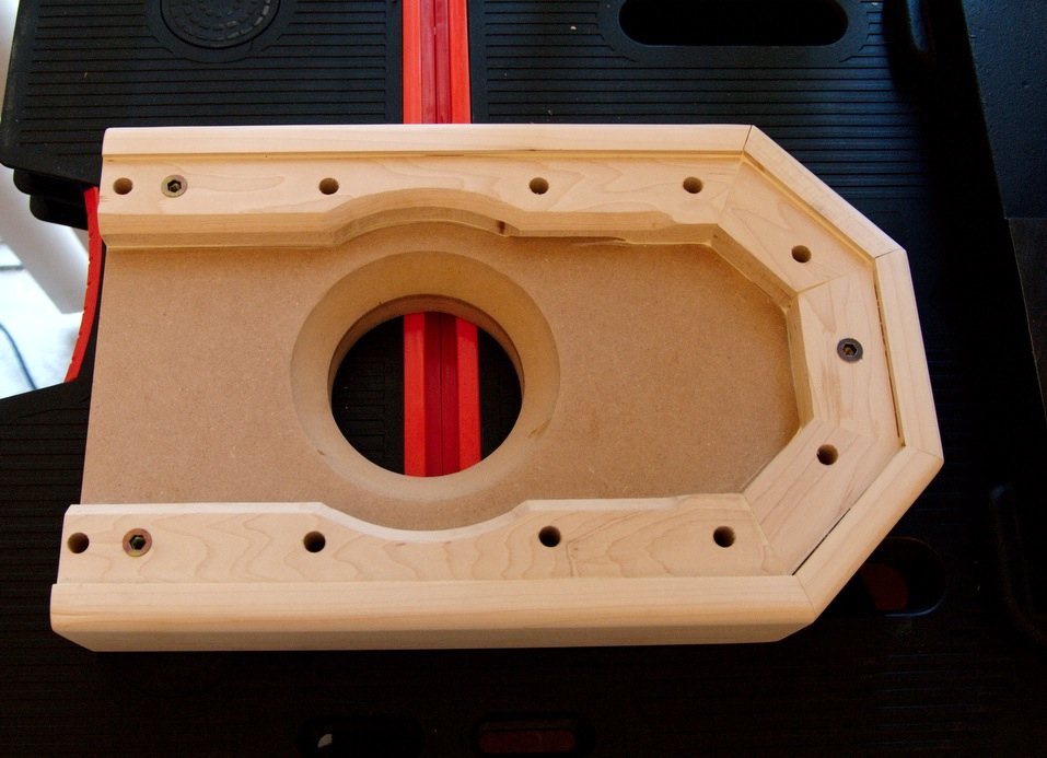

                                                Bases mostly wrapped up for today- it's one of those jobs you could do with a hand drill guided drill brace, but in this case I was glad to have the benchtop Ryobi drill press- made it easy creating a template guide in phenolic for both the bases and cabinets, and drilling the actual pieces was a cake walk- even the connector bolt through holes which are 2-1/2" deep The metric threaded inserts worked fine with the same 3/8" pilot hole, just not as deep! I used a DeWalt piloting bit that has an inner pilot drill, and is titanium coated.

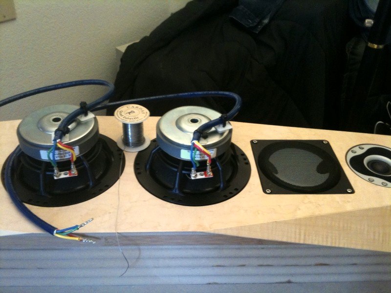

                                                                      The details take a surprising amount of time...
                                                                      At least it always seems to me- I think, oh yeah, I'll put in the threaded inserts and wire up the drivers in no time-
                                                                      But there's the stripping and prep, tinning, wire tie downs, etc.
                                                                      It's like a paraphrase of the old horror movie...
                                                                      Slowly I build... step by step... inch by inch. :W
                                                                      And knowing I'm going to have to take these back apart to finish them doesn't help!! :lol:

                                                                              Hey Jon,
                                                                              Is that the Kimber 4TC on your woofers?
                                                                              I mentioned to Madisound that I would like it if they carried the Kimber Kable product line and they replied that they would like to but that Kimber's ordering policies made it hard for them to do. :cry:

                                                                                Originally posted by bigg
                                                                                Hey Jon,
                                                                                I believe that it is Cardas Crosslink.
                                                                                Mike Mastin
                                                                                  • 16089
                                                                                  #715
                                                                                  Correct. Cardas Cross link on the woofers, Cardas SE-9 on the midrange and tweeter, for the lower inductance.
