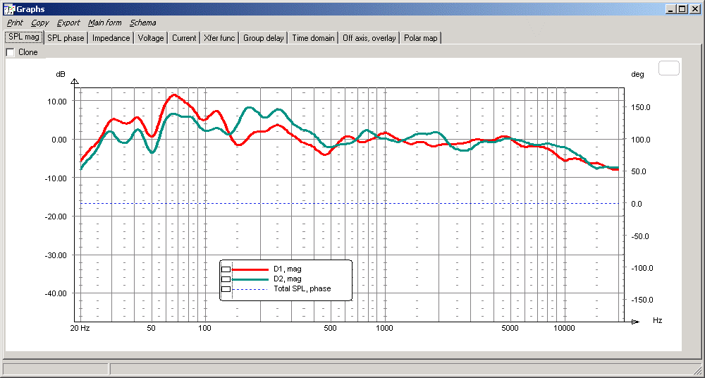

    Anyway, I just took some new measurements of the drivers in box. Much to my surprise, the Neo8 changed its performance quite a bit - it has more output in the lower midrange (around 800 Hz or so). The Neo3's response is as terrible as always (since those were used units, I'm not surprised).

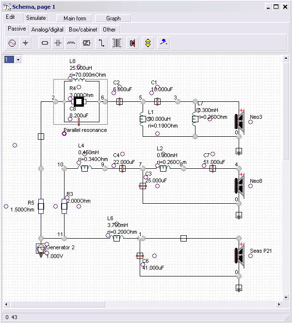

                  Here's the new crossover for the SEAS P21.
                  I've been living with this speaker for quite some time now, and I prefer it to any other designs. The Neos have a certain sonic signature to them (more accurately, they don't have any sonic signature, in my opinion) that makes me go back to them all the time. They are a joy to listen to - never tiresome, aggressive or misbehaved in any way. The only shortcoming I really dislike is the fact that they don't have a great off-axis response. I tried to minimise this problem in this design by aiming for a 30° flat frequency response, and it helps.. when you are at or near the sweet spot.
                  These have been my reference speakers for quite a while.

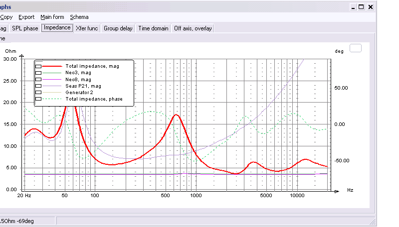

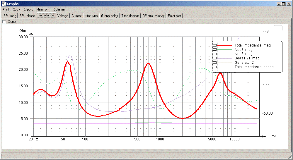

                  Impedance: Quite a bit more benign than the first design. The design is about 4 dB less sensitive than the original one, though.
Name:	Nueva imagen (1).gif

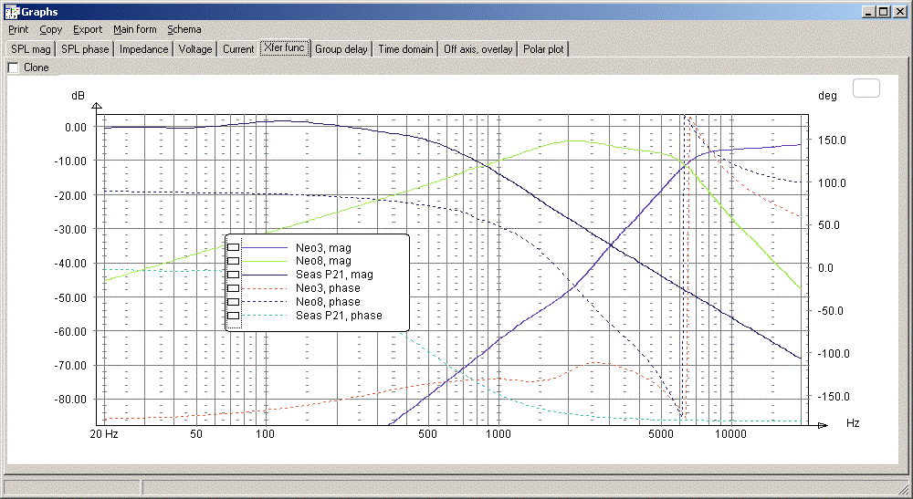

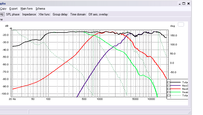

                  Transfer functions: smooth transitions all around.
Name:	Nueva imagen (2).gif

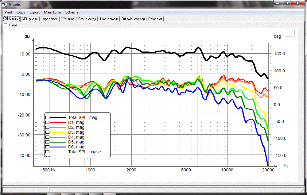

                  Frequency response at 30°: The Neos measure badly at 0°, but at 30° they behave nicely.
Name:	Nueva imagen.gif
                  Final crossover design: Most of the parallel caps are shown like that because that's the way I built the crossover (I wanted to use a couple of stuff I had from previous projects).
Name:	Nueva imagen (3).gif

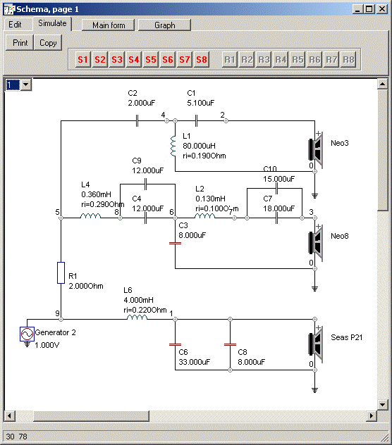

                              Here's the design.
                              The changes I made to the original are:
                              * Lowered x-over point from the tweeter to the midrange: 3.2 KHz, LR-4.
                              * Added a series filter to the tweeter. The Neo3 has a rising response in the top-end, and although you could avoid using this filter, I found using it makes the speaker sound a bit more natural. The exaggerated highs are very obvious when you remove this piece.
                              Here's the schematic. I used Dayton polypropylene caps all around, except for the shunt ones, which are basic non-polar electrolytics. The big inductor on the woofer is an Erse 14GA with an iron core, in order to keep sensitivity higher.
                              The impedance is fairly benign, with a single 3.5 Ohm point in the midrange.

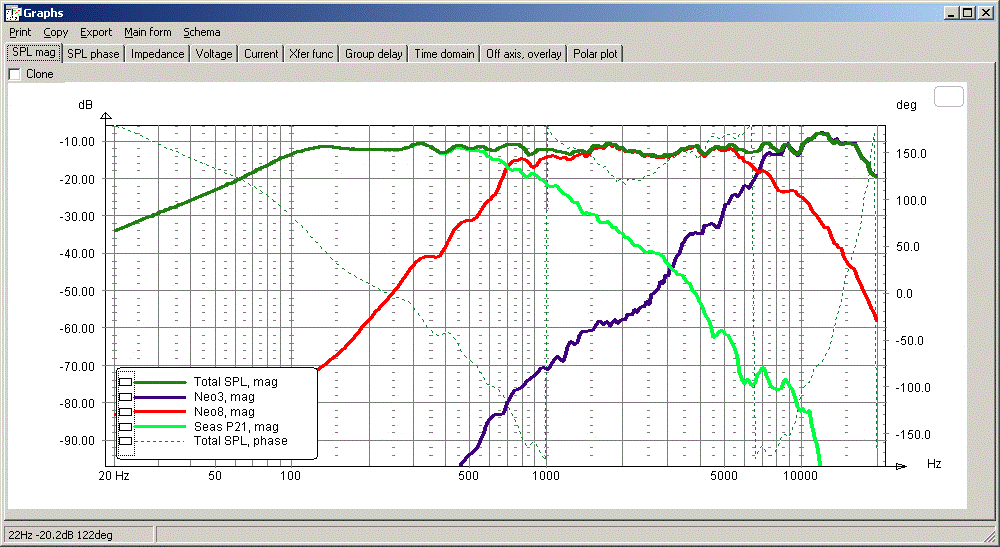

                              The frequency response is very similar to the original design's one, but the power response is vastly improved. The tweeter's response is better controlled in this version, too.

                                                                          Funny how these things work. This thread was digged up a couple of days ago, and I modified and re-painted the Miniliths, to better fit the room they are in now. And yeah, there's a circuit change involved, and yeah, to my ears, they are better than ever
                                                                          All of the changes have to do with the midrange - woofer interaction. The P21 is an excellent driver, and its bandwidth is quite wide, so it needed something faster than a 2nd order electrical.
                                                                          It's interesting that I've built at least 5 more designs after these ones, but I always come back to them. I just saw how many crossover iterations they've been through - 5. IT seems that everytime I learn something new, I mod them - but no other designs. I suppose that, after all these years, I wasn't wrong, and I really do love the Neo drivers. I'm listening to Gaucho right now, and Donald Fagen has never sounded better. :thumbup:
                                                                          I think it's time to properly document these speakers. I know the P21 is no longer available, but the tweeter - midrange crossover can be reused with other drivers.

                                                                            Sneak peek: I took off axis measurements from 0 to something like 80° in 6 steps. Here's the result. I like what I see.

                                                                              This makes me very excited to get to the project I'm collecting parts for that will use the Neo8 as a mid. I won't be using the Neo3 though.
                                                                              • fjhuerta
                                                                                • 1140
                                                                                Hi C,
                                                                                Actually my latest redesign of the x-over is based on what I've been able to learn about power response and off-axis response. The Neo8 works pretty good in this regard. I *think* (correct me if I'm wrong here) that the driver, being so slim and yet so tall helps smooth its horizontal off axis response a lot when compared to a standard cone midrange. That, and the fact that it simply sounds so great - if I were asked about this design, I'd say I love it because of the Neo8.
                                                                                Javier Huerta

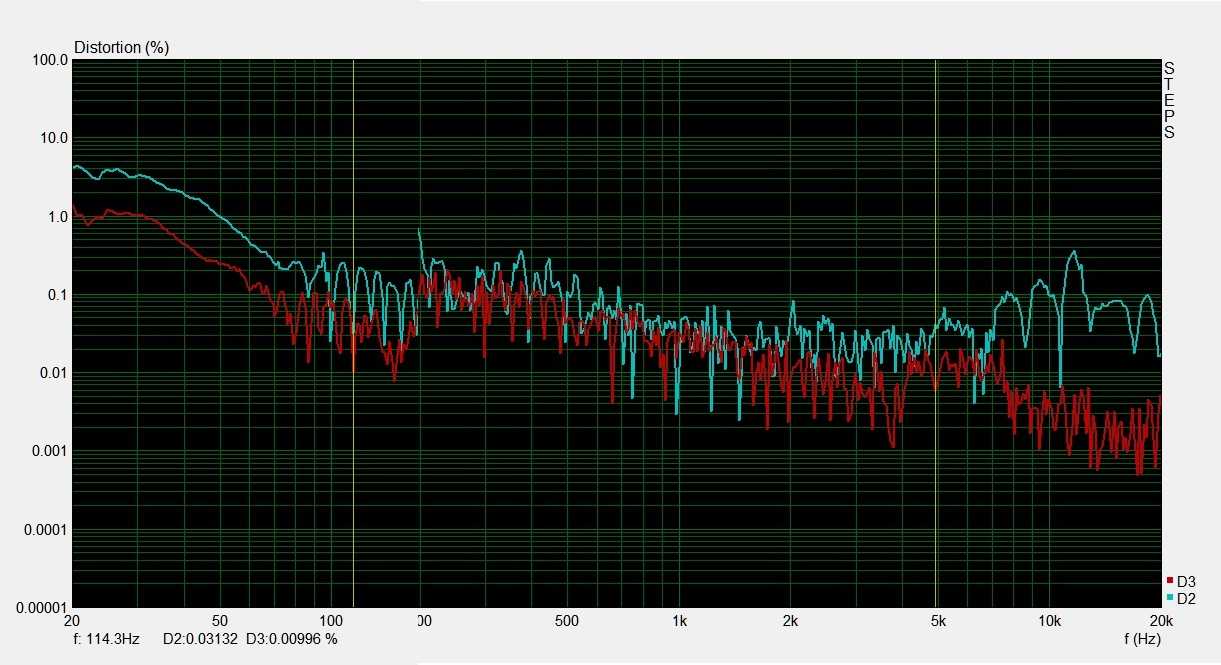

                                                                                  • 16203
                                                                                  Low distortion midrange drivers are crucial... the ear's pretty sensitive in that region.
                                                                                    I can only echo what Jon has said. I was really happy with the way my W15CY001s sounded and then I swapped that out for the B&W FST midrange unit.
                                                                                    At normal listening levels the distortion looks like this.
                                                                                    Which is ridiculously low and turning it up beyond that, to what I consider loud, only really increases the second harmonic up to a flat 0.1%
                                                                                    Perhaps you should perform a sweep of the Neo8 + Neo3 at your normal listening levels and compare it vs the megaliths, it might show up something interesting.
