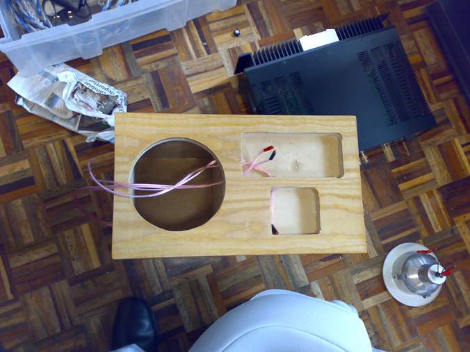

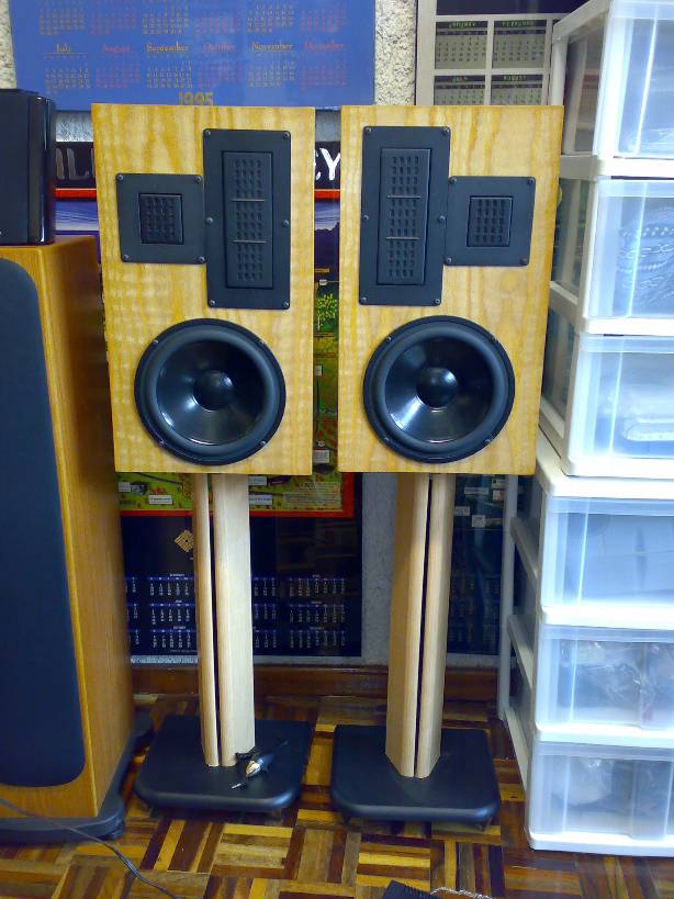

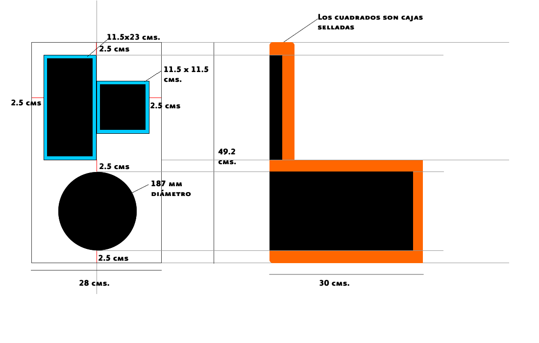

    Baffle layout and size
    I decided to go sealed. Considering that my available 8" woofers (in case I didn't like something about the Seas) could work well with about 12 liters (the Dayton 225, and the Audax AP210ZO), that's what I used.
    Here's the layout and size.
    1" MDF all around, veneered. Nothing fancy, just something practical and nice.
    According to Edge, diffraction shouldn't be an issue with drivers this big. We'll see.

        Hi Jon!
        Yep, I tried to immitate a MartinLogan in a smaller size (yeah, things don't always work that way, as you'll soon see!).
        And a lot of issues came up. Good thing is, I'm in no rush to finish this speaker.

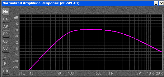

          Bass response and cabinet
          Here's the plot of FR for the cabinet. Nice, not to deep a response, but OK. Measured with the Woofer Tester 2, I got a nice 0.64 Qts.

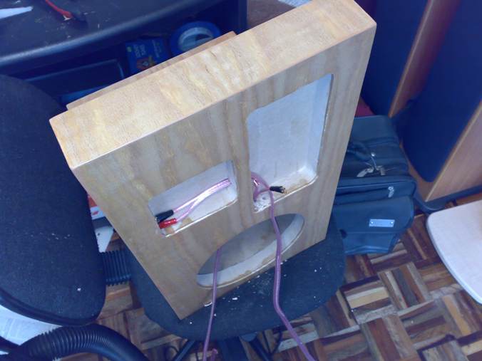

          Here are the finished baffles, with wiring included.

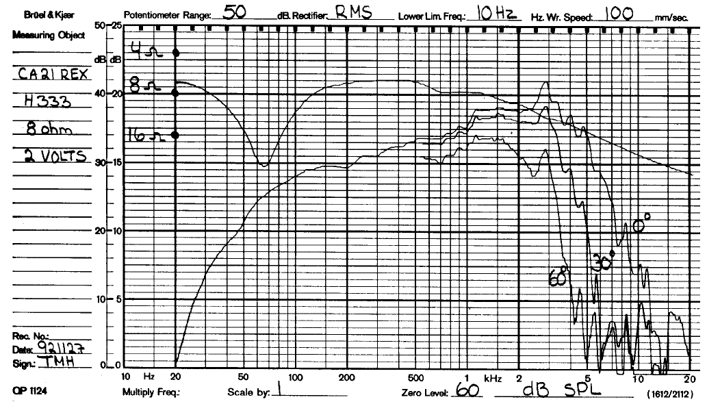

            This is where the fun stops
            According to my estimates, the speaker would be an 89 dB/W model...
            But something's definitely wrong here. Either I got a pair of macho woofers, or...
            Here's the woofer's FR plot, according to SEAS.
            Almost 90 dB, considering baffle step. Not bad!

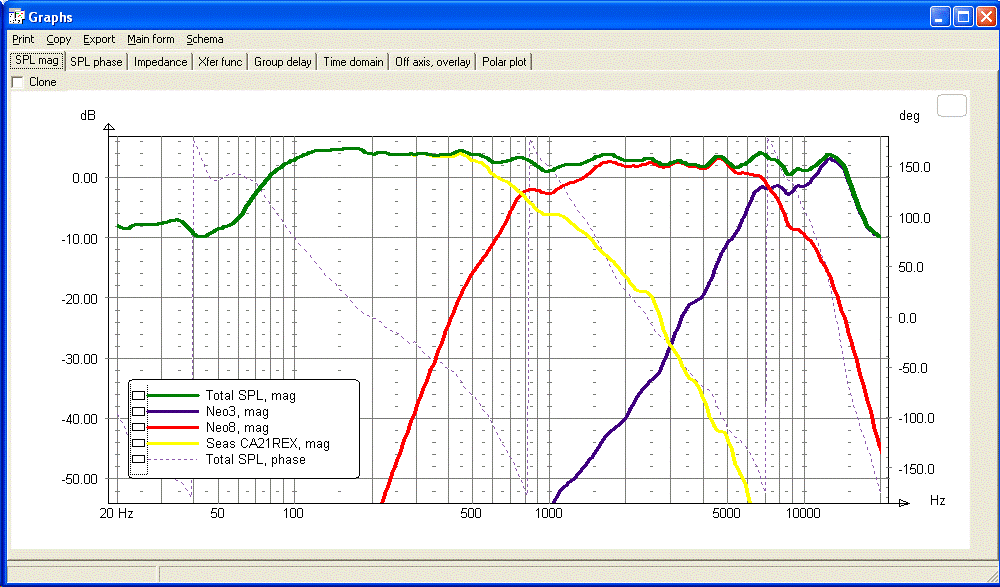

            The Neo3 and Neo8 graphs have their lowest point at 90 dB, so I assumed I wouldn't have any problems here. Well, not really.

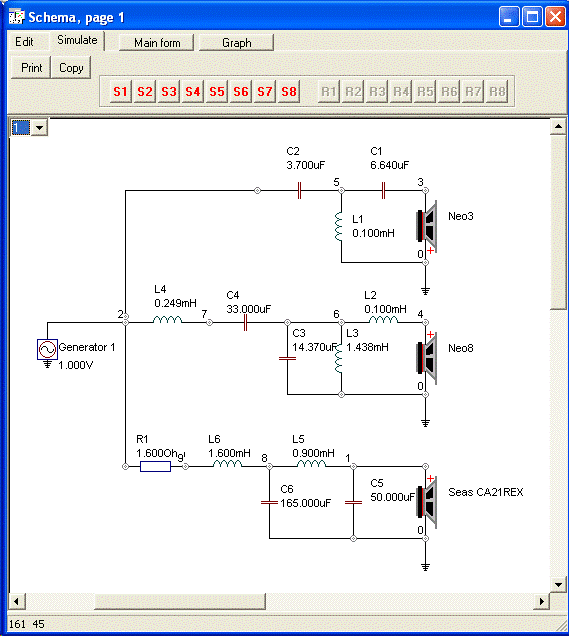

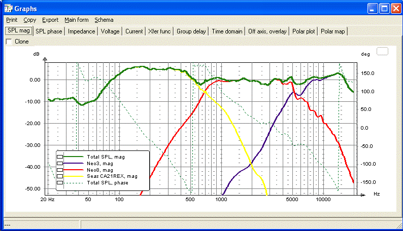

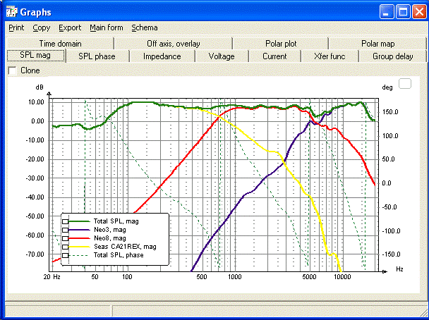

            Here's the FR of my first iteration of the crossover.
Name:	Nueva imagen.gif
            Hey, not bad, considering it's the Neo3 and Neo8 PDR...

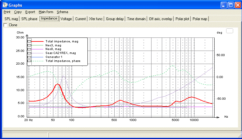

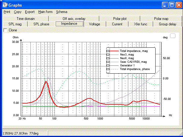

            Here's the impedance plot:
Name:	Nueva imagen (2).gif
            A little bit too low for my taste, but still not bad... hey, there's something wrong with the bass unit. See if you can guess what the problem is...

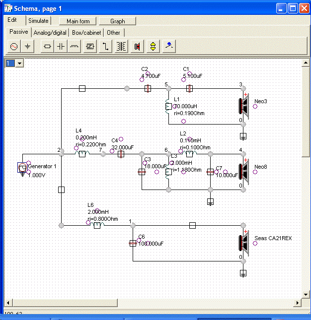

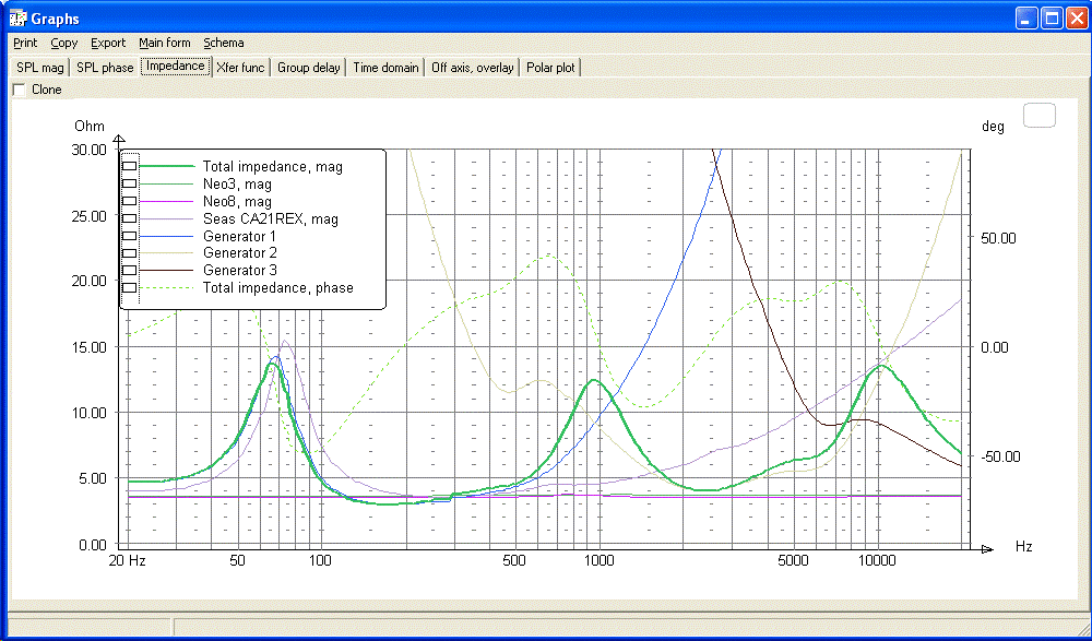

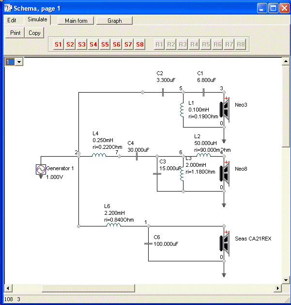

            Well, here is the problem:
Name:	Nueva imagen (1).gif
            See that resistor on the woofer leg of the circuit?
            Yep. The woofer is more efficient than the mids or tweeters. By a whopping 3 dB.
            This can't be happening.
            Right now, the only thing I can think of is that I overstuffed the tweeter and midrange cavities. I used a lot (A LOT) of dacron. Basically, the Neos chassis are pushing against it.
            I surely hope this is the problem. I need to correct it and take measurements again.

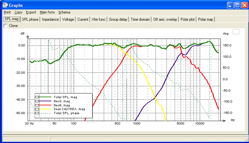

            Here's the response without the padding resistor.
            And my problem turns out to be a bit more tricky. Even if I the tweeter and mids respond well to taking out some dacron... the impedance on the woofer drops below 2 Ohm when trying to use a 4th order electrical filter.
            Wow.
            What do you think about this problem? I think I need to do a couple of things.
            1) Re-measure the speaker without so much dacron.
            2) Re-design the woofer / mid portion, shoot for a 2nd order filter at 800 Hz.
            If this doesn't help, I'll switch drivers and go for the Dayton RS woofer... with an 8 Ohm impedance and lower sensitivity it may help.

              Have you verified the voltage at the speaker terminals?
              Also, at what distance are you measuring?
              Do you know what the baffle conditions were for the b&w measurement you've provided are? If it's effectively dipole....
                Is the planar baffle sealed on the back? If so, I think B&G recommends at least at least 5" of depth and light stuffing for the big RD planars which cover a similar freq range as the Neo8.
                • Jed
                  • 3621
                  How are you handling BSC?
                  • fjhuerta
                    • 1140
                    Hi C,
                    I did verify the voltage... well, I think that's what JustMLS does when in 2-channel measurement mode. It has never failed me before.
                    I measured at 1.2 meters. That distance seemed to help regarding the FR of the planar drivers.
                    The baffle conditions are: 10L box, anechoic. I don't think the baffle dimensions are shown on the graph (I got it from the SEAS web site).
                    Dennis, the baffle is sealed, indeed, but it has only a 1" depth. Yikes. I surely hope the Neo8 doesn't require a 5" depth - if not, I'm in serious trouble!!!
                    Thanks a lot for your help.
                    Javier Huerta
                    • Jed
                      • 3621
                      Did you splice the nearfield data of the woofer with farfield and forget to add in BSC? The woofer data may be incorrect.
                      • fjhuerta
                        • 1140
                        Via the woofer circuit. As far as I can tell, there's no BSC on the midrange (I'm crossing over at 700 Hz).
                        I calculated the correct woofer response by doing the usual things... nearfield, farfield, KHF tool...
                        Javier Huerta
                        • fjhuerta
                          • 1140
                          Heh, that was exactly the first thing I thought of! Still, I just re-checked (just in case) and I'm using the corrected woofer response.

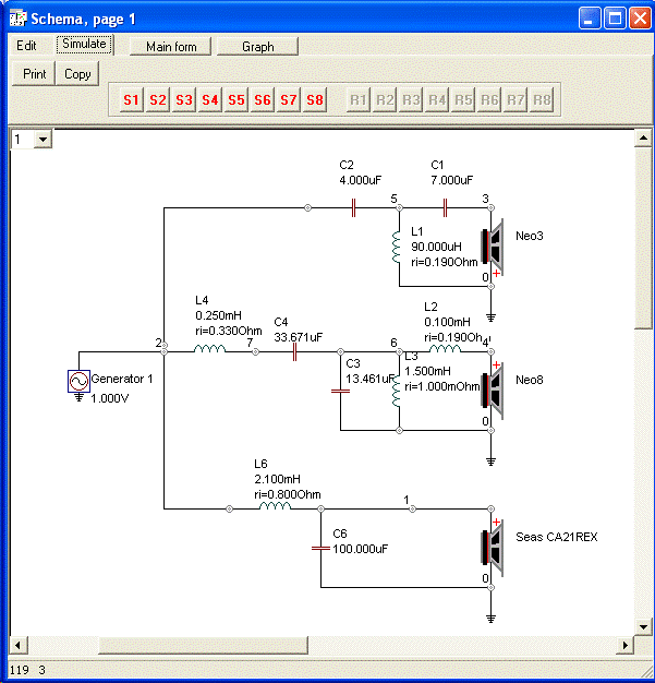

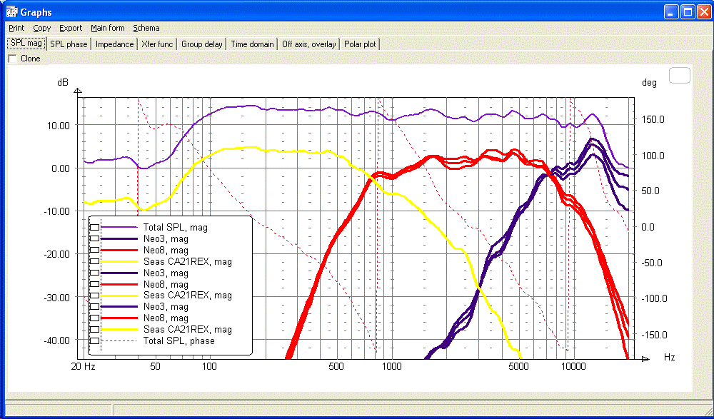

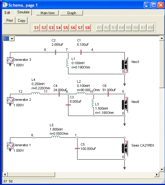

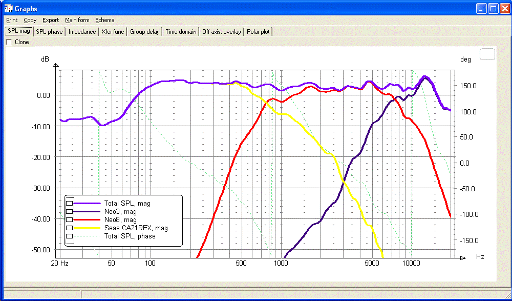

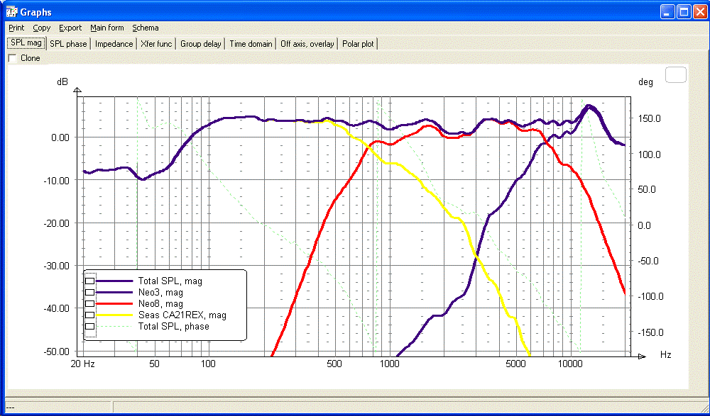

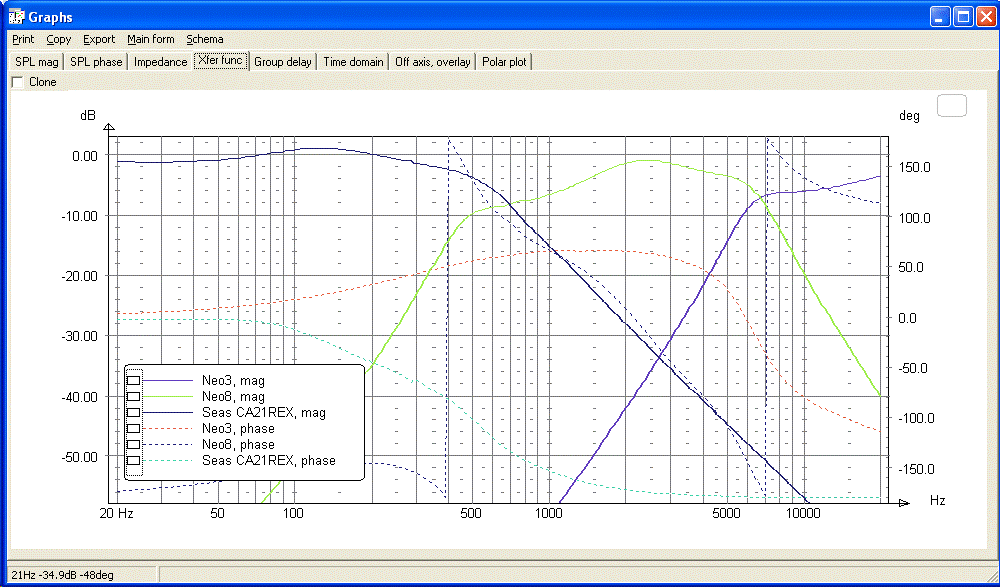

                            2nd x-over revision
                            Since I won't be able to re-measure the speaker until later this week, I spent some time playing with the x-over layout.
                            I changed the woofer's 4th order electrical to a 2nd order electrical, and tried to hit a 4th order acoustical slope. The result was great from an impedance standpoint. Then I shaped the response so as to create a downward slope (a bit of warmth).
                            In case the measurements are correct, I'll be using this crossover as a starting point for the definitive version.
                            According to my measurements, off-axis response will be pretty good, although it's only a simulation. I'll take 30° and 60° measurements this weekend, to be on the safe side.
                            So far, pairing the Neo3 and the Neo8 has been most helpful. The Neo8 is far easier to work with. Also, removing the Neo3's small baffle and using a sealed box extended its FR by at least 600 Hz!
                            FR
                            Impedance
                            New circuit

                            Javier Huerta
                              I bet you could get away with softer slopes mid-tweeter. 2nd order acoustic perhaps. Might help with various things and will obviously simplify the circuit.
                              • fjhuerta
                                • 1140
                                Thanks a lot for your input (again!) C. The reason I rolled the Neo3 so fast was because I've had bad experience trying to work around its FR, and when I saw the Neo8 was actually flatter, I decided to mainly use the 3 almost as a supertweeter.
                                One thing I've noticed is that after removing its back enclosure and giving it some room to breathe, its FR measured a bit better.
                                I'll try 2nd order, just like you said. I tried doing the same between woofer and Neo8, and the results weren't that great... at 700 Hz, actually, the 8's roll-off was basically 2nd order acoustic!
                                Javier Huerta
                                  Yeah, I'd still keep the target frequency where it is - you'll still get primary contribution from the Neo8, but you may pick up response levels a bit more and even out some of the peakiness that exists in the top octave.
                                  • fjhuerta
                                    • 1140
                                    Forgot to add - I usede Meniscus' Audio metal plates for mounting. I can't recommend them enough - they look as if they were an integral part of the Neo's. Awesome product at a great price.
                                    Anyway, I've been playing with 2nd order slopes. I have an issue... the drivers' aren't in phase, so I have even worse of a frequency response.
                                    I'm thinking about emulating the crossover and listening to it with both crossovers. The 2nd order ones are a lot simpler.
                                    I also need those off-axis FR plots...

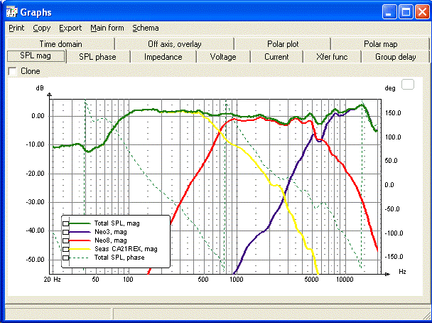

                                          OK, I finally re-measured the speakers and took off-axis measurements. I then compared the measurements to the original ones, and used the off-axis measurements to find out which version of the crossover looks better (2nd order vs. 4th order).
                                          1) The original measurements are correct. The Seas woofer seems to have a higher sensitivity than the Neo drivers. I measured voltages, measured every curve, etc. Removing the stuffing from the drivers seemed to make their responses a bit more ragged - sensitivity was unchanged.
                                          2) Off-axis, the 2nd order filter has some major suck-outs on the mid-tweeter crossover region at 30°. While, at 0°, both drivers sum perfectly well, at 30° they look to be out of phase.
                                          3) Off axis, the 3rd order filter has a flare at 5 KHz. I had to shape the response curve to mitigate it as much as possible without affecting FR on-axis.
                                          So, for now, 4th order acoustical seems to be the best bet. I'll still keep on playing with 2nd order... or different topologies.
                                          I'll post some graphs later today, or tomorrow.
                                          Javier Huerta
                                          • fjhuerta
                                            • 1140

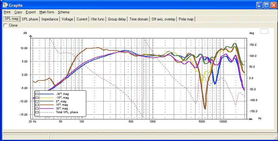

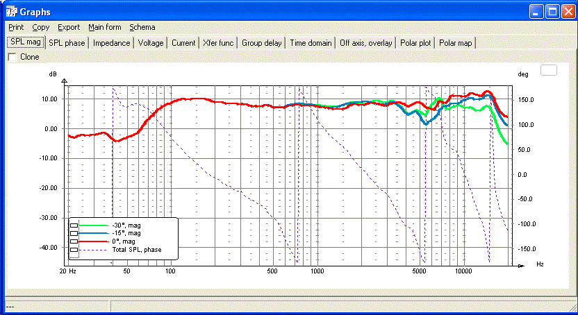

                                            AAAaaargghhhh
                                            I should have suspected it. There's a reason there aren't many 3-ways being designed in this forum.
                                            3-ways are hard!
                                            Especially when the drivers are physically big, and they don't have nice horizontal dispersion.
                                            At this point, I'm seriously considering just unplugging the Neo3 PDR.
                                            The issue?
                                            Off-axis response! Due to their horizontal placement and (I assume) the distance between drivers, off axis response is terrible!
                                            Depending on the listening axis, response develops major suck-outs - when I use a 2nd order x-over, the only difference is that they appear at different angles.
                                            I seriously don't think this issue can be solved, unless I raise the x-over frequency and make the Neo3 irrelevant. But I'd like to avoid the peak in FR from the Neo8.
                                            Any ideas?
                                            (The only FR with nearfield / farfield is at 0°).

                                            • Jed
                                              • 3621
                                              looks like the tweeter phase should be reversed, with that null off axis, so maybe instead of doing that, you could shoot for a lower crossover point to avoid the cancellations you are getting in the higher frequencies.
                                              • fjhuerta
                                                • 1140
                                                So far, no luck.
                                                I spent all night playing with X-over points. From 4KHz to 12 KHz, and every time I get a null at 15° off-axis.
                                                At this point, I can't help but realize this design is flawed from the start.
                                                The reason why I placed the drivers side by side instead of top-down was because I saw a MartinLogan which used this baffle layout. I suspected they did this because of the limited vertical dispersion of the Neo8, and thought it was a good idea.
                                                Now I realize that a better idea would have been to do a T-M-W and design using the M as the listening axis, letting the Neo3 fill in the upper octave with its wider vertical dispersion.
                                                I'm still wondering whether to build this speaker, or re-design with a new cabinet.

                                                          Would you mind posting a screenshot of the system when the tweeter is in negative polarity?
                                                          Another option might be a steeper slope between mid and tweeter.
                                                          • fjhuerta
                                                            • 1140
                                                            Sure thing. Great idea on the steeper slopes - I tried slower ones.
                                                            Javier Huerta
                                                            • Jed
                                                              • 3621
                                                              Thanks, but I can't see your pics, broken links.
                                                              • fjhuerta
                                                                • 1140
                                                                Here they are. That's strange - I was certain I had uploaded them before.
                                                                Javier Huerta
                                                                  Lookin better and how is the off axis now?
                                                                  • fjhuerta
                                                                    • 1140
                                                                    It isn't still how I'd like it to be, Jed.
                                                                    Still, I've noticed something. I quickly built a higher order crossover, and the cancellaton isn't anywhere as severe as a 4th order (I went for a 6th order), the FR is flatter... and I found out that when tweeters are placed on the outside, cancellation doesn't occur at all. Tweeters on the inside are problematic.
                                                                    This could be the solution to this problem. As long as the listener is in the sweet spot, the speakers will sound good. Since I already knew vertical dispersion would be poor, the "sweet spot" listening won't be an issue.
                                                                    Javier Huerta
                                                                    • Jed
                                                                      • 3621
                                                                      Sounds like you are getting to the bottom of it. :T
                                                                      • fjhuerta
                                                                        • 1140
                                                                        Jed, you are probably right, and I have to thank you for it. Quite frankly, if you hadn't guided me through it, I'd have probably forgotten about this cabinet.
                                                                        Anyway, a 6th order filter seemed to help a lot. I'll probably be refining the crossover point a bit during the week, but I don't expect the topology to change that much.
                                                                        I have very minor cancellation now, considering the size of the drivers, I guess this was pretty much unavoidable.
                                                                        Anyway, I may try to drop a bit the x-over frequency on the tweeter, but nothing too serious (500 Hz or less, perhaps).
                                                                        (FR as measured with the tweeters on the outside).
                                                                        Javier Huerta
                                                                        • Jed
                                                                          • 3621
                                                                          :T Glad I could help out. I'm sure they'll sound as good as they look. I haven't tried those BG mids/tweets yet myself, so let us know your impressions.

                                                                            I forgot to check one thing... impedance.
                                                                            It drops below 2 Ohm.
                                                                            I'm designing a new cabinet with side-firing woofers. I simulated in LSPCad the required distances to avoid phase cancellation. And yes, the tweeter is now on top of the mid.
                                                                            I'll build it in el-cheapo MDF, just in case I sc**w something up again.
                                                                            (Hey, if I'm using relatively expensive / nice drivers, there's no use in paying good $ for a crossover when I'm not sure of the results! - plus, the new cabinets may look very cool).
                                                                            I'll post again when I sort these issues out.

                                                                                  I designed two new cabinets. This time, I'll have them built out of raw MDF, and choose between them. One of them is a standard 3 way tower, T-M-W. It's quite probable the listening axis will be on the center of the Neo8, but we'll see. I'm sure this one will work, since I already modeled it extensively.
                                                                                  The second one is a rather unusual design. It has the Neo8 and 3 mounted in the front baffle, and the 8" woofer firing sideways. According to LSPCad, at 200 mm from the front baffle, and with inverse polarity, the woofer sums up with the Neo8. Since LSPCad isn't taking into consideration the size and shape of the actual box, I'm not sure this box will work. I hope it does, since I think it'd look very cool.
                                                                                  Any thoughts about it? The boxes themselves were not that expensive, so I'll have them by next week.

                                                                                    Some real progress.
                                                                                    After finally deciding the baffles were all wrong (and the woofer enclosure could be a bit bigger), I built two new enclosures.
                                                                                    One of them had a side-firing woofer, the other is a normal TMW baffle.
                                                                                    Anyway, the one with the side-firing woofer was GREAT... on axis. Off axis (obviously enough now, not so obvious back then), FR depended on whether you were listening directly to the woofer or not. Since the x-over point was around 700 Hz, the speaker was unusable.
                                                                                    The TMW baffle showed some promise, so I decided to work on it... and after a couple of weeks, this is what I ended with. Other tha vertical off-axis response (which I already knew wouldn't be that great, due to the tallish drivers), I think the design turned out quite fine.
                                                                                    One of the things I love about it is that it uses no resistors whatsoever. Levels were adjusted using the inductors' resistance (and, quite honestly, they aren't that critical - but the values I have for them are the most exact ones).
                                                                                    I don't have any pictures of the baffles, since they are being finished right now, but here's the final circuit and lots of graphs.
                                                                                    Another thing - these drivers' response off axis is... ahem, well, not really flat. Things start looking much better at 15°. I can't imagine designing a speaker using these drivers without considering off-axis response as well as on-axis.
                                                                                    (Note: Off-axis response is not an LSPCad simulation - it's taken from real 15° and 30° off-axis measurements. This is the only way to see how critical off-axis response seems to be with these drivers).
                                                                                    Schema:
                                                                                    On axis:
                                                                                    15° off axis:
                                                                                    30° off axis:

                                                                                    • fjhuerta
                                                                                      • 1140
                                                                                      Transfer function:
                                                                                      Impedance:

                                                                                          Success!
                                                                                          After what seemed like months of hard work (oh, wait - it really took that long), I finally finished my speakers
                                                                                          I'm absolutely blown away at the Neo drivers in this configuration. By combining the 8 and 3 , I avoided most of the issues (especially regarding FR) I had with the Neo3 alone.
                                                                                          The Neo8, crossed at 800Hz, is simply superb.
                                                                                          How good is it?
                                                                                          Here's an idea - I was listening to the "Brothers in Arms" XRCD2 disc today, and I was sure I had blown a speaker. It had a very strange distortion I had never heard. After swapping channels, speakers, amplifiers, versions of the album, and listening to both speakers side by side I realized something - the distortion I was listening to came from the bass guitar itself. It was so real and pure, I thought the Neo8 had blown up! :E
                                                                                          Now I have a question... can a dynamic driver sound as realistic as the planar ones? I've listened to many, but I had never confused real life distortion with recorded distortion. And I don't think I've ever heard a speaker with such dynamic transients, either (except for my old MartinLogan Scenarios, which were quite quick with transients, but sounded terrible).
                                                                                          I'm sold on these drivers. I'll try to post some pictures and more information tomorrow.
