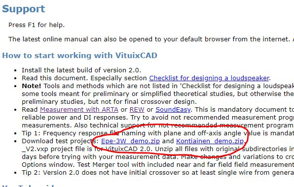

                                              I am coming from BoxSim, there the start is a no brainer starting with the 3 way default project.
                                              Do you think you can provide some example 2 Way or 3 Way passive crossover and simple CB cabinet .vsp V2 format project files supplied with the software installation as a kind of quick start to this quite complex tool?
                                              Or as first answer a link to some kind of web link where to download examples of projects.
                                              I did not find anything like this or the https://kimmosaunisto.net/ web site.
                                              • draki
                                                • Oct 2012
                                                • 37
                                                In VituixCAD that you linked, open the User Manual.
                                                Scroll down to Support / How to start working with VituixCAD.
                                                There are two test projects which you can download.
                                                      Sorry for the stupid question - after reading the simple answer i have to ask myself whether i'm getting too old...
                                                      Many thanks - starting with an example project is extremely helpful and this is probably the reason why you put this in Tip 1
