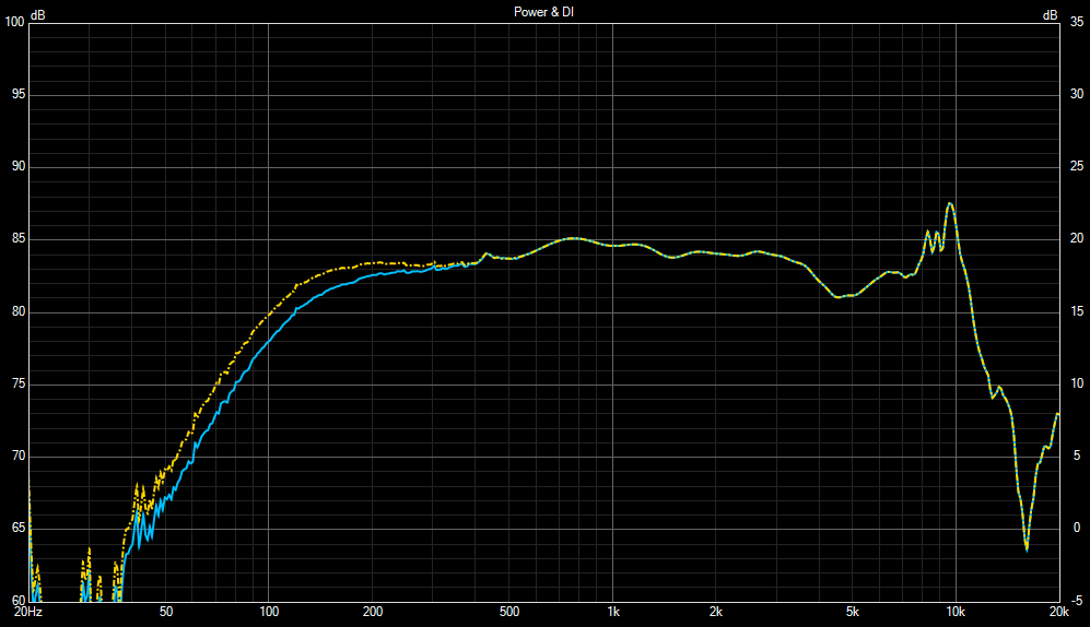

    Originally posted by kimmosto
    Users have been asking do they need measurement data in vertical plane, negative angles, smaller than 10 deg steps etc. ASR Directiva project has measurement data for some conclusions, applicable to circular radiators in horizontally symmetrical small box.
    Solid lines = both planes and negative angles, step 5 deg, totally 143 responses / driver.
    Dash-dot lines = positive angles in horizontal plane only, step 10 deg, totally 19 responses / driver.
    I thought the need or lack thereof with vertical angles and negative angles was already fairly well established. There are use cases for vertical data, such as ribbon or AMT drivers. I detailed a simplified method of approximating the vertical data for a driver without measuring in the following thread, unfortunately there didn't appear to be any interest in this.
          Yes, but (mostly) in theory. That's maybe the first public and quite reliable data set as actual measurements in both planes with 5 deg angle step. Anyway, result is a bit surprising, but within predicted/acceptable tolerance so vertical measurement data and 5 deg angle step can be useful and informative but not mandatory with circular hifi drivers.

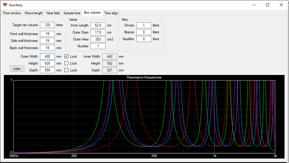

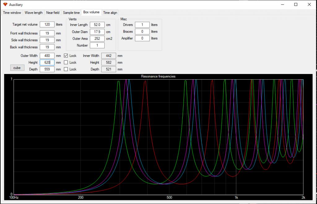

                                                                    Something seems a bit off with the vertical scale of the resonant frequency chart on the box volume calculator window.
                                                                    What I get:
                                                                    What the help file shows:

                                                                      2.0.76.7 (2021-10-11)
                                                                      Auxiliary calculator
                                                                      * Y scale, Q factors and range of resonance chart improved.
